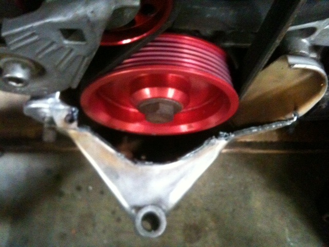

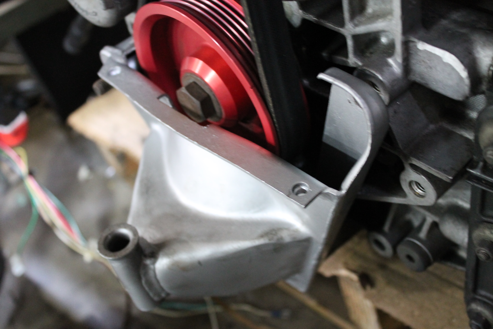

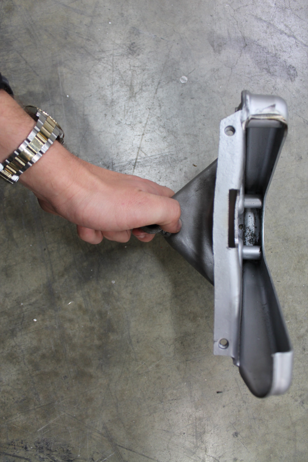

Small speedbump in the way of getting the engine in the car.
As you may recall, this engine has the Clewett Engineering Serpentine belt system installed, great system- I love it. However, the system will not clear the engine mount (engine side) on the OEM /6 engine support. It still needs about 1/2 an inch before it presses flush against the engine.
After looking at a few options, we've decided to cut the support lip on the mount, and re-weld it approximately 1 inch closer to the firewall, giving both enough room to run the Clewett pulley system AND replace a belt inside the car while still maintaining the 'box' structure on the mount that gives it so much strength.

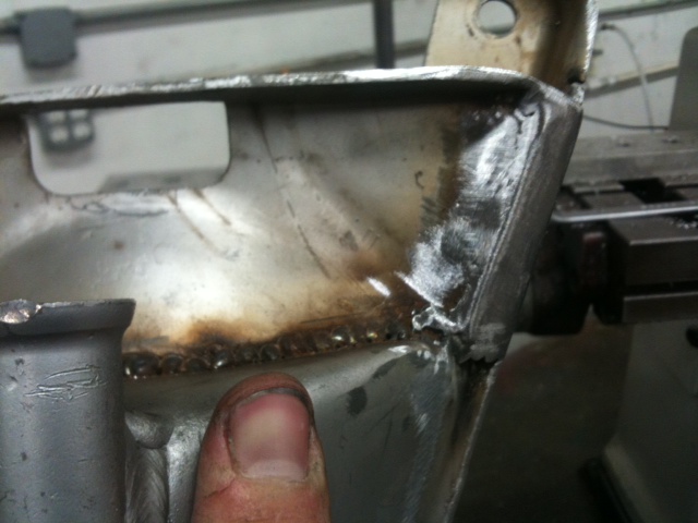

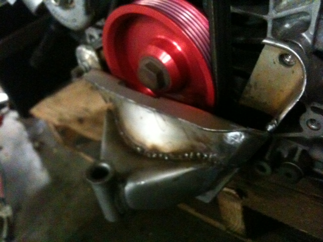

Initial plasma cut done courtesy of my Father. Now I'll be cleaning this up, grinding down the edges, and re-welding the top support and possibly two 'fins' to give it additional strength. It's still very strong, but I rather be over-kill than iffy.

QUOTE(RiqueMar @ Feb 28 2012, 02:37 PM) *
They're called "gussets".

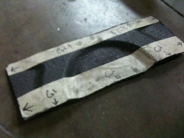

RiqueMar
post Mar 3 2012, 01:49 AM
Post #691
Enrique Allen Mar
Posts: 2,264
Joined: 28-August 08
From: San Diego, CA
Member No.: 9,478

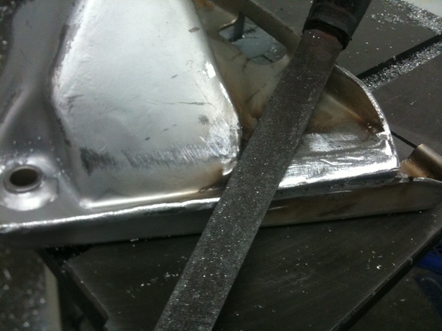

Friday night.... again.... and here I am with a file trying to get a super nice radius on a part no one is ever going to see.....

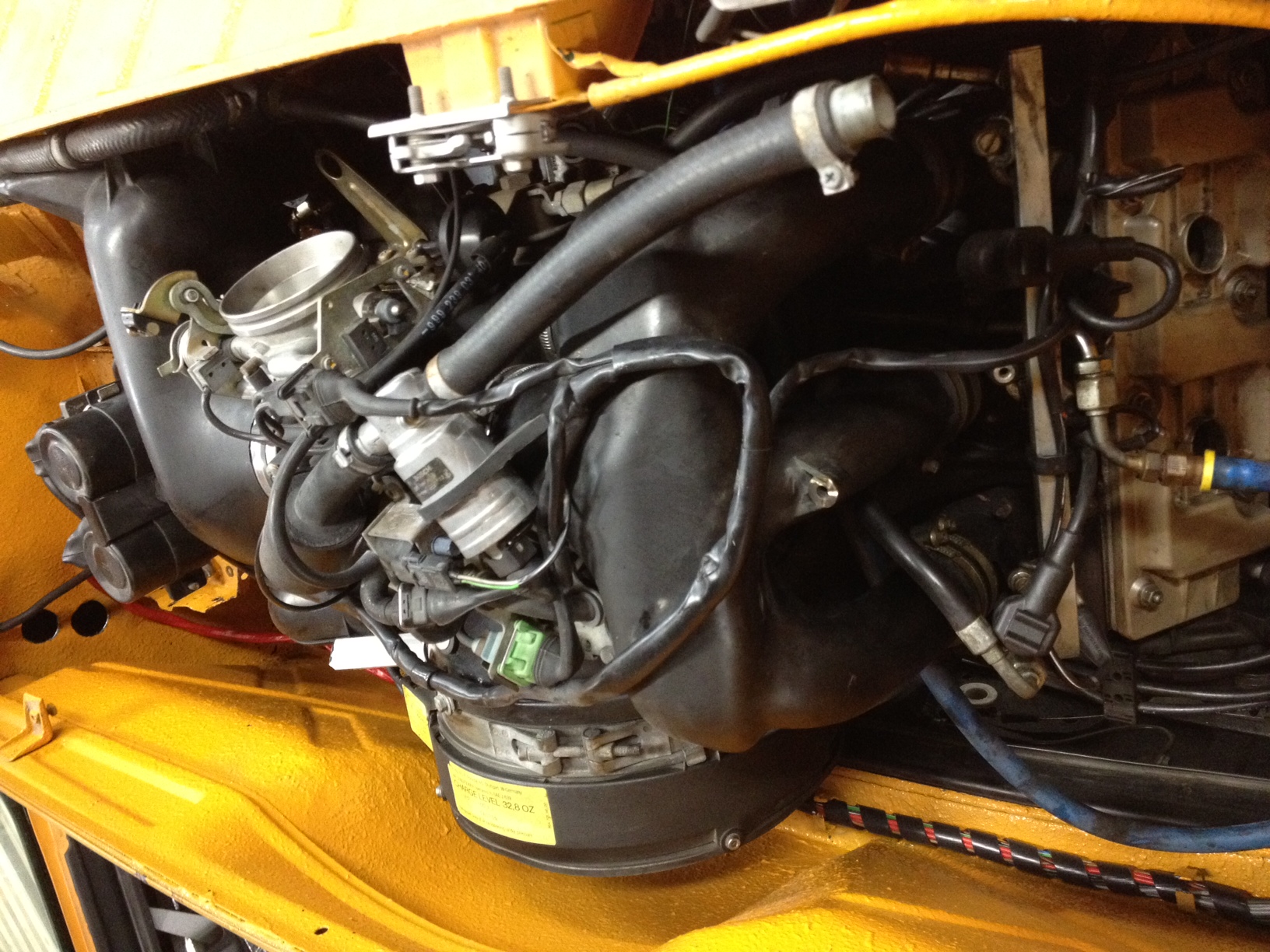

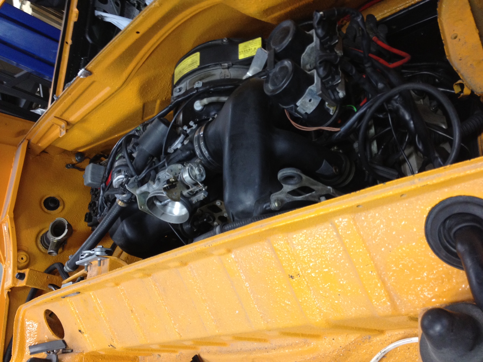

This is now the third fourth engine this car has had since I've owned it.... and I still have yet to drive it (IMG:style_emoticons/default/dry.gif)
Fits like a glove though! (IMG:style_emoticons/default/biggrin.gif)

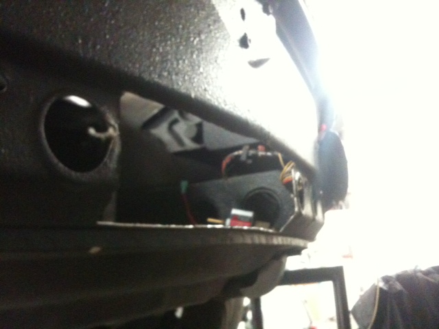

RiqueMar
post Mar 9 2012, 01:03 AM
Post #695
Enrique Allen Mar
Posts: 2,264
From: San Diego, CA
Member No.: 9,478

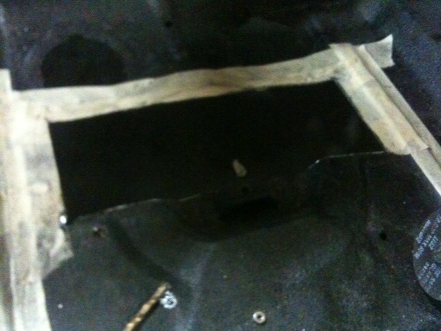

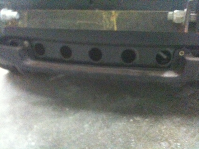

Plugging right along. (IMG:style_emoticons/default/smash.gif) (IMG:style_emoticons/default/sawzall-smiley.gif) (IMG:style_emoticons/default/smash.gif) (IMG:style_emoticons/default/sawzall-smiley.gif) (IMG:style_emoticons/default/smash.gif) (IMG:style_emoticons/default/sawzall-smiley.gif)

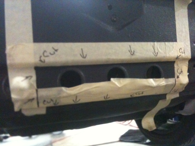

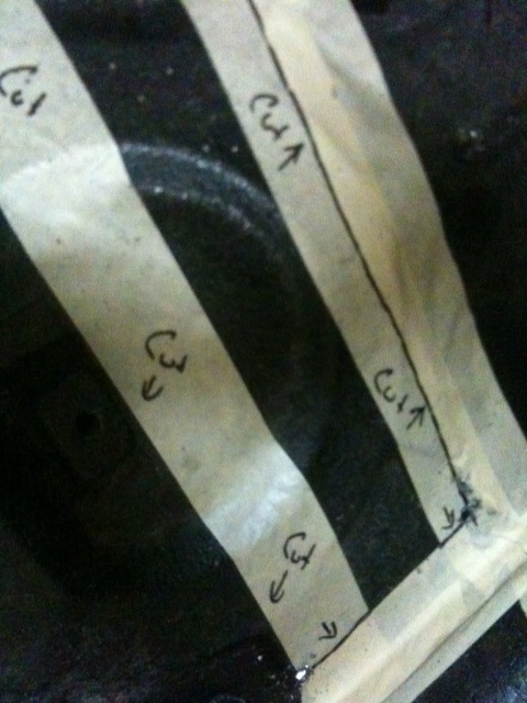

RiqueMar
post Mar 9 2012, 01:33 AM
Post #696
Enrique Allen Mar
Posts: 2,264
From: San Diego, CA
Member No.: 9,478
post Mar 9 2012, 07:49 AM
Post #697
914-6 GT in waiting
Posts: 20,588
Joined: 19-September 09
Member No.: 10,825
Are you going to reinforce the body around the cut-outs?

QUOTE(mepstein @ Mar 9 2012, 05:49 AM) *
Yes, we have a 'fiberglass modeler' on staff who's really good. I'm thinking a nice one-piece 'ring' of carbon fiber around the entire cutout that will tie the oil cooler into the body in addition to the bolts on the bottom

[quote name='RiqueMar' date='Mar 9 2012, 10:16 AM' post='1642042']
[quote name='mepstein' post='1641989' date='Mar 9 2012, 05:49 AM']
[/quote]
Nice!
