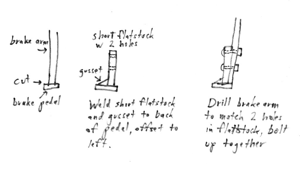

I posted this reply in another thread about speakers, so I thought I might offer this fix in it's own thread. Mark commented: "(the) reason I don't care for the console is because anything but slippers I catch my right foot between the console and brake pedal."
I hear this from a lot of 914 owners if they have big feet. Here's a relatively easy fix, and really improves the problem. Hey Mark, I have size 13 shoes and I too would drag my brake pedal with my right foot. I finally hacksawed the brake pedal off right at the end of the arm, (did it in the car without removing pedal box). Then I welded a short piece of steel 1/4 inch flat stock with 2 predrilled holes to the back of the pedal, offset to the right side of the pedal, as you look at it from the front. Then I welded a small steel gusset between the extension arm and the pedal to add support from pedal pressure being now on one side on the extension arm. Finally I drilled 2 matching holes in the brake pedal arm aligned with the extension holes and bolted it all together on the left side of the brake arm. I have a included a crude diagram below to show the simplicity of the process. It took me about 30 minutes to do, all "in car", and was not as hard as I made it sound. Now my brake pedal has about a half inch clear on the side of my big shoes, and makes a real pleasurable difference driving the car. ![]() |

TargaToy The idea makes sense but the diagram is drawn as i... Jan 16 2020, 12:51 PM
oakdalecurtis
The idea makes sense but the diagram is drawn as ... Jan 16 2020, 01:45 PM
Ansbacher A similar problem to what the OP describes is even... Jan 16 2020, 02:36 PM
76-914 I had this problem with my Karmann Ghia but instea... Jan 16 2020, 02:51 PM
dwillouby Thought about that when mocking up my drive by wir... Jan 16 2020, 02:56 PM
SO.O.C914er I simply removed the rubber boots which gave me mo... Jan 16 2020, 02:58 PM![]() ![]() |
