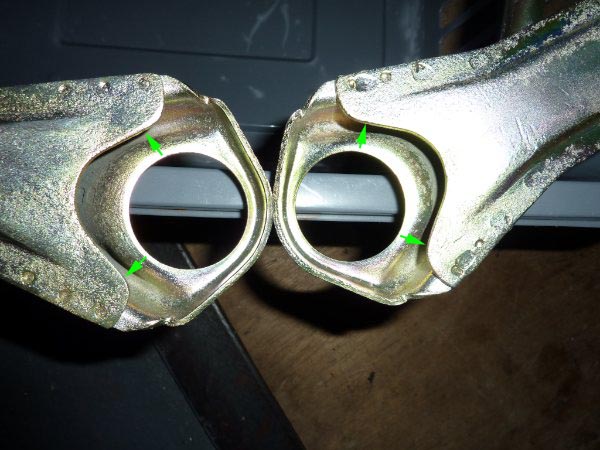

QUOTE(veltror @ Mar 31 2010, 04:41 PM) *
The A arms do not look bent, what do you think Andy
They look good. (IMG:style_emoticons/default/thumb3d.gif)
As long as the hole is centered between the metal flanges, you're good ...
(IMG:style_emoticons/default/popcorn[1].gif) Andy
I added a pic to illustrate. The hole for the strut should be centered so that the distance marked by the green arrows is the same. If the hole is not centered, the arms are bend.

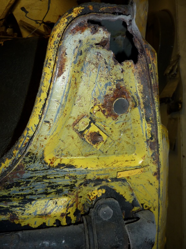

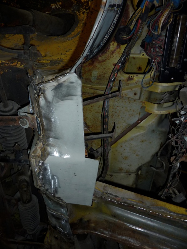

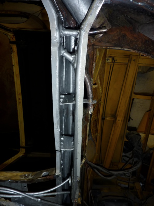

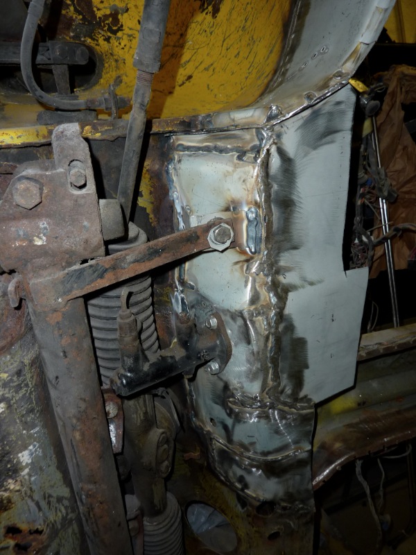

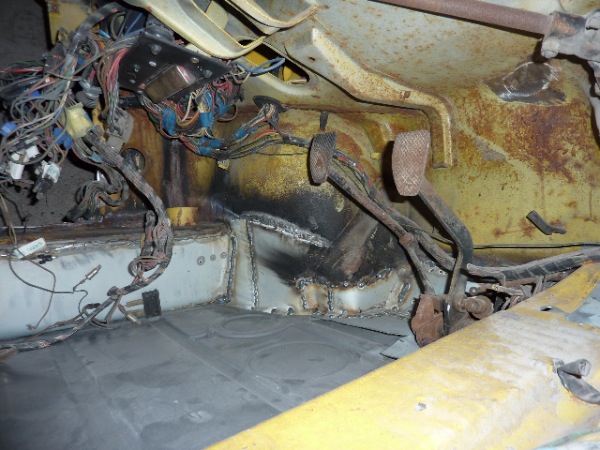

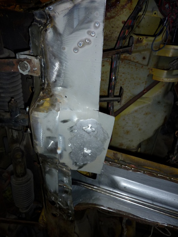

the whole front area around the master cylinder was pretty weak and crusty so marek replaced all of that and also the area in in the inner wing. Sometime in the past it had some work done and the throttle tube got burned thru, so that is being fixed also.. rust everywhere, hopefully a floor soon!!!

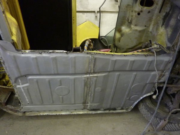

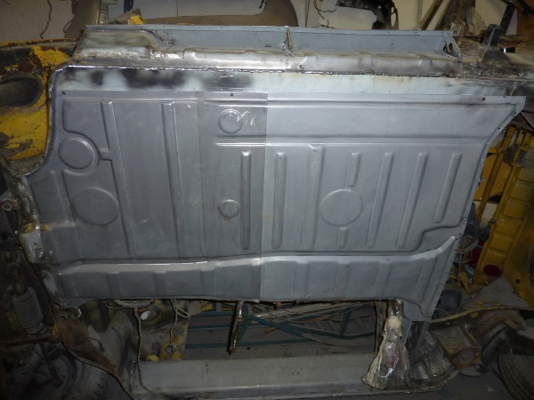

(IMG:style_emoticons/default/smile.gif) Marek, has got the bit between his teeth now, first he fixed the throttle tube which was u/s rebuilt all the metalwork around the pedal cluster, which was paper thin. (IMG:style_emoticons/default/smash.gif)
Floors need some fettling but are in place ready to be welded tomorrow. (IMG:style_emoticons/default/welder.gif) Then the other side and for the first time in a while it will be back on its wheels.
Much more work still to come, fitting of door jamb, refitting of wings and flares.. but its on its way which counts....

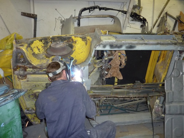

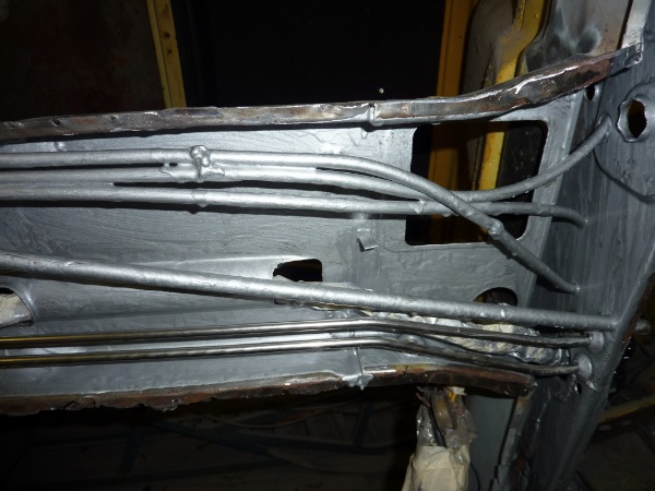

(IMG:style_emoticons/default/piratenanner.gif) Works continues, floors got welded in on one side, throttle tube was fixed and pedal area remade from scratch. Today the car got turned round and the other side of the floor is going to get welded in. Marek, the genius who is doing this has suddenly got his appetite back fro this project, at around the two year mark. (IMG:style_emoticons/default/welder.gif)
Anyway here are some pictures from today.

When it rains it pours, after closing it all up we noticed we had been using an incorrect cable to make sure the throttle tube was good, arghhhhhhhhhhhh, had to cut out the floor again weldin a new tube and weld it up again. This is going to send me insane...

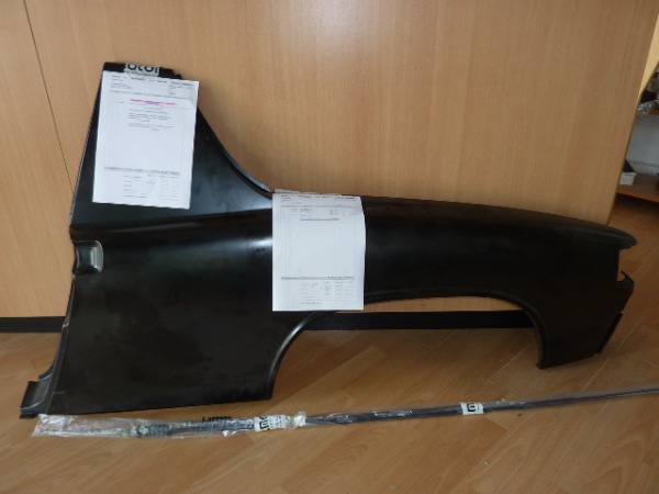

Just to make it clear, it was derusted, prepped and painted several times, it is not por15 it was painted with some zinc primared somethign or other that my body man di and then covered in some silver paint as a top coat. I doubt it will rust again, I plan to dinitrol it afterwards. I understand the concerns for flipover but I am kind of limited in what i can do. I did have the car back on its wheels recently and am happy to say it has not twisted, all the measurements still look good. Parts supply is a problem but I have just scored a NOS left rear wing which is good since it was very rotten and the door jamb was crud. Pictures soon.

Look what I bought from Mittelmotor .... (IMG:style_emoticons/default/aktion035.gif)

It will almost be a shame to fit this NOS wing...
