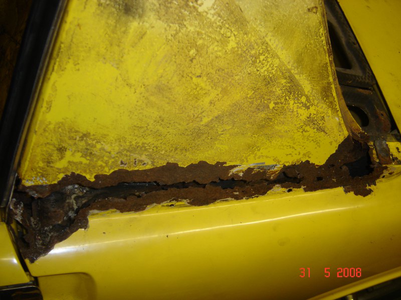

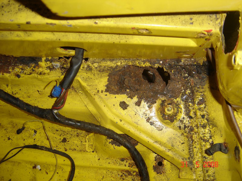

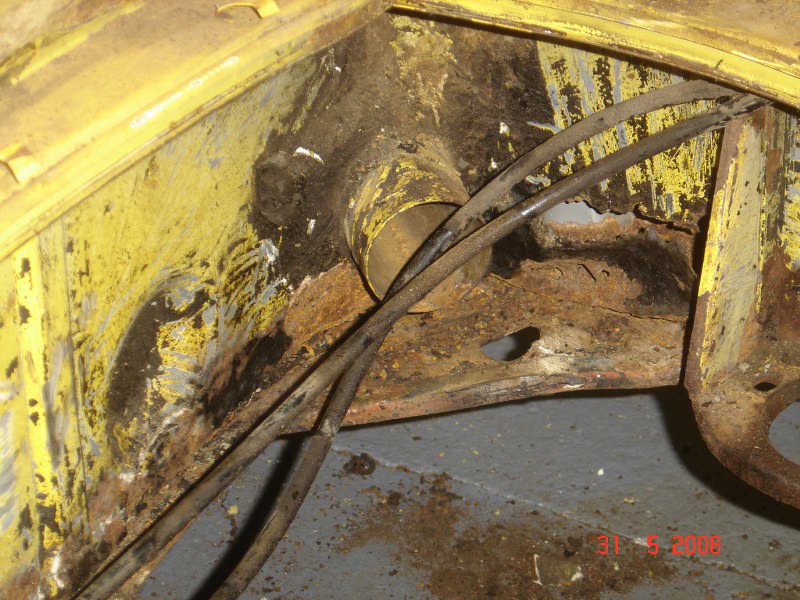

Well more progress now car very nearly stripped, not sure how to take out the metal dash frame but found a thread so Ill do that tomorrow. Welding welder.gif starts next week. Here are some progress shots.
Roman mad.gifClick to view attachment
veltror
Where did the seat belt mount go?

welcome.png There are club members here that have repaired worse.

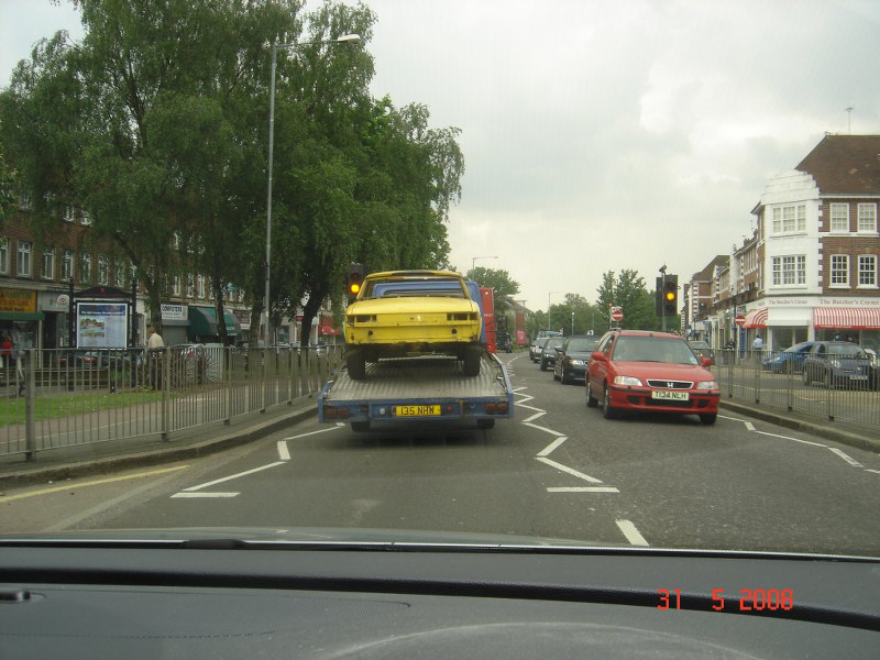

Right got the thing stripped now, and it has gone off to the bodyshop, wish I had the skills to weld decently, needless to say my body man is worried. Also not the last picture of it being transported down to the man, lots of people looking at what it is..

I couldn't help but notice that everyone is on the wrong side of the road! biggrin.gif
Is your car right hand drive?

Nope its left hand drive only about a dozen or so were converted by Crayford to RHD. Who says we are are on the wrong side of the road, probably explains why you have so many accidents driving.gif
http://en.wikipedia.org/wiki/Driving_on_the_left_or_right

Left side of the road is way better. Add in roundabouts and it all works perfectly. The Brits got that part "right".
Now if they could just put one faucet on their sinks instead of two the place wouldn't be so bad.
British 914s suit low-loaders.
