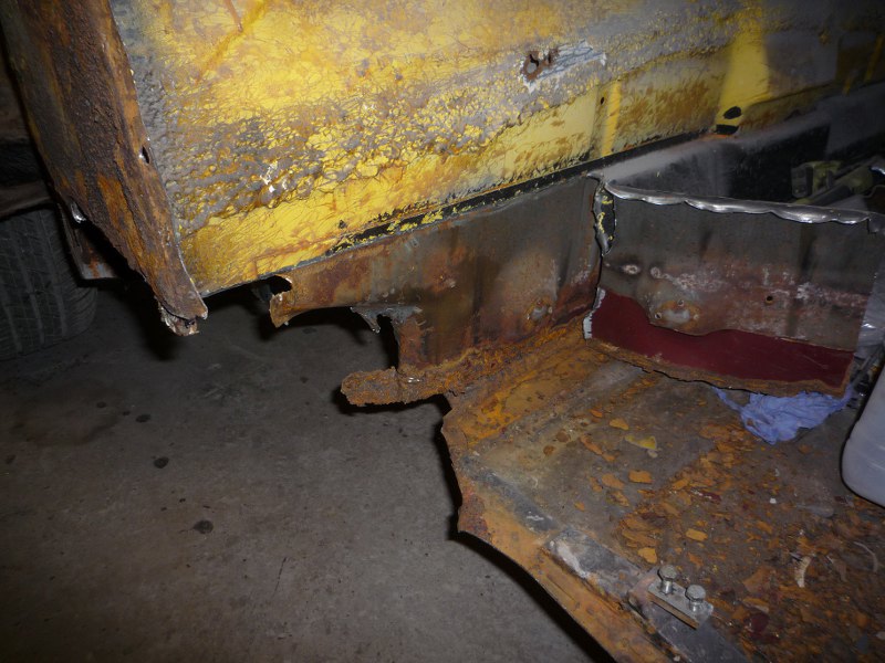

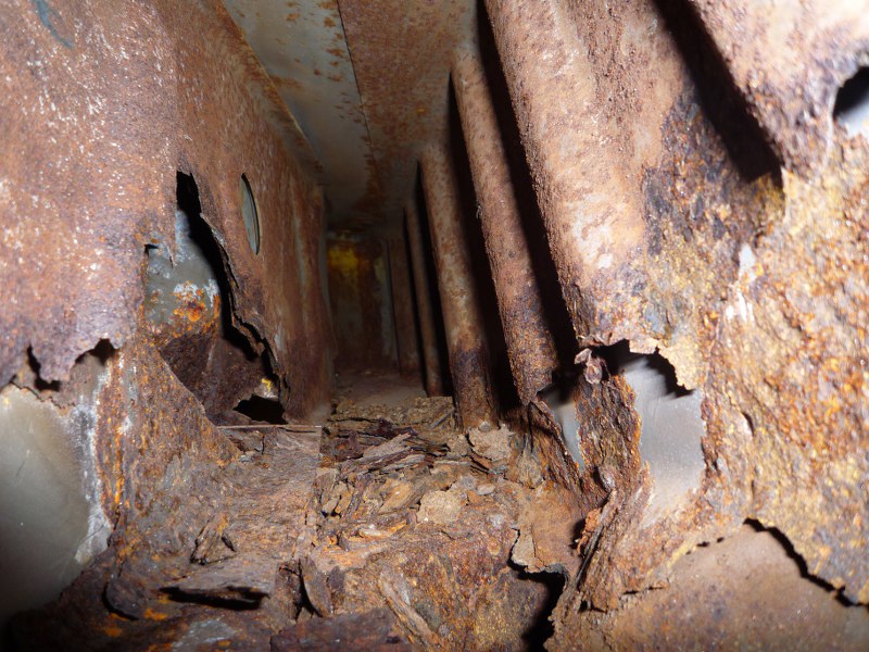

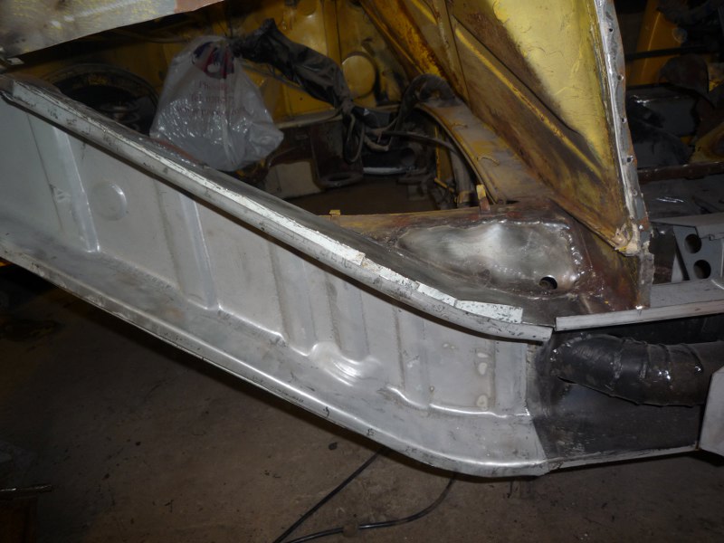

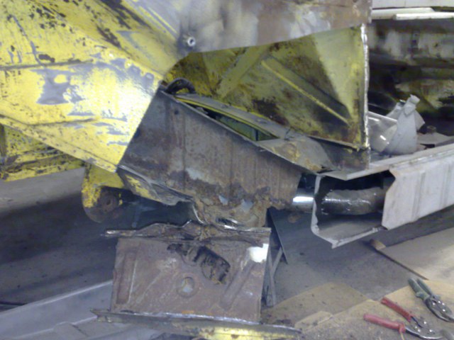

ok i took a picture looking back up the remains of the long, makes me want to cry or feel sick. (IMG:style_emoticons/default/barf.gif) (IMG:style_emoticons/default/barf.gif)

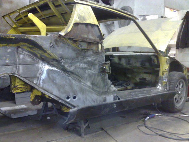

Ok inner sill tacked on

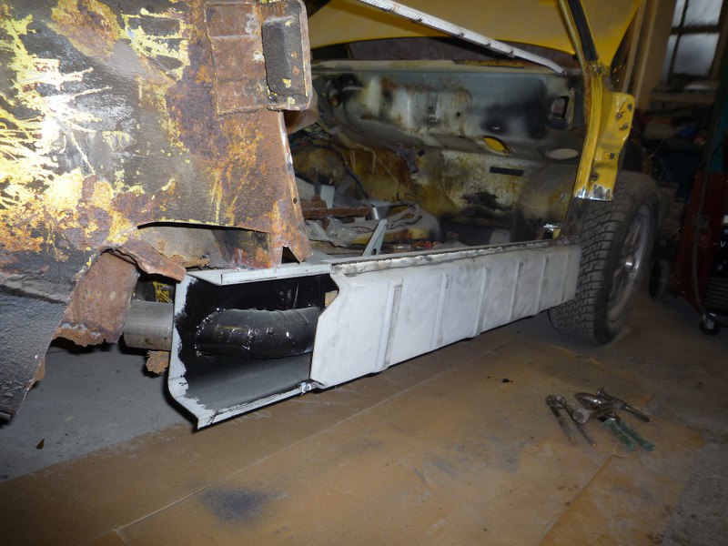

Ok rebuilt rear heater pipe and now need to reshape front (IMG:style_emoticons/default/welder.gif)

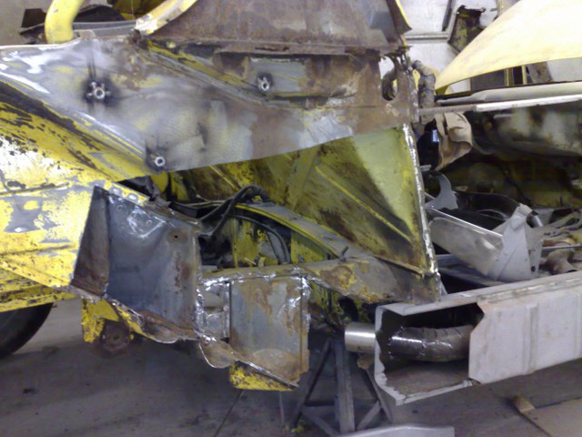

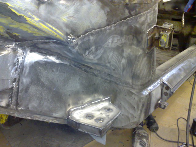

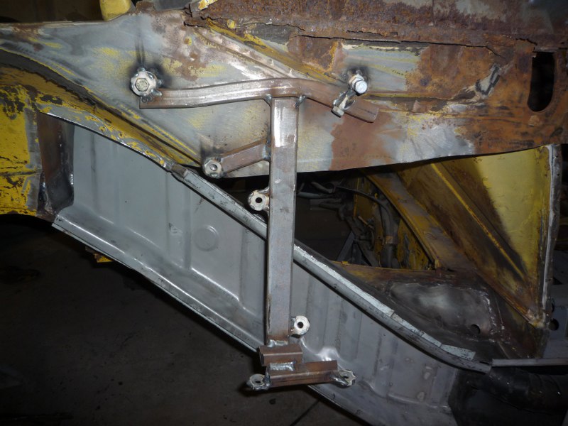

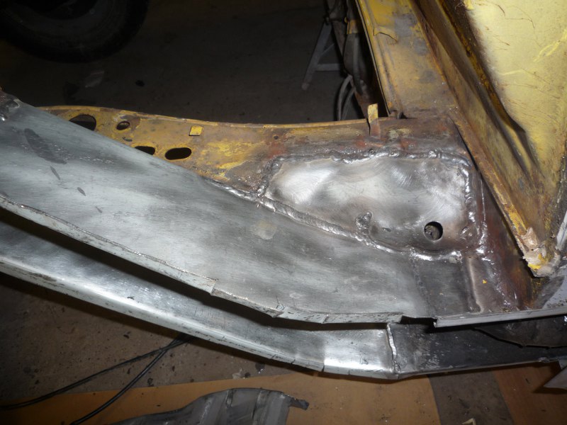

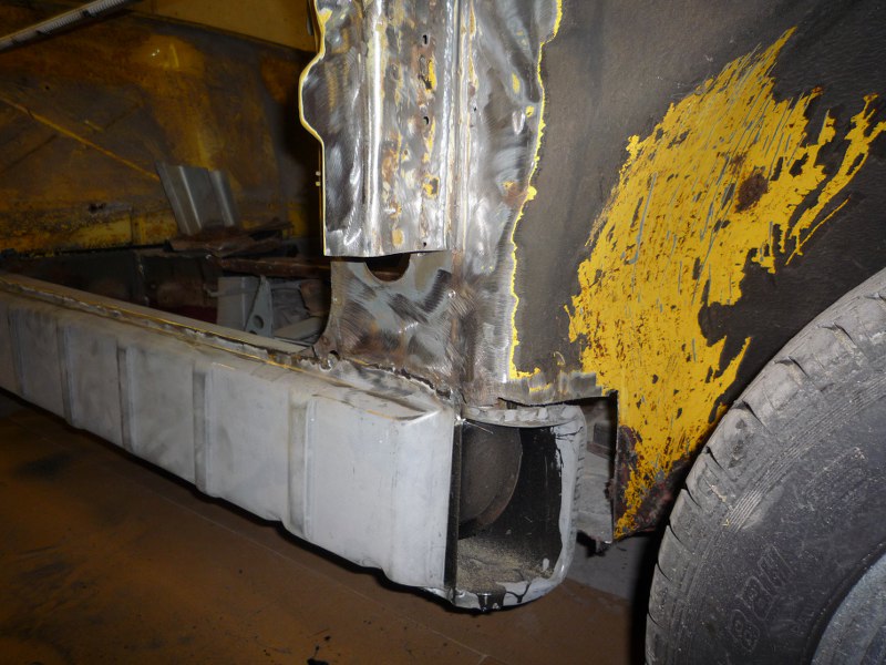

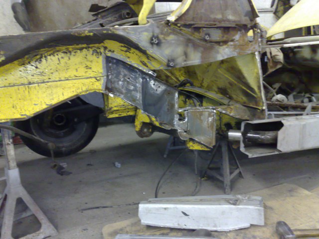

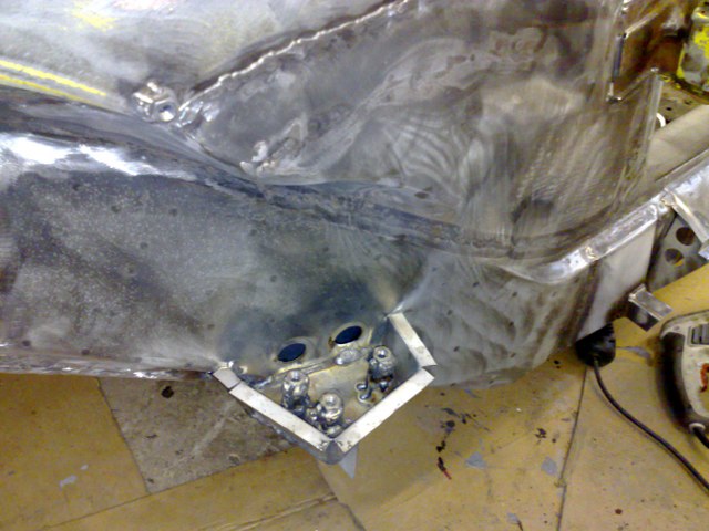

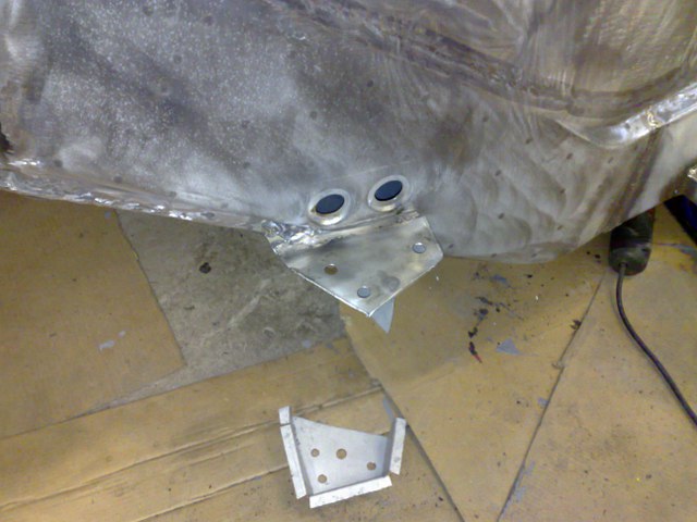

Big update, lots of work done over Xmas. cut out the outer suspension console. Fabricated the inner long, fixed the hell hole, rebuilt the door pillar, fabricated a mount for the suspension console so it goes back int he right place. Cut out the battery tray.
Most of you guys would not bother, but not many here in the Uk so it has to be done. (IMG:style_emoticons/default/welder.gif)

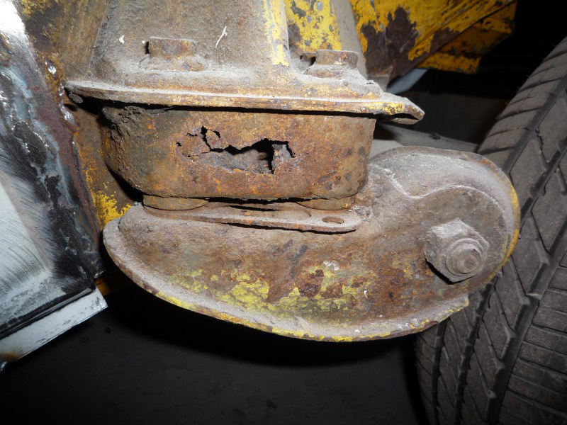

I wish I could take the credit for all the metalwork but thta is being done by a magician friend of mine. called Mark (IMG:style_emoticons/default/pray.gif)

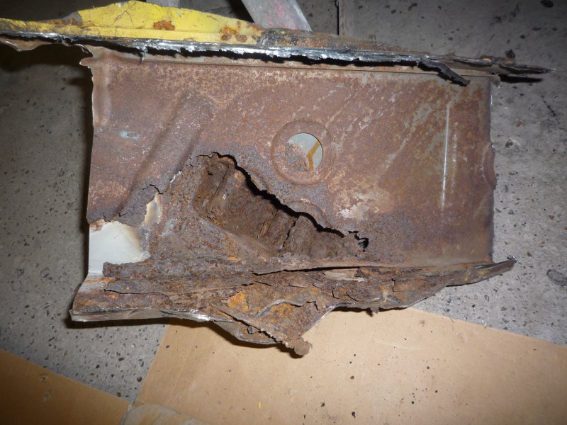

Anyway nice rusted outer console

some more

That's some nice metal work right there!

Cool, it's lke raising the dead. Your friend does nice work. (IMG:style_emoticons/default/welder.gif)

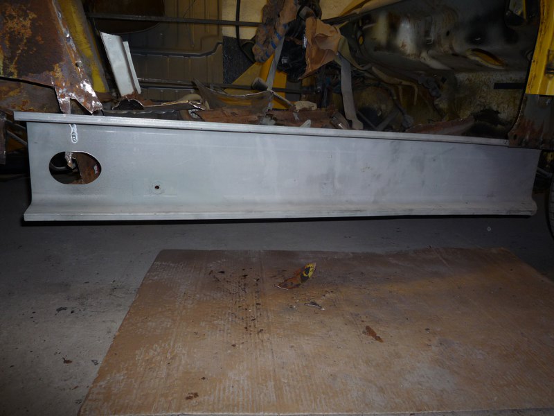

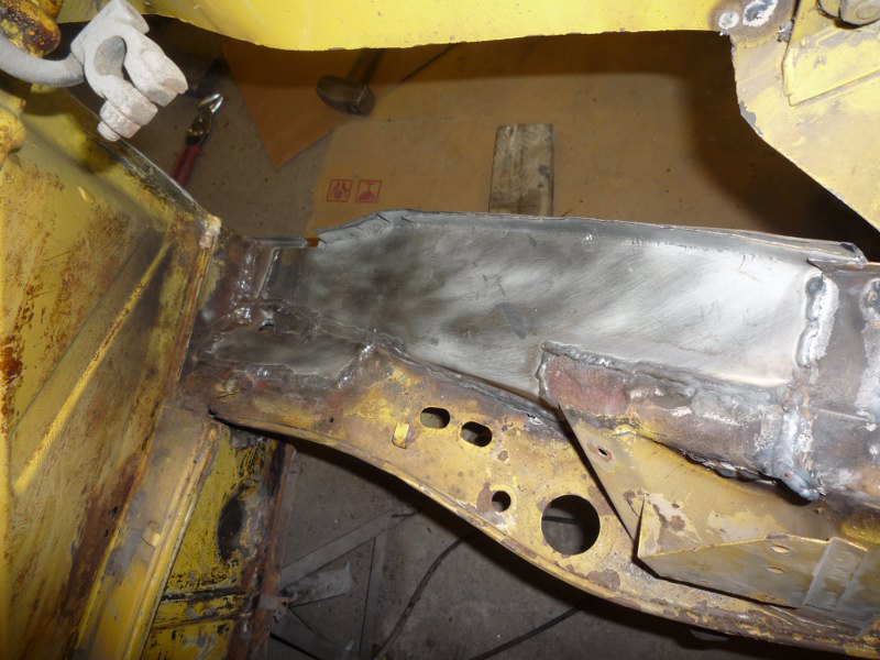

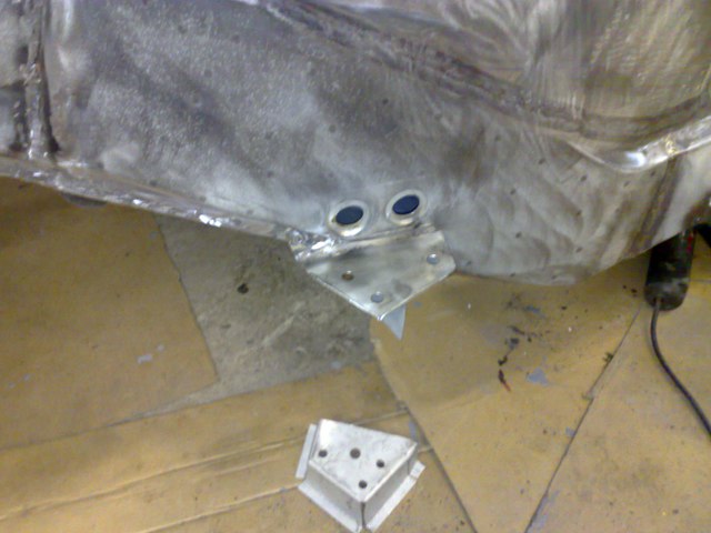

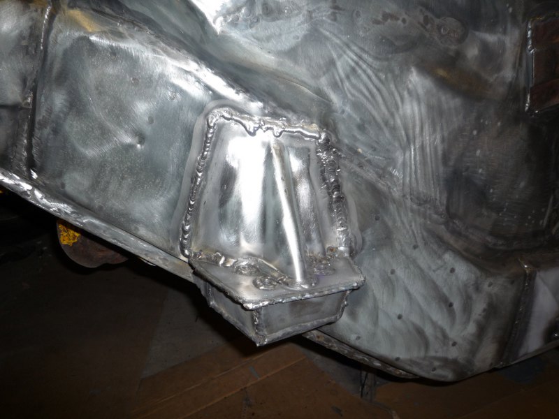

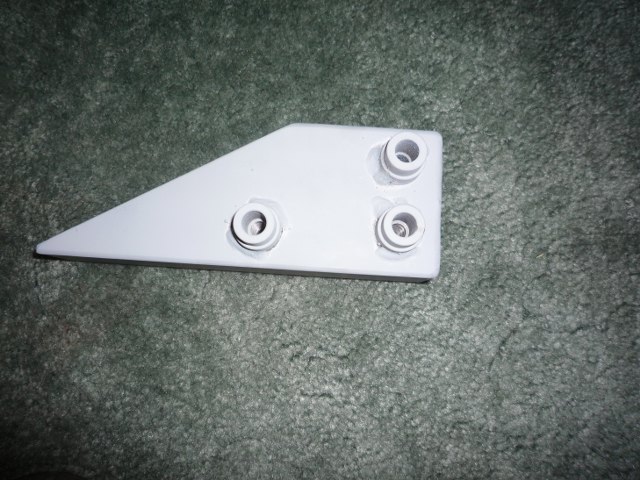

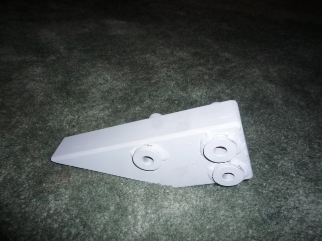

The left outer console was pretty much toast so Chris Foley made me this part and its intended replacement

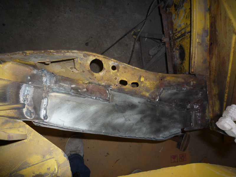

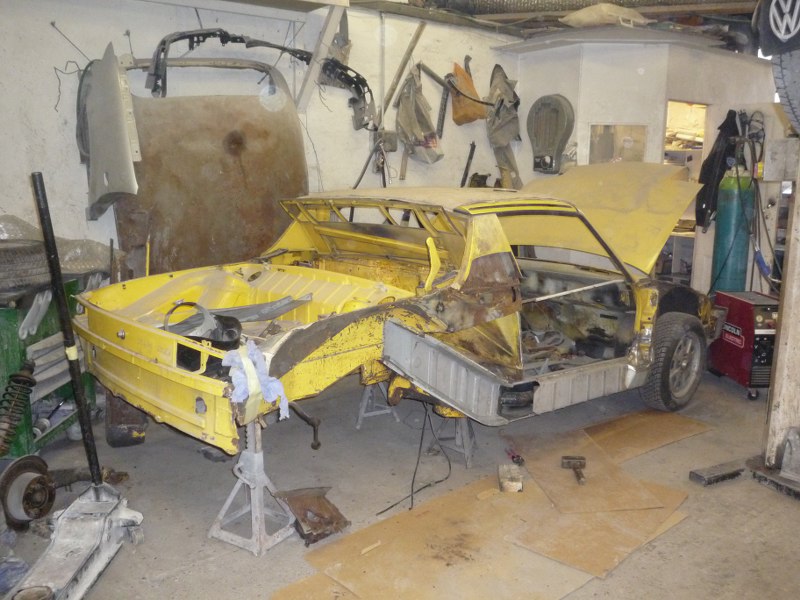

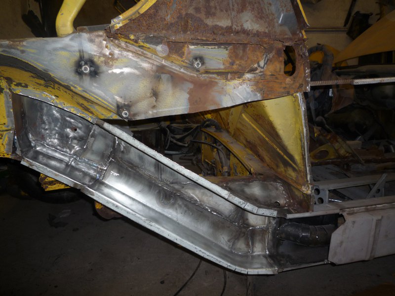

Well the magician (IMG:style_emoticons/default/welder.gif) doing the bodywork my mate Marek (IMG:style_emoticons/default/pray.gif) had other plans so here is a big update with some out of sequence pictures. Best wishes to all in 2009. (IMG:style_emoticons/default/beerchug.gif)
thanks for everybodys help off this forum

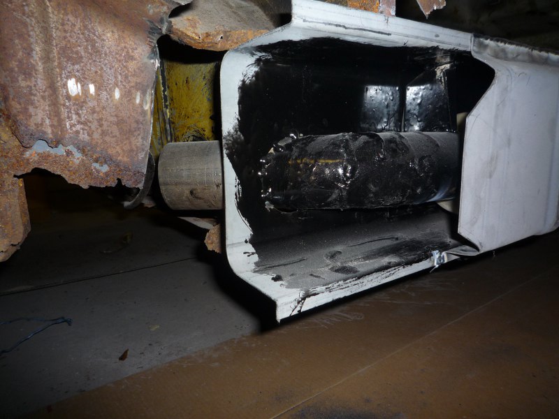

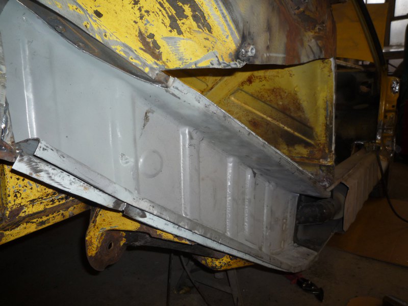

and some more, I am sure most of you in the US would have made this into a parts car...
