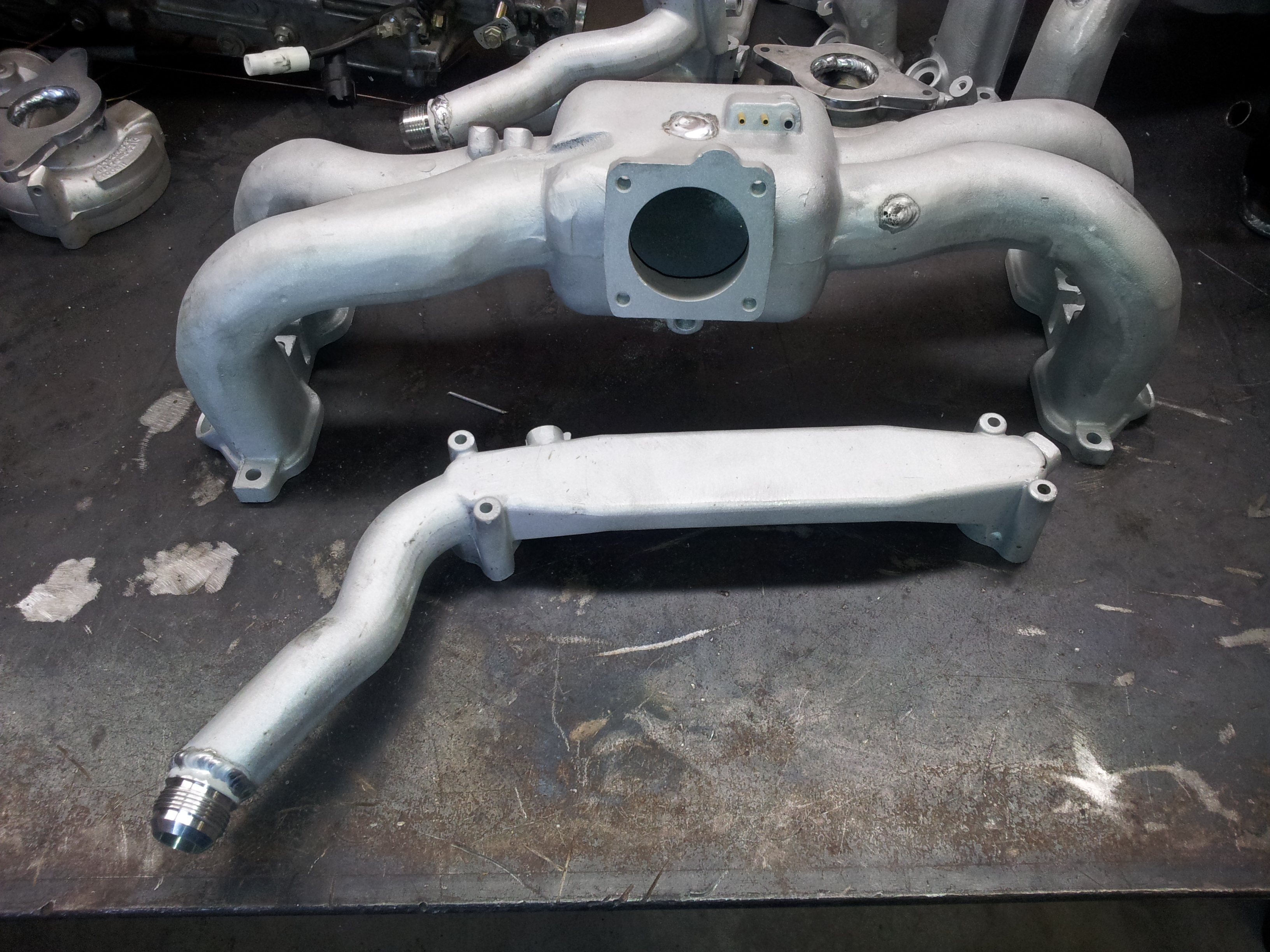

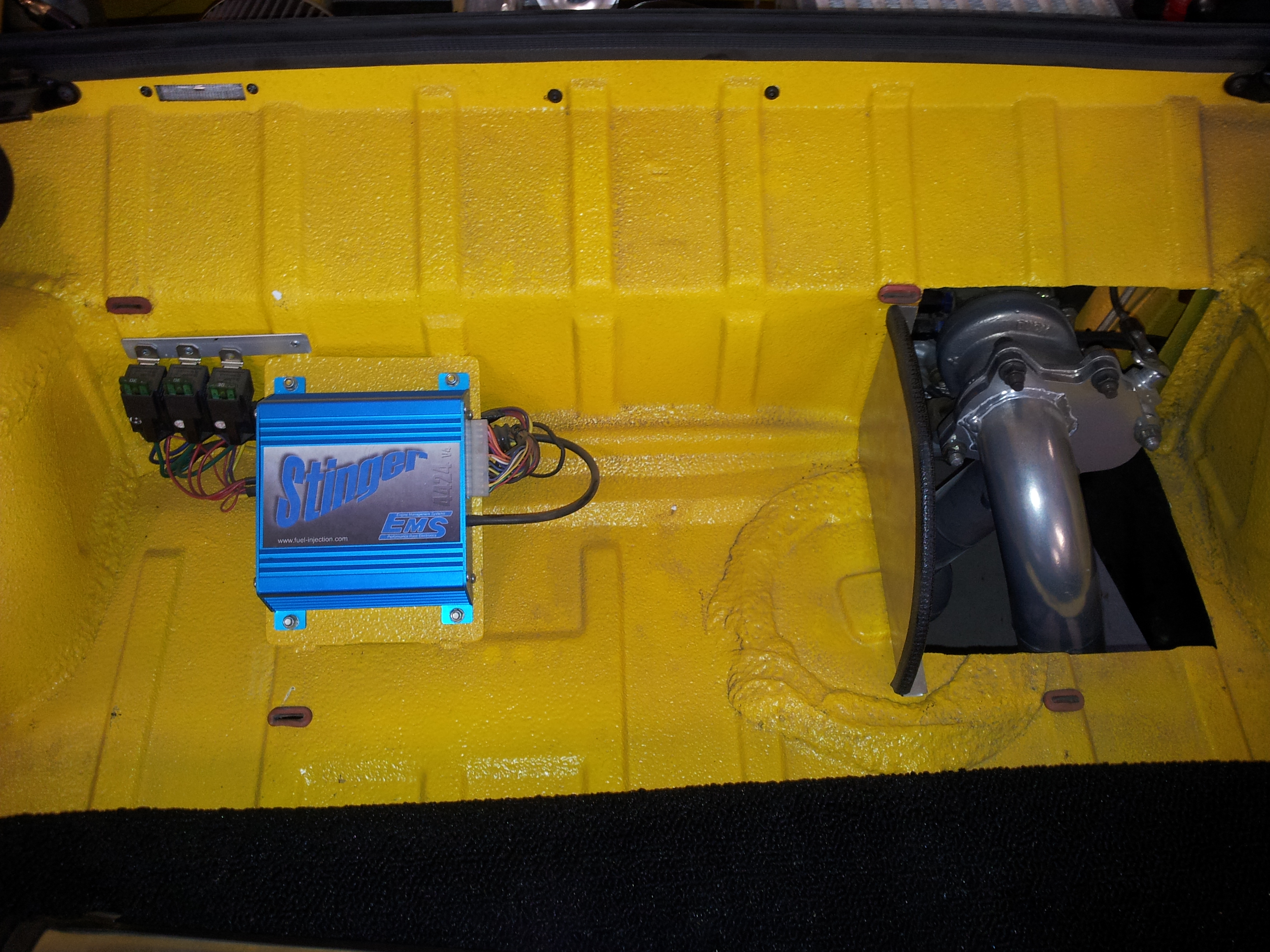

Manifold getting cleaned up with the water cross over a.n fitting installed Attached Image

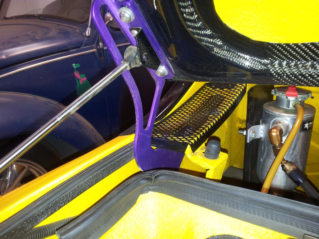

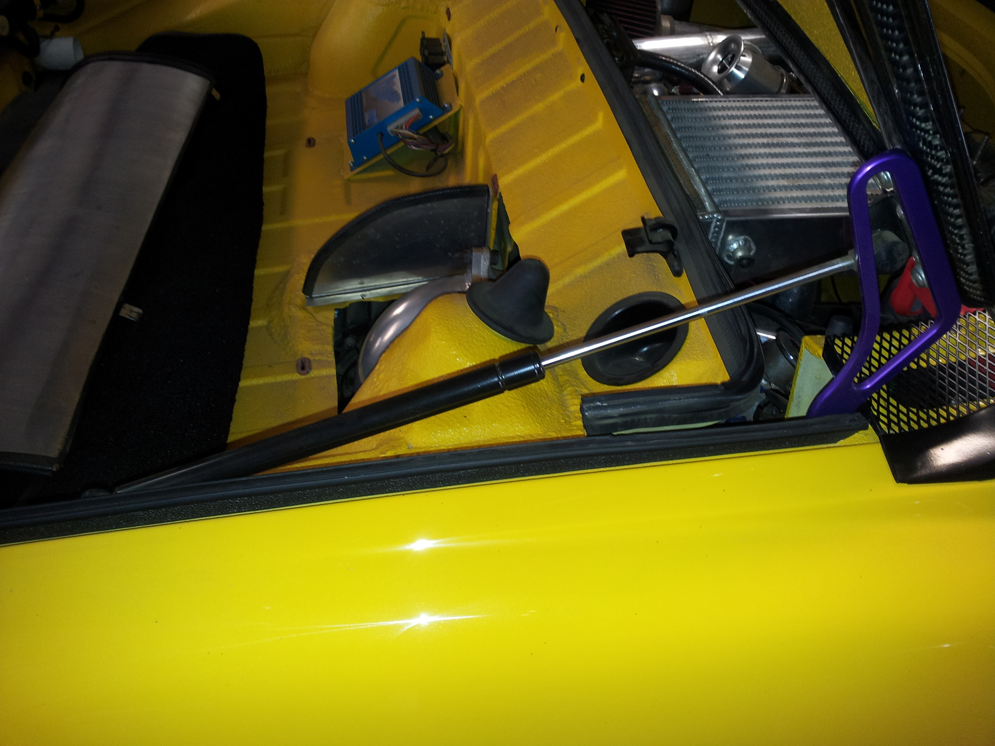

Some more of the yellow carAttached Image

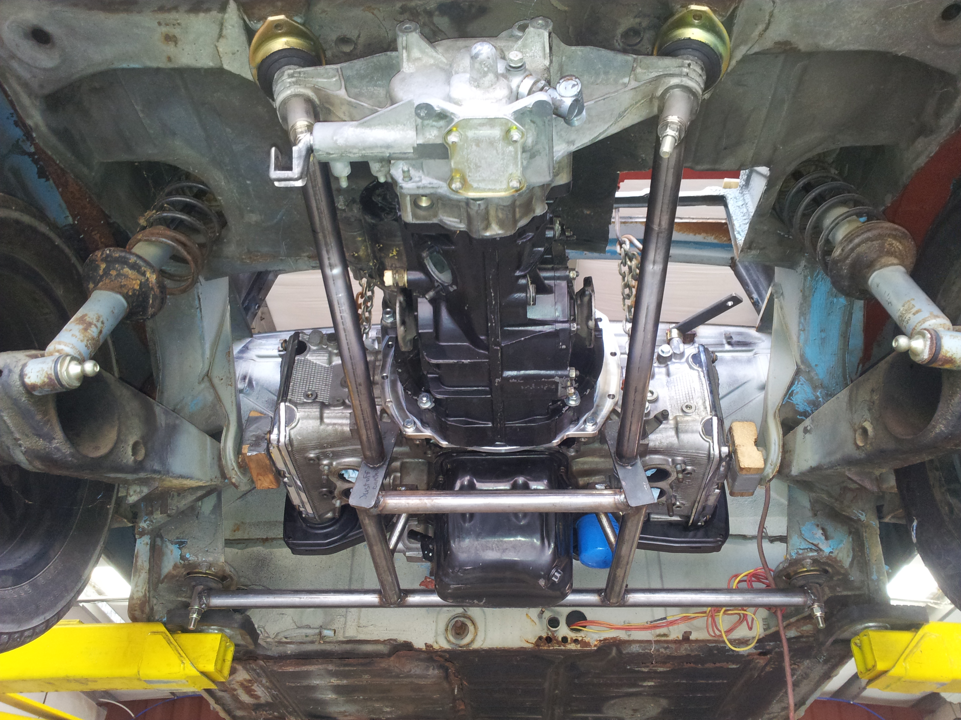

Attached Image bottom of different car with cage

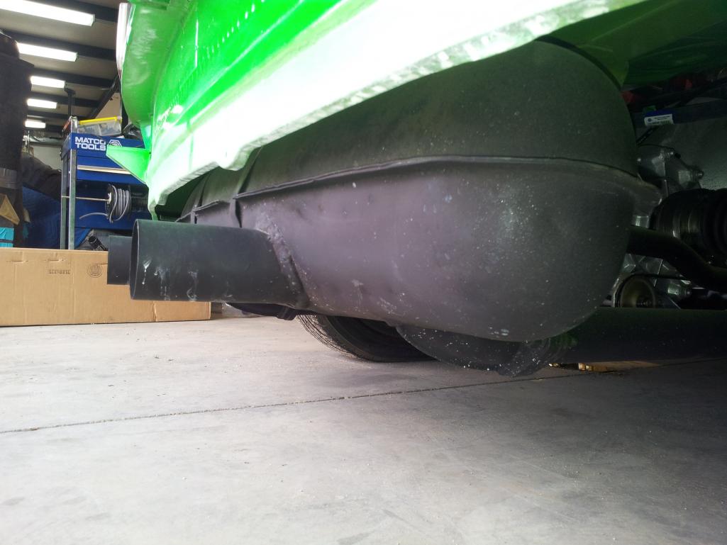

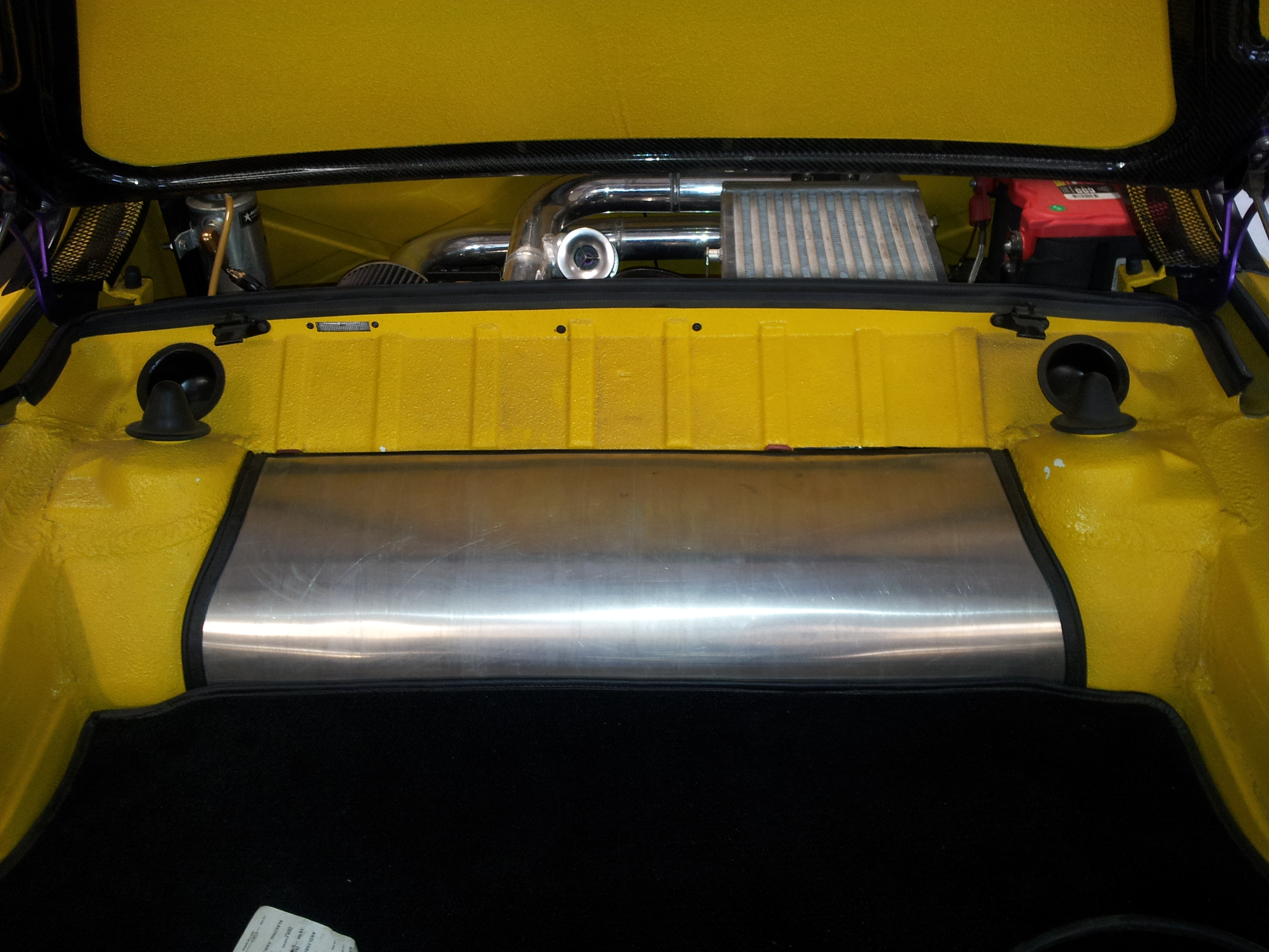

Green one with 911 exhaust Attached Image

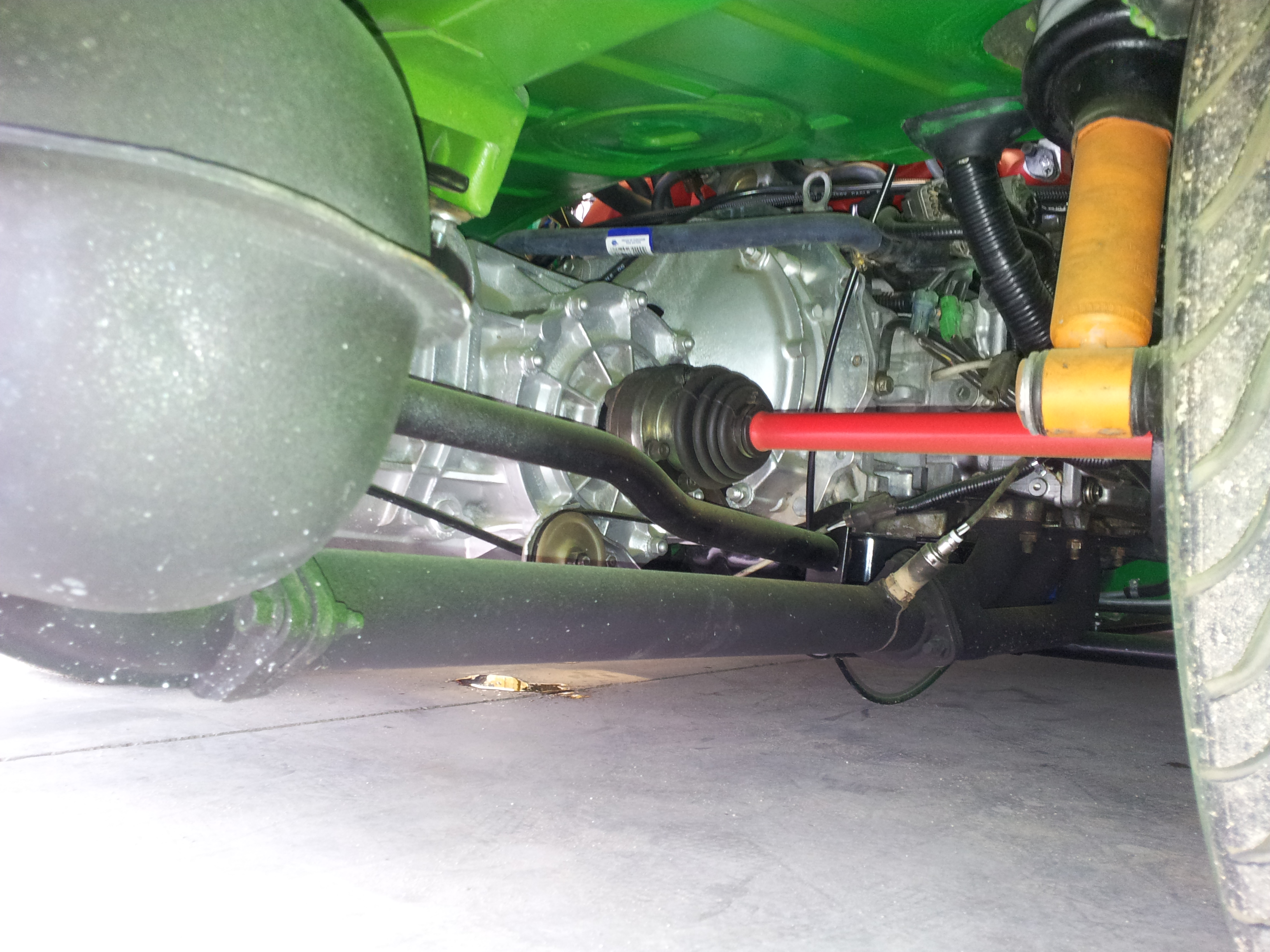

Attached Image under the green one

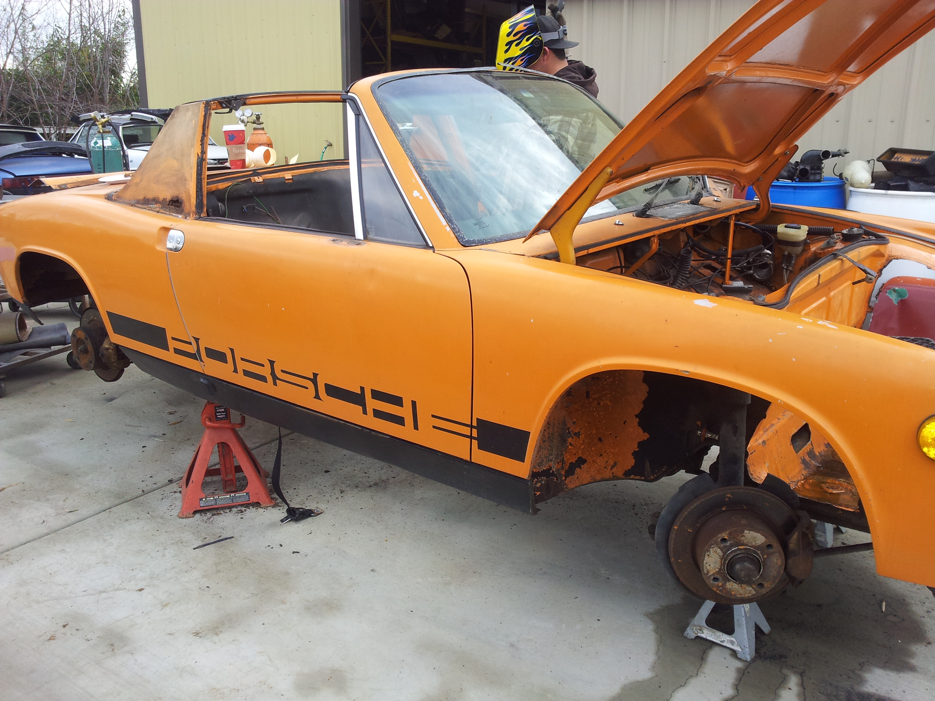

An orange one getting some body work done to the sailAttached Image

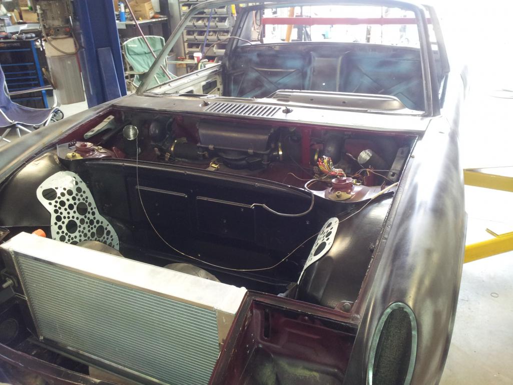

ruby914
post Dec 29 2012, 01:12 AM
Post #56
Posts: 720
Joined: 26-April 09
From: Hawthorne, Ca
Member No.: 10,305
Porscharu73,
I am cleaning up some of my work under the front hood. My air exhaust port is a lot smaller than in your photos but as I recall this is a stress point that tends to crack.
My plan is to weld a doubler plate on the inner wheel well wall. With an opening that large you may want to do the same.
I remember a discussion on this with photos but I could not find it.
I would like to see the cracks again so I can properly place the doubler.
Maybe some of your readers have a link or photos? (IMG:style_emoticons/default/popcorn[1].gif)
I should add, this cover with the holes looks very nice. If it is only pop riveted on, I don't think it adds any structural integrity to the body. The rivet holes may even be where a crack originates from. Now, if it fastened to a reinforced inner wall the plate may help reduce flex and stress.

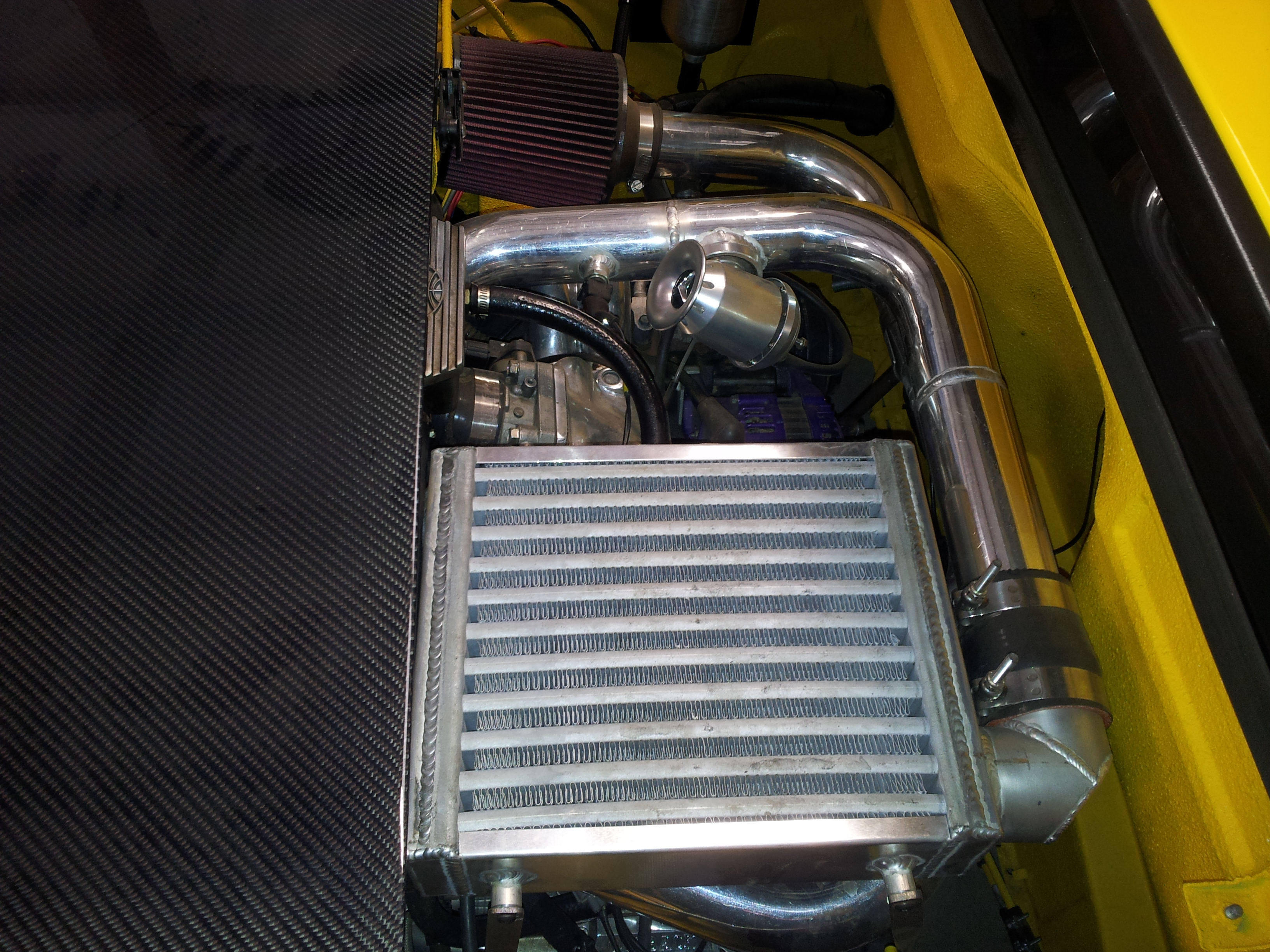

QUOTE(Porscharu73 @ Dec 28 2012, 03:06 PM) *
Do you have the spec's/make & model# of the radiator/fan combo in this post?

when your shop decides to offer up their services, they can then post a thread in the members vendor section, until then, this is a progress thread in my book.
1- all cuts in sheet metal should have rounded corners, not 90 degrees corners.
2- radiator should be mounted with rubber isolators to car.
