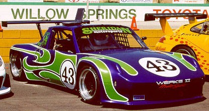

what speeds will you be traveling with the fd3s (btw, I don't know what that is and have dialup at home here, so won't be googling until tomorrow (IMG:http://www.914world.com/bbs2/html/emoticons/dry.gif) ) I ask because big wings = drag and if you aren't really cranking the mph, the wing hurts you, doesn't help you.
Some guys with Pcars have put wings on the back and it actually slowed their lap times because they didn't have the HP to pull that thing through with wind as easily (even 6cyl 911s) and didn't have enough top speed to take real advantage. Someone actually just posted that exact thing happening to them on either this forum or the bird board racing forum.
I was rolling 125-ish through turn 8 at Big Willow in 3rd gear and not really sure if a wing would've made a big difference at that speed (since that car was holding on no problem anyway and I don't have a wing yet). However, I am hoping to get more like 150-160mph thru there like the car I posted does, and Roger assured me I need the wing to pull that off.
That said, many of the Pcars that run Willow run about 120-130/135mph thru T8 (and click off very respectable lap times). Just a warning.
I saw an RX like yours last week on the freeway and had put a big wing on it, but the uprights were welded straight to the rear lid and pointed up 90deg to the lid, so the wing was actually angled with the car - both trying to stop the car and lift the backend off the ground - rolling 70 on the 91 freeway. I had my camera with me and tried to get it out and get a shot, but he thought he was Joe racer and was cutting in and outta traffic, so when I was almost caught up to him, my exchange was upon me. I REALLY wanted that photo...
Chassis shops and paint shops are notorious for taking forever. Trust me, there are days like yesterday where I drove all the way over there to see five tubes welded into place - so that takes 3 days. But then apparently someone puts some dust in his weed and 3 days later the whole rearend is in the car. Relative to other shops though, he is a bullet train, he is a pretty smart dude, and his welding is unreal.

sort of a combination of both I guess. Roger's car was like 1800-1850lbs with 350HP, so good power to weight. He is "flat out" through t8, which with the gearing he had in the car, put him between 150-160mph by his calculation. He warned me that he has been off t8 six times though. (IMG:http://www.914world.com/bbs2/html/emoticons/unsure.gif) I dunno if I like the idea of an occassional off track excursion at 150mph. One time a wind gust blew him off the track.
Willow has two pretty long stretches, the longest really being turn 8 if you have about three things working for you
1 - you have the huevos to take the ridge up and outta turn 7 at some good speed to go into turn 8 because there is a bit of a "whoopty do" there that can get the car off the ground if not careful. Last time out I hit it pretty hard when Jack Olsen (911 guy pretty well known on the bird board) was following me and I saw him get out of it because I bet he thought I had lost it - the car shifted what felt like a foot straight left.
2 - the car can hang on through the slight bend. This is where the combo of the Hoosiers I have with the addition of a rear wing to plant the back of the car down will help me
3 - you have enough brake to deep into turn 9 but get slowed down enough to make it through t9.
The straight is good for some high speeds as well between t9 and t1 because t1 isn't as brutal as t9, so you can carry higher speed through it. A lot of guys with decently prepared 914s with built 4s or decent 6s tend to not like the big track as much because they are just flat out and cruising T8 and the straight, so not as much fun as a smaller track where they aren't "kicking back" at 125 waiting for the next good turn.
Another reason for the wing on my car is that many cars get light on the front end at high speed. 914s like to get light on the rear, and down the front stretch the time I went up around 140mph the car was feeling really twitchy.
And now that I see your car full size - the car that had the funky wing I mentioned before was an earlier version of the RX7.

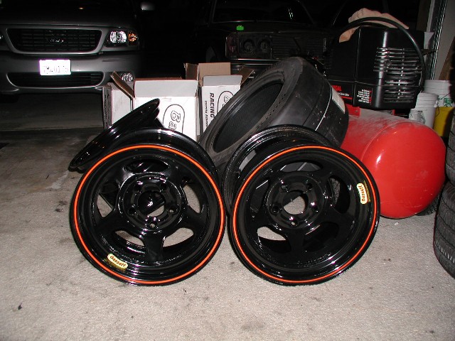

please allow myself to touch.. myself. Got the wheels in from UPS yesterday. As far as the tires, UPS must have a monkey for my delivery guy. Got one tire from Hoosier on Tuesday, box 2 of 2. Hmmm, wonder where 1 of 2 is?? Oh, apparently he/she didn't like the label (IMG:http://www.914world.com/bbs2/html/emoticons/confused24.gif) , so it wasn't delivered and went back. Some sort of UPS scam to charge Hoosier a few extra bucks to "read" the label. Anyway, talk to UPS Tues night and everything is fine and will be delivered on Wed. So I get home, no tire, but 4 wheels. Call UPS - driver couldn't deliver because I was "closed". My house now has business hours apparently. The UPS operator had no clue wtf was going on as the package is clearly a residential package, he dropped the other one the day before, so forth. And why the hell would he drop 4 wheels, but not the tire? EEEdiot, gawd (my best attempt at Nap Dyno) (IMG:http://www.914world.com/bbs2/html/emoticons/headbang.gif)
I just can't figure out why it has to be so difficult (IMG:http://www.914world.com/bbs2/html/emoticons/WTF.gif) Hopefully the tire gets dropped today so I can mount and balance the rear for AJ to start fitting to the car on Friday.

wonder if the 10" rears will be wide enough (IMG:http://www.914world.com/bbs2/html/emoticons/idea.gif)
(IMG:http://www.914world.com/bbs2/html/emoticons/laugh.gif)
