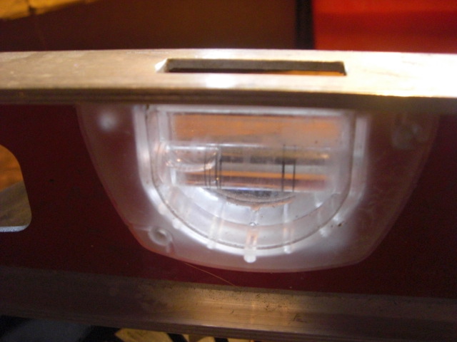

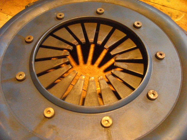

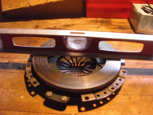

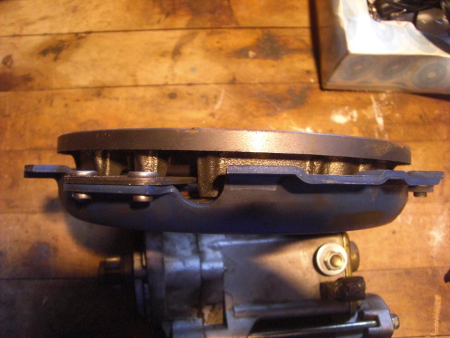

Just gave in and pulled the trans after taking some of the turbo stuff off. Exhaust stayed on, but just didn't the weight of the trans on the kerry hunter system thats in there. On a stock exhaust you'd have support at both sides from both HE's, but, well, it just looked a little scary. But not as scary as the pressure plate.
What?!?!?!?!
Called the mfg, PP has been sent back to them. Can't have 1500 miles on this. Can't imagine I didn't see this when it was installed. Can't imagine what broke to cause this condition. Soooo slipping clutch due to whacked PP, not contaminated or grenaded clutch disc.
Results and costs following the teardown of the PP will determine the scope of the "while I'm in there" part of the project. Being still sub-optimally employed, (no job) what little $$$ I have hidden away had to go a bit farther than when the black ops fund was receiving bi-weekly assistance...
Anyone with thoughts on this?
And- the clutch disc I pulled out was a factory 6 spring. I had another factory 6 spring NIB that I pulled out to compare to the one that was in service. They were pretty identical, except that the center, splined section was maybe 1/4" longer on the NIB clutch disc. Both are Sachs. Any problem using either disc in the car?
Cupomeat
post May 29 2012, 02:55 PM
missing my NY 914 in VA
Posts: 1,349
Joined: 26-November 07
From: Oakton VA
Member No.: 8,376
THat is VERY unusual.
Perhaps one side of the diaphragm has cracked/broken causing the uneven pressure across the wear surface.
I've never seen one like that, but it has to fail somehow.
As for the 1/4" deeper hub on the disk. Not sure it should matter but I don't know which is original length, the current (and the other is 1/4" shorter) or the other way around.
Get a measurement and we could tell you which is stock length.
Eitherway, mostly likely you'd be fine as there is a fair amount of room in there. You just wouldn't want the splines ending and the disk being pushed backward by the input shaft toward the pressure plate.
Interesting failure, thanks for sharing.

How is your flywheel?
Looks like the throwout bearing was pressing off center but I can't know who caused what first. Was the bearing properly installed?
Anyway, I would double check the bearing as they are not build to sustain lateral forces and it may have some heay wear now.

Hows THIS for customer service...
On Jun 4, 2012, at 9:37 AM, brett baltau wrote:
The clutch had a broken diaphragm. Not sure of the cause of it braking. It has been fixed and sent back out to you already at no charge.
Brett
