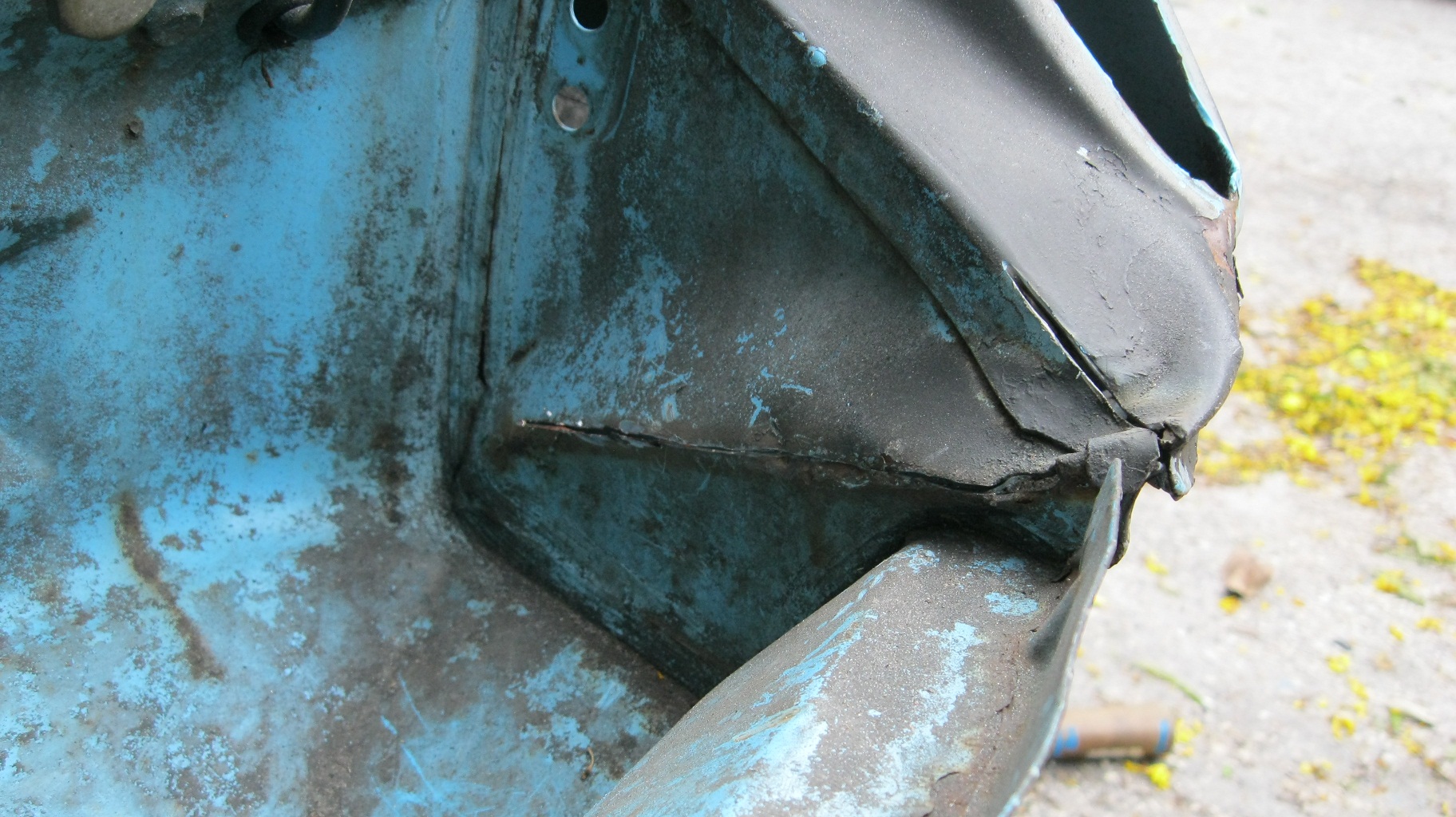

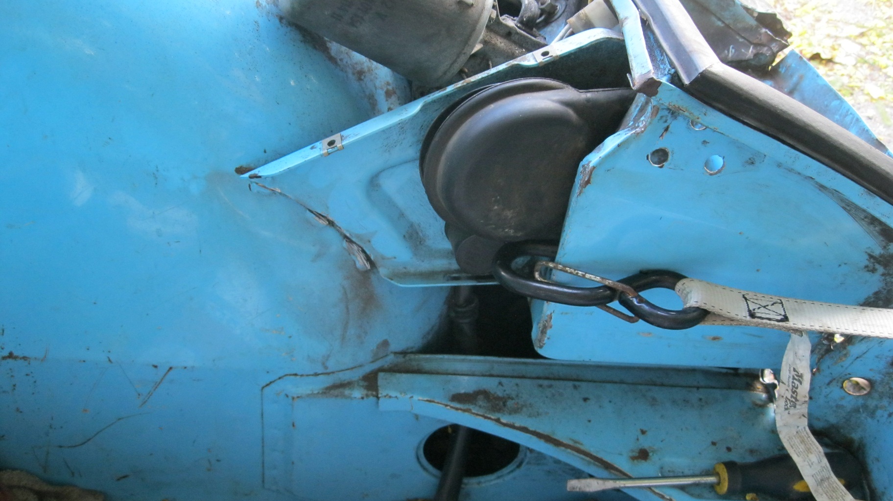

Then I "relieved" the metal by cutting it along the creases.
Then cut the three welds holding the bucket support bracket to the fender. I then let the redneck in me out and hooked up a ratchet strap to the bucket. Next, rolled the car backwards in neutral a few times, and checked the distance from the bucket to the bulkhead using the passenger side measurements as a reference. Finally, once I was satisfied, that was all welded back up. Fast forward to last week, and this is what it looks like with a little filler. |

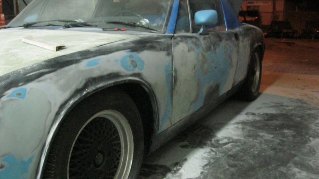

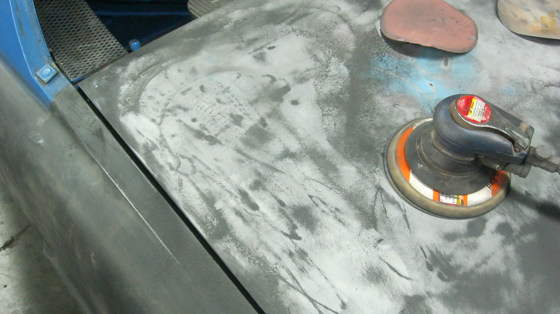

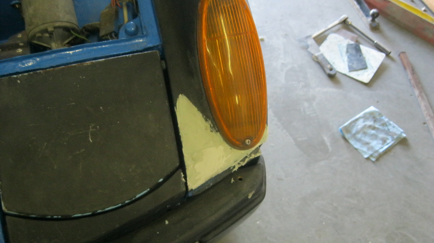

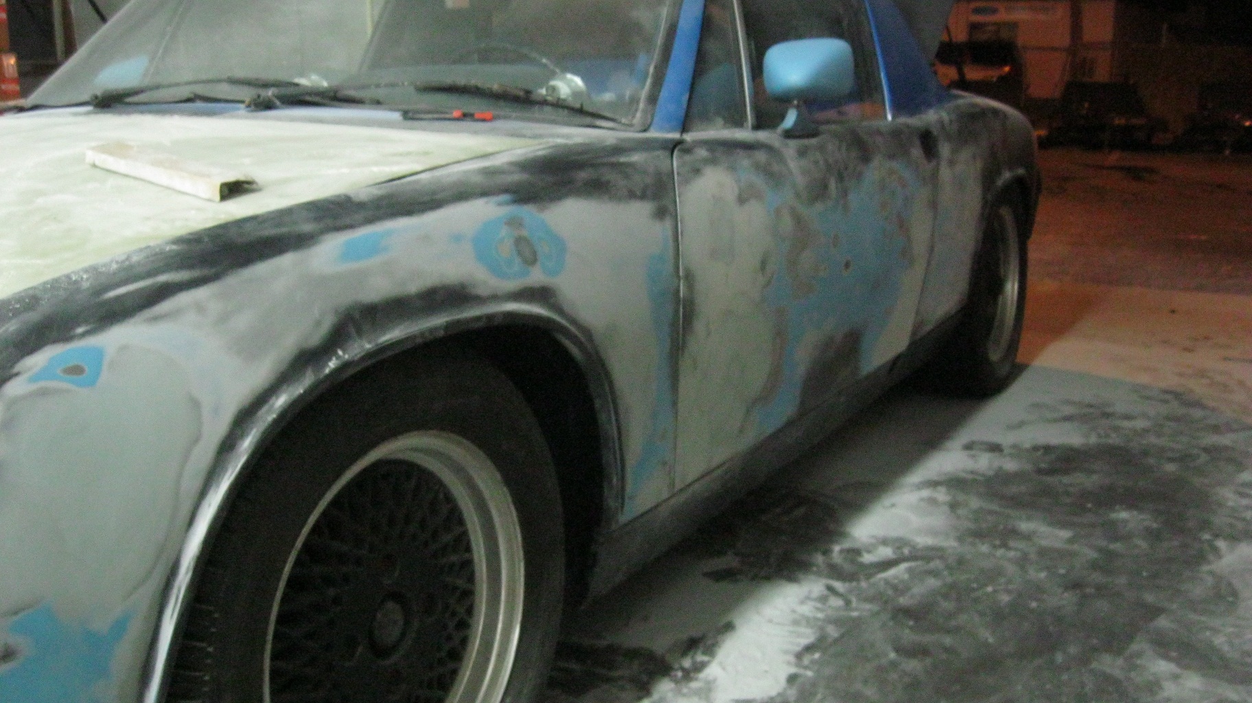

More filler. Trust me, it looks like a lot more than it really is. I pulled and dollied out as much as I could before starting. Also, if no rust was present, I chose to scuff the surface lightly prior to adding filler. I personally don't believe in stripping it down to bare metal before filling, as the paint is one more barrier to prevent rust. If you were doing a concours car, obviously it would be a different story and you probably wouldn't consider filler in the first place. For me, no big deal (IMG:style_emoticons/default/smile.gif)
Now here is the frustrating part. See all those black swirlies? It appears as though someone at some point let a five year old loose on this car with a dremel or something along those lines. They were ALL over the car. None that I observed went through the sealer or first coat, but most were through the second paint job layer. I only discovered this when I started to DA/block the car. From what I understand, this would usually mean taking the whole car down to at least the first coat. Since I don't have the time, resources or a dedicated shop, I can't strip the whole thing down. So instead, I decided to block it as best I could so that the primer coats I would lay wouldn't have so many steep "valleys" to fill. Perhaps Scotty B or Rick can chime in here, but I'm keeping my fingers crossed that once I block the primer I won't see these valleys in the final coat. And that brings me to last weekend, where I shot a coat of urethane primer/sealer. I will block this coat and then possibly shoot another before color. Traditionally a great paint job gets at at least 3 of these before color, from what I understand. But for a Chumpcar/daily driver, I think I've probably already done far more than was really necessary. The best part was that my fiance said, "Okay, so I just want to say, you did a great job. A year ago, I never thought you'd get this far. I'm proud of you." .... I guess I can keep her (IMG:style_emoticons/default/smile.gif) Wait till it gets color - she might even ride in it then! (IMG:style_emoticons/default/laugh.gif) |

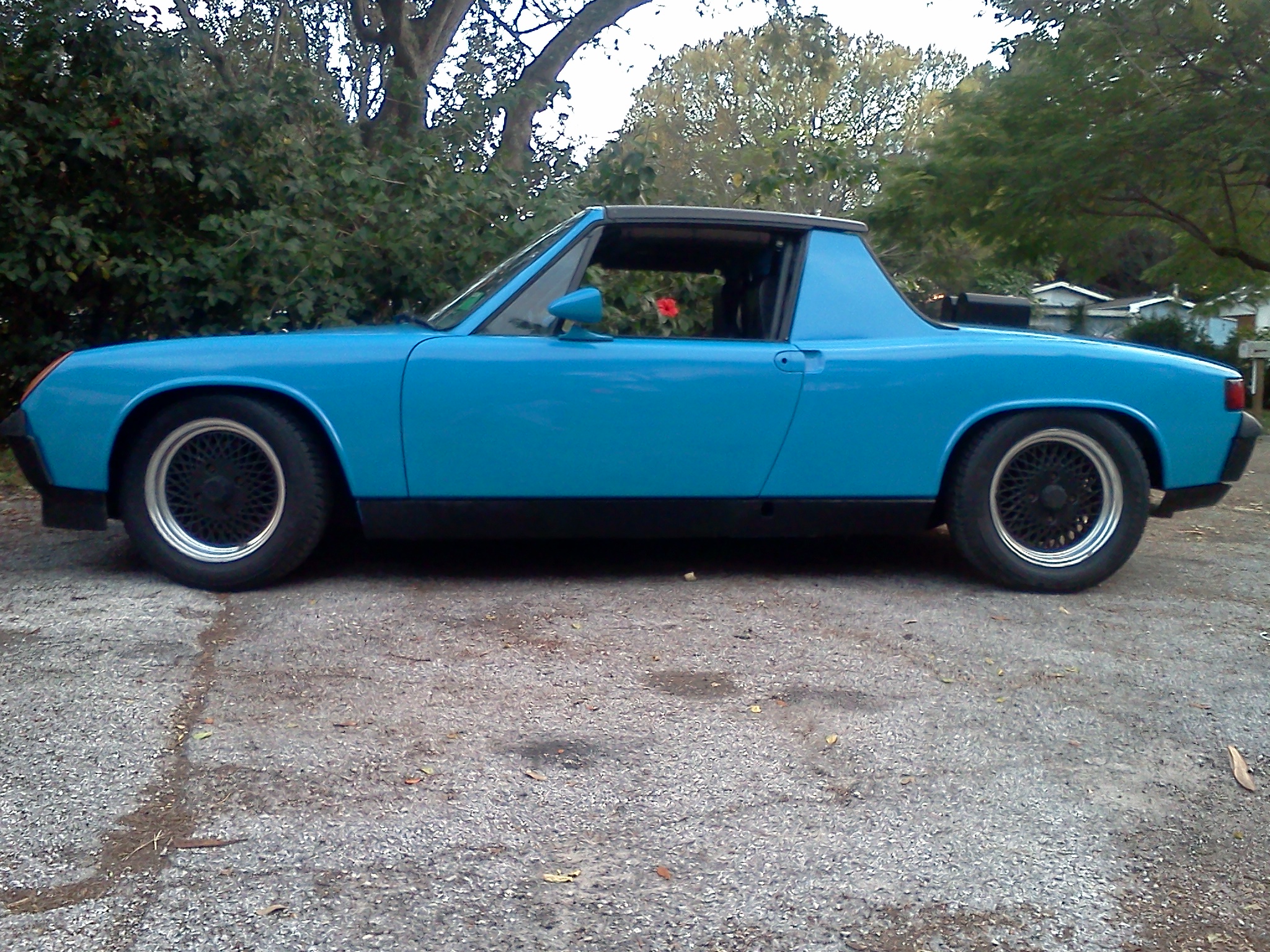

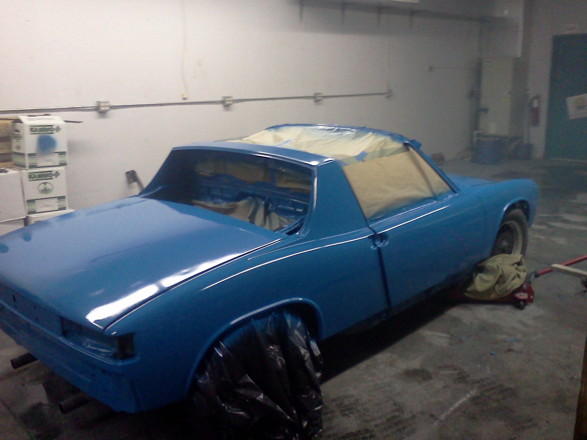

Crappy pic, and not quite the paint job I had hoped for, but it'll do for now. Need to color sand and possibly repaint the hood after it dries over the next month. I was wearing gloves and didn't know my hands were sweating inside. Needless to say there is a spot where sweat dripped onto the paint where I had just gone over. Oh well, looks better than it did.

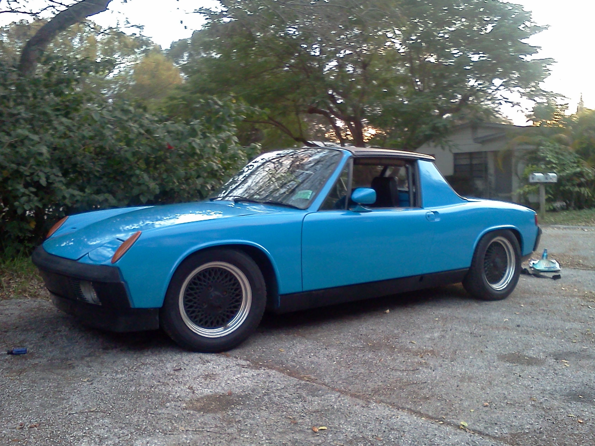

First time seeing your build thread, George. Nothing short of awesome! (IMG:style_emoticons/default/thumb3d.gif) Anything else transpired in the past month? (IMG:style_emoticons/default/popcorn[1].gif) Thanks Mark (IMG:style_emoticons/default/smile.gif) Yeah, I've been piecing things back on it for the past few weeks and removing others to repaint or replace. I mocked up the cage so I could get measurements and soon I'll start wiring it for a cutoff switch, etc. Still have a small hesitation under heavy throttle transition, but I think that can be solved with bigger idle jets. John (FourBlades), my new teammate (IMG:style_emoticons/default/biggrin.gif) has agreed to loan me some so I can troubleshoot. Here is the most recent picture. Would never have gotten this far without everyone else's help and inspiration. Thanks again! Attached thumbnail(s) |
