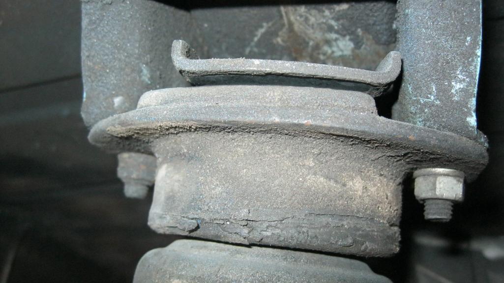

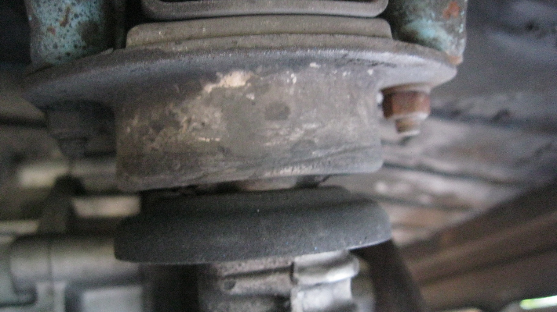

While I'm at it though, can anyone take a look at these pics and tell me what you see? The first two are of the transmission mounts, first just hanging and the next with me pushing up on the tail. I see a large gap at the top and obvious movement. I'm really just trying to determine if the mounts are bad or whether I have them installed wrong somehow. The last pic is of the passenger side trailing arm bushing. I have been getting some real clunks from the right rear of the car when going over bumps, and I think this is a dead giveaway that the bushings are bad - I'm assuming the pivot shaft is moving up and down in the console. Can you confirm this from the picture? Thanks again everyone! Attached thumbnail(s) |

George, I have the fix for that as well - I have a couple of pairs of WEVO Tranny Mounts in my Tool Box

nice TC. i fear an epic failure with the mounts you're running with george. when one of them goes south it won't be in the garage.
