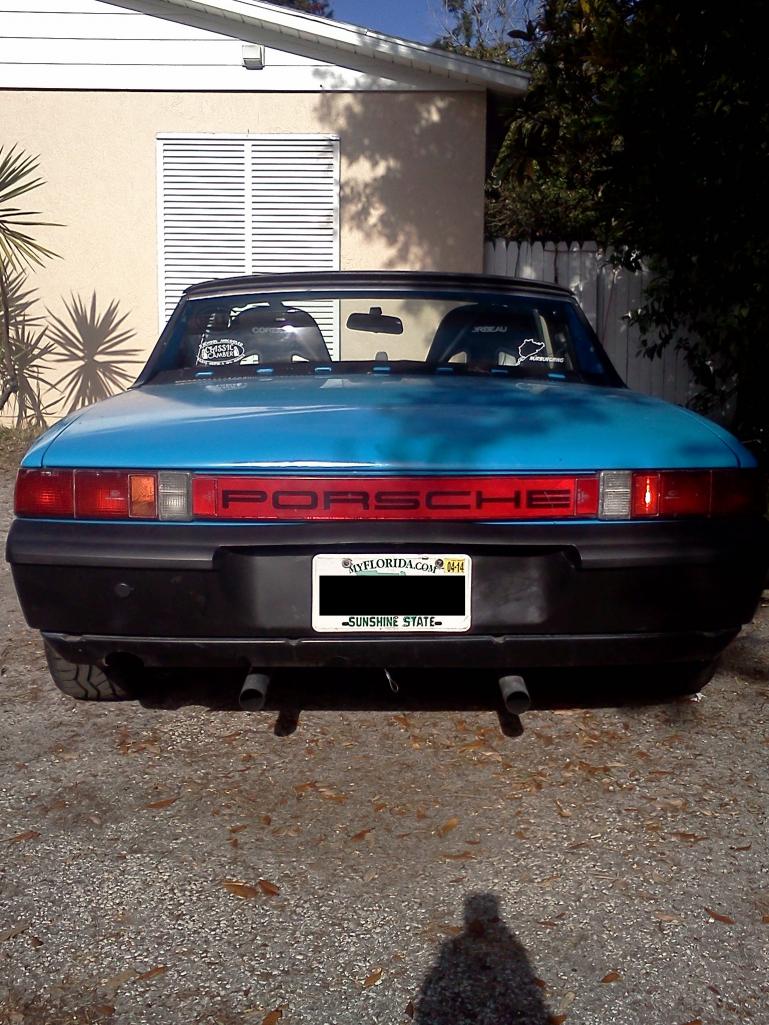

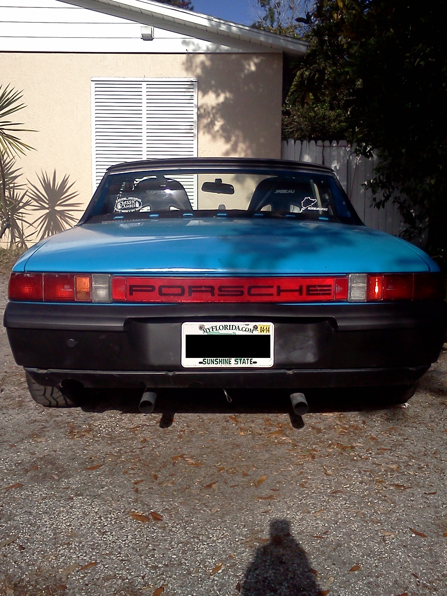

A couple pics of the rear of the car, as requested by Eric.

Good thing you blacked out your plate. Someone may want to track you down and steal that thing. (IMG:style_emoticons/default/sad.gif)

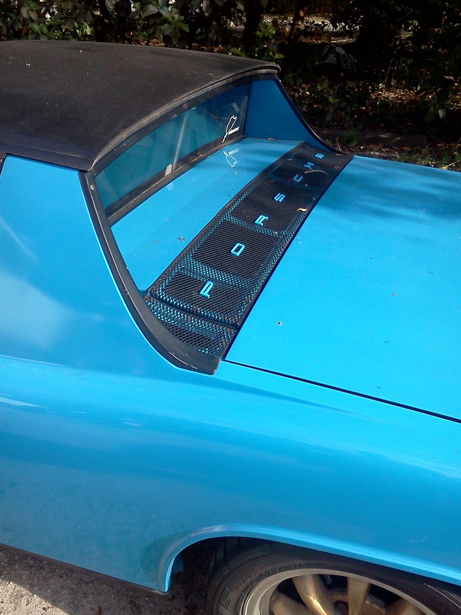

A couple pics of the rear of the car, as requested by Eric. What paint did you use on your sail trim. Mike It needs to be redone. Initially I scuffed up the trim, then used self etching primer and top-coated with the crappy Duplicolor stuff from Autobone. It's too soft and doesn't bond well enough with the aluminum so it's got some chips. After doing some more research and listening to Scotty b, I used the SEM Trim Black on the window trim, with much better results. This stuff is a little more expensive, at $15 for a can, but you need to do is clean and scuff the aluminum and spray. Much better bond and it's designed for this usage. Find it at most paint stores - I bought mine from my local NAPA paint store. |

I like how you painted you PORSCHE letters to match your car! Looking Good!
