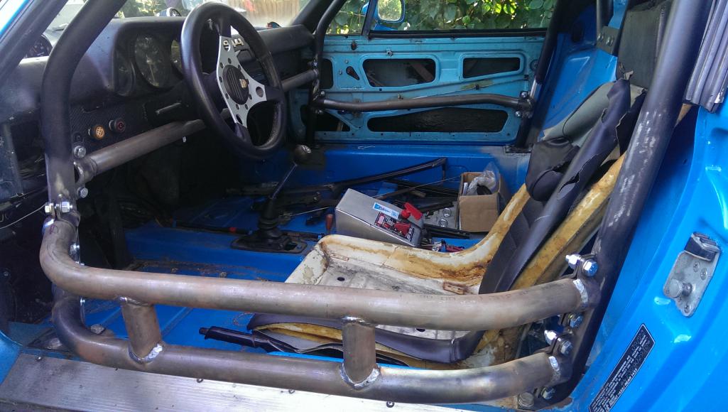

Door bars in and cage complete, finally!

QUOTE(ThePaintedMan @ Jan 13 2014, 08:43 AM) *
Looking good. (IMG:style_emoticons/default/piratenanner.gif)

Thanks Shane. As I mentioned to you, not quite Tangering Racing quality, and if I had it to do over again, I probably would have just purchased Chris's product. But it will be nice to remove the cage to R&R things if need be.

Looks like it turned out pretty nice. Are you planning on paint or powder coating to prevent too much rust?
