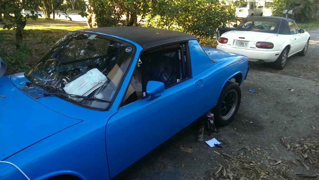

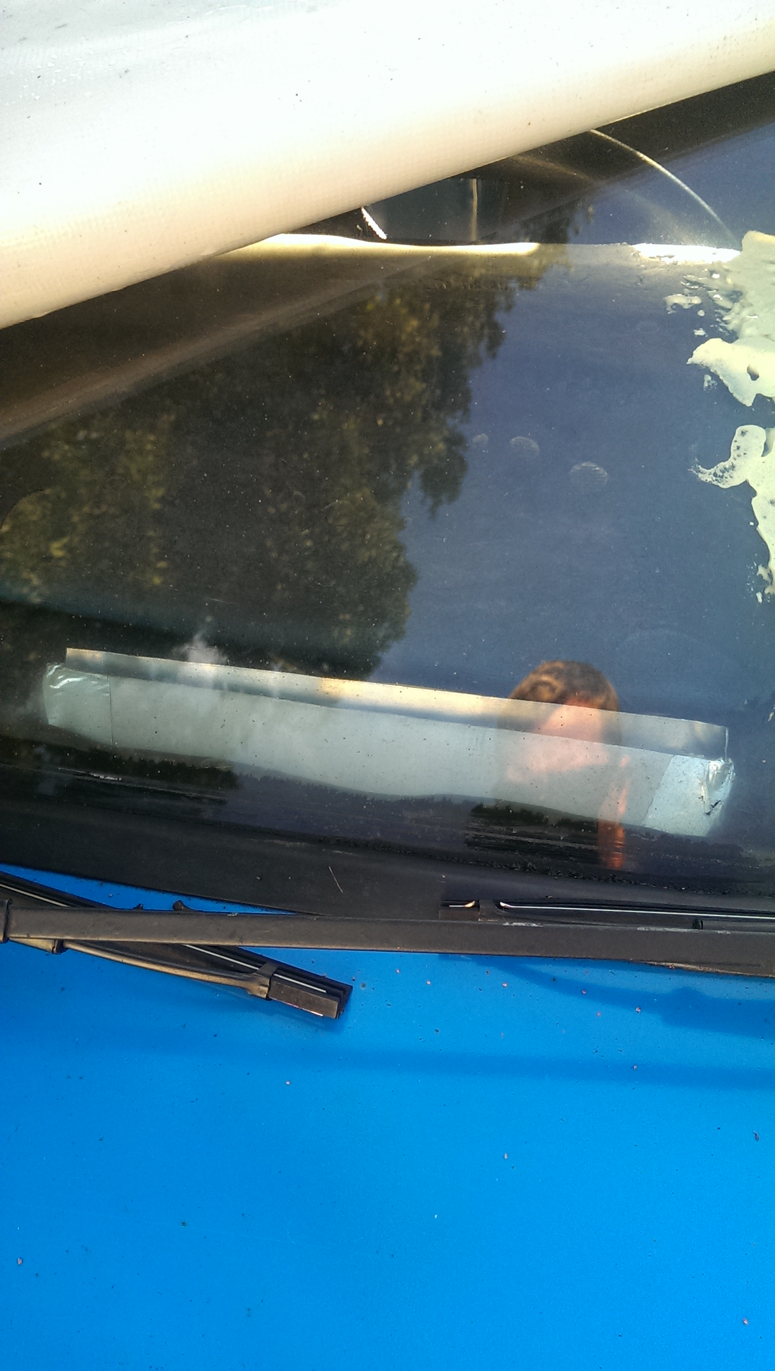

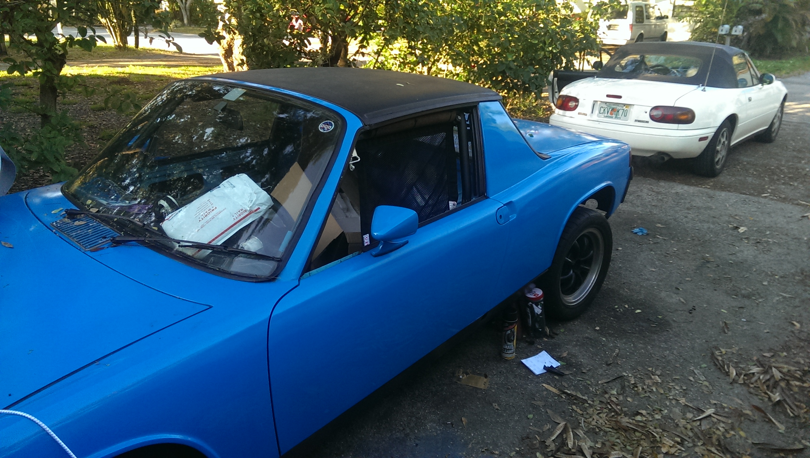

Latest project. Came out pretty good and took very little effort/time... which is rare for most of my projects.

Did you use plexiglass? How did you cut it?
ThePaintedMan
post Jan 15 2014, 09:46 AM
Post #288
Posts: 3,887
Joined: 6-September 11
From: St. Petersburg, FL
Member No.: 13,527
I believe it's 1/4 inch acrylic. It's what I had sitting here at the time (not even sure where I got it.) I cut it with a Dremel and a little saw blade attachment I got at Harbor Freight. Ideally, I think the best way to cut it is with a band saw. I have some leftover if you want to experiment Chad.

Sounds good, I am tired of worrying about water leaking in there

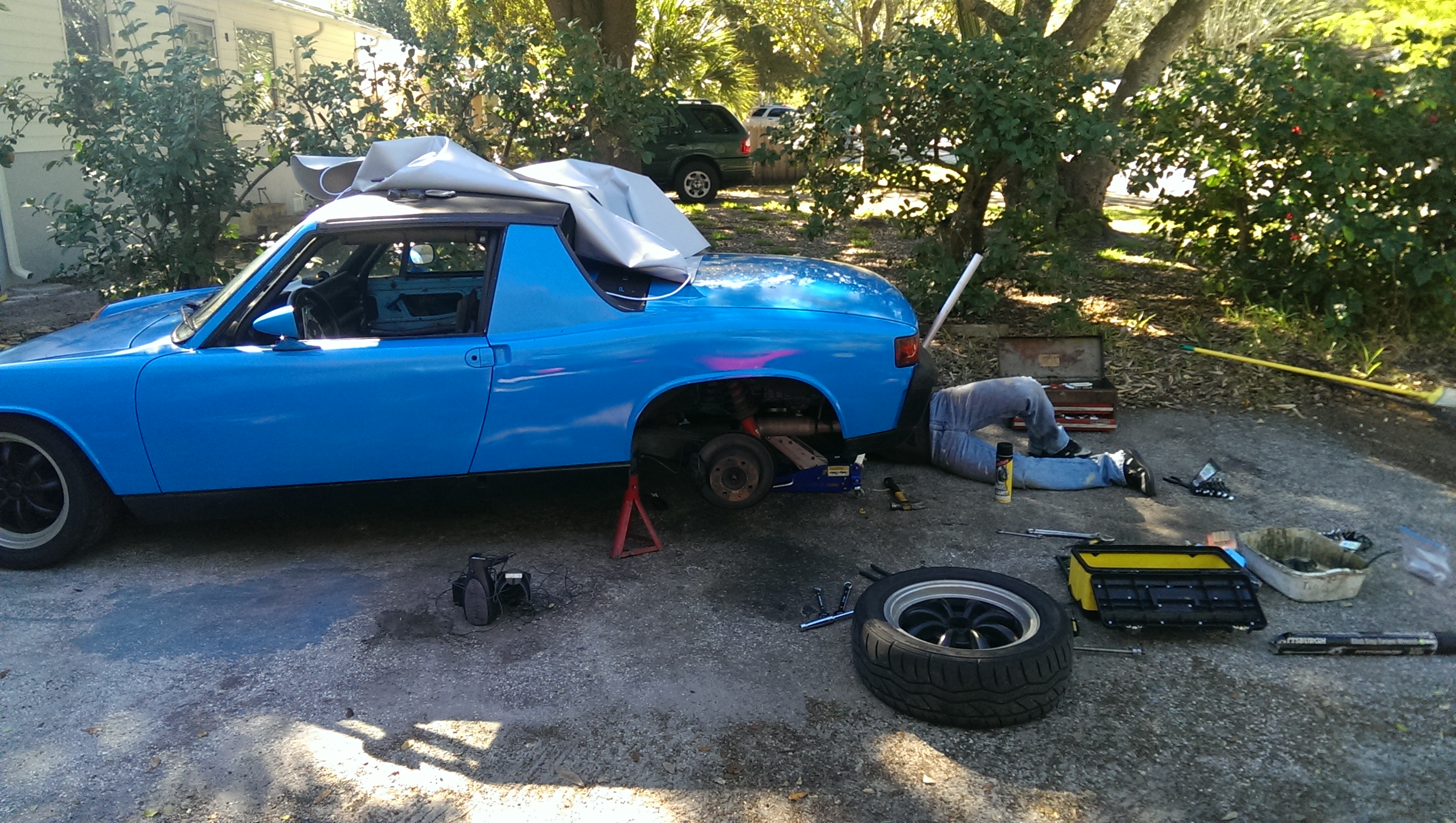

Chad stopped by on Saturday morning to help me drop the transmission and replace the throwout bearing and wheel bearing. The man is a beast! He had it out in 30 minutes and still had a good attitude despite having a radiator hose blow off of his V8 car on the way over (IMG:style_emoticons/default/smile.gif)

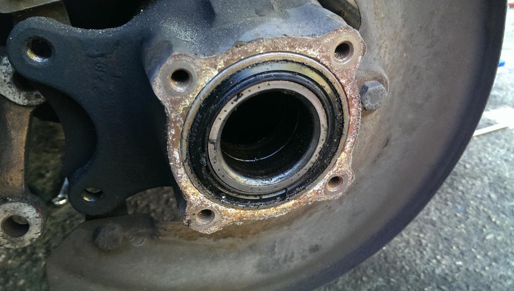

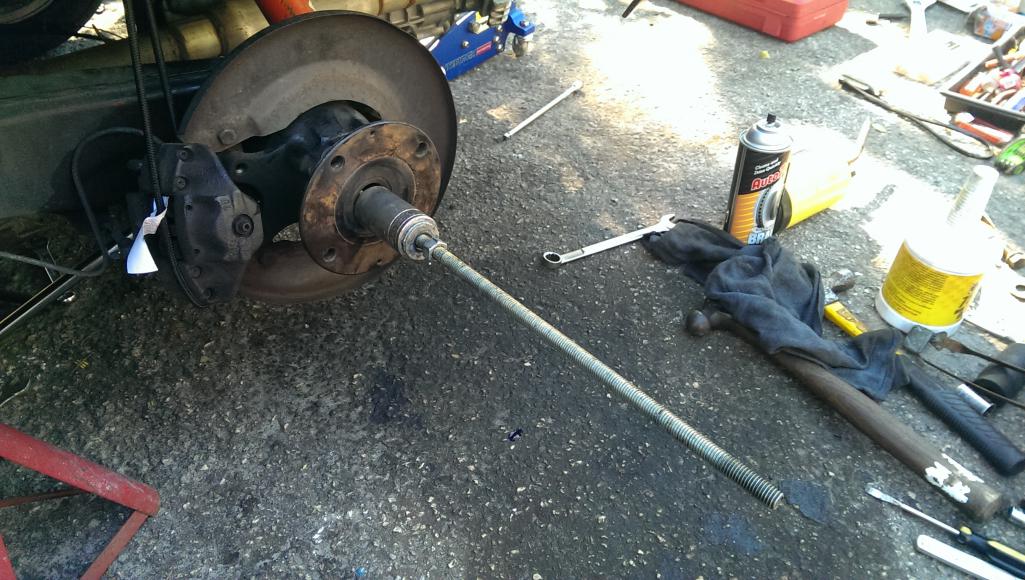

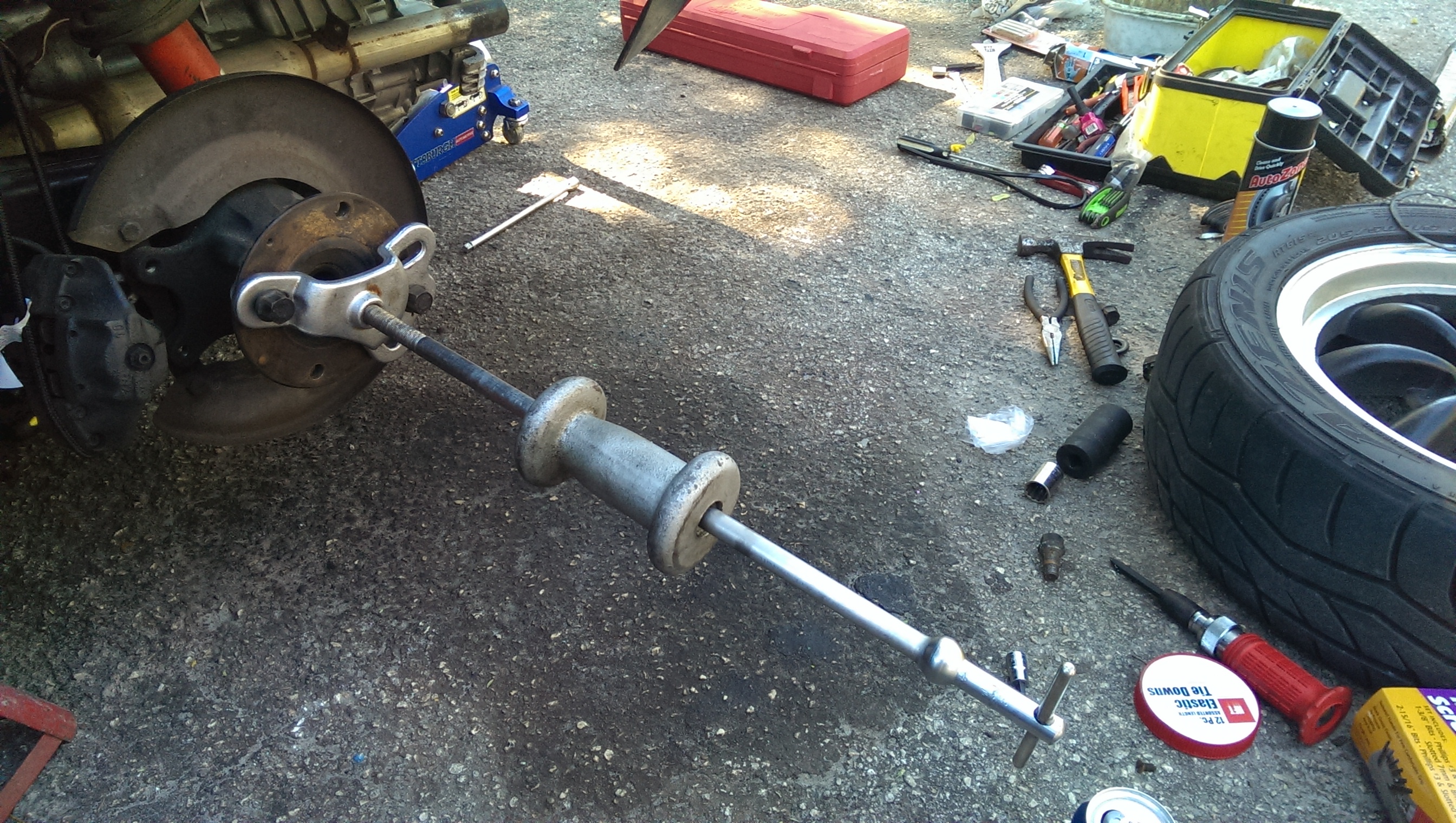

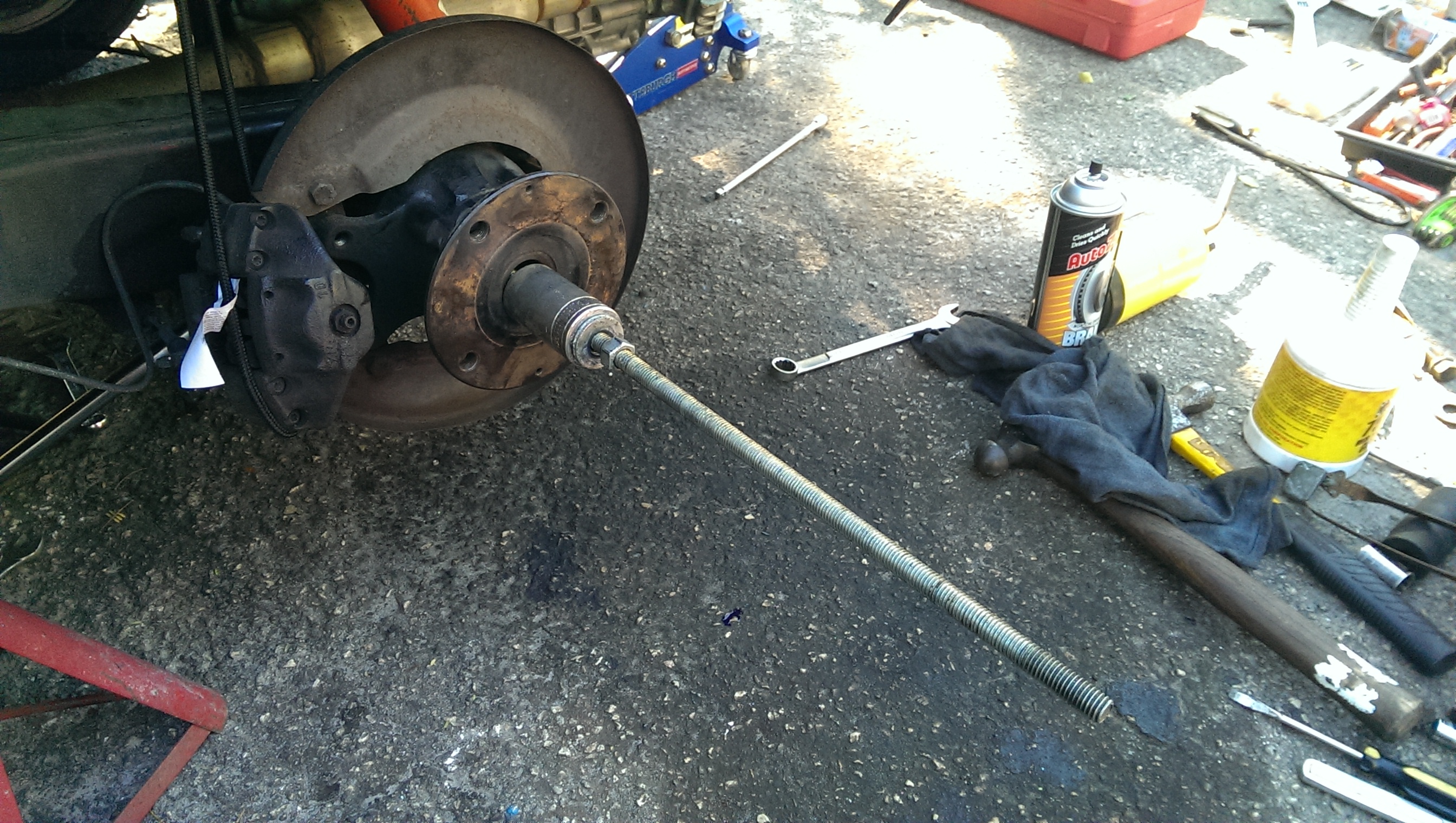

Chad had to run, but I was able to tackle the wheel bearing. Of course Eric Shea's beautiful press method is probably preferred, but I tackled it on the car since I've done it multiple times on Miatas and other vehicles. This allowed me to avoid re-aligning the car (at least for the time being) as well.

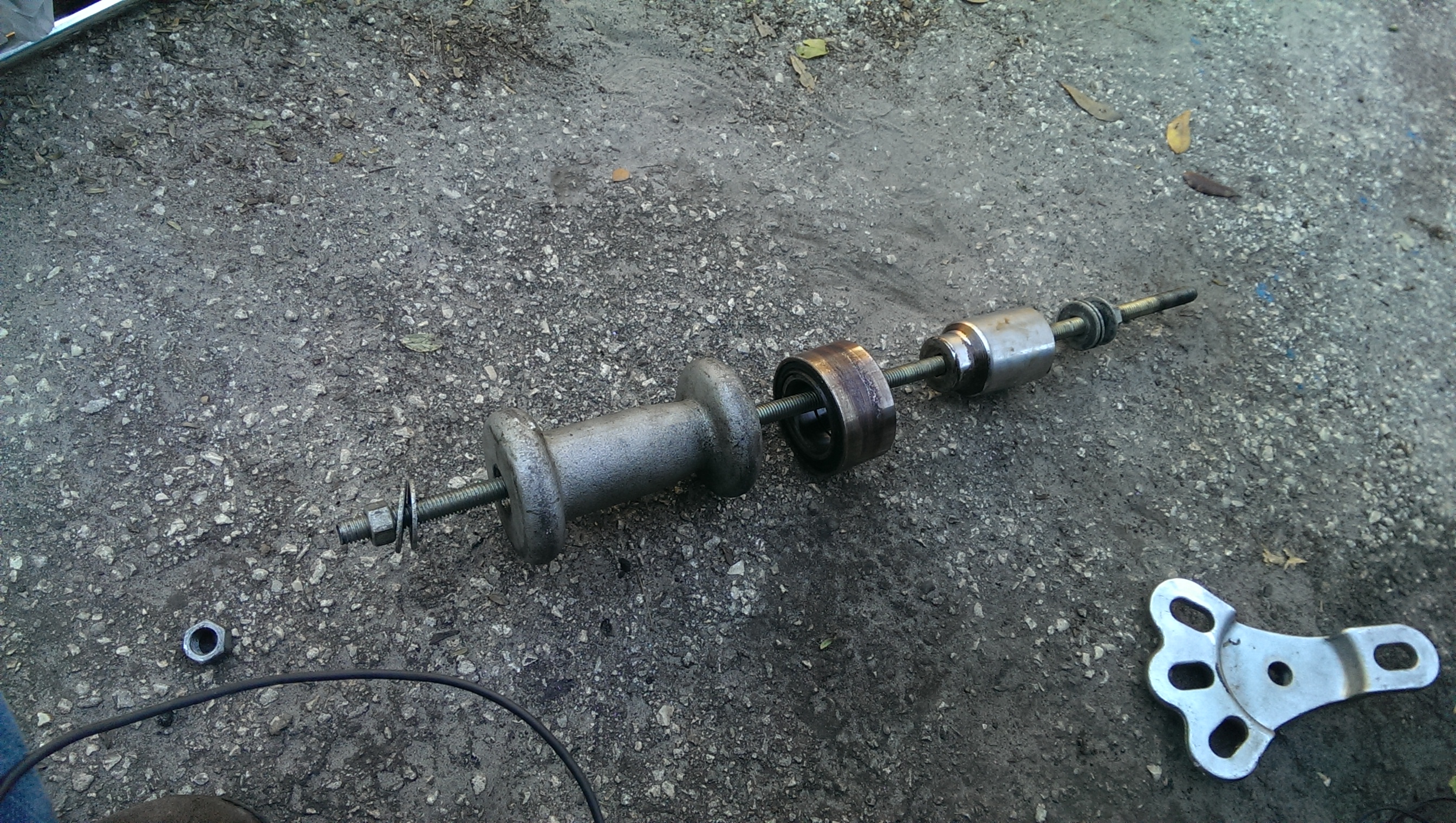

First, I removed the rear hub nut, wheel and caliper and used an impact screwdriver to remove the two screws retaining the rear disc to the hub. Then I borrowed a slide hammer (part #27033) and hub puller attachment (part #27032) from Autozone. This can all be seen below.

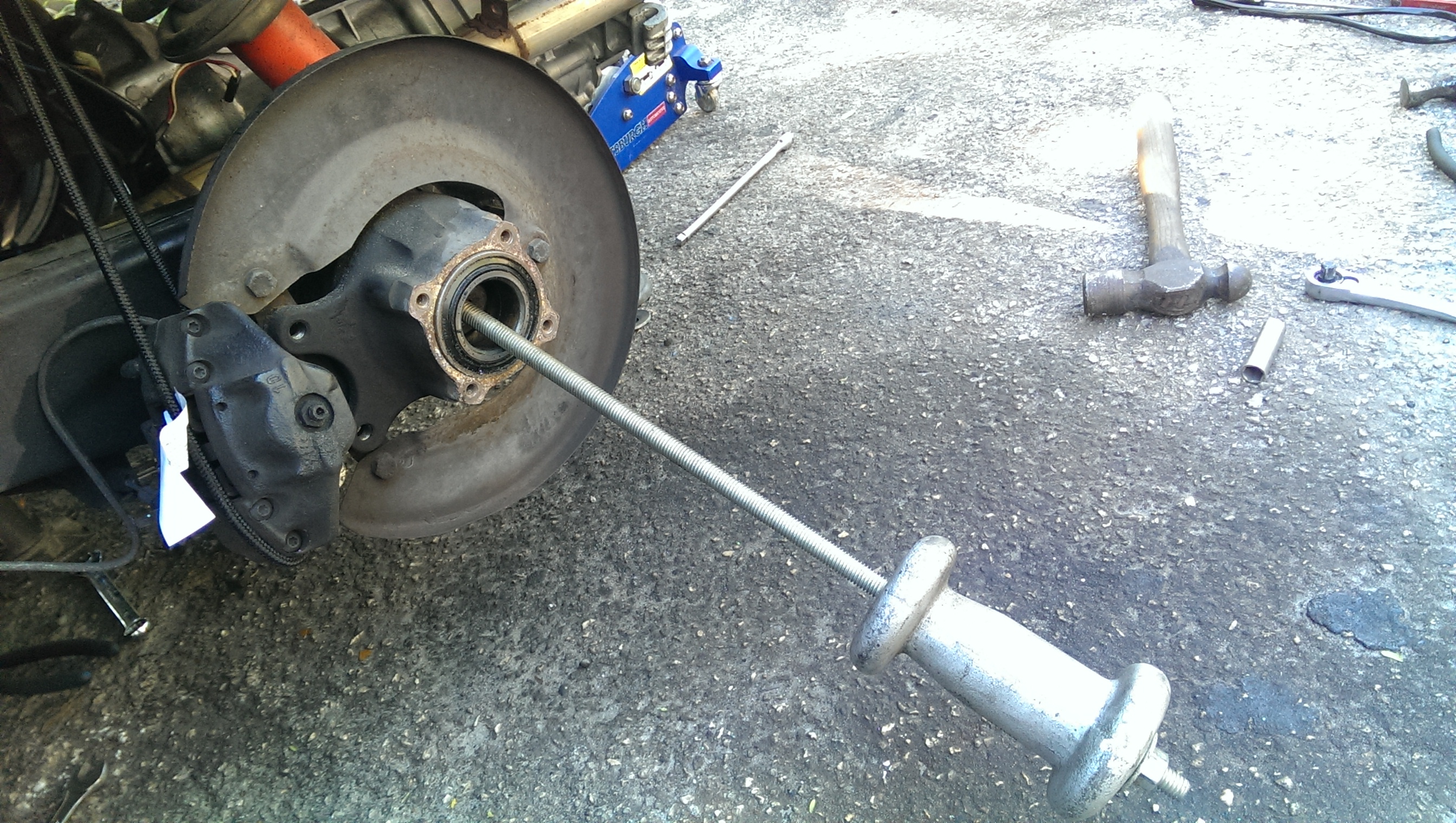

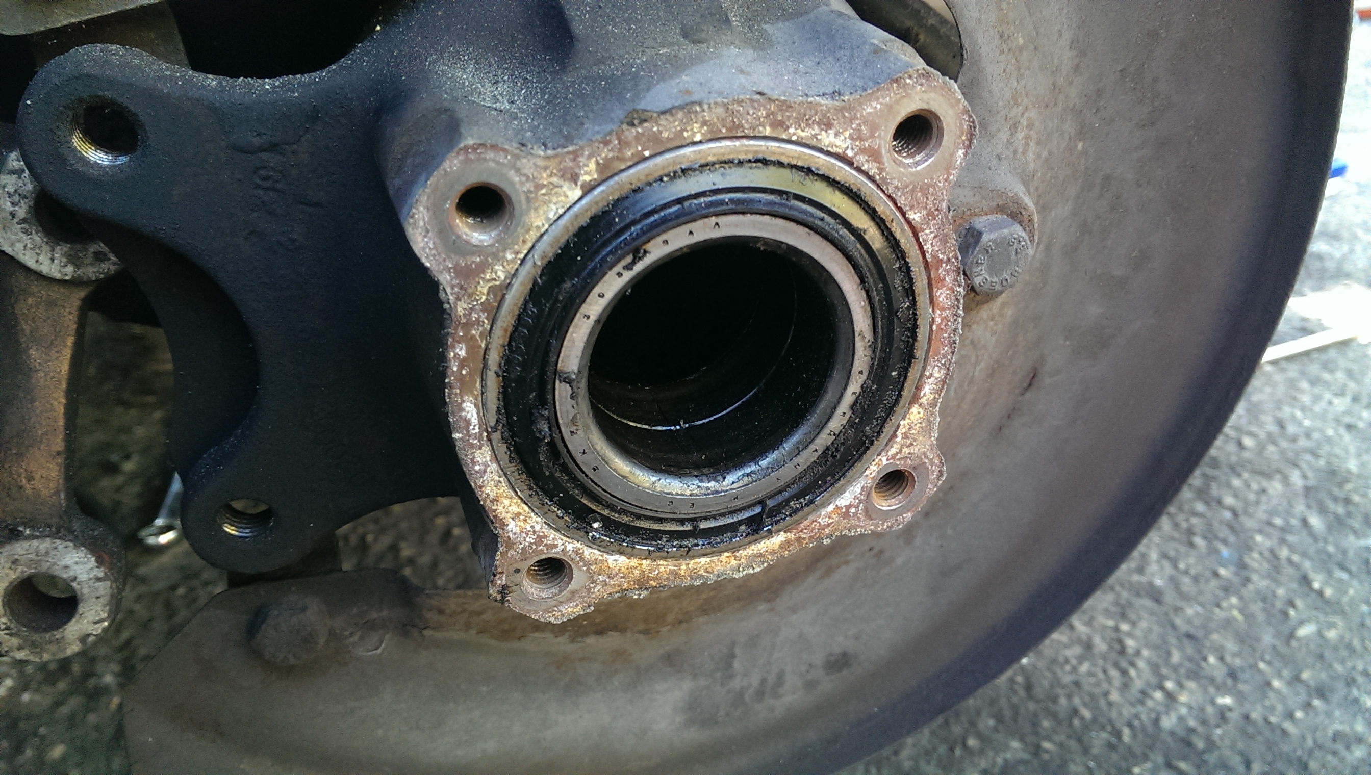

...Gave it a couple pops and it came right off, and even left the inner race inside the bearing, which is nice (often times you'll end up having to drive/split the race off of the hub).
The bearing had a decent amount of play in it, which explains the squealing. These are SKFs, and I believe them to be original to the car. Not bad to get 40 years out of one of these puppies. Notice that the outer seal is completely dried up and shrank from the outer race.
Next I removed the bearing retainer plate. While it is possible to drive the bearing out of the arm from the backside, there is limited space to work, so I put my threaded rod to use with a large socket behind the inner bearing race. I used the the weight portion of the slide hammer on the threaded rod to pull the bearing out.

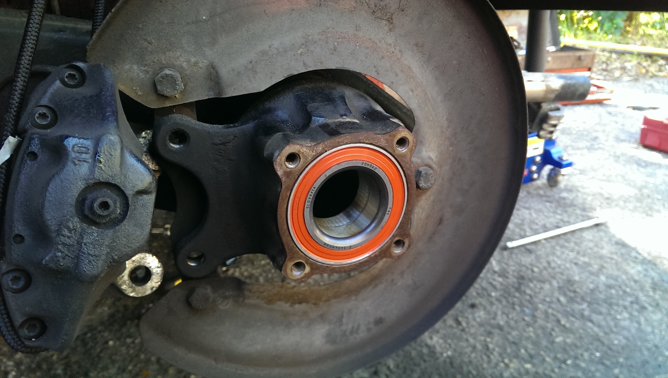

Here is the whole assembly out of the car.
Then, after freezing the new bearing for a few hours and heating up the trailing arm recess, I lightly began to tap it in. Once it was in fairly straight, I used the old bearing to drive it the rest of the way how. ONLY tap the outer race - do not touch the inner race or risk having to do this all over again in a short amount of time.

Then I used the threaded rod to pull the hub into the bearing. A little bit of leftover Redline rear end grease made this a piece of cake. (IMG:style_emoticons/default/beerchug.gif)
The rest is pretty boring (IMG:style_emoticons/default/smile.gif) Reassemble in reverse order and torque the rear hub nut to 180-250 ft lbs.

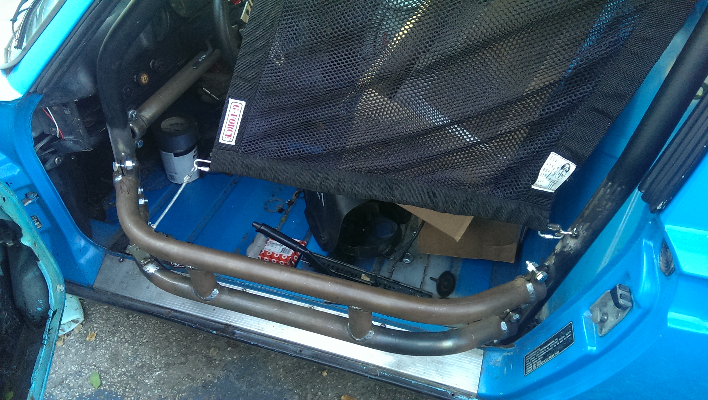

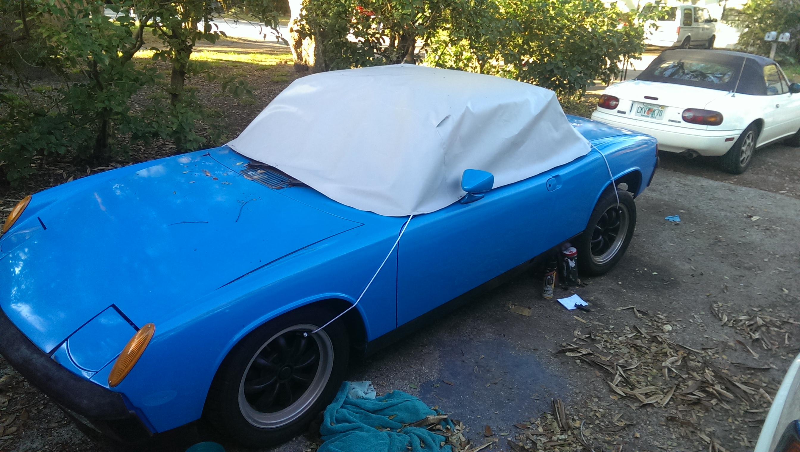

Window net in! A bit of a pain finding something that would attach the bottom to the door bars effectively and remain tight, but also be flexible enough to fall completely out of the way to allow ingress/egress. I ended up using a solid 5/16 steel bar with 3/32 vinyl coated cable.
A huge thanks to Perry Kiehl as well. Since the window had to be removed to fit the door bars, I had no way to keep water from getting inside. Perry rushed me out one of his GREAT umbrella covers, which makes rolling up the windows (or even having any) unnecessary now! (IMG:style_emoticons/default/piratenanner.gif)

Does it also cover the engine bay?
ThePaintedMan
post Jan 23 2014, 08:36 AM
Post #297
Posts: 3,887
Member No.: 13,527
QUOTE(Jetsetsurfshop @ Jan 23 2014, 08:36 AM) *
It sure does Shane. For anyone with carbs, this is a no brainer, but I think it's pretty much a prerequisite for any 914 anyways. Perry is a great guy and was super helpful.

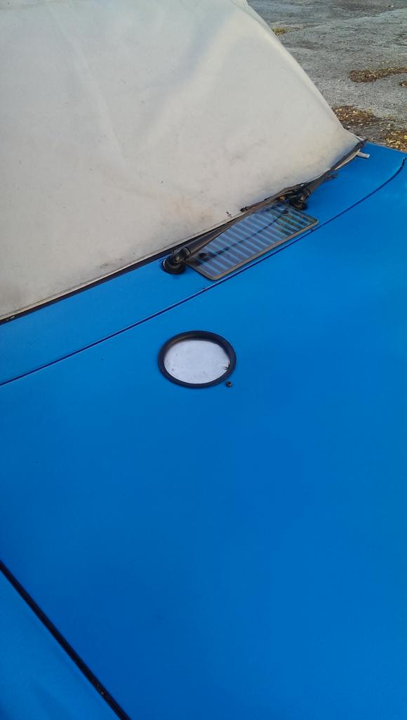

A couple more things I've been meaning to do for awhile.

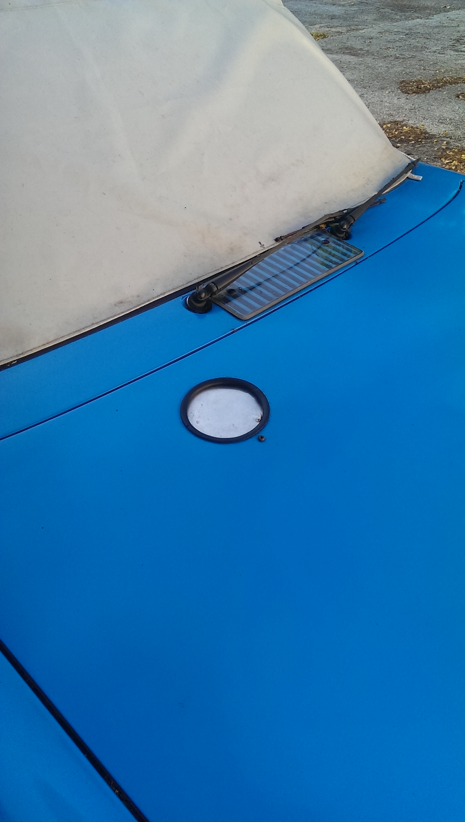

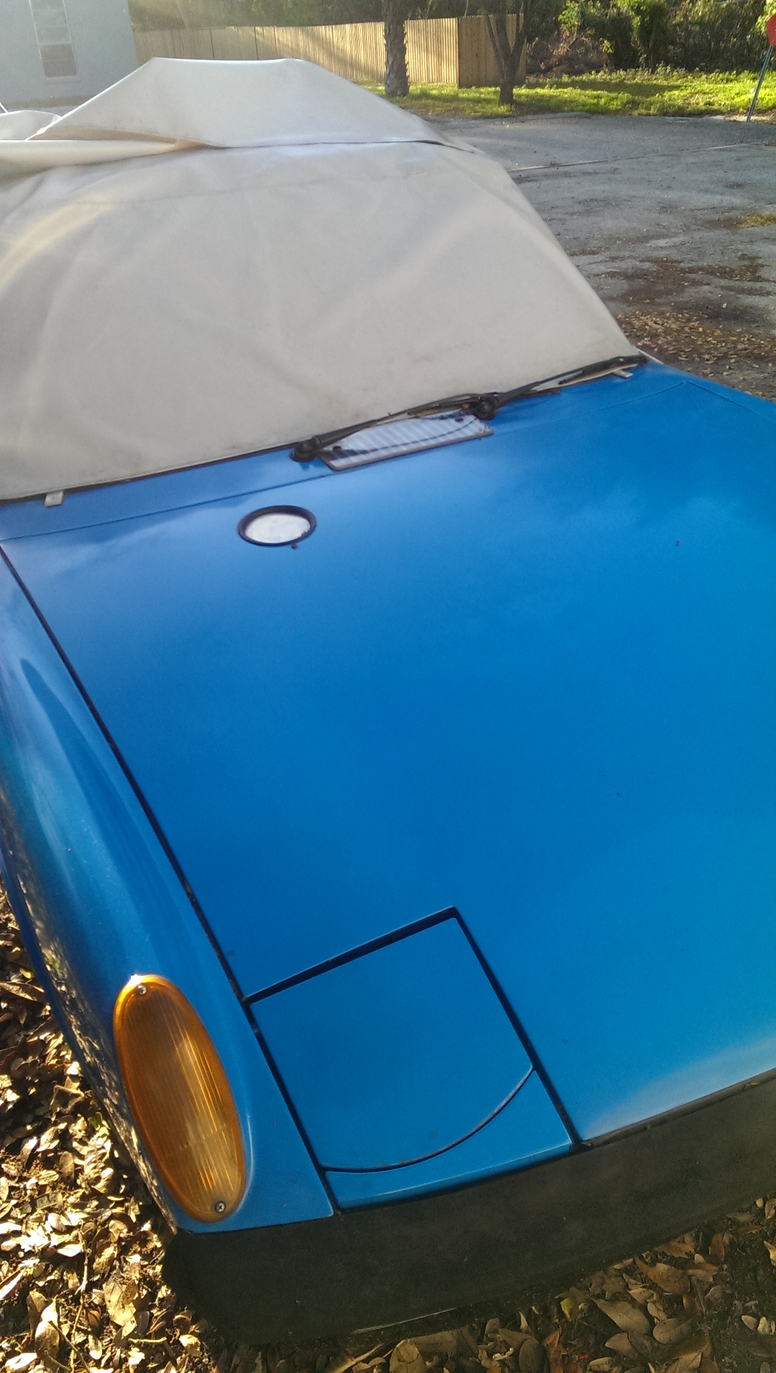

First, I emulated Brant's simple, but awesome hood fuel filler door idea. Simple measuring and cutting and a little bit of thin aluminum produced almost exactly what I wanted.
I finished it off by adding a little bit of split rubber cord from McMaster. I need to go back and paint the metal where the cutting wheel took the paint off once it stops raining around here.

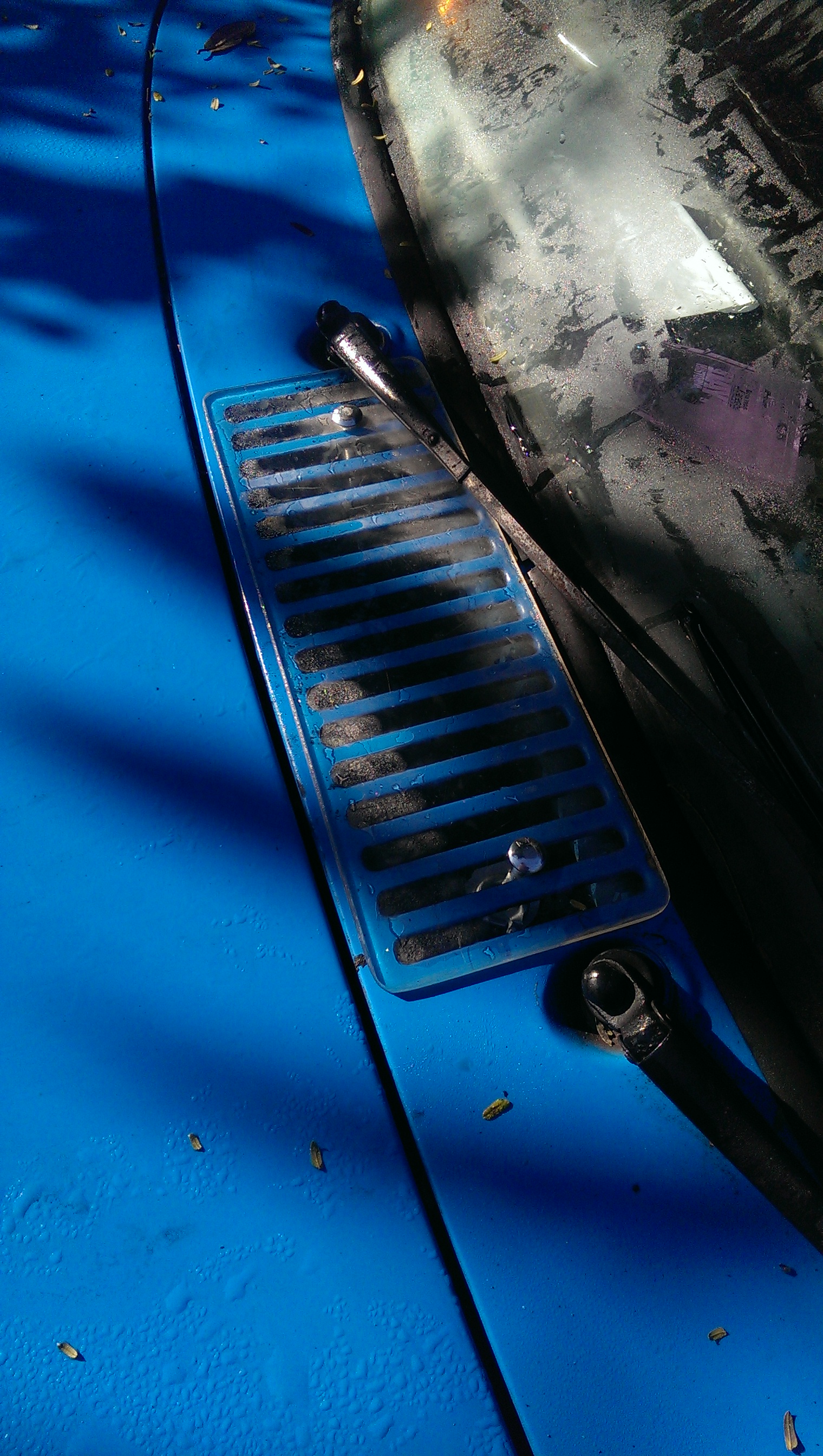

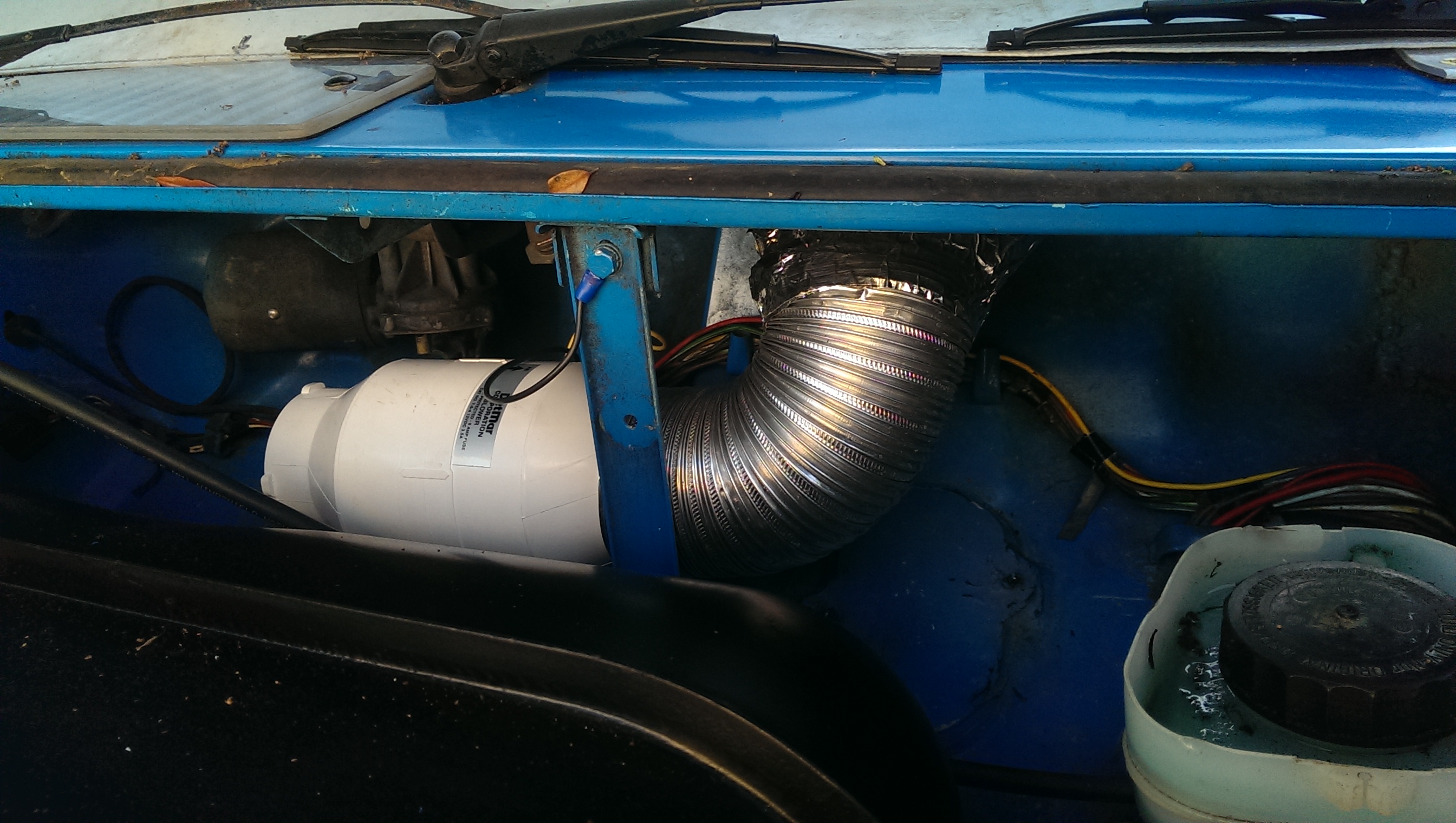

I also needed a simple and lightweight solution for a defroster. I ended up with a $20 bilge blower from Ebay, some ducting from Home Cheapo and a little bit of time fabbing up an aluminum vent to replace the factory bakelite piece that would have been there. I didn't see the need to connect it to the cowl as all you really need is air at the same temperature as ambient. I would say the whole thing weighs less than 2-3 pounds.
Last night's rain gave me a chance to try it out with the window fully fogged over. In less than a minute it was clear again - those bilge blowers put out a TON of air.

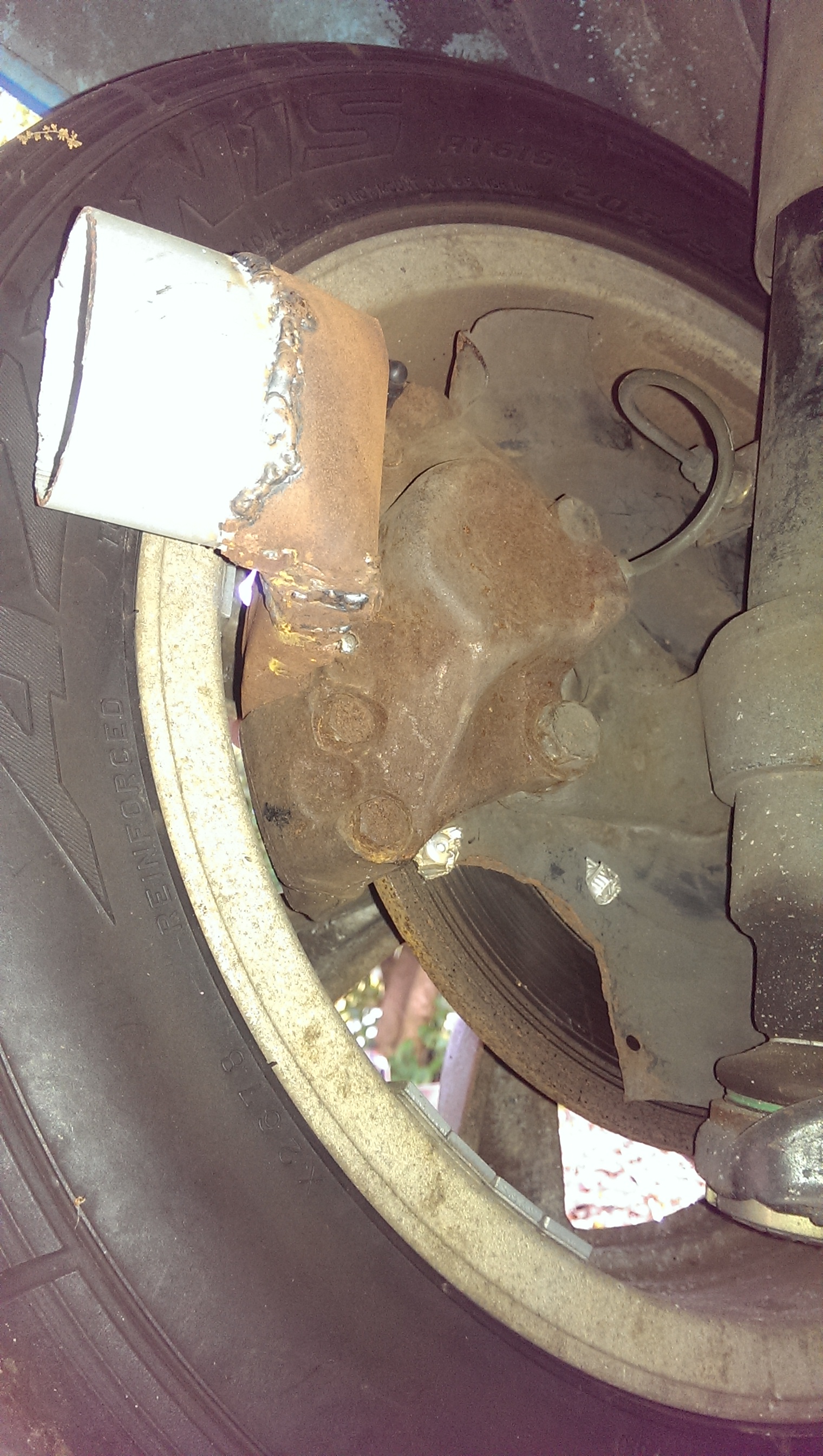

Member No.: 13,527
Finally over the weekend I was able to finish my homemade caliper ducts. I'll concede that this idea was wholeheartedly stolen from Racer Chris' awesome idea for providing vented air to solid rotors. These actually sit directly on top of the caliper, blowing air into them rather than on the rotor.
Unfortunately they're made of thin steel, so they weigh about 1/3 lb each. One day I'll go back and do them in aluminum.
Again, thank you to Racer Chris as I definitely wouldn't have come up with the idea on my own. (IMG:style_emoticons/default/pray.gif)
