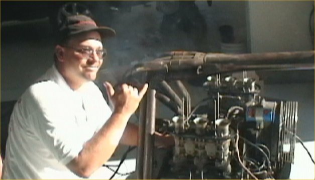

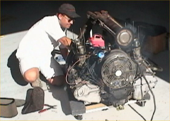

Vroom Vroom is right. We started that thing...Tonight (IMG:style_emoticons/default/clap56.gif) (IMG:style_emoticons/default/clap56.gif)
Mark thanks for your help...again. (IMG:style_emoticons/default/cool_shades.gif)
Had to shim out the VW bus bell housing to get the starter gear off the flywheel after start-up..
Carbs need rebuilding...No surprise there.
Fired right up though and revved up. I'm very satisfied.
All you SIX nuts, help me with this.
Weber 40IDA's have 55 idles, 30 chokes and 180's visible down the sight hole ( emulsion tube stack? )
We made a video of the intial start and run ( with flywheel clatter ) . Mark will post it tomorrow night for your entertainment. I wish we shot some footage after some tweaking. The first couple of minute were...well, rather smokey. (IMG:style_emoticons/default/confused24.gif)
Anyway, progress. (IMG:style_emoticons/default/mueba.gif)
Cheer me on!

here

yeah, baby!
nebreitling
post Aug 18 2004, 10:21 PM
Post #118
Member Emeritus
Posts: 3,314
Joined: 26-March 03
From: San Francisco
Member No.: 478
awesome, trekkor. your face in that picture says it all!
i say find a way to keep that exhaust as is! (IMG:style_emoticons/default/smilie_pokal.gif)
