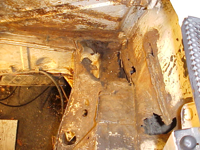

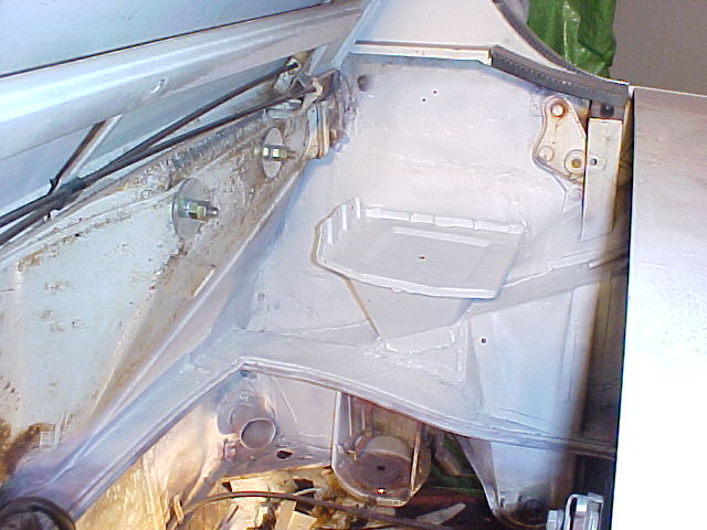

Here's what I'm looking at:

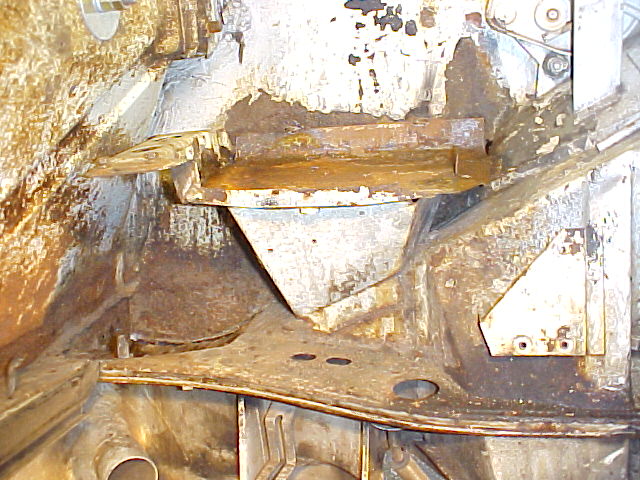

tray, pedestal and MPS mount- gone.
911 sport mounts- in.

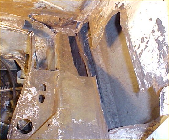

yuck (IMG:http://www.914world.com/bbs2/html/emoticons/ohmy.gif)

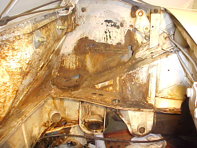

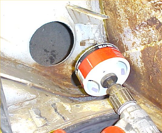

cut some holes (IMG:http://www.914world.com/bbs2/html/emoticons/wink.gif)
I'm going to go get a 4-4.5 inch hole saw for the filter, too easy.
Also cut off the blower motor pedestal- gone.
I'll naval jelly all the rusty areas, then use a rust coverting paint/primer.
It looks worse than it is. (IMG:http://www.914world.com/bbs2/html/emoticons/cool_shades.gif)

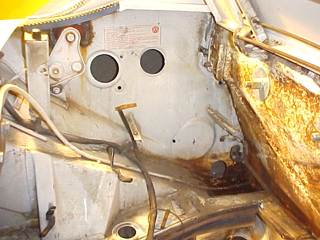

Did the BIG HOLE today.
Talk about TORQUE
That was a challenge not to break my wrist.
I didn't even take the label off, just sawwed through it too. (IMG:http://www.914world.com/bbs2/html/emoticons/smile.gif)
Anyone need a *new* hole saw.

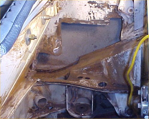

chasing rust... (IMG:http://www.914world.com/bbs2/html/emoticons/dry.gif)

top view.
Looks bad, I know. Not one bit of rust on the lower longs, motor mount ears or suspension console.
Quite a pile of dirt fell out when I popped the rocker off.
I'll do battle some more tonight. (IMG:http://www.914world.com/bbs2/html/emoticons/welder.gif)

I finished the rust repair. (IMG:http://www.914world.com/bbs2/html/emoticons/cool_shades.gif)
I found a nice tube to use as oil tank hole liner.
It's soft vinyl drip irrigation tubing. Found it in white.
Cut it into u-channel, nice fit.
Tomorrow I will paint the engine bay, install the oil tank, maybe the SIX, too. (IMG:http://www.914world.com/bbs2/html/emoticons/cool.gif)

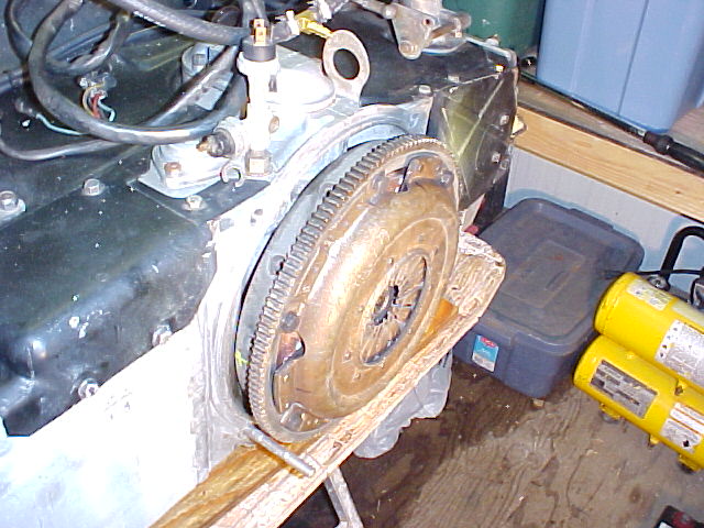

Clutch is on... (IMG:http://www.914world.com/bbs2/html/emoticons/smile.gif)

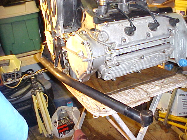

Engine mount bar is also on...
