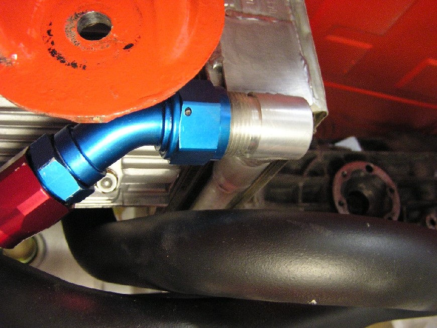

people are probably sick of this picture, but here is a shot of one modified:
brant

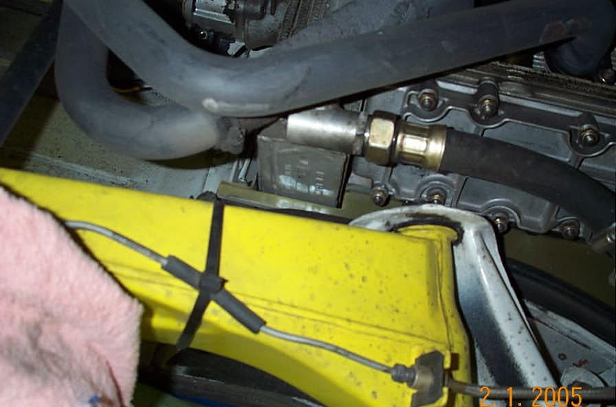

OK, Here's a shot lookin' up at the area.

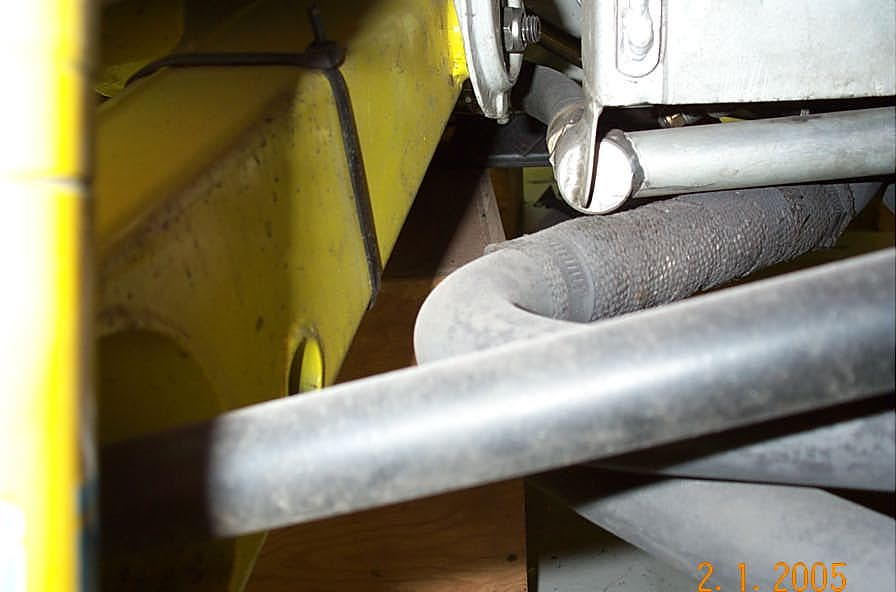

And here's one looking forward.

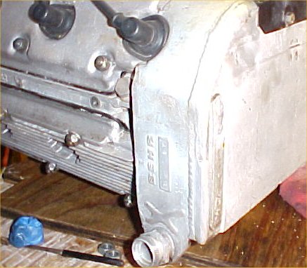

here's my cooler.
Is the suggestion to remove the cooler, weld it, re-install it?
Brant's set-up looks good.

JP, those shots were perfect.
Thanks!

By all means, take it off. Otto's did my cooler conversion.
If you have AN lines, have an AN fitting welded on...
BTW, you have to install & tighten that oil line to the tank before you install the tank......unless you have a some kinda magic wrench.....gud luck.

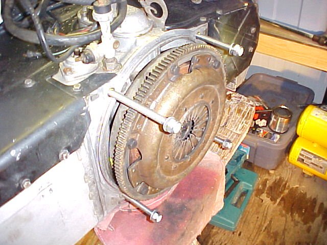

heli-coiled and installed the studs into the back of the motor.

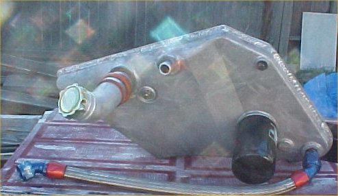

this one

Vellious?
Go with AN.....16 or 20 on the supply side.
Don't dick around with that cooler. Take it to someone that KNOWS what they are doing.

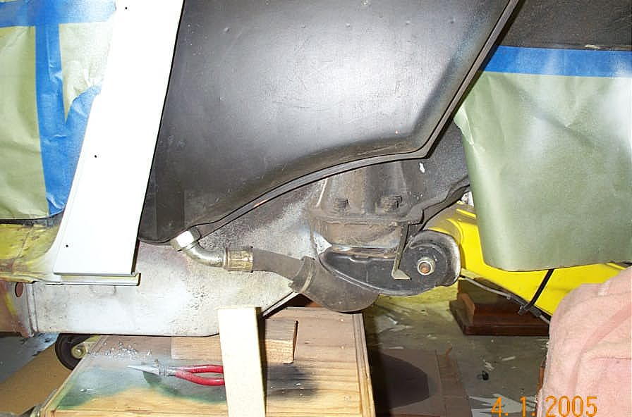

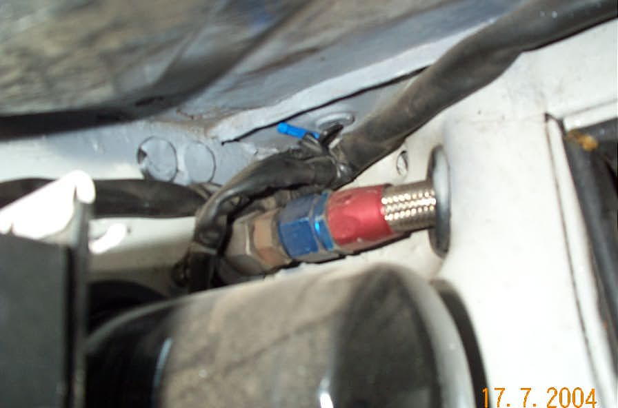

Pics......feed line ....to below cooler
J P Stein
post Jan 4 2005, 11:49 AM
Post #260
Irrelevant old fart
Posts: 8,797
From: Vancouver, WA
Member No.: 45
More.......Scavenge line to tank.
