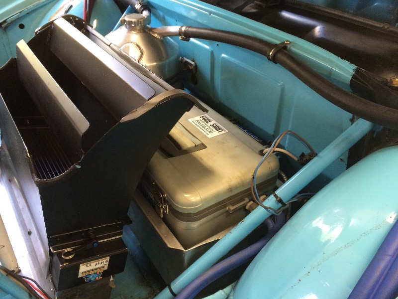

I do...the exact one on Papa Smurf...but it's vented up through the hood.

QUOTE(naro914 @ Oct 20 2015, 09:41 AM) *
Nice install. Note that the way yours is done with the dual verical lips, it basically has really big louvers venting out the hood!

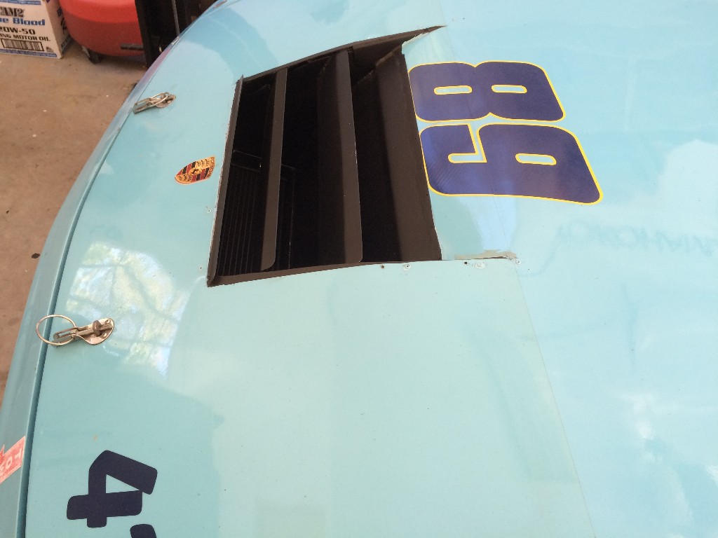

QUOTE(mepstein @ Oct 19 2015, 11:27 AM) *
QUOTE(Cairo94507 @ Oct 19 2015, 03:10 PM) *
Now you guys have me worried. I have the exact same set-up as Mark with louvers in the trunk floor, like PMS has on their car above. I am going to go out a limb here and say if PMS selected this method to expel hot air from their car, it will be good enough for my street driver. However, you got me thinking for a minute there....
Michael - you have nothing to worry about. Remember, the front cooler is a supplement to your on engine cooler. Your covered.
I removed my on engine cooler so I'm relying solely on the front cooler. If it gets to warm I will add back the engine cooler.
(IMG:style_emoticons/default/agree.gif) your engine is a fairly mild 3.2 that isn't seeing track beatings. The front cooler is supplemental. Stock 911's ran the trombone setup with a similar sized cooler in the fender well that got a lot less air flow than your, and Marks cars will be getting. NO need to worry (IMG:style_emoticons/default/smile.gif)

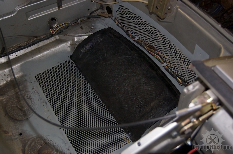

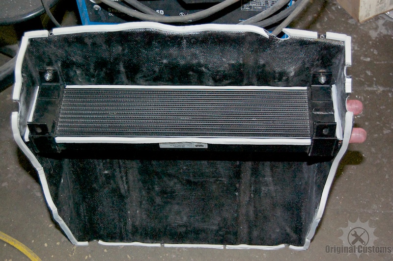

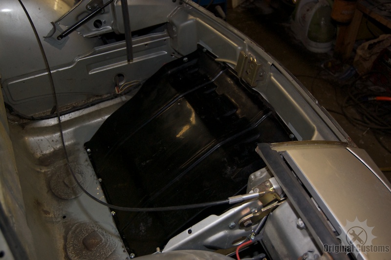

I asked Mark to engineer and install this one for my car based on Eastcoasters design.
(IMG:http://www.914world.com/bbs2/uploads_offsite/www.originalcustoms.com-7-1445359500.1.jpg)

QUOTE(echocanyons @ Oct 20 2015, 12:45 PM) *
Winner winner chicken dinner. I like that!

From: NoVA
Member No.: 50
Wow, that is VERY cool...spare tire, oil cooling and the stock cover still fits!!!
Sell a kit and I think there would be buyers

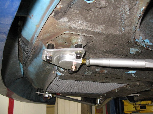

that is awesome! AND you can get a little cooling to the brakes if it was a track application...

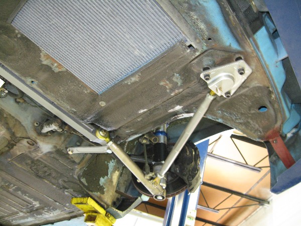

I realized I have no pictures of Huey's front trunk area with the flat cooler, but I found a couple when it was in Papa Smurf from the bottom...not great pictures since I was taking pictures of the suspension control arms, but you get the idea...this was before I scraped off all the undercoating...
Wow...look how empty the front trunk was back then!!

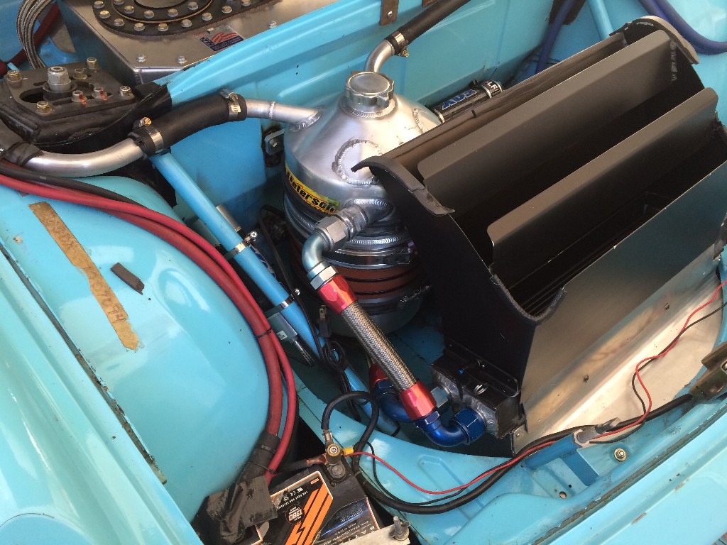

Here's the inlet/outlet side of the cooler now in Papa Smurf:

QUOTE(echocanyons @ Oct 20 2015, 08:45 AM) *
I agree, very nice installation by Mark. Is the ductwork fiberglass?
I always thought East Coaster's installation was first rate. Good work everyone.

QUOTE(naro914 @ Oct 21 2015, 09:22 AM) *
Very cool pictures of the cooler and what looks like ERP suspension components. (IMG:style_emoticons/default/cheer.gif)

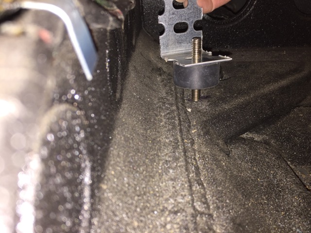

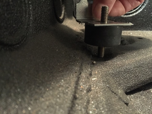

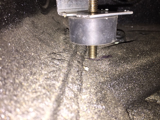

I'd like to install these rubber isolators in this exact spot and as you can see the bottom is not flat. Any ideas of what I can do here? The top brackets are easy... I'll simple use an L bracket.
Thanks,
Rob
PS - Just using the L piece shown as support so I can a good picture... (IMG:style_emoticons/default/beerchug.gif)

Contour the rubber grommet?

Add a metal spacer of sorts to the chassis that allows the rubber to be mounted exactly where you're holding it?
Or would that move everything up too high?
Just FYI, when i installed my front cooler, i added a U-channel to the bottom (and top) so that the cooler "floats" in it.
The U-channel is padded to absorb vibrations.
No rubber mounts were harmed during the install ...
