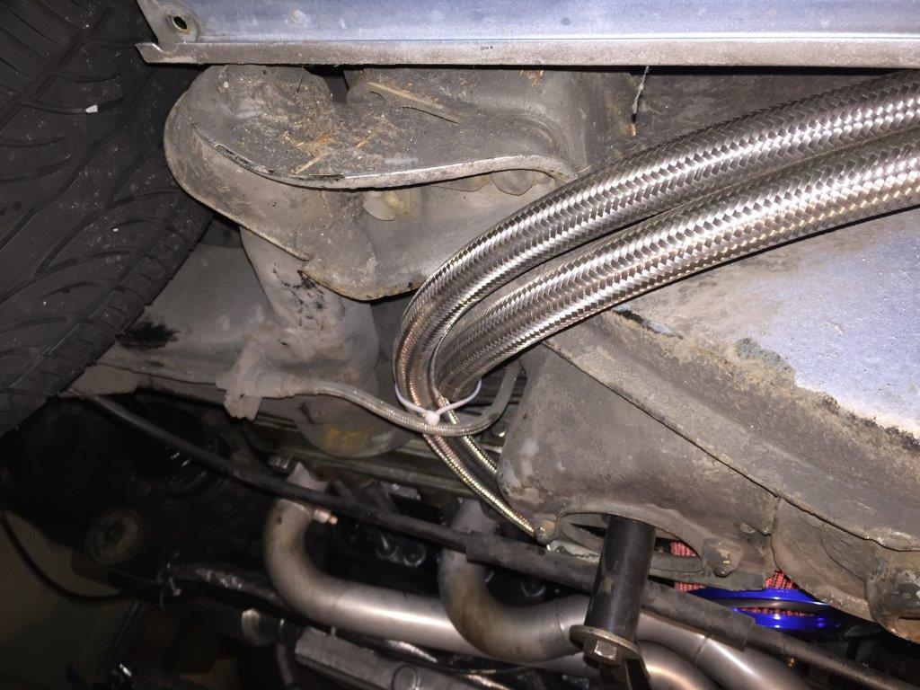

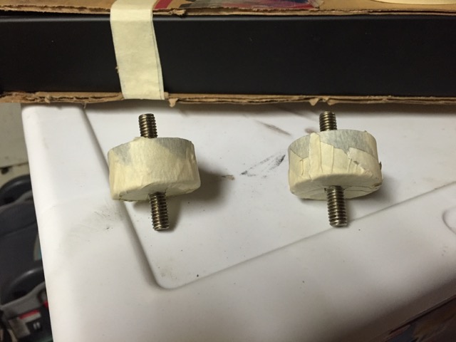

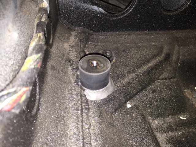

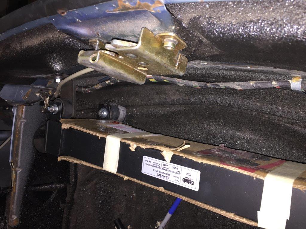

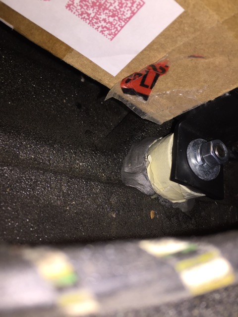

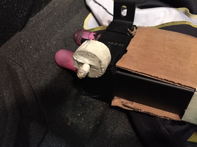

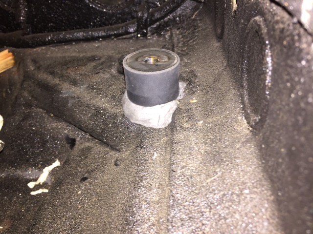

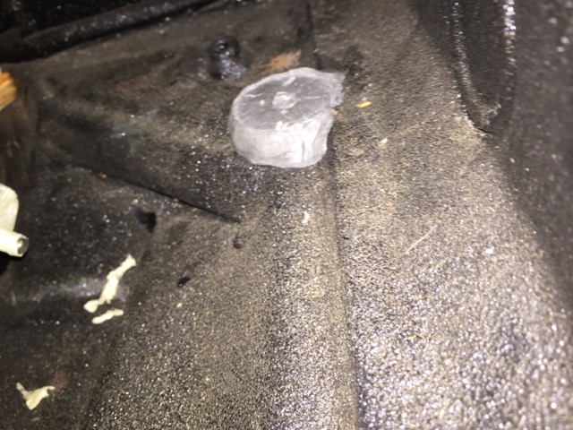

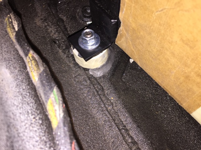

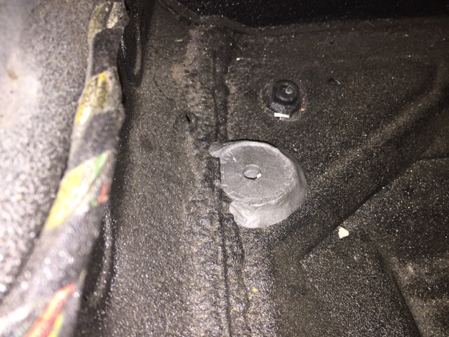

QUOTE(rtalich @ Oct 23 2015, 06:21 PM) *
I'd like to install these rubber isolators in this exact spot and as you can see the bottom is not flat. Any ideas of what I can do here? The top brackets are easy... I'll simple use an L bracket.
Thanks,
Rob
PS - Just using the L piece shown as support so I can a good picture... (IMG:style_emoticons/default/beerchug.gif)
This is what I've done so far...
Attached Image Attached Image Attached Image Attached Image Attached Image Attached Image Attached Image Attached Image Attached Image

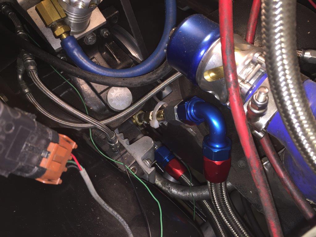

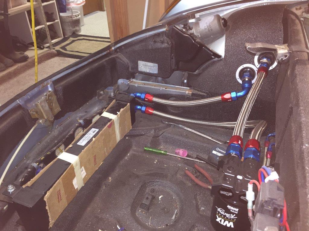

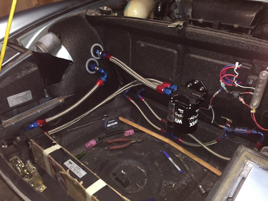

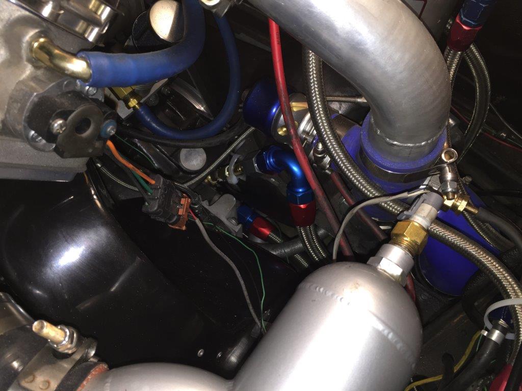

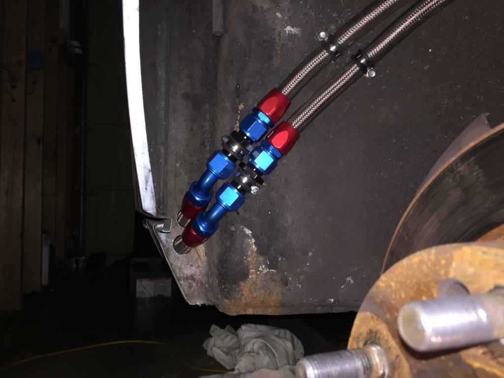

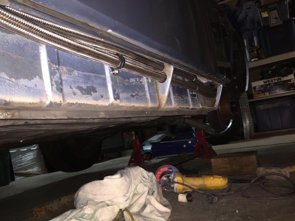

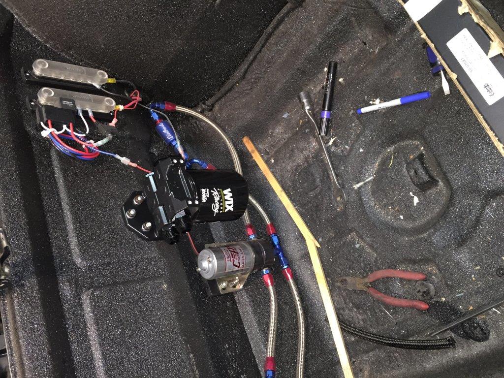

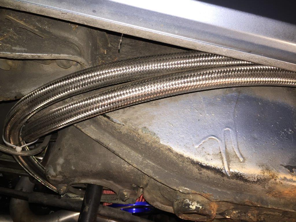

post Nov 17 2015, 10:40 AM
Post #52
Posts: 279
Joined: 25-September 06
From: Bellevue, WA
Member No.: 6,913
More progress...
ChrisFoley
post Nov 17 2015, 10:49 AM
Post #53
I am Tangerine Racing
Posts: 8,019
Joined: 29-January 03
From: Bolton, CT
Member No.: 209
Those don't look like -12
rtalich
post Nov 17 2015, 11:40 AM
Post #54
Posts: 279
From: Bellevue, WA
Member No.: 6,913
QUOTE(Racer Chris @ Nov 17 2015, 08:49 AM) *
They are -12AN lines and fittings. The other lines in some of those pics are fuel, which are -6AN lines.
ChrisFoley
post Nov 17 2015, 11:47 AM
Post #55
Posts: 8,019
From: Bolton, CT
Member No.: 209
QUOTE(rtalich @ Nov 17 2015, 01:40 PM) *
Nevermind.
