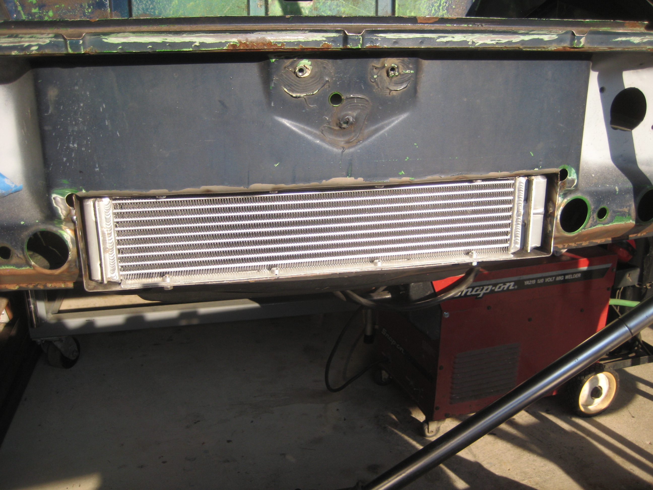

Even as we speak.

Replica OE GT cooler.
Will use a 911 thermo back in the drivers side lower engine compartment.
Brass tubes and all OE metric fittings

Neat, is it going to have a bottom to it or will you just use the trunk floor?

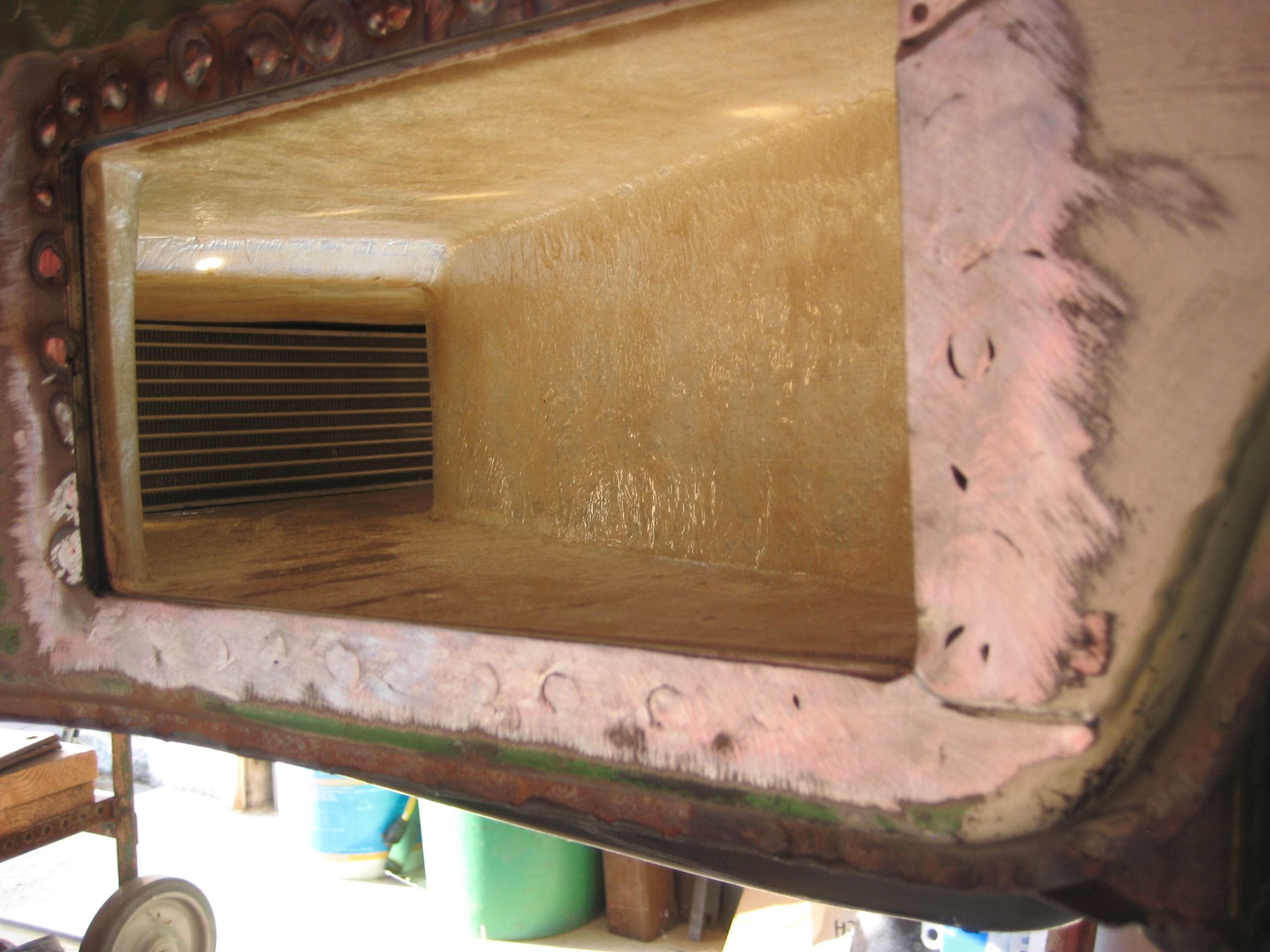

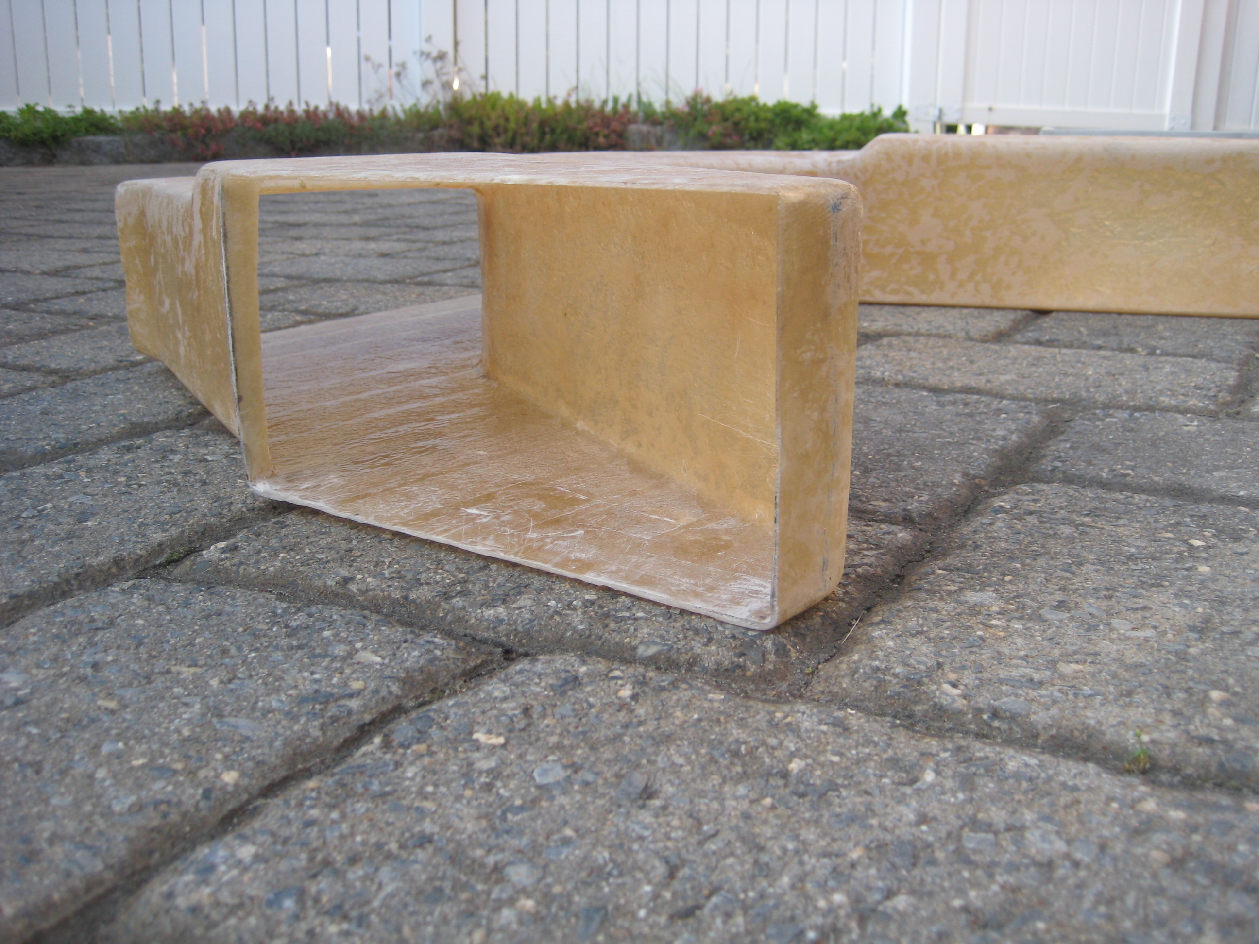

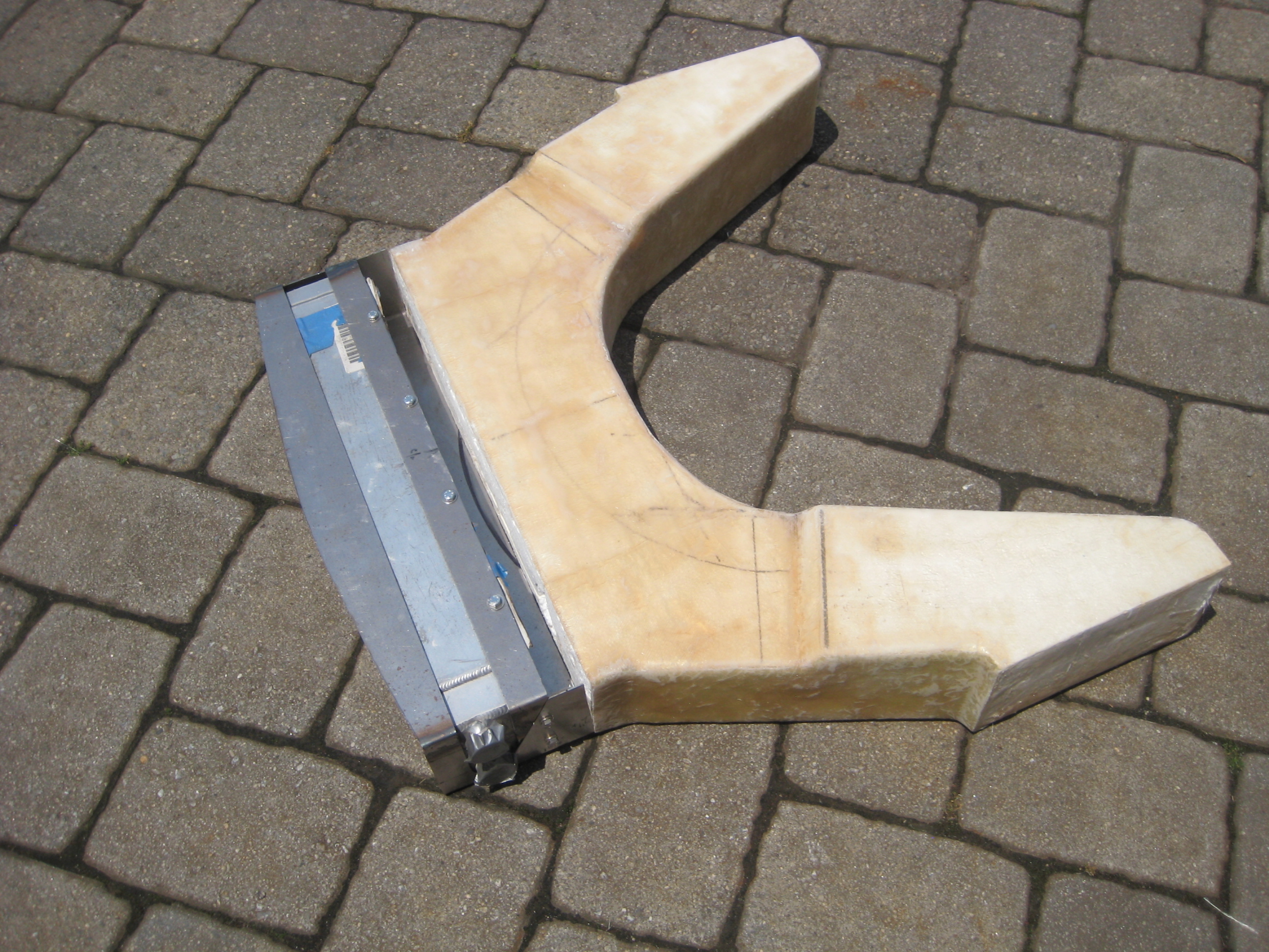

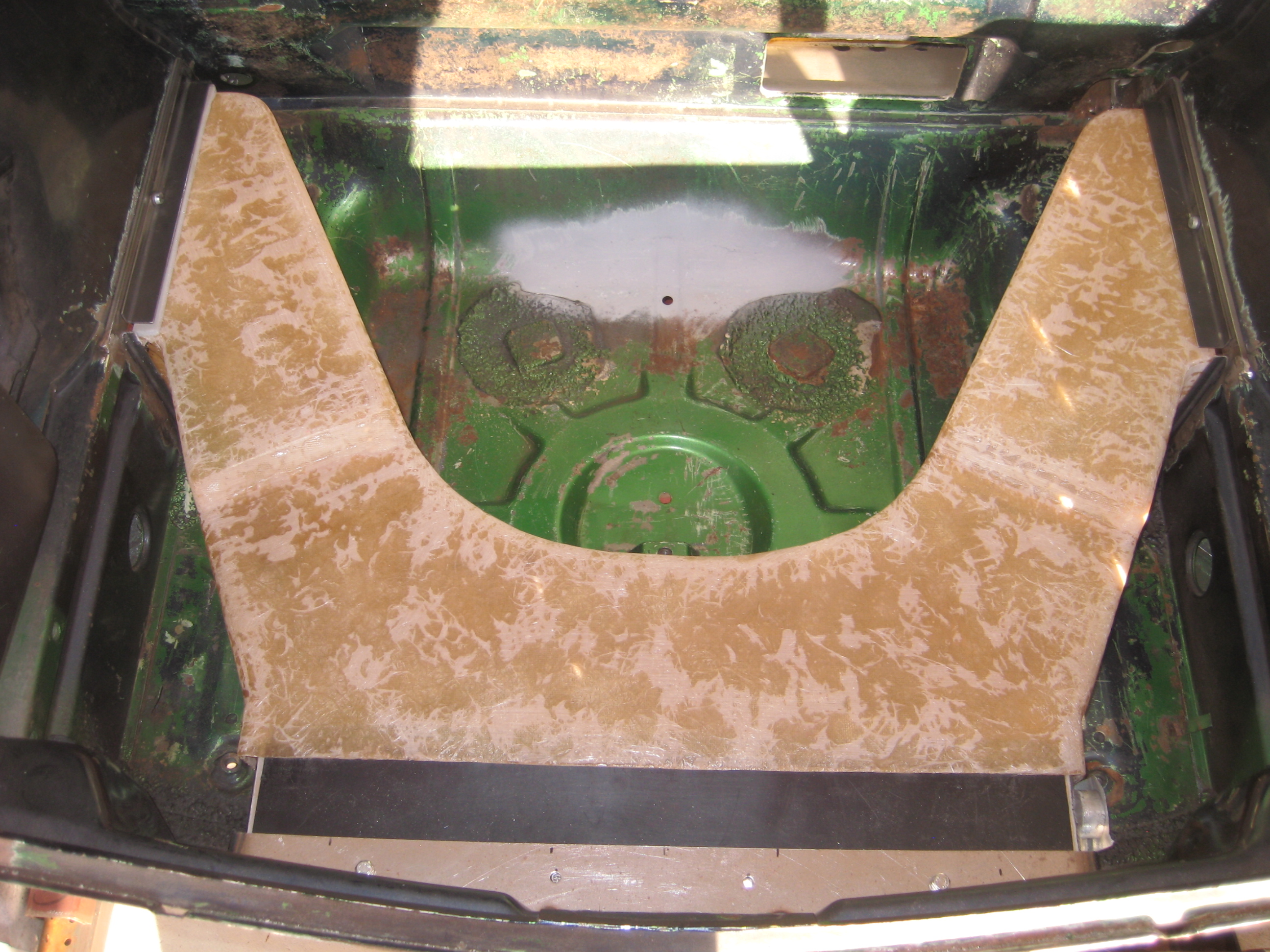

rgalla9146
post Jul 20 2016, 04:47 PM
Post #68
Posts: 4,943
Joined: 23-November 05
From: Paramus NJ
Member No.: 5,176
QUOTE(Mueller @ Jul 20 2016, 05:45 PM) *
QUOTE(rgalla9146 @ Jul 8 2016, 10:38 AM) *
Even as we speak.
fiberglass duct above floor to fenderwells
pictures don't illustrate too well...shadows,colors etc.etc

Very nice fiberglass work. How was the duct molded? With a foam male plug? I would like to learn how to do small fiberglass projects like that.
rgalla9146
post Jul 21 2016, 09:53 AM
Post #71
Posts: 4,943
From: Paramus NJ
Member No.: 5,176
QUOTE(maf914 @ Jul 21 2016, 11:02 AM) *
Yes, done over a styrofoam form wrapped in clear packing tape.
After the fiberglass is hard the styrofoam is broken up and removed from the inside.
There is an earlier picture in this thread with the foam still inside.
Cairo94507
post Jul 21 2016, 03:59 PM
Post #72
Michael
Posts: 10,588
Joined: 1-November 08
From: Auburn, CA
Member No.: 9,712
That looks like an excellent solution and keeps one from having to open up the trunk floor. (IMG:style_emoticons/default/smilie_pokal.gif)

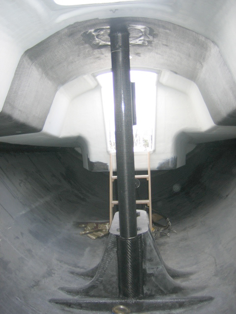

QUOTE(rgalla9146 @ Jul 20 2016, 06:49 PM) *
Even as we speak.
Now if you'd done it in carbon, then really cool !!
Bare boat interior prior to interior build:
