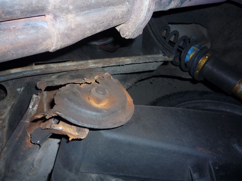

So I notice my passenger rear wheel camber was way off. That side of the car was sagging a little bit. I figured something came loose. I jack up that side of my car (IMG:style_emoticons/default/headbang.gif) (IMG:style_emoticons/default/headbang.gif) (IMG:style_emoticons/default/headbang.gif) (IMG:style_emoticons/default/headbang.gif) (IMG:style_emoticons/default/headbang.gif) (IMG:style_emoticons/default/headbang.gif) (IMG:style_emoticons/default/headbang.gif) (IMG:style_emoticons/default/headbang.gif) (IMG:style_emoticons/default/headbang.gif) (IMG:style_emoticons/default/headbang.gif)
Take a look at my suspension ear (IMG:style_emoticons/default/hissyfit.gif) (IMG:style_emoticons/default/hissyfit.gif) (IMG:style_emoticons/default/hissyfit.gif)

Sucks. There's no patching that one.

seems to be a lot of this right now,
there was at least one other thread when mine was active a couple weeks ago.
http://www.914world.com/bbs2/index.php?sho...c=96575&hl=
it's a pita, and if you have any hp at all you need to reenforce.
it looked to me like this is the last spot for the acid dosed rainwater to have collected all those years.

Unfortunately you will need to remove the whole damn thing and replace it with a new one. Drill out the spot welds, and fit up a new one. get some measurements from a known good car.
If you are putting in a big motor and sticky tires you can just go ahead a put the plate on now.

That's a combo rust/fatigue crack and has been happening for awhile...
Notice that a lot of the crack is rusty which means it happened a while ago which is consistant with mild steel. High temeper materials would snap with a clean unrusted break surface, and with the the mild steel, the crack would march along the part allowing old breakage areas to rust, and the new break to look shiney.
Which is exactly what happened here.
I'm just glad that it happened with no damage to you, and with minimal parts damage (broken ear).

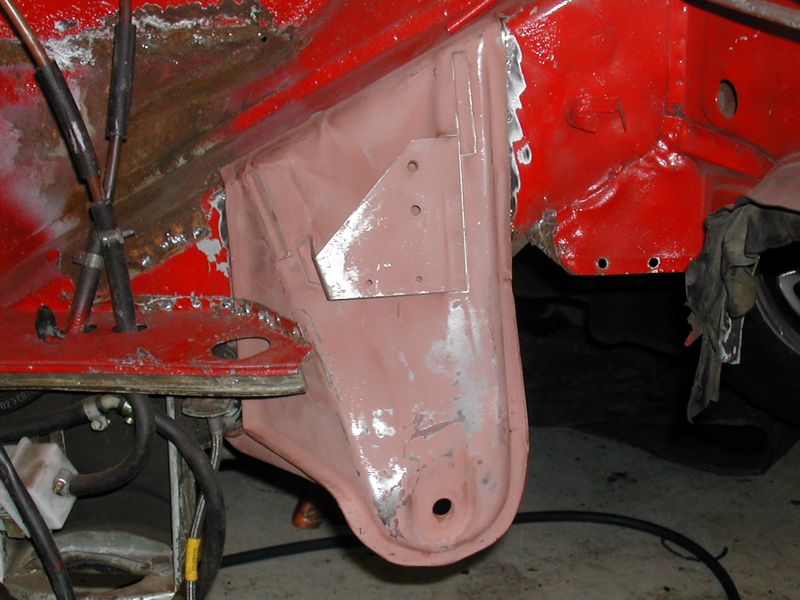

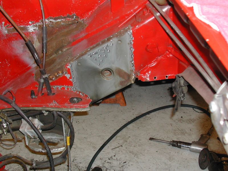

Pics from a replacement. It's a quite a PITA on the underside.

Hmmmm, I'll consider the front clip extremely partial payment. (IMG:style_emoticons/default/shades.gif) It could be done in a day if the motor is already out.
