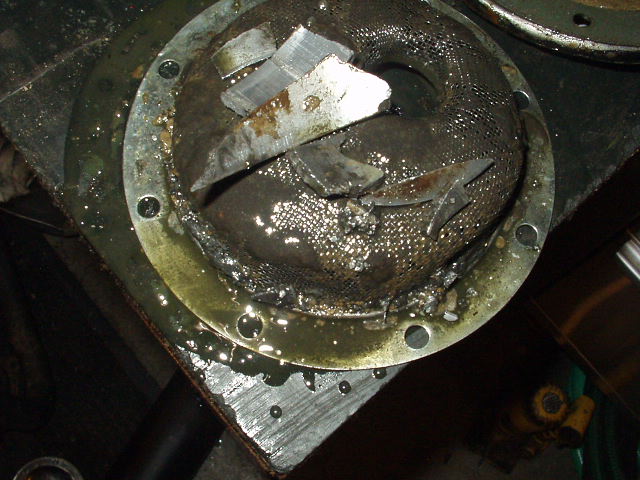

After removing the screen JP fished out this pile of shrapnel.
Don't think water did this!

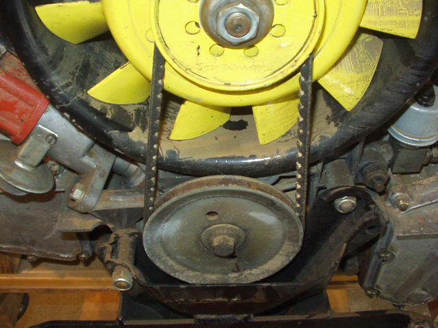

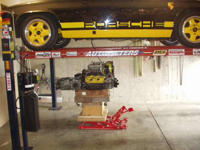

Engine out, using JP's very slick jack and boxes. My four post allowed lifting the car instead of dropping the engine.

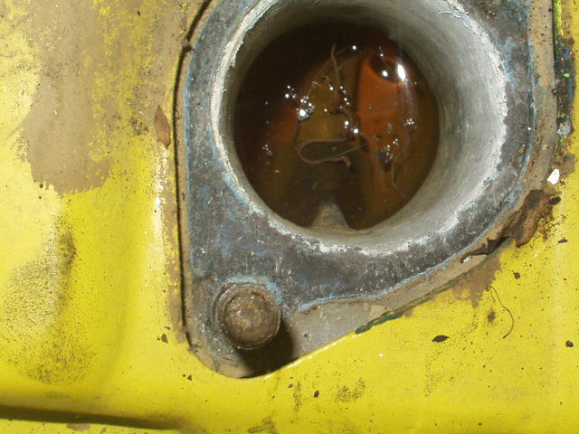

You ain't seen nothin' yet Z
Pennsylvania silt.

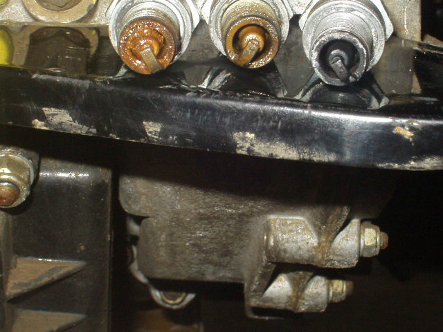

Plugs

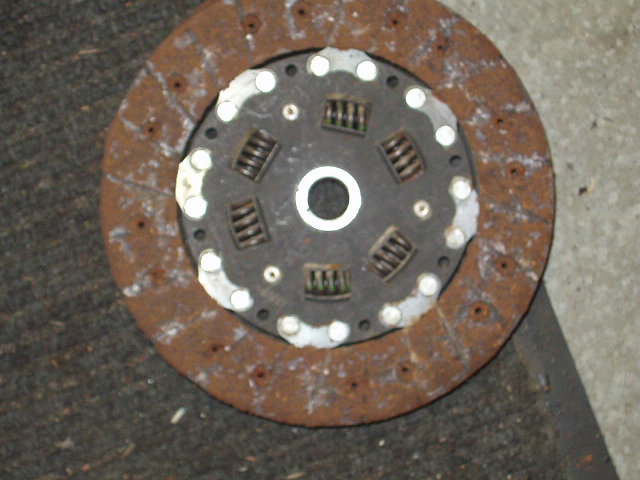

Clutch disc dissolved. Hope the rusty p. plate and flywheel can be saved.

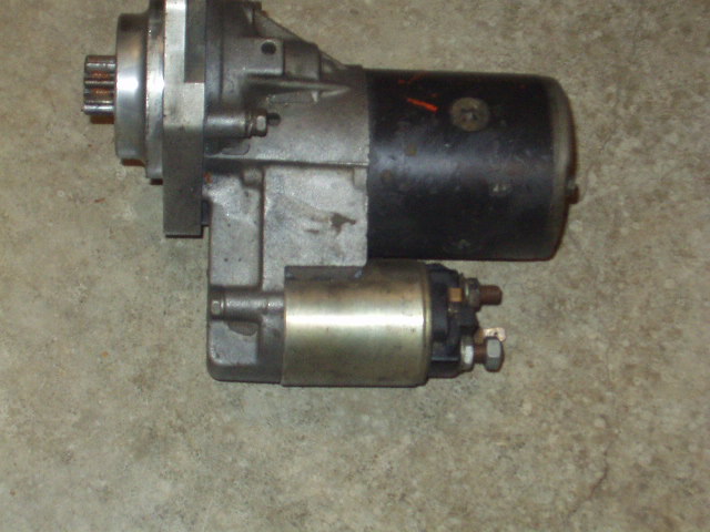

Found an unusual starter.

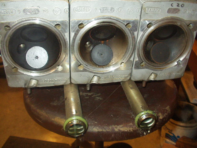

Here is proof that MM seated at least one intake valve properly.
Held a port full for a year!

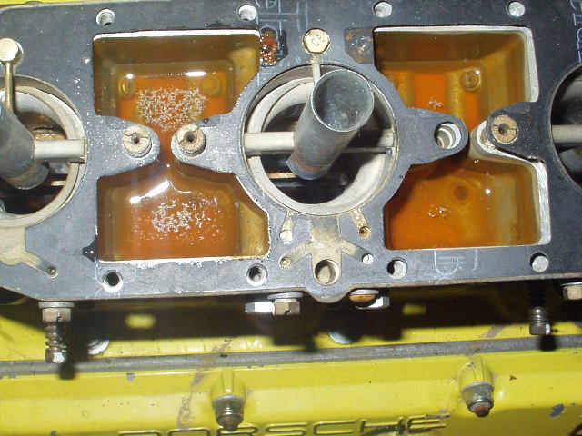

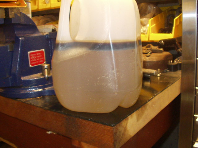

Think there might be water in the fuel?

Hummm.....What's the shittage in that intake port? Also,
that is not a stock 2.7L intake port..appears to be a small port carb head.
MM did sumthin' there....it appears to be a half assed porting job.

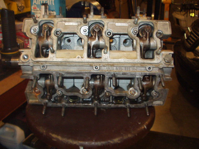

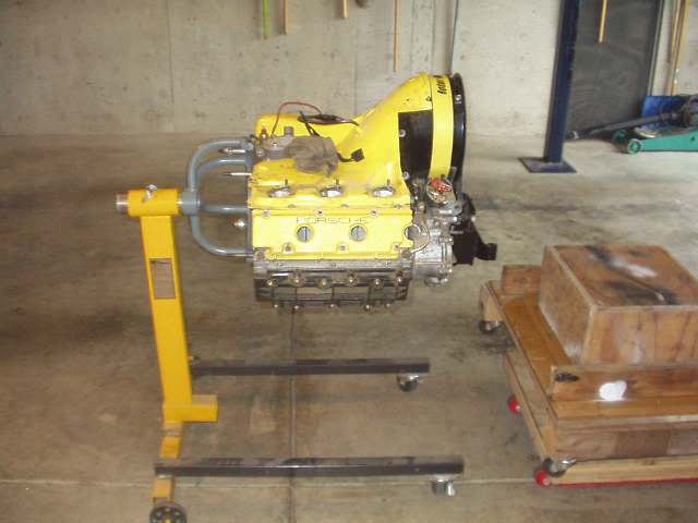

Ok, here's the the rocker side of one bank. Cam not rusty, just a little light rust on the rockers.
Porsche Rescue
post Jul 2 2005, 09:29 PM
Saving and Enjoying Old Porsches
Posts: 2,978
Joined: 31-December 02
From: Bend, Oregon
Member No.: 64
Here's the hot side. Must have been run by someone on the bench but pretty fresh looking.
