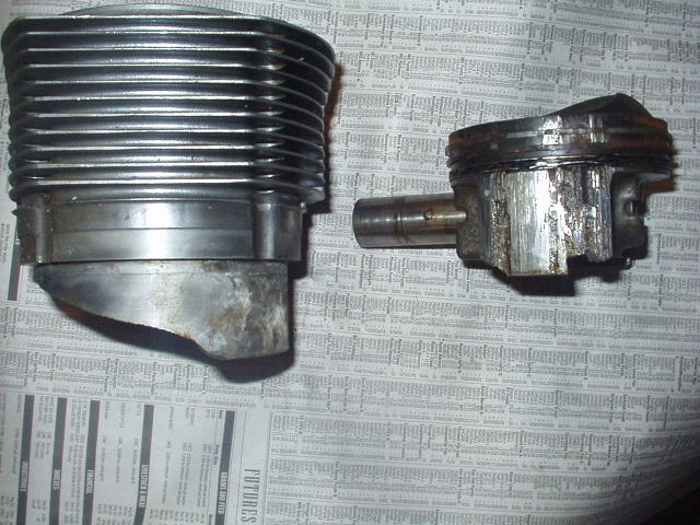

Now for the gore.......... #4 guess we know where the shrapnel came from. Pretty strong flood currents in Pennsylvania!

Alusil cylinders by the way. Here is #1. Lots nicer than 4.

#5 got hit by hard water too.

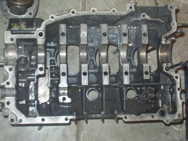

Case looks good to my eye.
JP, can small bore heads be installed on 90mm cylinders?

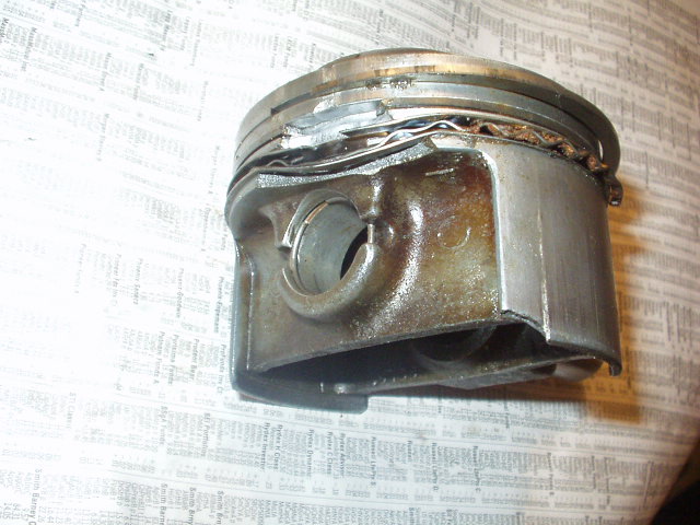

Hummm....the rings appear to be intact.....cept maybe the oil ring. That could be a chicken/egg deal. My WAG, galling....
non ferocoated piston on a Alusil cylinder.....Musta made *some* noise (IMG:http://www.914world.com/bbs2/html/emoticons/laugh.gif)
How did the rod look?
Bring them suckers to the AX tomorrow for "show & tell".
We can set it on the registration desk.

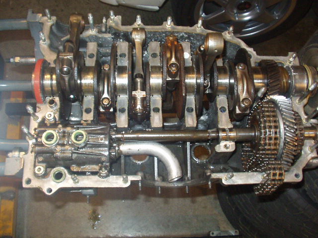

Gotta get JP over here with his measuring sticks to see what we have for a crank.
Shop owner told me the car had never been on the road as a six. Pretty obvious that is true since it has a new Velios tank which has never been plumbed. He said the motor was "fresh" from Motormeister. I intend to call him to make sure and to ask if he ran it before it was installed. Meantime, I don't think I'll be asking MM to build the replacement. I might suggest he order his next one from somewhere else.
I'll post some pics of the interior in a few days. You would never know it was submerged, unless you noticed the high water lines inside the gauge lenses!!!
If ya got a Mill or lathe (IMG:http://www.914world.com/bbs2/html/emoticons/laugh.gif)

No thought of trying to get satisfaction from MM. I bought the car assuming engine was a boat anchor (but hoping to get lucky). I just want to get the facts straight, and if appropriate, advise the shop in PA to do business elsewhere next time.
I have arranged to have a 2.7 built to install in the car this summer. If case (7R)and crank are good I will sell them. Head assemblies might be usable, depending on whether or not I can determine what they are!
