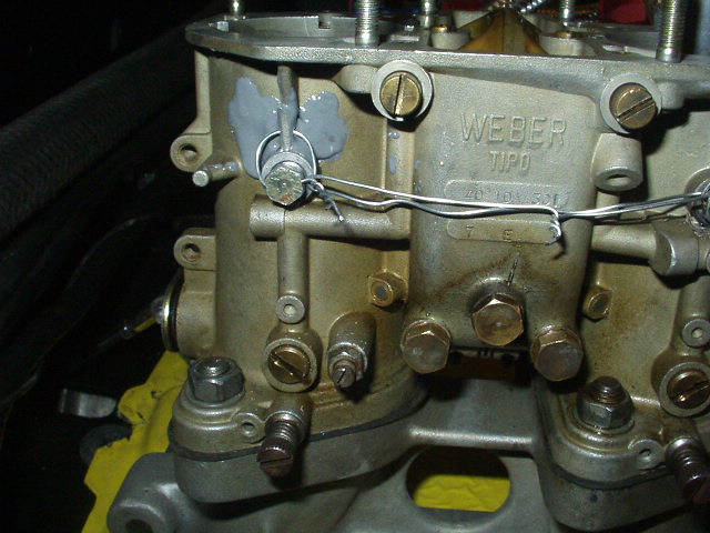

Jim...the JB weld will work...get the mating surfaces real clean with acetone first....make big fillets, don't worry about looks.......don't glue in the venturi. I like the yellow wheels better too (IMG:http://www.914world.com/bbs2/html/emoticons/cool.gif) .....the car looks beautiful!

Well, JB Weld it is. Patched it together tonight. Sleeping with my fingers AND legs crosssed.

Do petrol and JB work okay together. Leave the stripes off. The car looks great as is.

Oh yeah, will JB weld hold gas? It's a pretty good solvent, especially with ultrasonic vibration. Does an engine produce ultrasonic vibration?

JB Weld should work fine once cured. You can get the stripes from Jeff.

Well, here's the patch......surgical it ain't. Solid enough that it accepted the set screw, snugged tight by hand. Don't laugh at the "daisy chain" wiring job. The screw is wired to the broken piece. If the piece comes out I want to be able to find it hanging there. Haven't done a road test yet. Tomorrow is supposed to be dry so I can get it good and warm before re-tuning the carbs. If I get to that point I should be good to go. Suspect I won't have any trouble knowing if it falls out!

Geeez, hope that works. (IMG:http://www.914world.com/bbs2/html/emoticons/unsure.gif)
Can it be welded (real welding) after that JB is done?

Don't think you can weld pot metal. I am optimistic. The stuff is very hard. They claim it can be drilled.
Silly me, I thought they were made of aluminum.

That'll hold.
