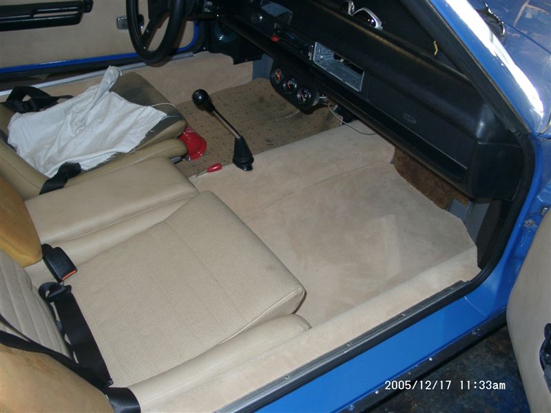

This colour is awsome in natural. But i think it is very sensitive to dirt.

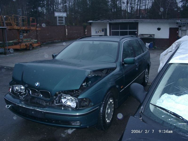

Little Off topic but have to share.
Since i had an accident with my new daily driver there was no major Progress the last day´s.
Owned it only for 5 weeks and then had a little problem on the highway

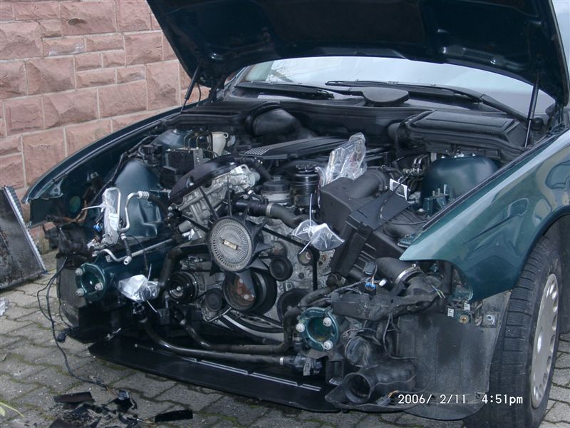

took out all the crushed stuff.

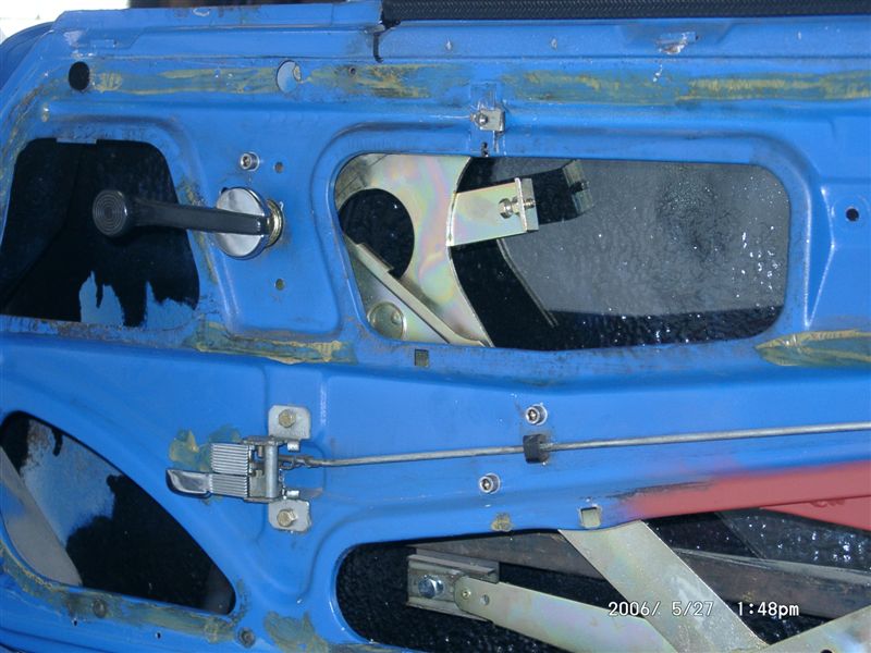

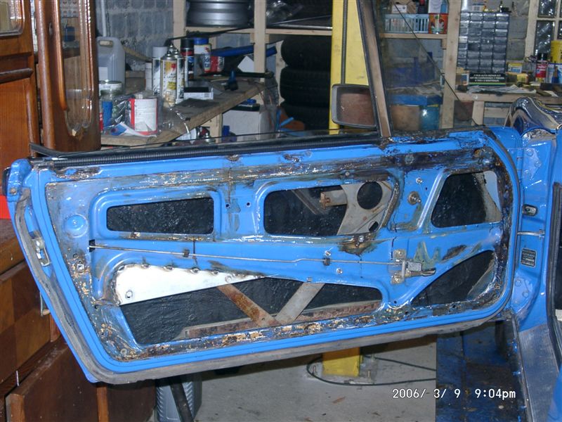

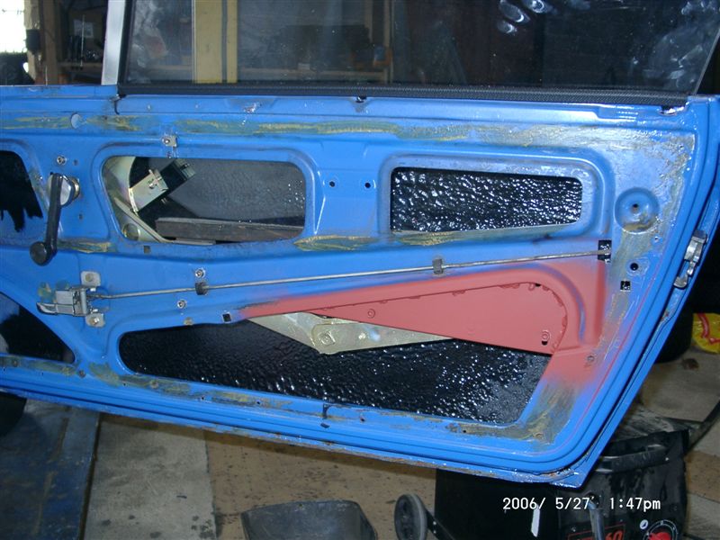

Hi together,
last conversion on the car was changing the old style windows to new style windows and cranks.
No more rattling of the windows!!! (IMG:http://www.914world.com/bbs2/html/emoticons/smilie_pokal.gif)

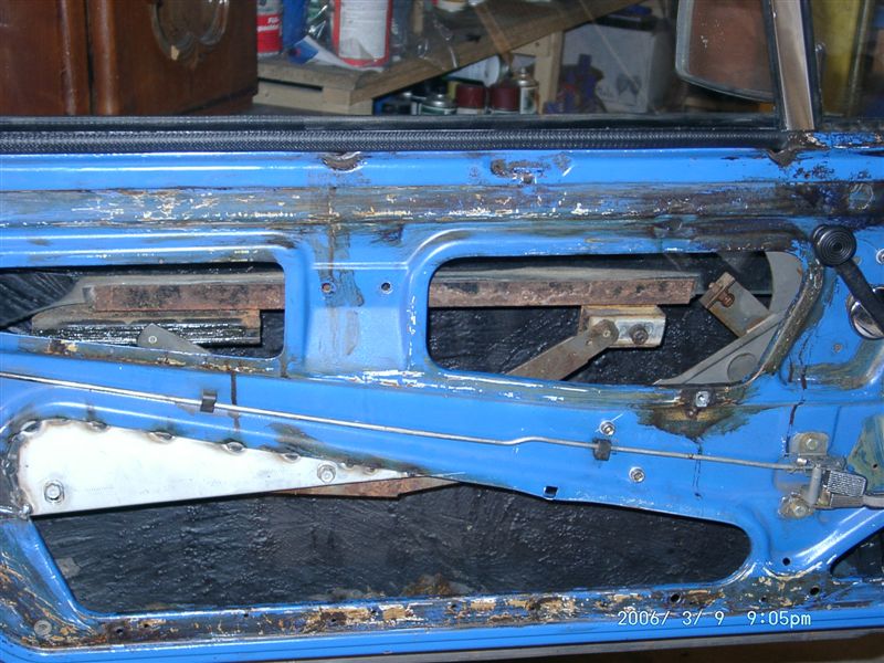

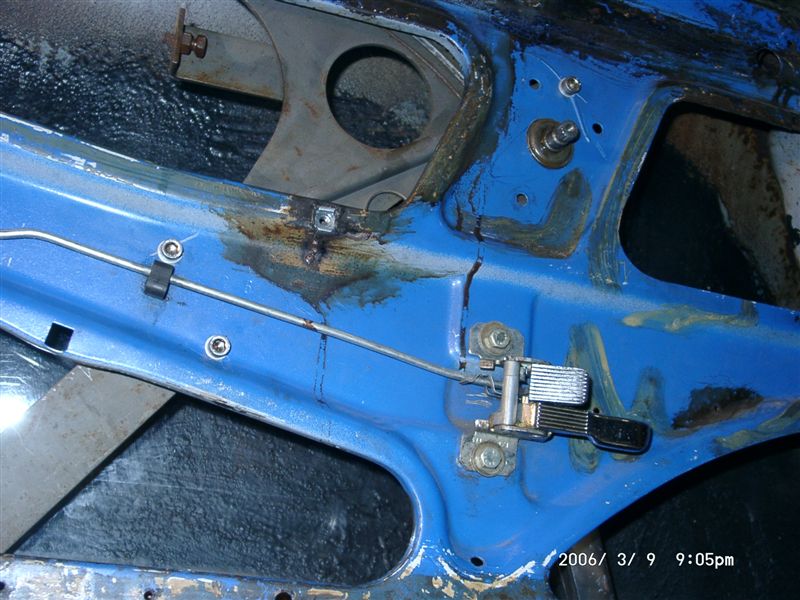

michelko
post Mar 29 2006, 06:47 AM
Post #568
Posts: 867
Joined: 30-November 03
From: Germany, Lambsheim
Member No.: 1,404

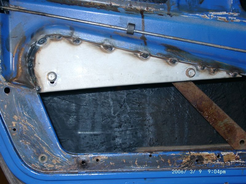

all i had to do was collecting the window parts drill some holes and weld a piece of sheet metal in.

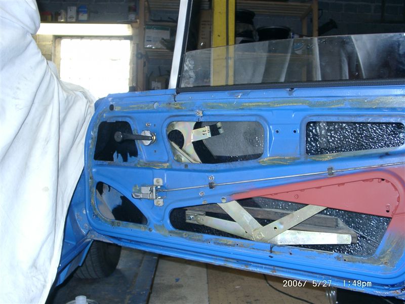

michelko
post Mar 29 2006, 06:48 AM
Post #569
Posts: 867
Member No.: 1,404
the windows goes very smooth up an down.
Realy worth the work.

Root_Werks
post Mar 29 2006, 08:42 AM
Post #571
Village Idiot
Posts: 8,730
Joined: 25-May 04
From: About 5NM from Canada
Member No.: 2,105
Thanks for posting the pictures of this, what a great conversion idea. Need light doors? Want late regulators? Looks pretty straight forward even. Cool! (IMG:http://www.914world.com/bbs2/html/emoticons/smilie_pokal.gif)

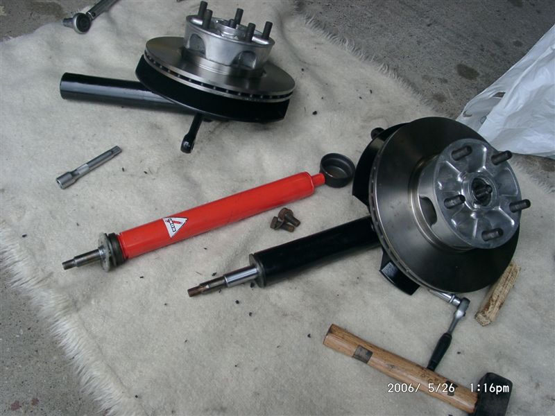

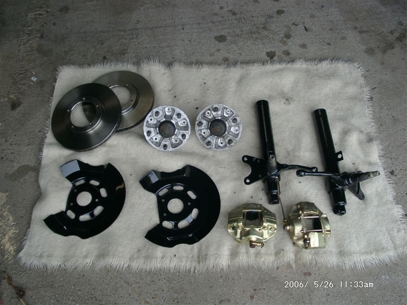

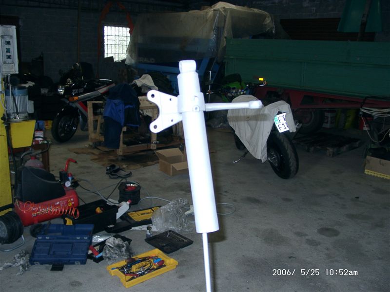

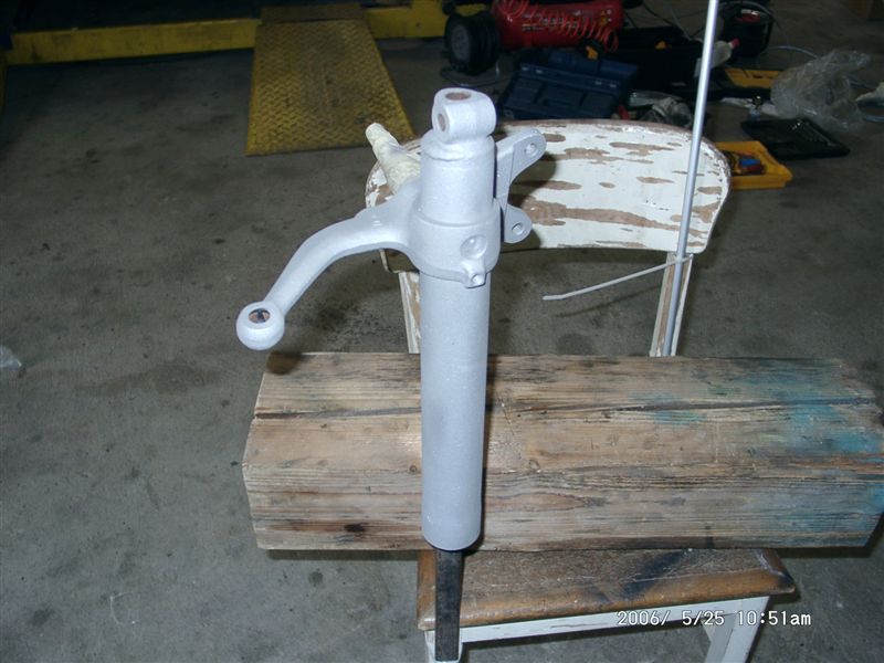

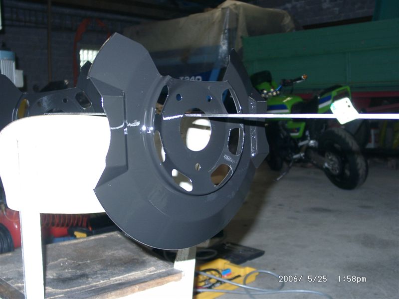

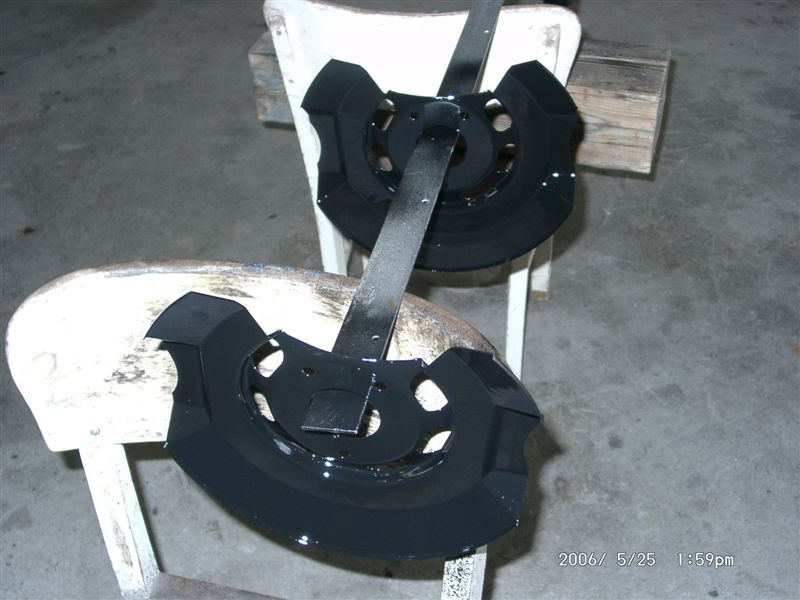

Hi guy´s
did some work on 5 lug conversion. Got the struts sandblasted and painted with por 15. Reeeaaly nice!!
Last missing part to start the swap is the 19mm master cylinder.
First pic: the raw struts.
michelko
post May 26 2006, 08:38 AM
Post #574
Posts: 867
Member No.: 1,404
nother one
michelko
post May 26 2006, 08:39 AM
Post #575
Posts: 867
Member No.: 1,404
first coat of por 15
michelko
post May 26 2006, 08:40 AM
Post #576
Posts: 867
Member No.: 1,404
the new dust shields
michelko
post May 26 2006, 08:42 AM
Post #577
Posts: 867
Member No.: 1,404
hey cool i discovered the multiple attachment function
and here is the nearly complete Setup. equiped with new bearings , new koni´s etc.

Today i changed to the new style windowregulator on passenger side.
No more rattling windows (IMG:style_emoticons/default/aktion035.gif)

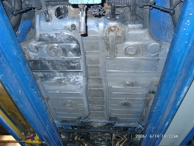

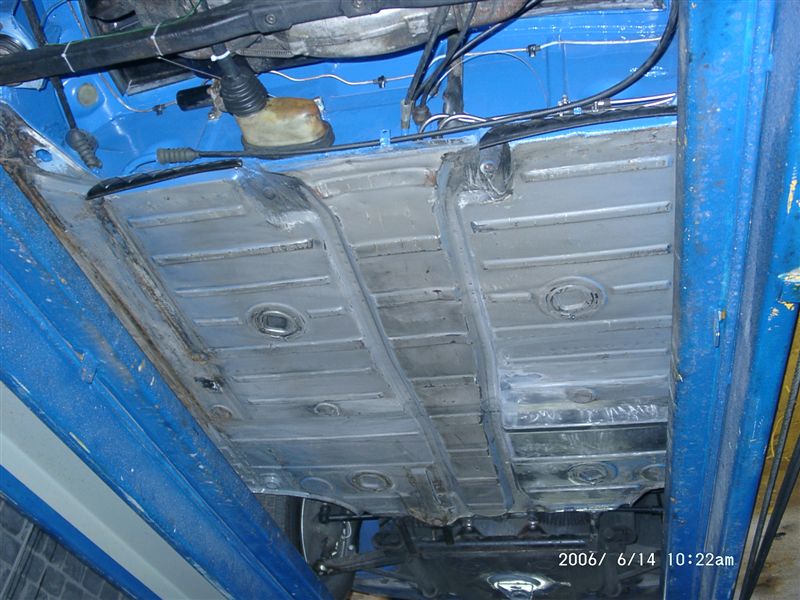

Here is a little update on my restoration thread.
Stripped down the underside of the car to the primer, some parts to bare metal.
It´s just amazing how solid this is!!
I think i strip all to bare metal and the using metal ready and por 15.
Not sure how the por15 will stuck to the old primer??
The first two pic´s shows the bottom
Third pic shows the long before restauration.
Unbelievable it the same car!!
(IMG:style_emoticons/default/smilie_flagge6.gif)
