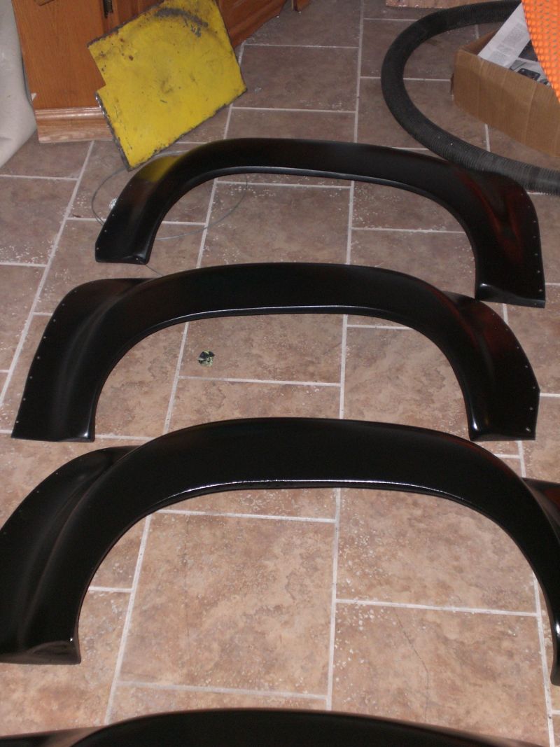

painted and putting the flares on!!

one side done, came out reasonably well concidering who was doing the work!! (IMG:style_emoticons/default/beer.gif)

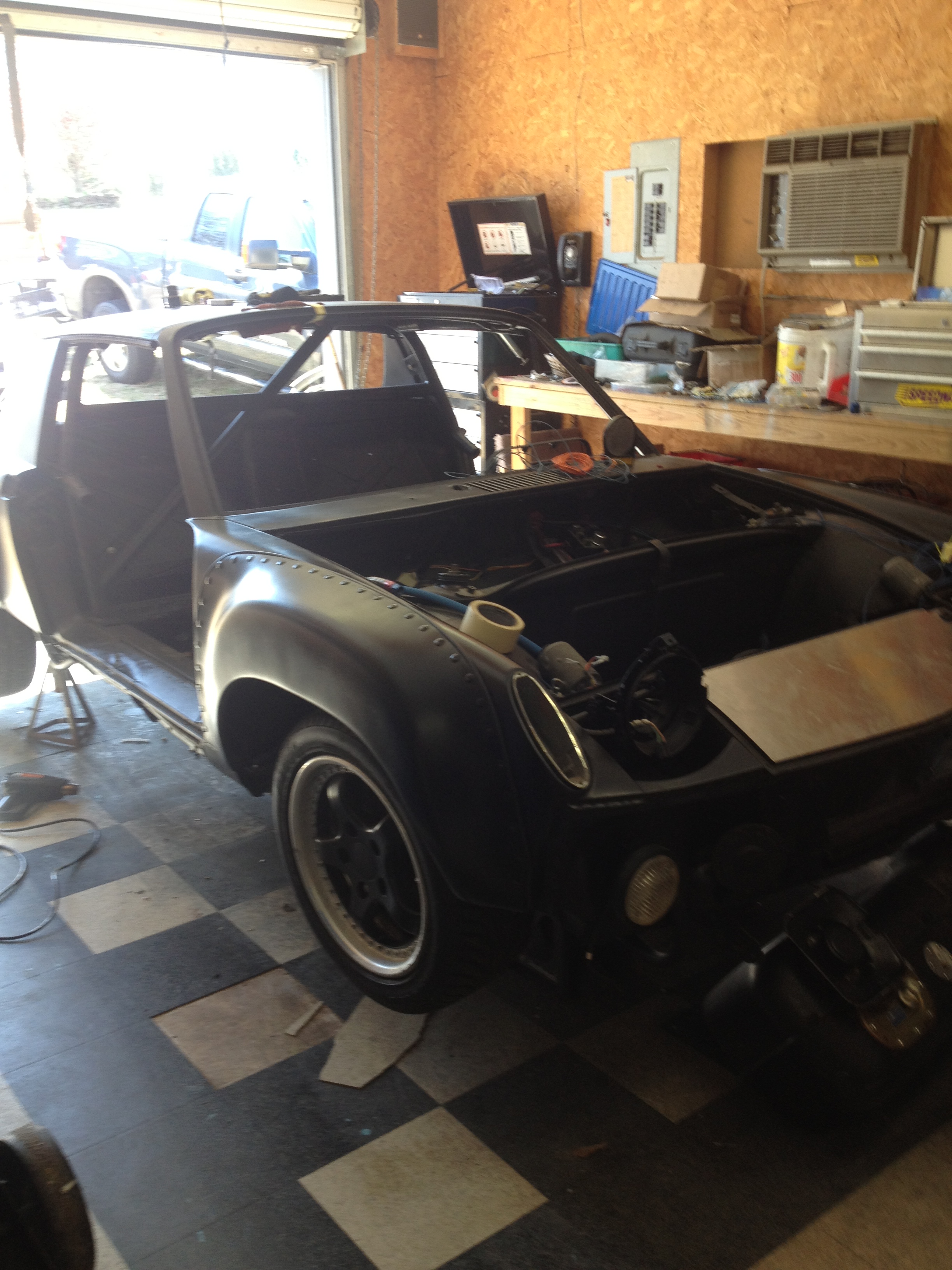

The long EPIC continues.. 6 maybe 7 years into it... Life does get in the way..
We move the car to Bob's house.... Thank GOD for bob or this car would never get done!!
Here it sits in its new home..
The engine is wired, plumbed and has the fuel lines in place..
Need a different Fuel press reg.. old one doesnt match up to he new fuel rails..
