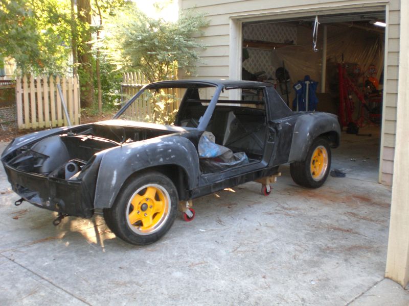

been working on my project for awhile now,, read a long time!!!!..latest update..she's not naked any longer...2 years of bare metal and now I started spraying...... First time.. I'm handling the primer on my own.. wacko.gif
He will be handling the final hot rod black..

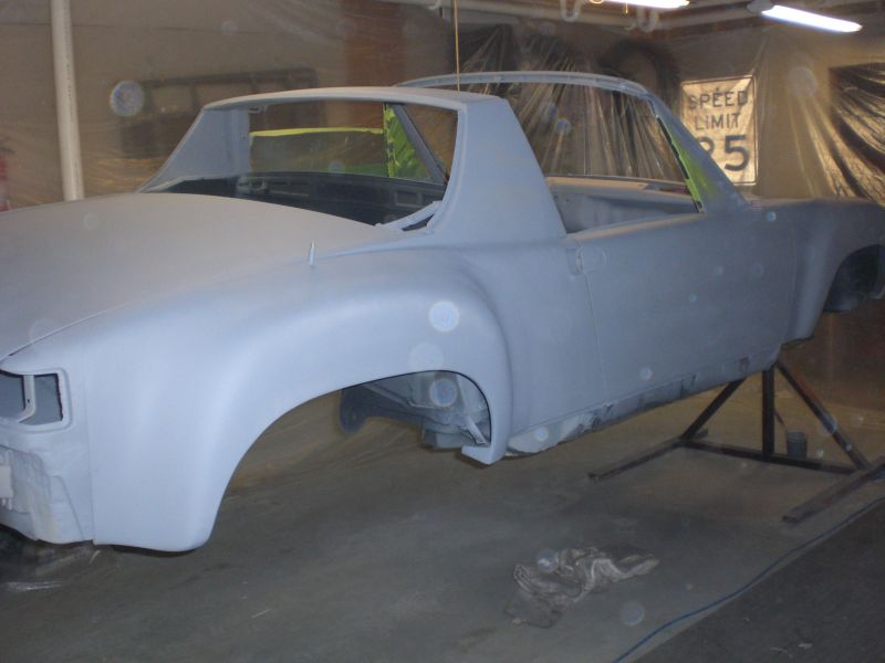

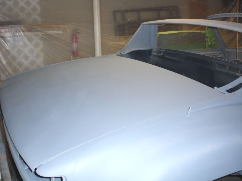

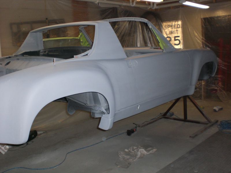

acid etch primer and the gray primer
d914

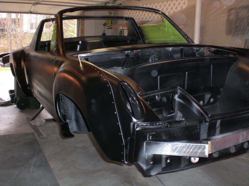

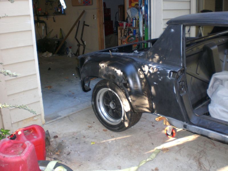

flares will have welting and be riveted on.. again fimal color, hotrod black..

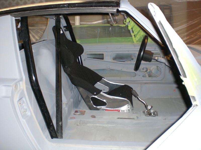

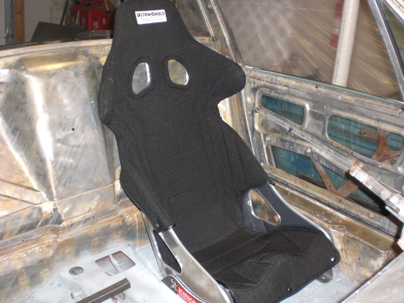

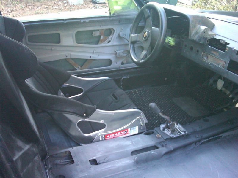

seats,,,ultra shield rally
d914

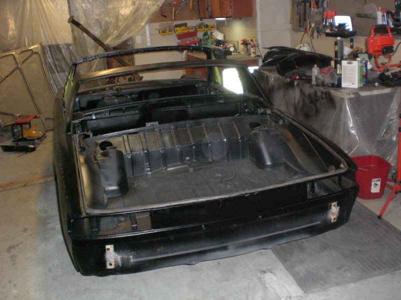

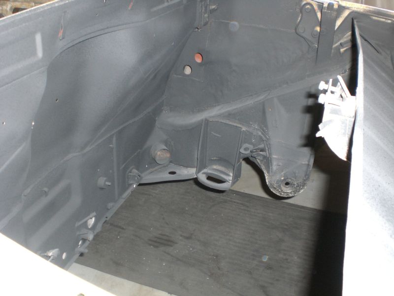

trunks, bottom and engine bay undercoated..

Nice project Greg! Are those the wider GT flares? Do you remember where you bought them? They look like a nice fit. Did you get the rocker covers to match? Can't wait to see it with paint. smile.gif
d914
yes normal are 7 and 9,, these are 9 and 12..various sources including AA for the rockers,, I believe they are AIR..

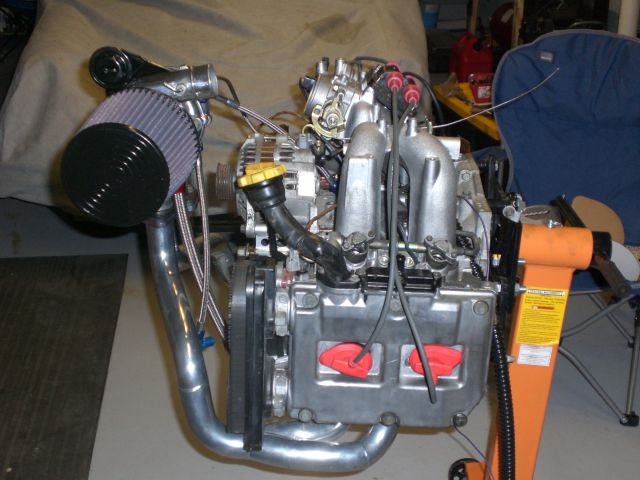

for old time sake...the engine..

What is that shifter setup? That looks delightfully better than the factory piece.
d914
Im using the suby tranny with a honda cable shifter from an accord..

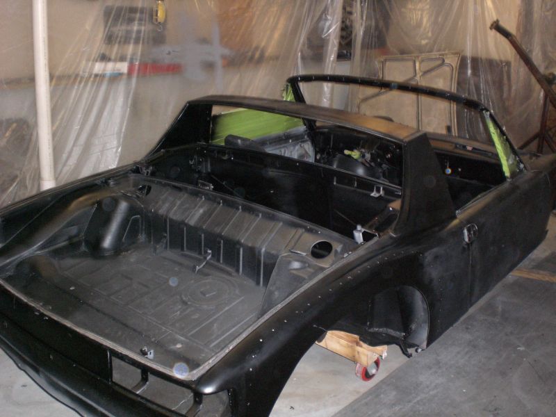

primed, sanded, bondo'd, trial fit the rockers, primed and I'll probably sand some more...I think Im slowly getting this body work thing..
The rockers are close.. I need to trim a little more metal and a second pair of hands would help with final placement of the flares..

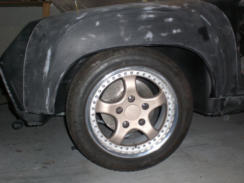

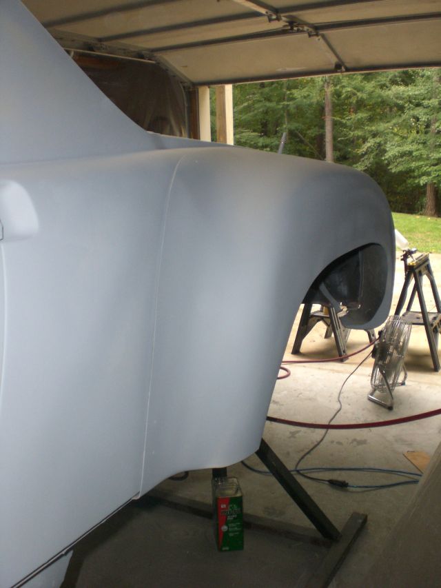

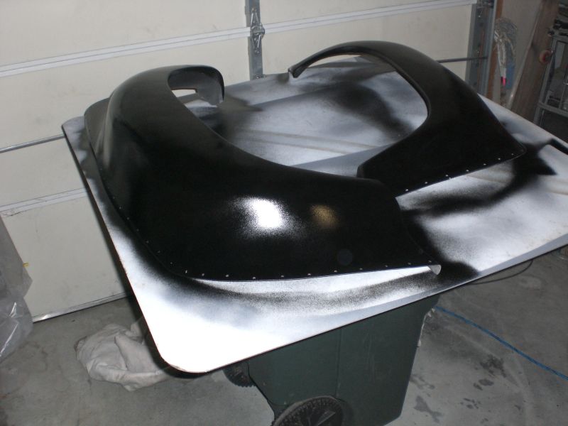

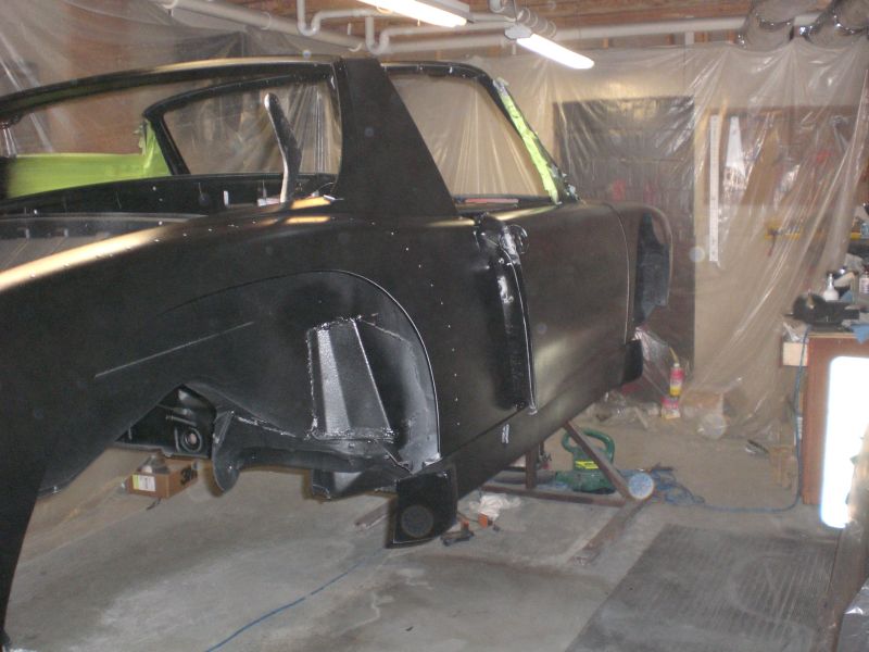

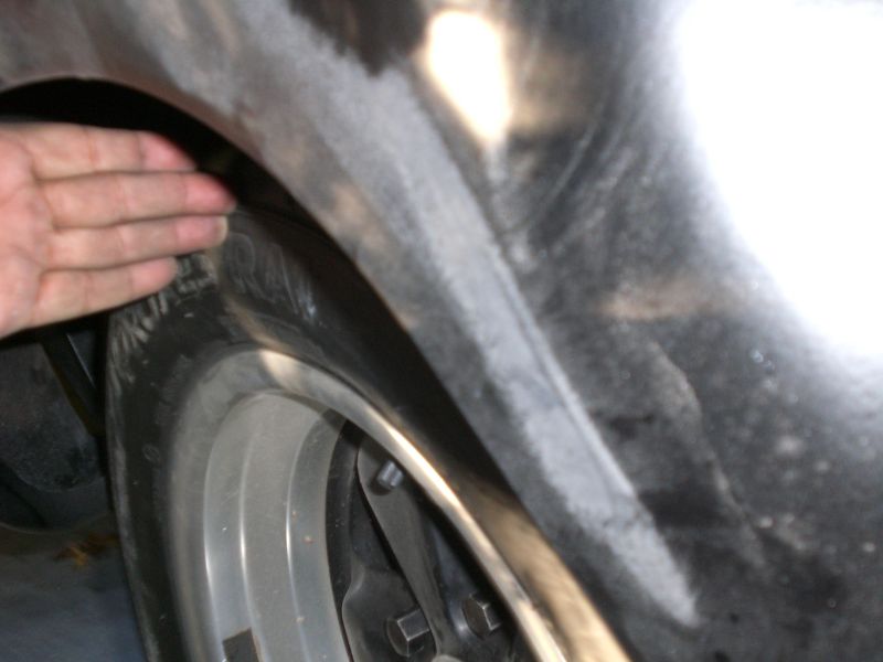

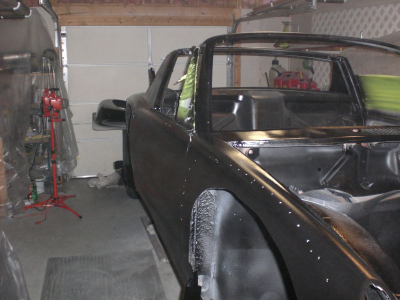

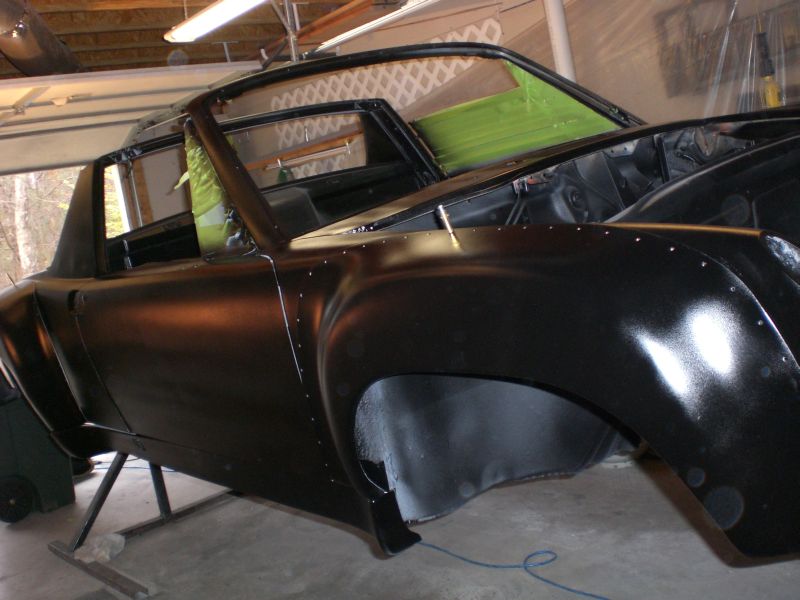

ok long time and no update, I finisged body work, did final mock up on flares and drilled likea thousand holes!! riveting on.. and broke out the paint gun unsupervised!!!!...
I know I have a couple fixes on the fares and Im sure I do on the car since Im verically challegned!! They will just have t wait until tomorrow!!

d914
definitly some touch up do,,daylight is not your friend!!!! Not too bad for my first attempt.. Mainly the flares need some follow up.. Here is some shots with the flares on with a cleco..

Im not going for a smooth polished finish,, hotrod black, vw fender welting and about 130 large head black rivets.. You can see all the holes!! Aluminum ralley seats, minimal interior..
Car is to be street and track oriented..

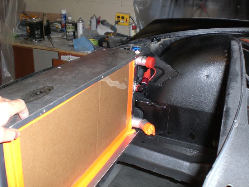

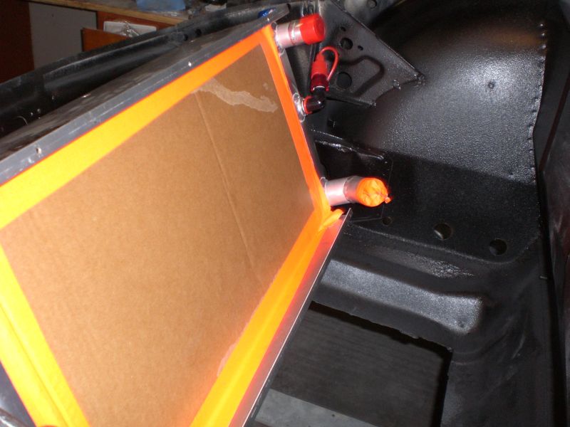

d914
went parts hunting in NASCAR country and came up with a deal on a 14 x 30 C&R radiator for $250!!
Also picked up some used ROCK Batteries form Roush Racing.. Drycell type.. One large and one small...Both for $50.....I'll try them out and see whats left in them.. They use them for 2 races and then call it a day.. They also had all kinds of used oil coolers and oil tanks cheap.. Most of the stuff is way too big for us..but there are a few diamonds out there...

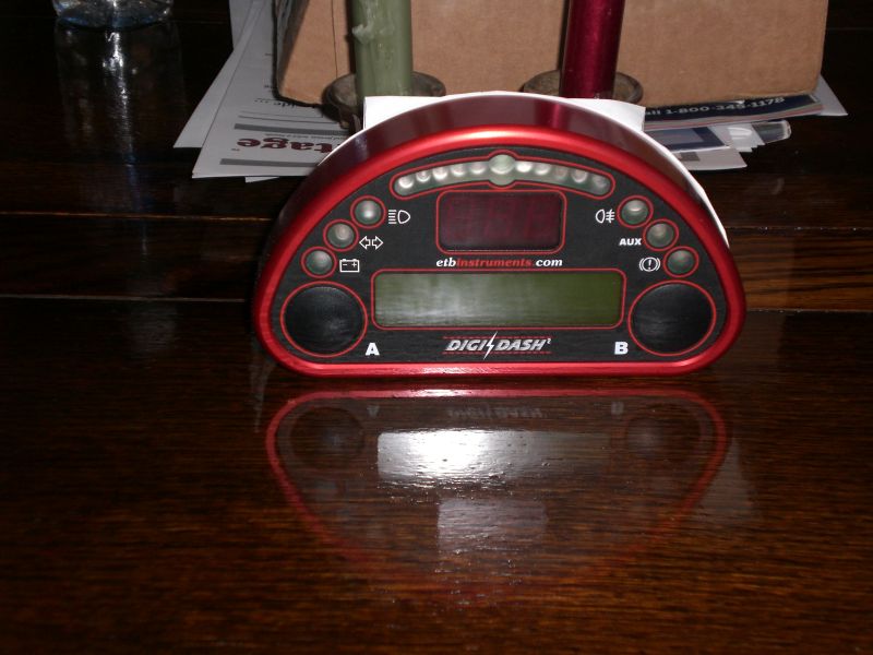

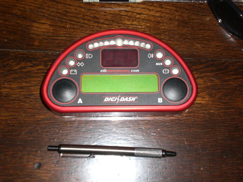

Merry christmas to me... I did a little more negoiating today and picked up an older version of a race dash w/ data logging for less than the street dash!!
Function Summary
Speed (mph / km/h selectable) (Maximum of 250mph or 400 Km/h)
RPM (up to 25,000)
Engaged Gear (calculation based)
Water Temperature (in ºC or ºF)
Oil Temperature (in ºC or ºF)
Oil Pressure (in PSI or BAR)
Auxiliary Pressure (fuel or boost)
Fuel Level (% Remaining in Tank)
Battery Voltage
2 axis G-sensor
Race/Track day lap timer with up to 32 split times
Elapsed race timer
Programmable Shift Lights (3 Modes of Operation)
Datalogger (17.3Mb)
Selectable Sample Rate for Recording Data (10-20Hz)
Brake System Usage logging
Programmable Warning Alarms
Maximum (Peak) Value Hold memory on all parameters
Odometer (total & trip counter)
Acceleration / Deceleration timer
Engine Hour Counter
Trip Distance Timer
Built-in SVA Compliant Warning Lights
BHP calculator
Technical Specifications
Operating Voltage - 8-16v
Max Power Consumption 400mA
Dimensions:
Datalogger Box - 120mm x 110mm x 36mmDisplay - 160.4mm x 89.8mm x 28mm
Weight - 600g
Ingress Protection Rating - IP54

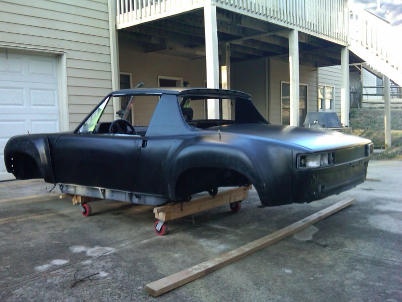

finally off the rotiserre(sp)!!!!! Still needs some paint work but she is on the floor again.. in between finishing the paint I can start to bolt things back together!!!
slowly but surly making progress....

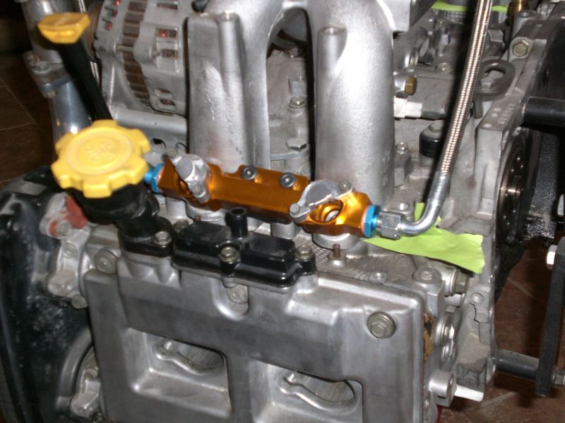

Bought the pcv breathing set up,, bypass feeding back into intake.
lighter crank pulley
Going the circle track shop on Mon to if they have some coil overs for my koni reds and any deals on brakes.. They are getting out of that business.. Cash discounts!!
JDM spec fuel rail for side feed injectors, a little bling and a little simplifing the fuel system...besides I like -6 vs hose clamps,, I'll have one out back and two upfront.. My breakpoints will be -6.

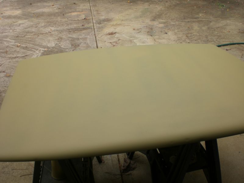

mercy post!!!! By the way I still suck at painting!!! The only thing I can seam to manage is a beautiful textured ORANGE PEEL.... Im a frigging artist at it!!!!!!!
When I get done sanding either you or someone is going to paint this sucker....#@#&*%^^&&*&$$%^^&**^&%$$!!!!!!!!!! But not me!!!!!
charliew
Try thinning the paint more. Usually the paint is going on in too big of drops when it is op too much. Try more air pressure also, a long hose really lowers the pressure. Are you using a 3/8 id air hose and how long is the hose. Turn up the pressure at the outlet at the tank and adjust the regulator at the gun. If the paint is setting up too quick and not leveling out, because of higher temps, use a slower reducer or thinner. Course you've got to sand the op off for a smoother next coat. You will waste a lot of paint sanding most of it off. Mix up smaller amounts of paint and experiment with it till you get it right before you paint the whole thing.

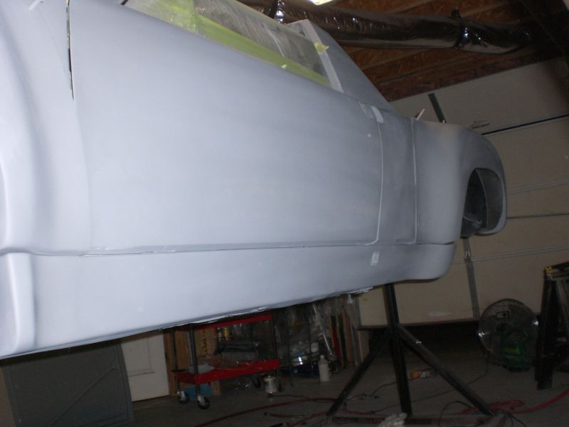

my revolutions.... I have 4 fuchs 8x15 for track... Street I'll need some 17x9 or 10's..
I sanded down all the orange peel from the first time around.. I'm going to wait a bit before I respray... Im a clumsy as hell so I'll get closer to all the main work done befor I paint again.. Plus it will be a bit cooler..

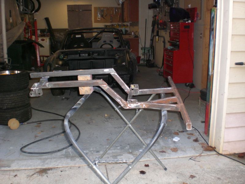

Britain Smith

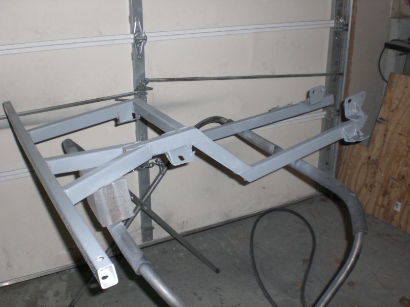

Do you have an pictures of your engine cradle?
-Britain

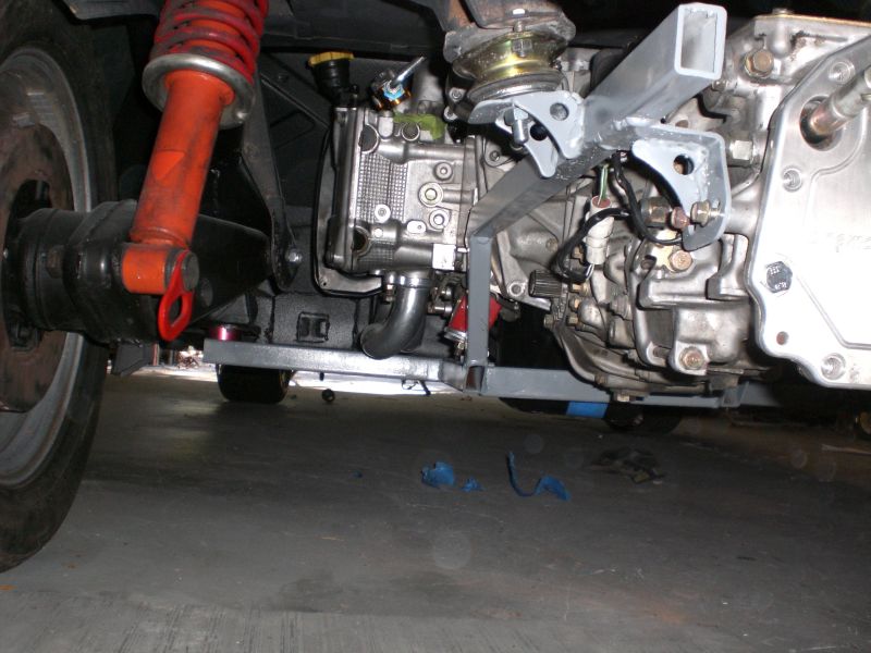

d914

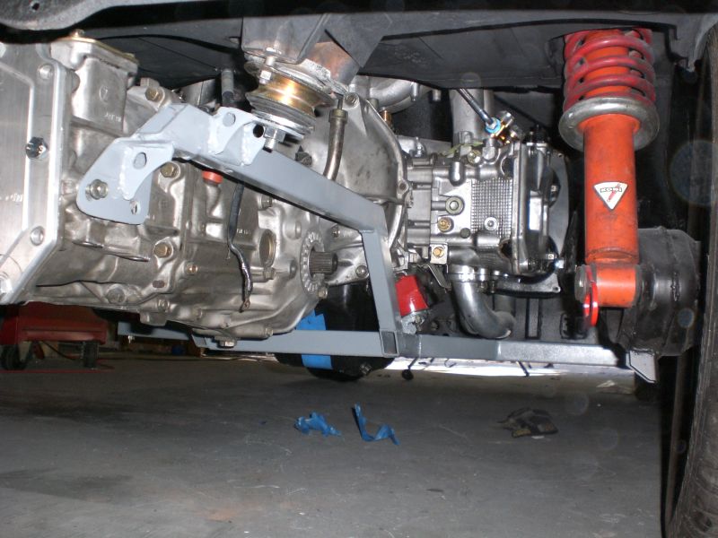

I will this weekend. I have to pull it, sand it amd paint.. I'm not sure this was the easiest approach. This was our first attempt, then put to the side for a while. We did Bobs 3.3 six then resumed and finished mine.. Bob's is a three piece unit versus my one...
I think if we did another it might be the small car bracket plus our fabed tranny mounts...It would save alot of time..
d914
engine bar done and being sanded and painted
upside down

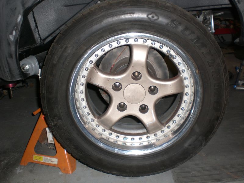

picked up a set of three piece wheels...16" 8&9's... unknown manufacturer..
only info on back... Made in Japan....F-206
Im going to paint the centers black,,, and give the rest a good cleaning

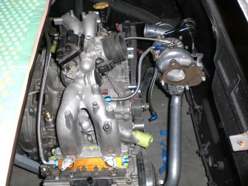

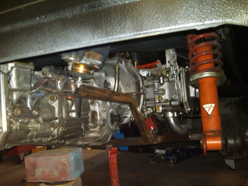

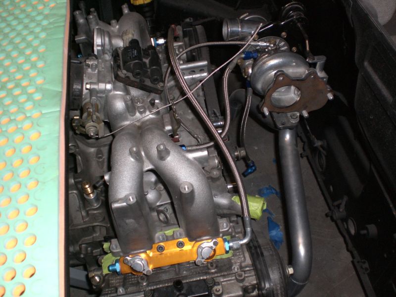

engine in and mocked up two ways..
First intake forward.. To do this must move alternator( I have the bracket) raise the turbo and run a 180 turn in the intercooler.
the other is to run with intake to the rear.. I think I have room of the pipes.. I can still raise the turbo a little , to make pipe angles easier, and hvae a 180 in the back with a straight thru intercooler..
d914
engine bar back in

d914
I took out the engine tray to keep things clean and give some better access.. I could so something like that and use fasteners to drop out of the way for service...uummmm phase 2... I need this thing on the ground and under power for some fun.. its been drug out way to long..

QUOTE(d914 @ Oct 31 2010, 09:29 PM) *
the way you built the engine frame, it's easy to make a flat bottom!
