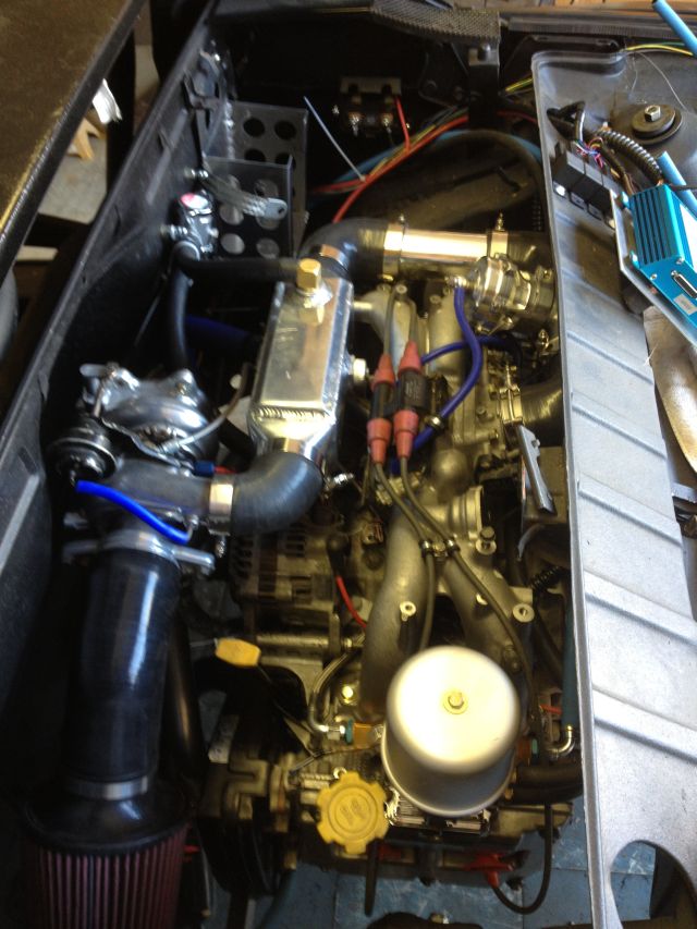

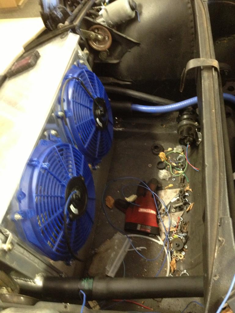

Radiator is in and plumbed..
Re-designed the intercooler set up ... much neater, Thanks BOB!!

I believe I will be using a thermostat vs. the restrictor plate... warming up would have been am issue..

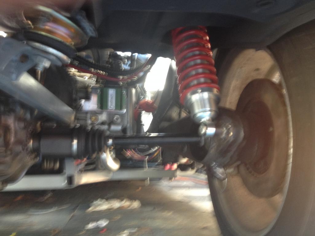

Played with the car a little today.
installed Racer Chris Swing arm Brackets
installed Rebel racing mono balls for the front struts
Built and test fitted custom axles ( half suby/half Porsche)
Mocked up the modified dash
pics a little later

d914
post Aug 4 2013, 04:04 PM
Post #91
Posts: 2,350
Joined: 12-July 03
From: Atlanta, ga
Member No.: 904
sorry only blurry shots of this..

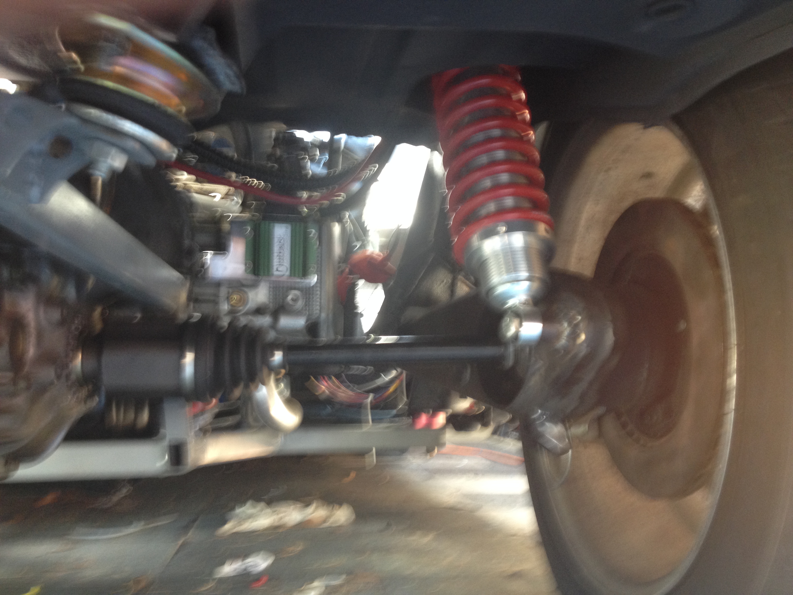

New shocks,, Rebel racing tops, UB Machine bottom. Bilsteins with coil overs.
