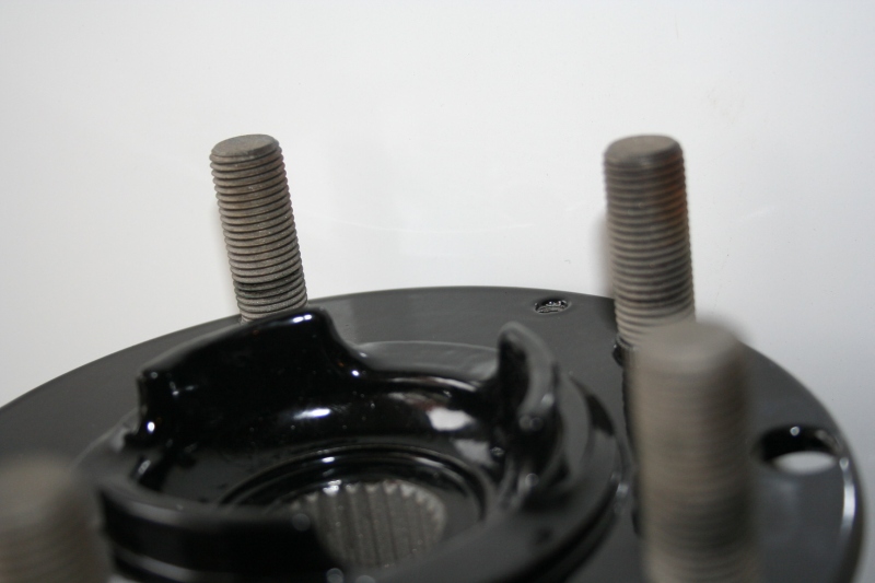

I am doing some work on Felix's (neo914-6) rear trailing arms, they are freshly powdercoated and look nice...however, my concern is the powdercoating on the rear hubs.
In the picture you can see a lip due to the coating....when measured using a flat edge, I can get a .0025" feeler gauge under the flat edge in varied areas of the hub.

never paint or coat any machined surfaces.... like where the wheel mounts...
sand it off?

Thats barely more than one hairstrand. So whats the problem? Dimitri

If it is thicker on one side than the other the wheel will not ride true. Not so
important at slow speeds but.....

Ask Felix first, of course, but I vote chuck them up in the lathe and take off the P/C on the mount surface.

Plated parts are fine, but painted parts in that area are a bad idea.
Hubs have to be absolutely flat and true. I spend a lot of time cleaning the hubs before mounting a brake rotor. Even a tiny bit of dirt is bad news there. You have to treat them like cylinder walls, CV joints and bearing races.

.0025" is not a problem. Think about it, what are standard maching tolerances? Read a current car manual and look at what is acceptable runout. Put it together and don't worry.

A 2" or 3" scotch brite disc in a die grinder will take the powder coat off pretty easily.
BTDT
It will be a hassle getting around those studs though.

Mike, just knock the studs out of it and run a flat file across the face it until its level. Should be fine.....If you are worried, you can tape it off and use paint remover on the face. It will take it right off.

Bottom line is you're gonna have to remove the paint, and do it in a manner that ensures the wheel will run true. The Cap'n

Jasco will remove powdercoating. Let it sit for a while and remove the powedercoating with a putty knife.

You probably should clean it off but I bet the rotors are off by at least that much if not more.
