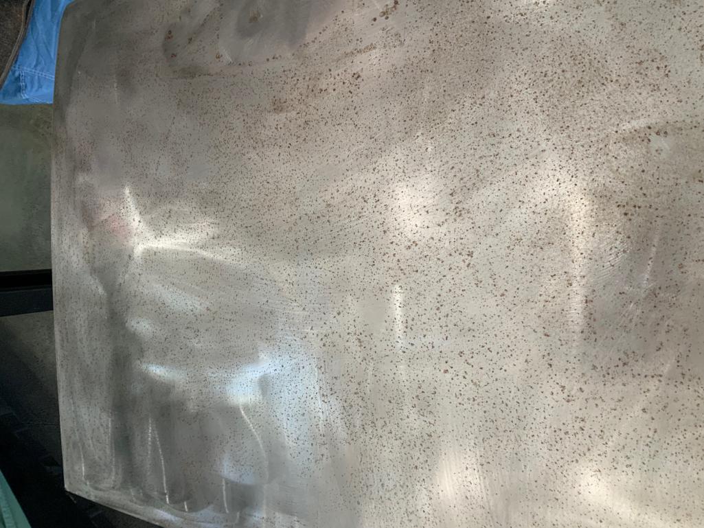

Jett
post Dec 30 2023, 10:20 AM
Post #16584
Posts: 1,699

Continuing to strip the BB, getting ready for the body shop.

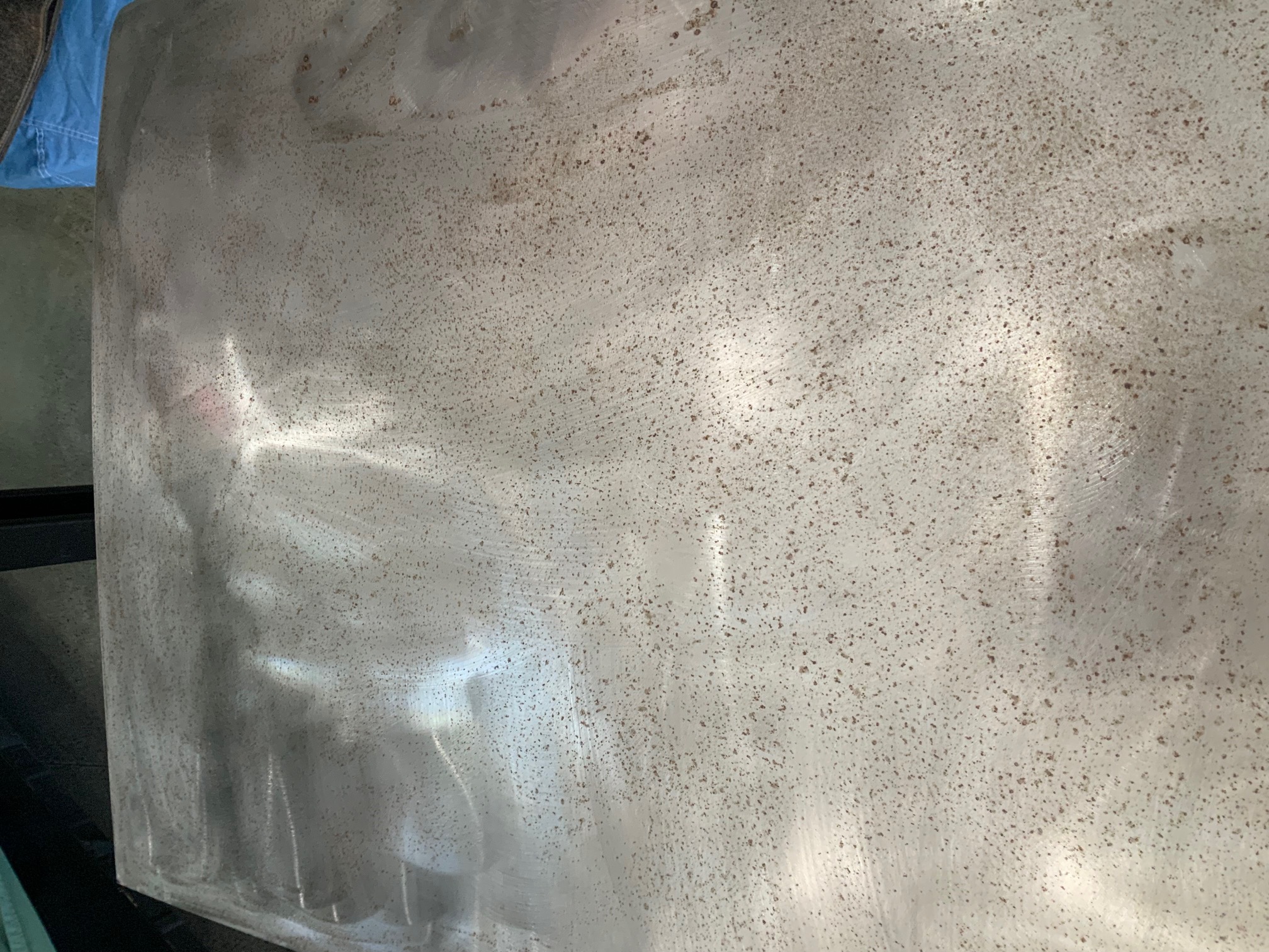

QUOTE(Jett @ Dec 30 2023, 08:20 AM) *
This maybe hard to believe but this rust was under the primer, also saw what appeared to be a couple of small spots of surface rust under the stock rear shock tower seam-sealer.
The trunk panel appears to have been sanded, and then primed… is it possible that the sanding was done at the factory to remove rust before painting?

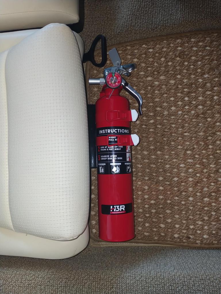

I put in a new fire extinguisher in the Blue 2.0
Thanks Ben ( @mb911 ) for the mount.

From: Buffalo
Member No.: 24,877
QUOTE(Jett @ Dec 31 2023, 05:28 PM) *
My '75 example had the same sort of rusting, but it was in a spider pattern. The finish paint did not indicate any issue with the base. Glad I got down to bare and I'm sure you are too
Jett
post Dec 31 2023, 07:18 PM
Post #16595
Posts: 1,699
Joined: 27-July 14
From: Seattle
Member No.: 17,686
QUOTE(930cabman @ Dec 31 2023, 03:38 PM) *
Exactly!

QUOTE(Jett @ Jan 1 2024, 10:28 AM) *
Interesting as my car has started to pop under the paint in the same pattern ,I seem to think I have that issue but not all of the car ,however my car was fully repainted back in the late 90's so maybe sloppy work and the fact the primers weren't waterproof like the epoxy around now (IMG:style_emoticons/default/confused24.gif) .
Wonder if light media blast would remove the rust spots ? .

QUOTE(mmichalik @ Dec 31 2023, 03:15 PM) *
Very glad those worked. I am having 50 laser cut right now. Should be ready in a week or 2
