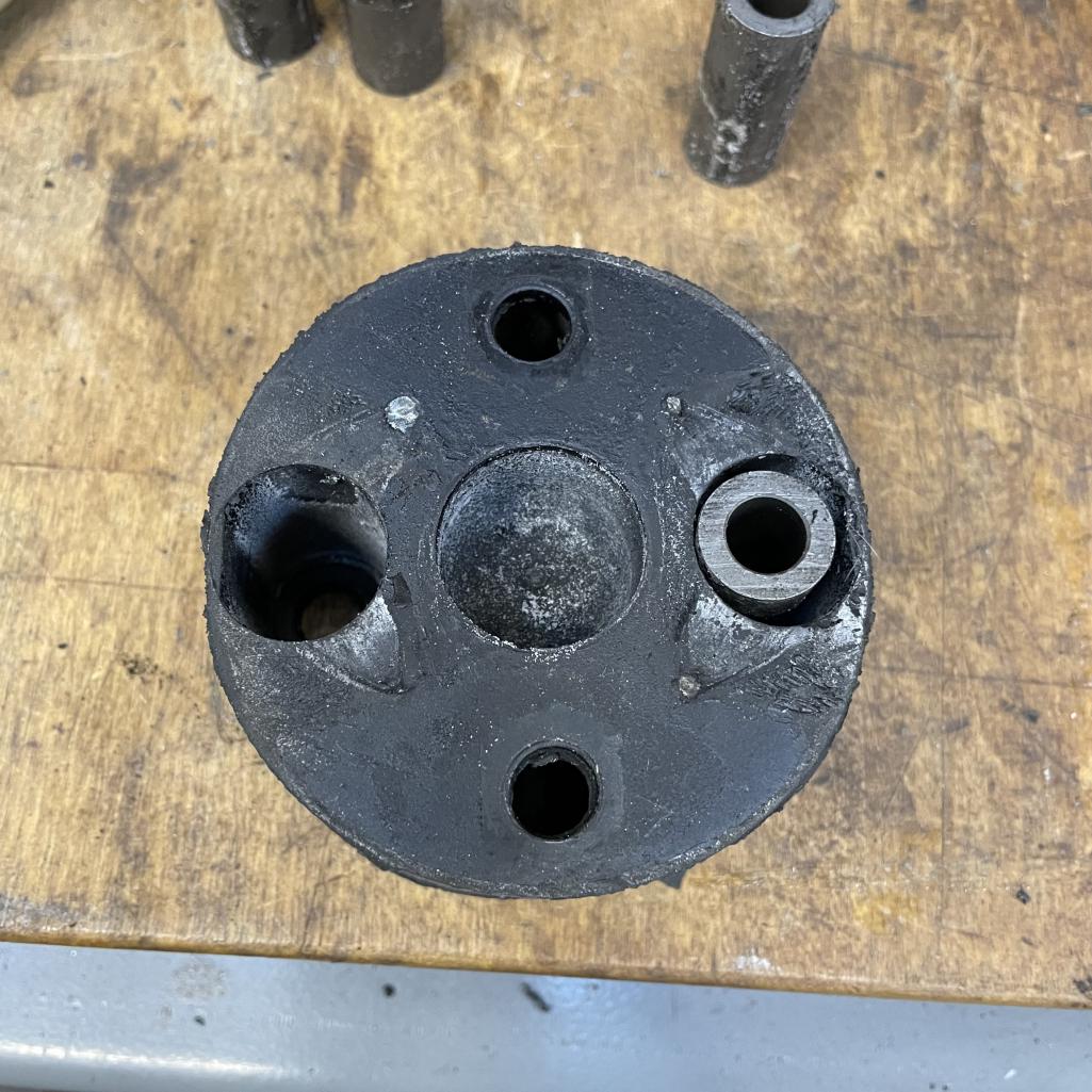

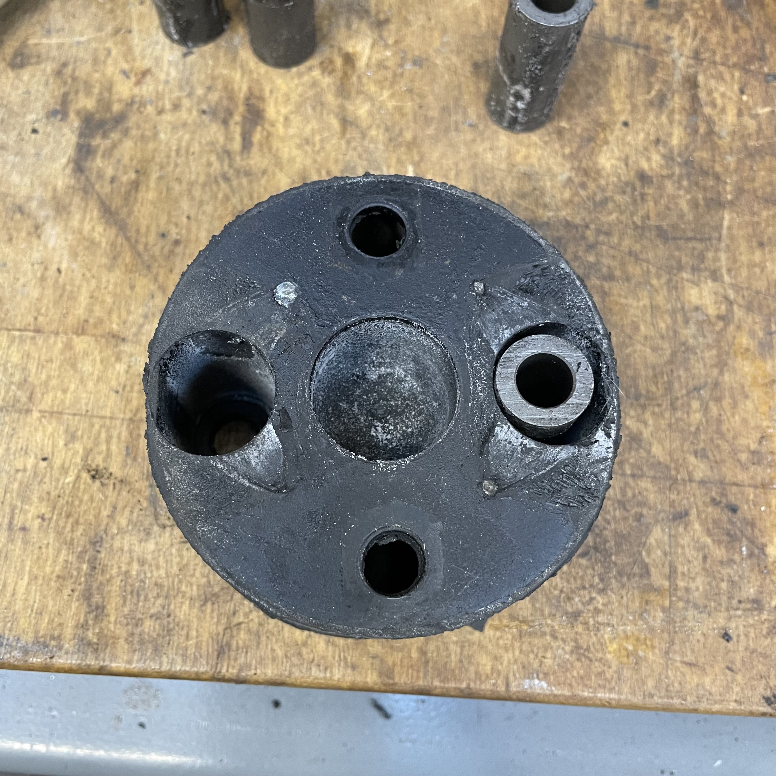

Pulled the rack, after all. The gas tank was already out. Happy that I did - the holes in the rubber puck were wallowed out and the "bushing" with the pin bearings looks pretty cruddy (and scratchy sounding when spun on the shaft).

I purchased a bushing made from Delrin I think from Tangerine Racing.

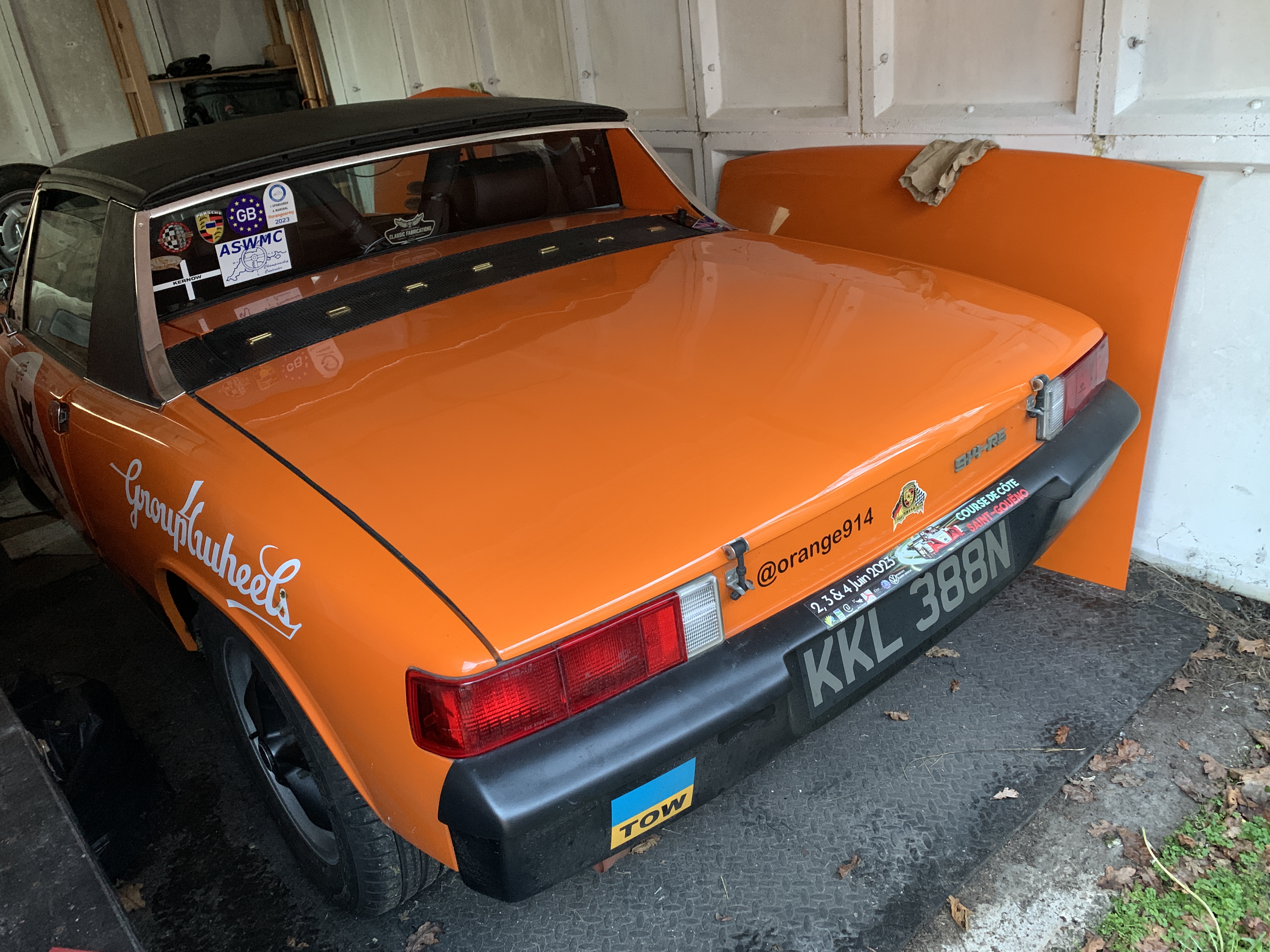

Reinstalled lightweight trunk lids which had spent the last year matt black with stripes, now redone in Nepal Orange to match the rest of the car.
Standox paint scanning technology meant a perfect match for the 20 year old US-applied orange!

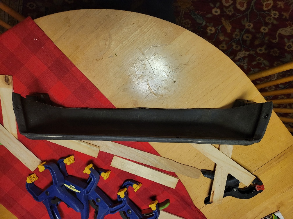

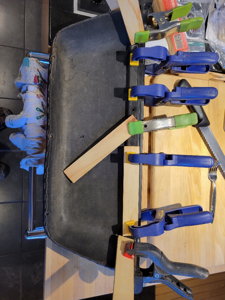

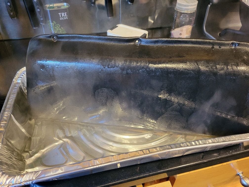

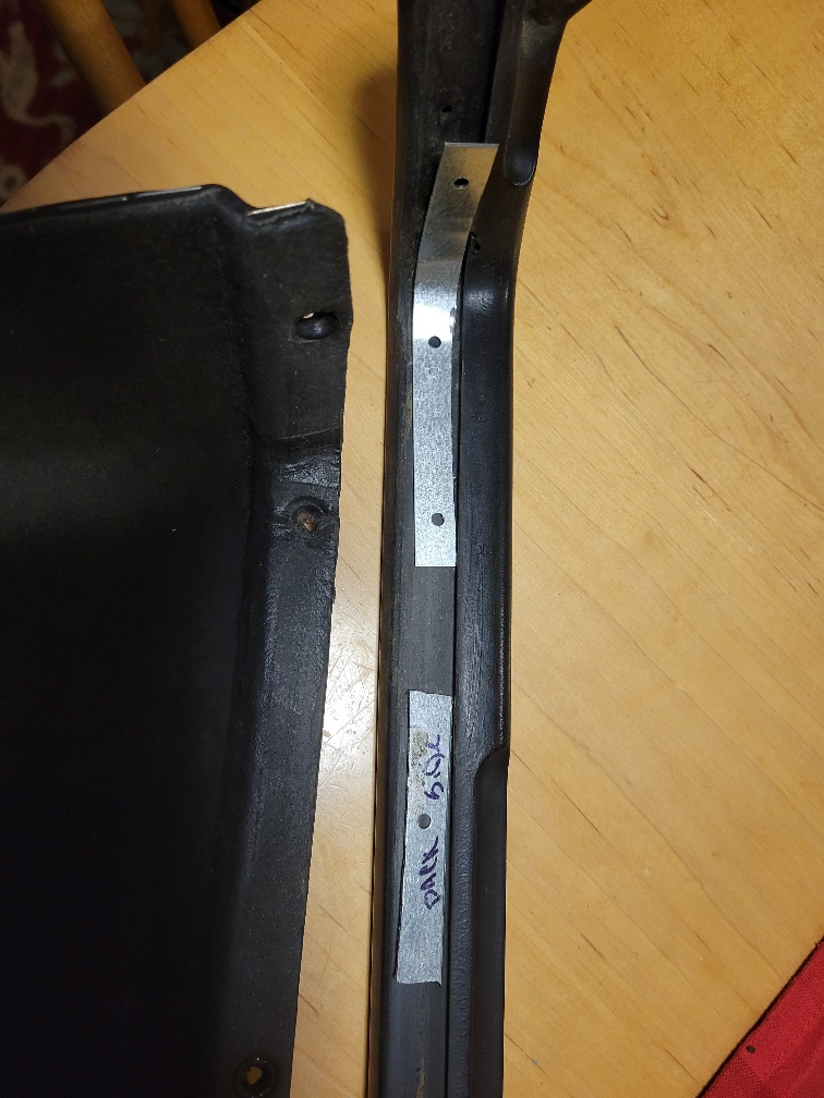

Digging into my doors and found that my drivers side map pocket had gotten wet ober the years warped badly and ripped out 2-3 screw mounting holes in the "fiber board" that it is made out of. Trying to think of ways to save it and I hit upon remoisturizing the pocket and realigning it.
I dinked the mounting edge in steaming water and used the mounting bracket as a template as it dried. I dipped it 2 x and let set for a few days. The mounting edge returned straight and true and the augered out mounting holes closed up enough that I won't have to use the plumber's tape back I thought I would need to remount!

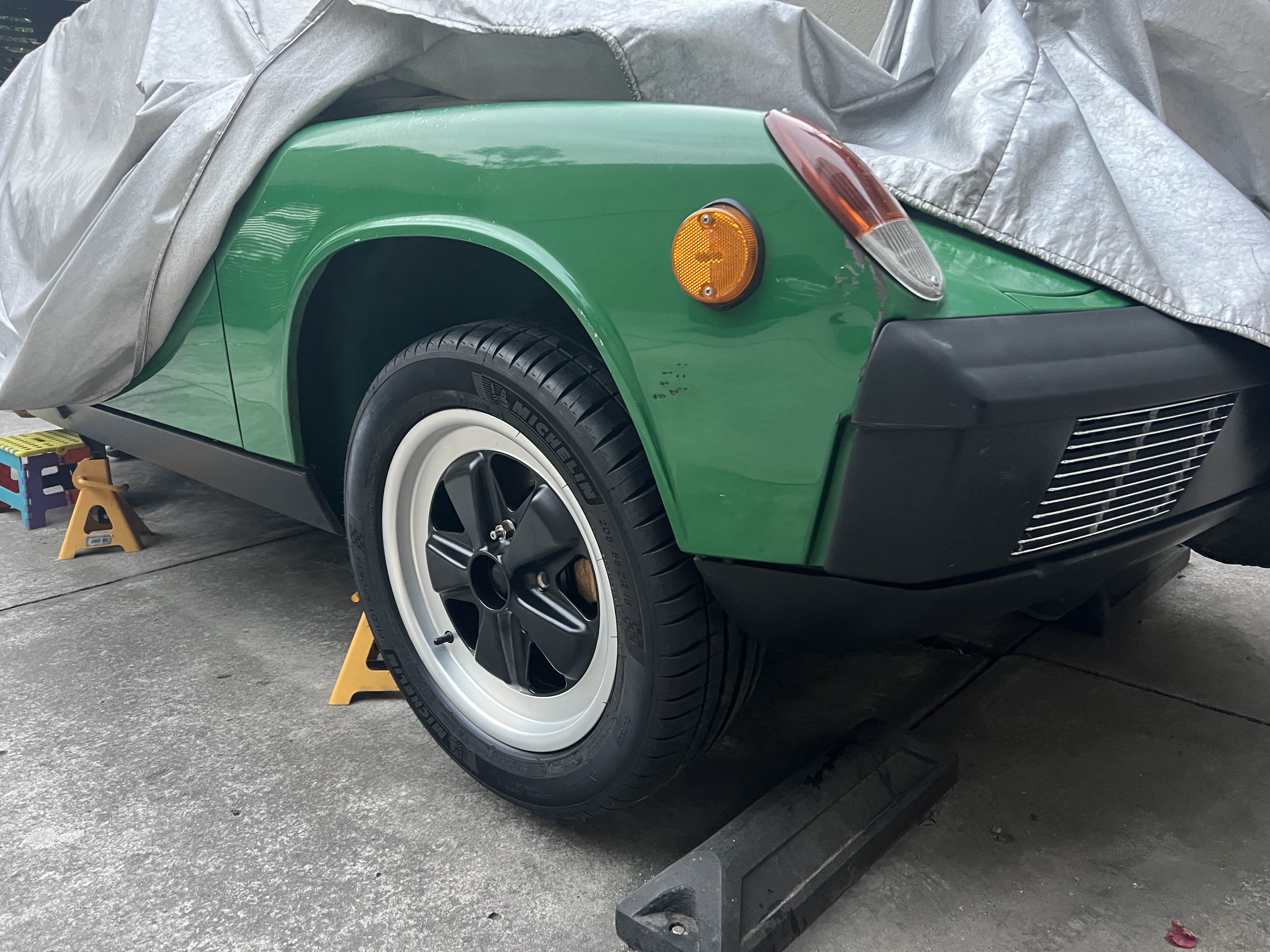

Got myself a pair of maxilite wheels in 16”x6” to measure and define the rears…
Got some titanium nut & bolts and we are waiting for the PMB 5 lug kit to arrive.
Next best thing to an original bent and fixed Fuchs.

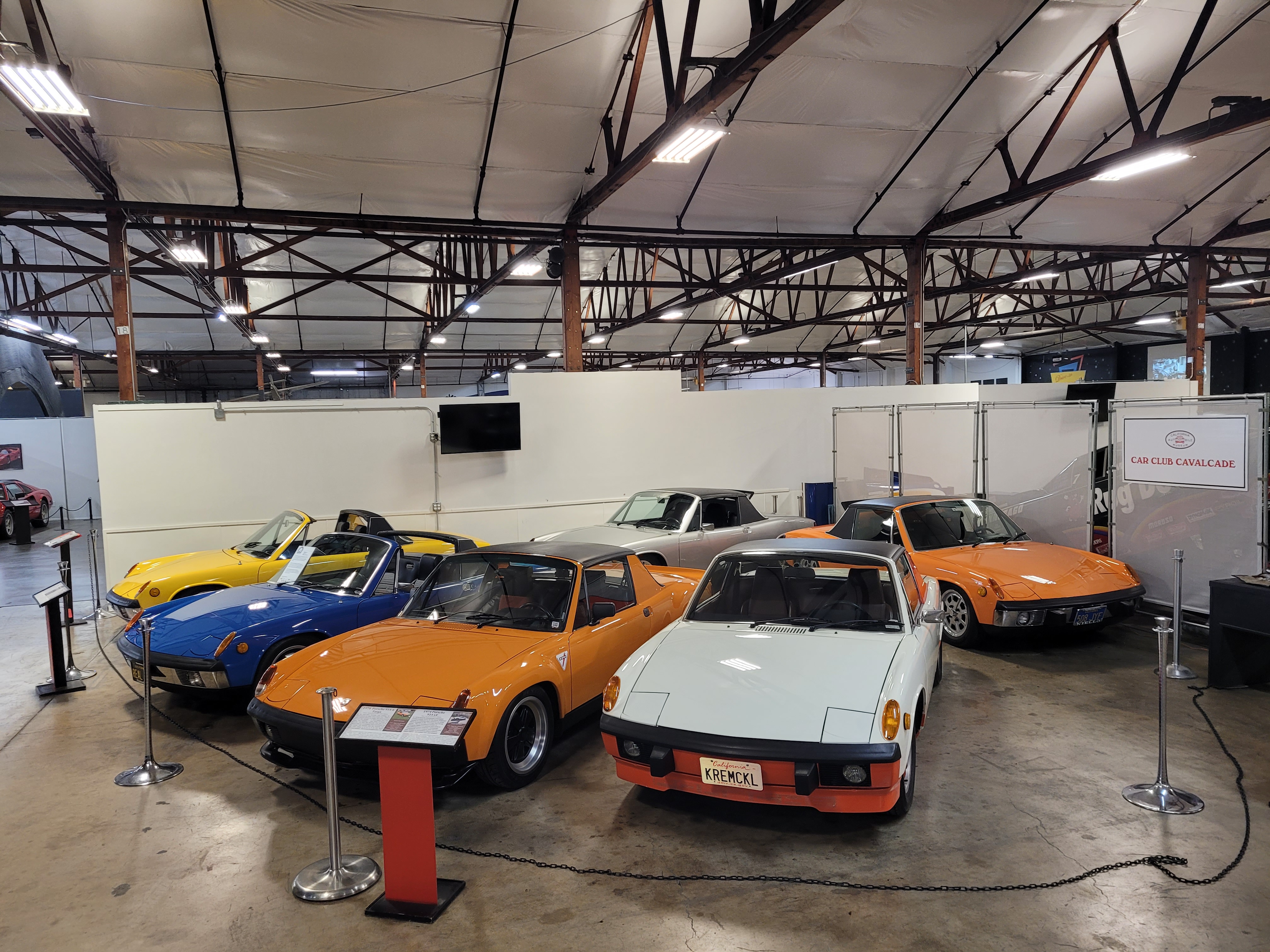

Missing my car - on display at the California Auto Museum for 6 weeks Attached Image

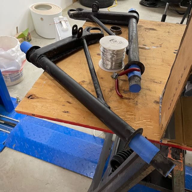

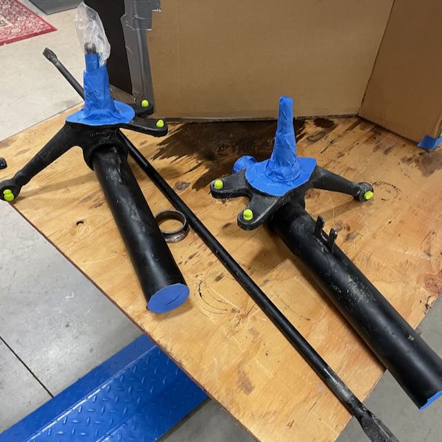

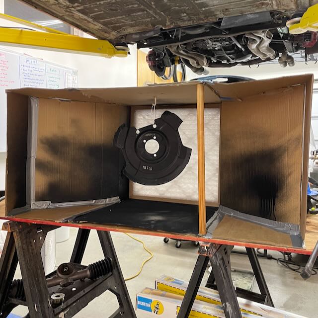

Masked off parts from the front end and enlarged the "spray booth" to fit the bigger bits.
