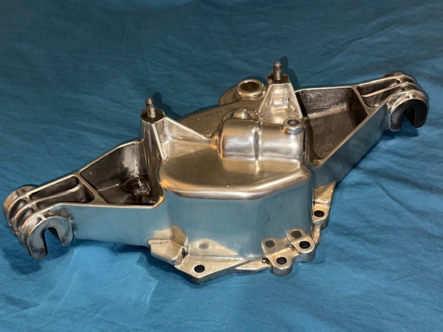

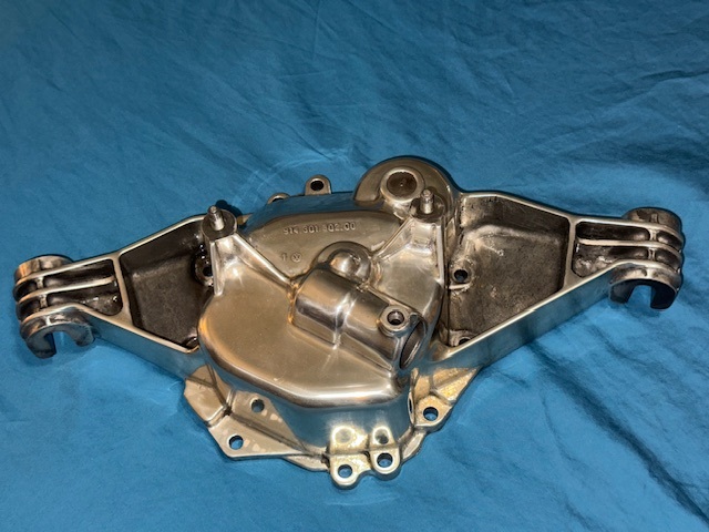

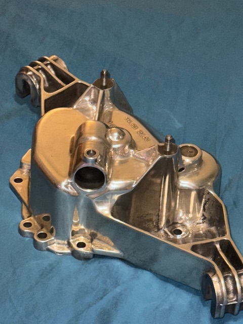

Got the polishing done and it looked great for my first time polishing magnesium. Two hours later it was begining to show a fog that didn't wipe off. The internet tells me mag is highly reactive to oxygen. Enter clear high temp engine paint. So it was re-polish the piece, run inside and wash off the piece with degreaser soap, dry it quick and spray it. I had the path clear to the oven since it took two hands to move the piece. Not sure how well it is going to stay on but after baking it doesn't look bad.

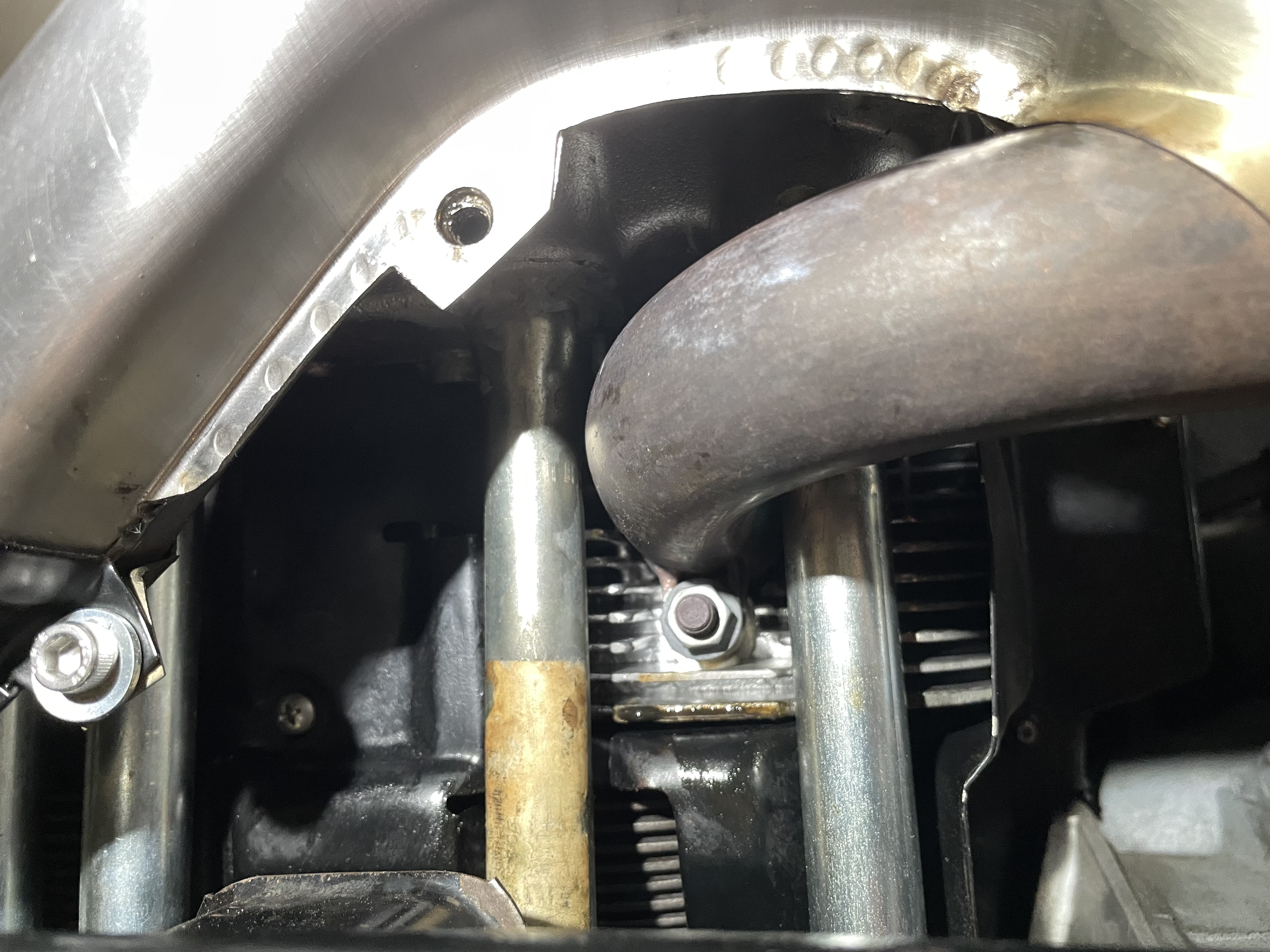

and i think i said that wrong above, that drip seems to be coming from between the cylinder and the head shown here int his picture, but i may possibly be seeing a seeping from where the cylinder and case interface as well, but mainly here , above picture is the driver side , this is #1 .- question is , should i drop the motor and trans and get this checked? its easier to do the valve adjustment with it out too anyway, and that way i can actually leave the exhaust and transmission all together in one piece. and while that is out i can have the engine lid hinge brackets replaced since they are cracked. which means i might as well go ahead and finally repaint the whole firewall......

I would pull it and it sounds as though you've got the rest of it figured. Any chance you can run her on a test bench? prior to refitting? Would be a good check for oil leaks

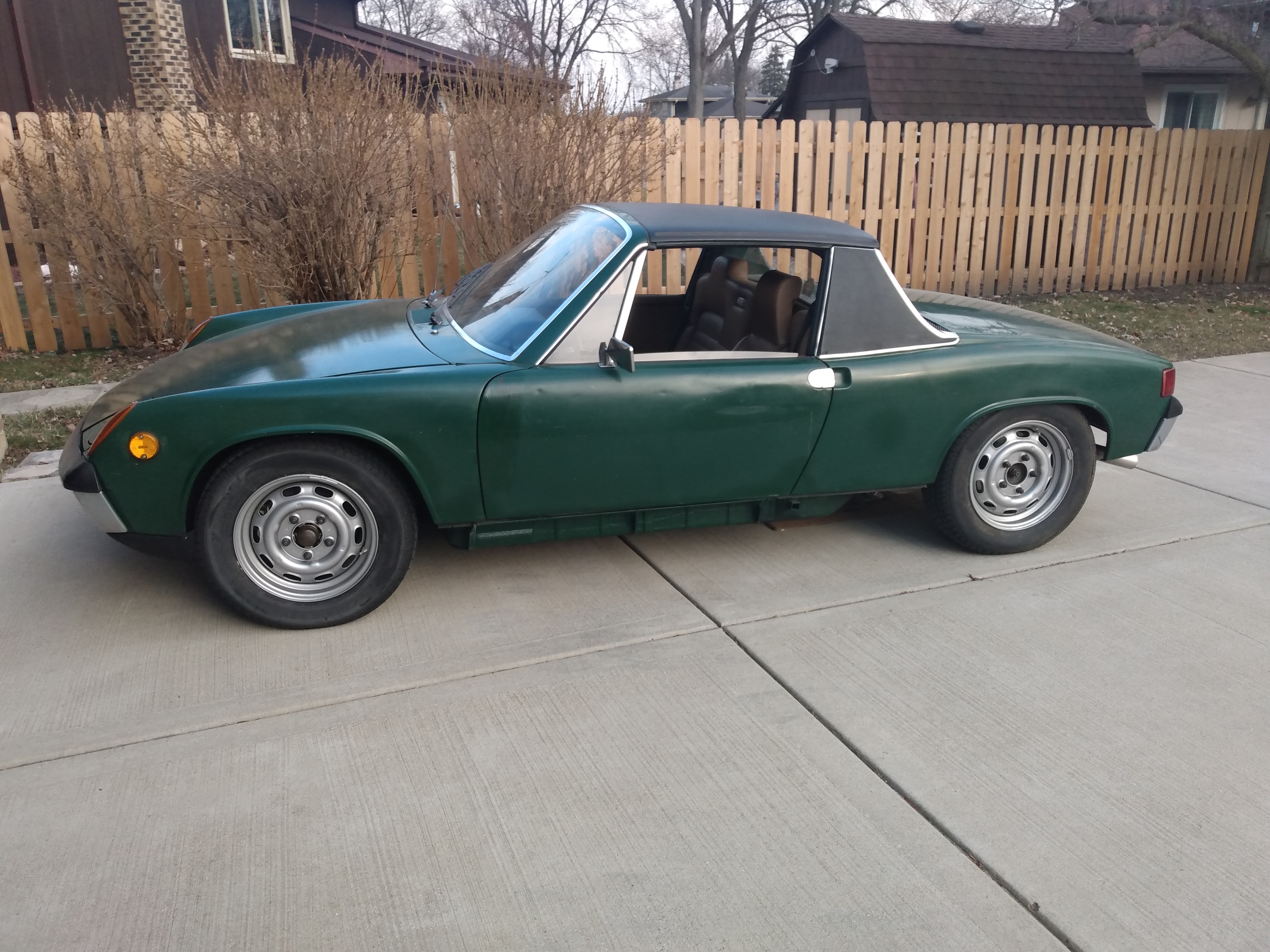

Drove it for about a half hour over suburban 'back roads'. First time she has been out this year. Hit 75 degrees in Chicago today.
