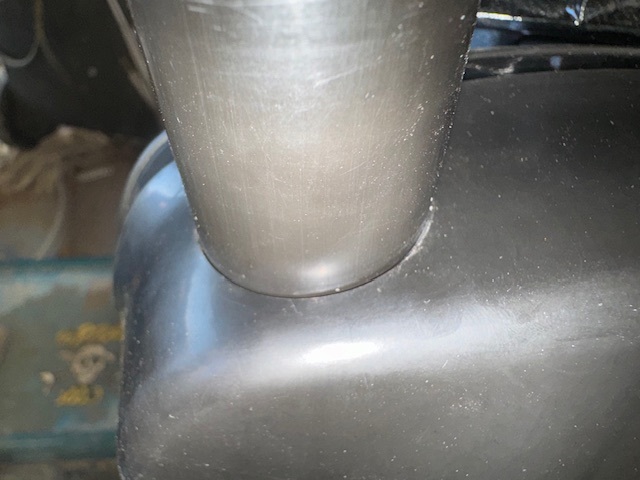

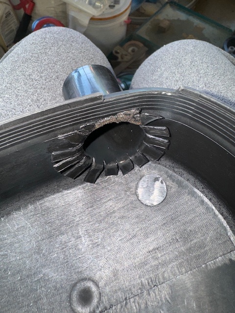

QUOTE(mb911 @ Mar 8 2024, 01:47 PM) *
QUOTE(Shivers @ Mar 8 2024, 01:36 PM) *
It's not pretty but it is strong
Umm as a professional welder/fabricator I will pose the question how do you know that’s strong?
Maybe I should have said it is more than strong enough for the job it will be doing...But I did try to break it off, it is not budging. (IMG:style_emoticons/default/smile.gif) Guy said the aluminum cast from those days is crap, full of impurities and oils and it was hard to weld. Had to have recieved good penitration, I had to sand the console to flatten out the cast where it raised from the weld. Yeah it's ugly but it's on there

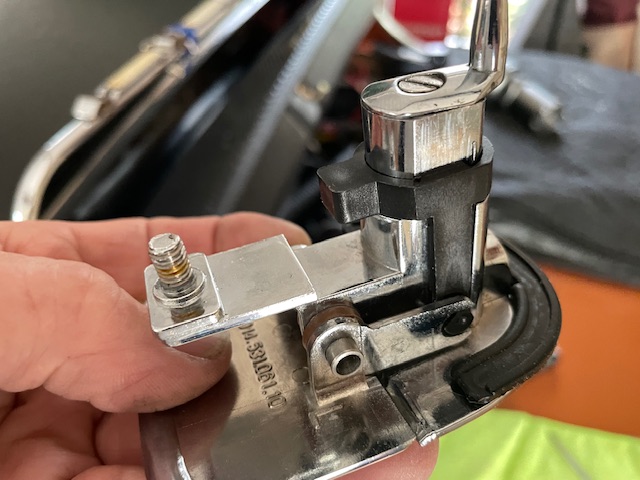

I removed my driver's side door panel today and repaired the door handle (replaced all broken plastic bits) and removed and lubed the latch mechanism. Then I drove her for about 2 hours to enjoy the fruits of my labor.
Tomorrow I need to replace the broken horn button ring and faulty wiper switch.

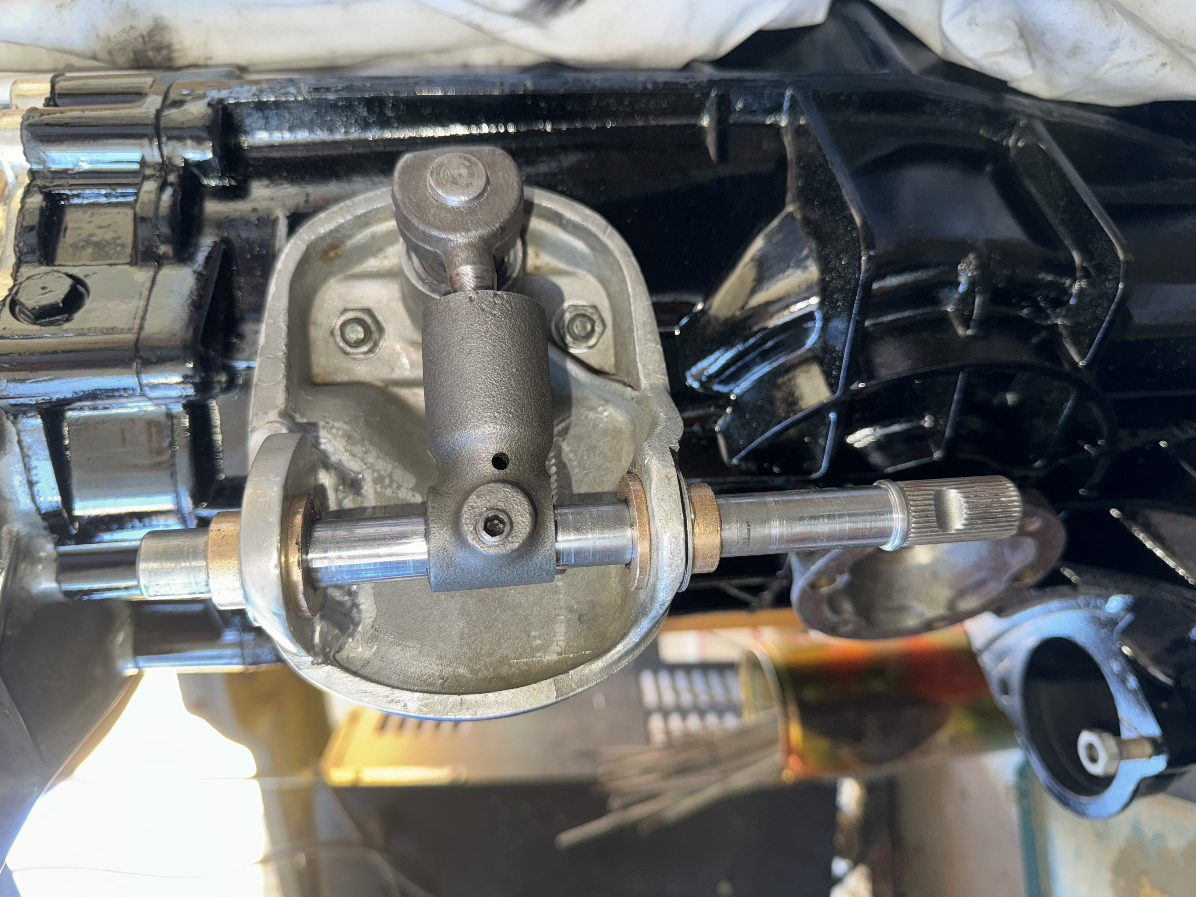

I’m using a steering column shaft to finish the console but it has to be turned down and a cone screw hole put in and the trans portion will be done. So off to find the cheapest machinist in the Coachella Valley. (IMG:style_emoticons/default/biggrin.gif)

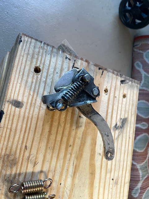

So many projects, so little time.
going to be doing the same and pulling the door card this afternoon so i can repair the latch mechanism, as soon as my package of small repair parts arrives from 914rubber, the cam actuator thing that slides and unlatches the door when you pull the outer handle snapped off last week while in Amelia making it necessary to use inner handle only for opening door. That was supposed to arrive yesterday. So full out rainy day meant cancellation of our C&C for this month.

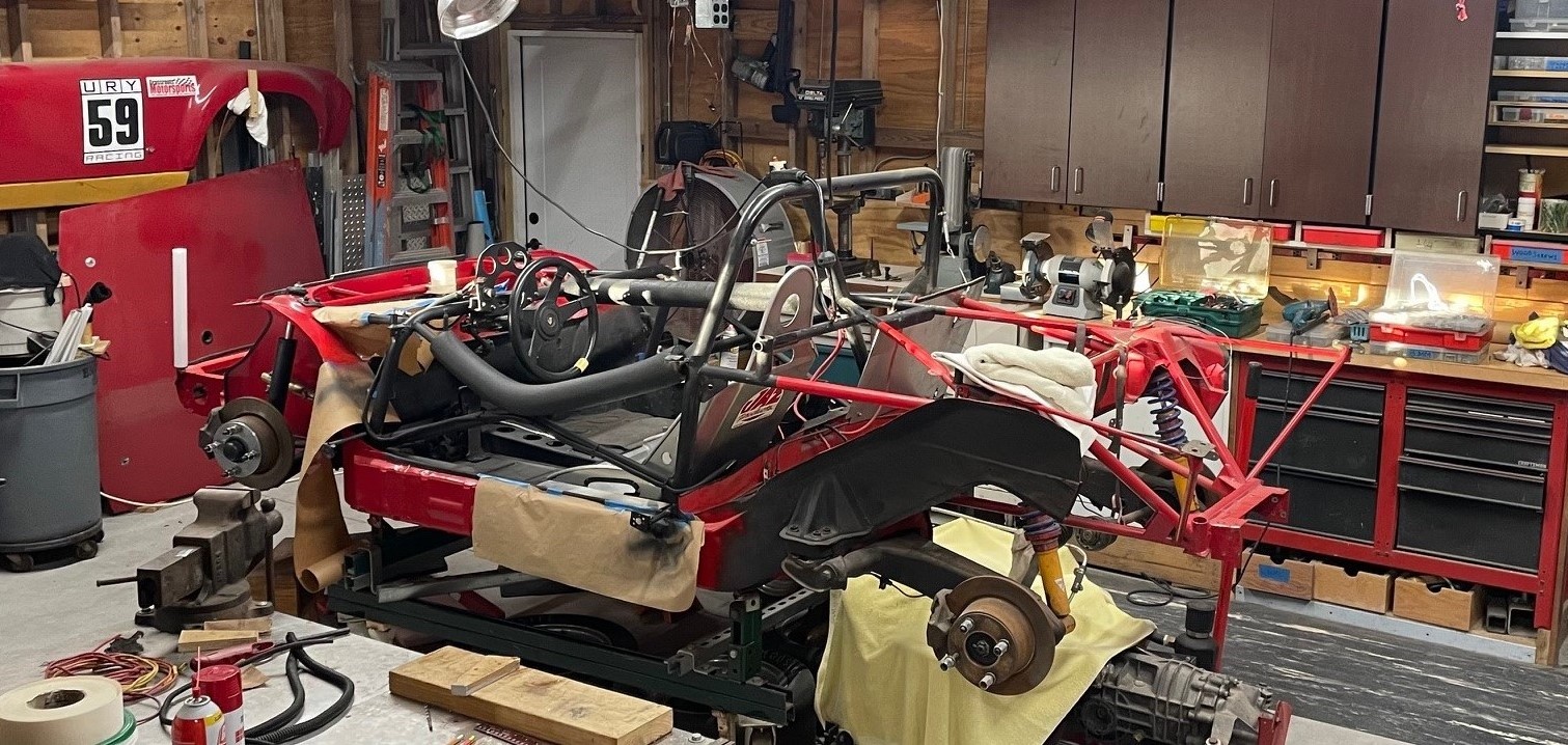

The rebuild continues. (IMG:style_emoticons/default/beer.gif)

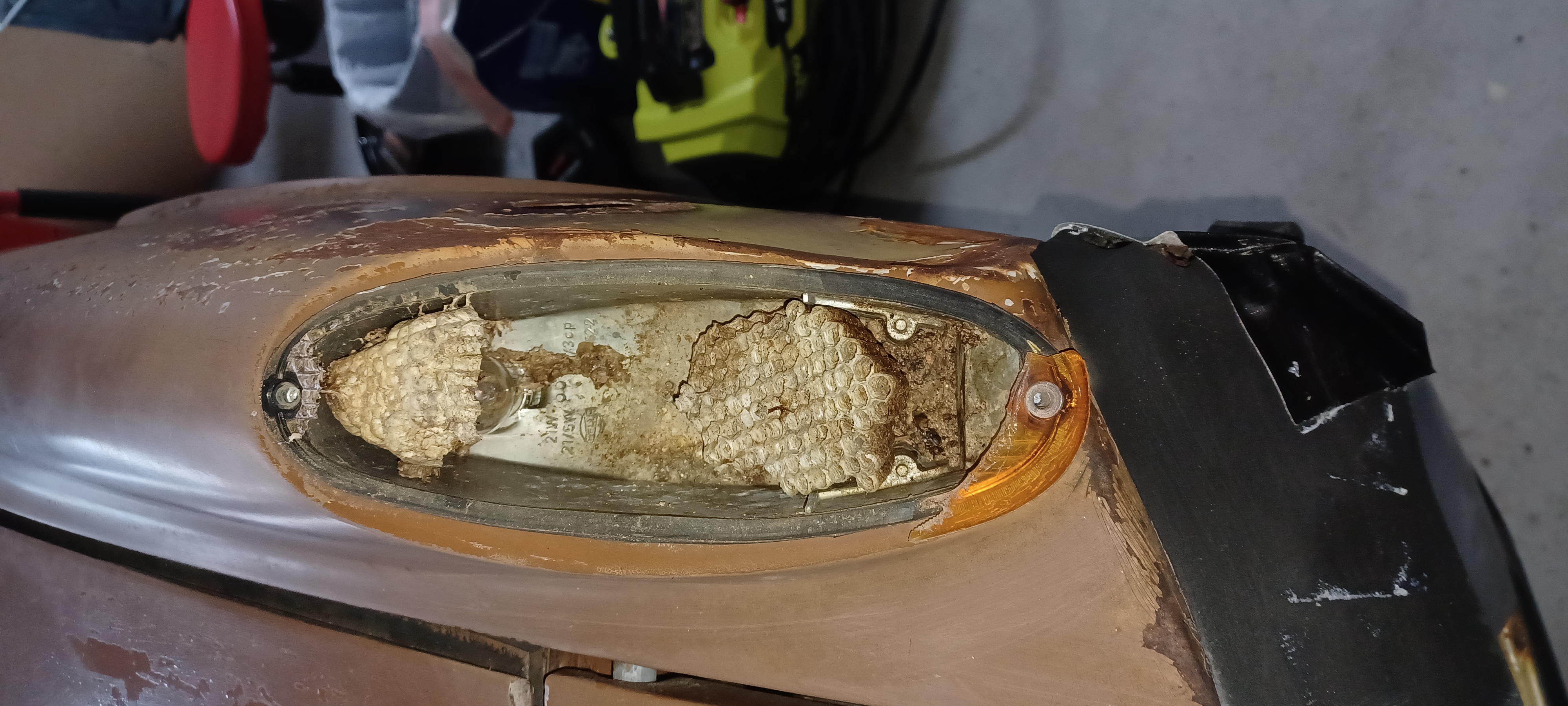

Exterminator duties... little boogers can get in the strangest places!

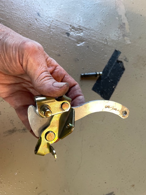

new door lock cam actuator , nice new key zinc plated door stay mechanism and new springs and rollers , improvement
for sure

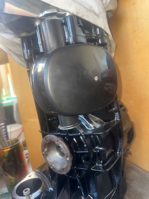

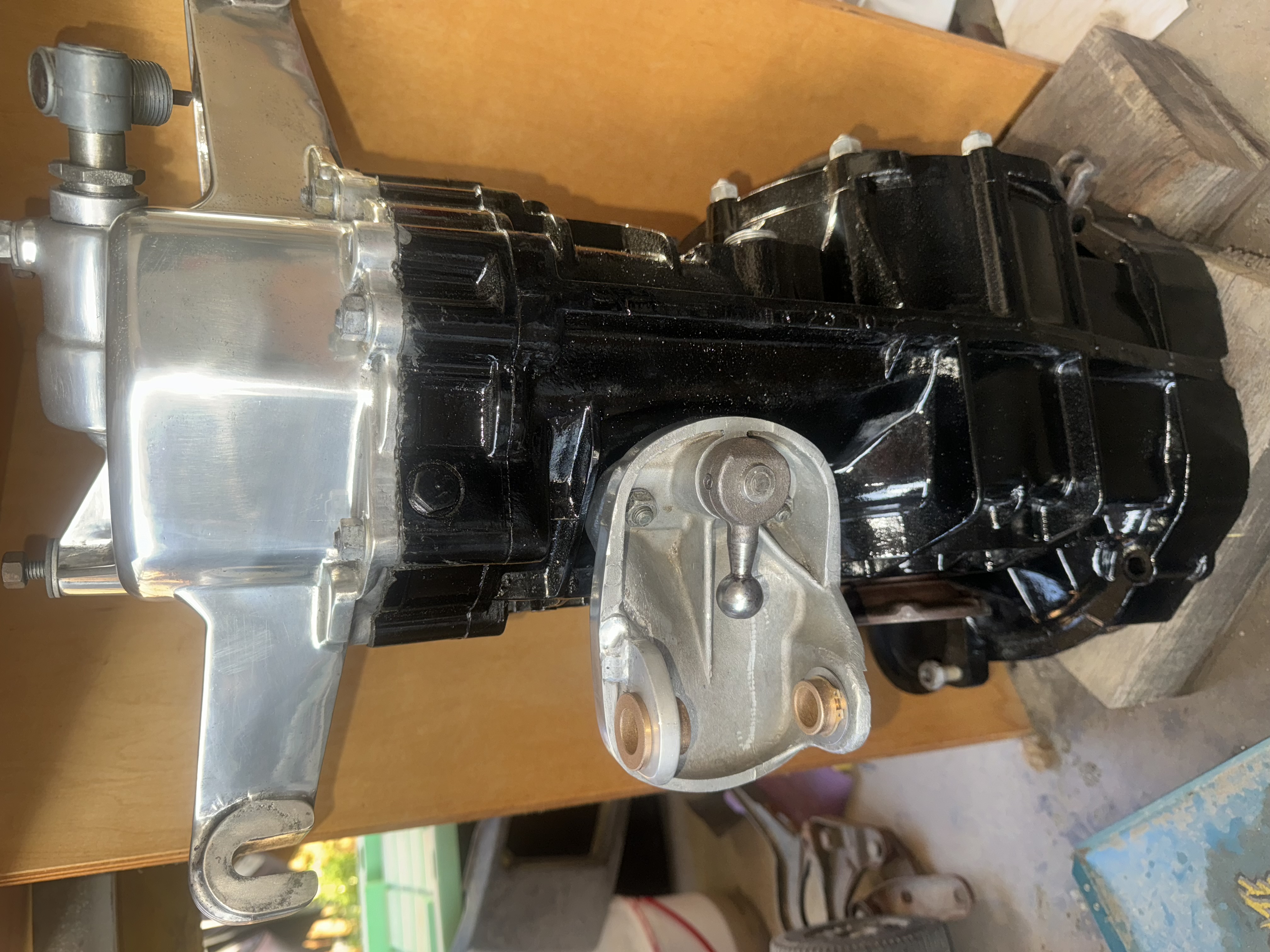

A little at a time. Cover just needs to be glued to hold new piece on propper angle

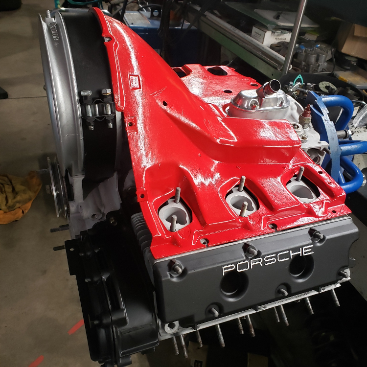

REDRUM, 66 sand cast case, 2.7 twin plug,Attached Image

Niiiice! Wish my friend had a twin plug fixture for 2.7 heads…I probably would have gone that route too…alumn case is nice upgrade from a mag

Nice Jeff! I bet that twin plug 2.7 will be a sweet engine.
My 2.7 has 964 cam caps and valve covers. Looks like it should have twin plugs and doesn't. Wonder what it would take to make the conversion?

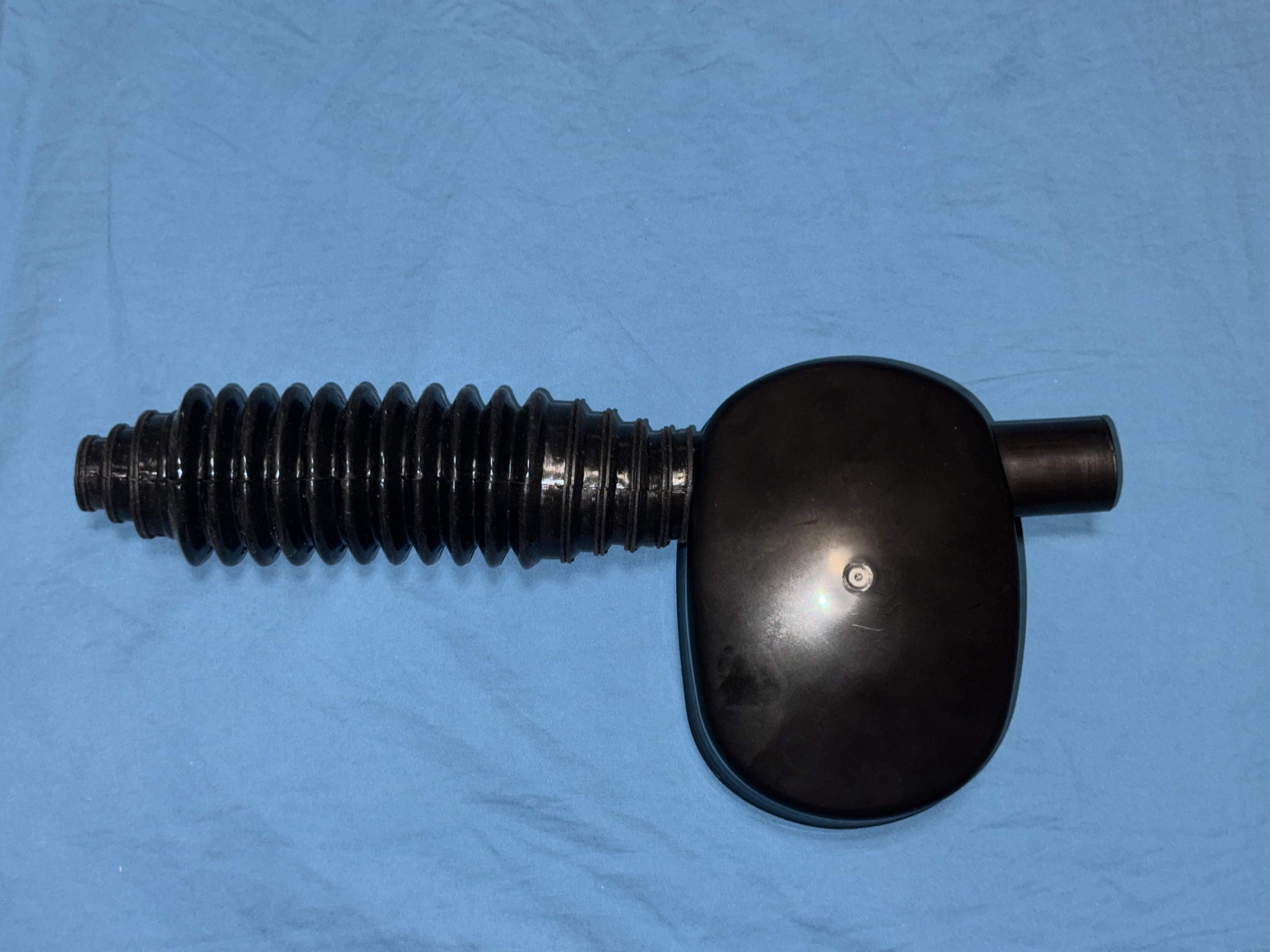

I’ve been searching for a bellow dust boot that would work for my project. I needed one that would fit the reproduction dust cover for the shift console, it needed to be big enough to fit over the 914 steering system u-joints and on the other end small enough to fit the shift rod. And not so darn long it looks funny. Universal Steering Rack Boot
