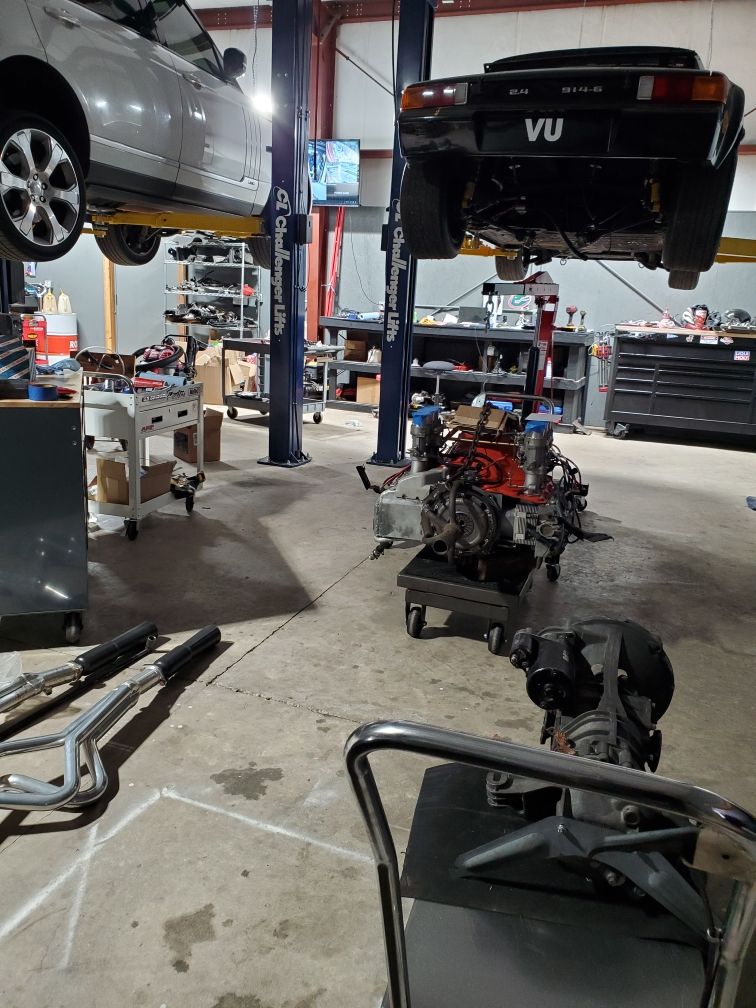

Engine ready to go back in

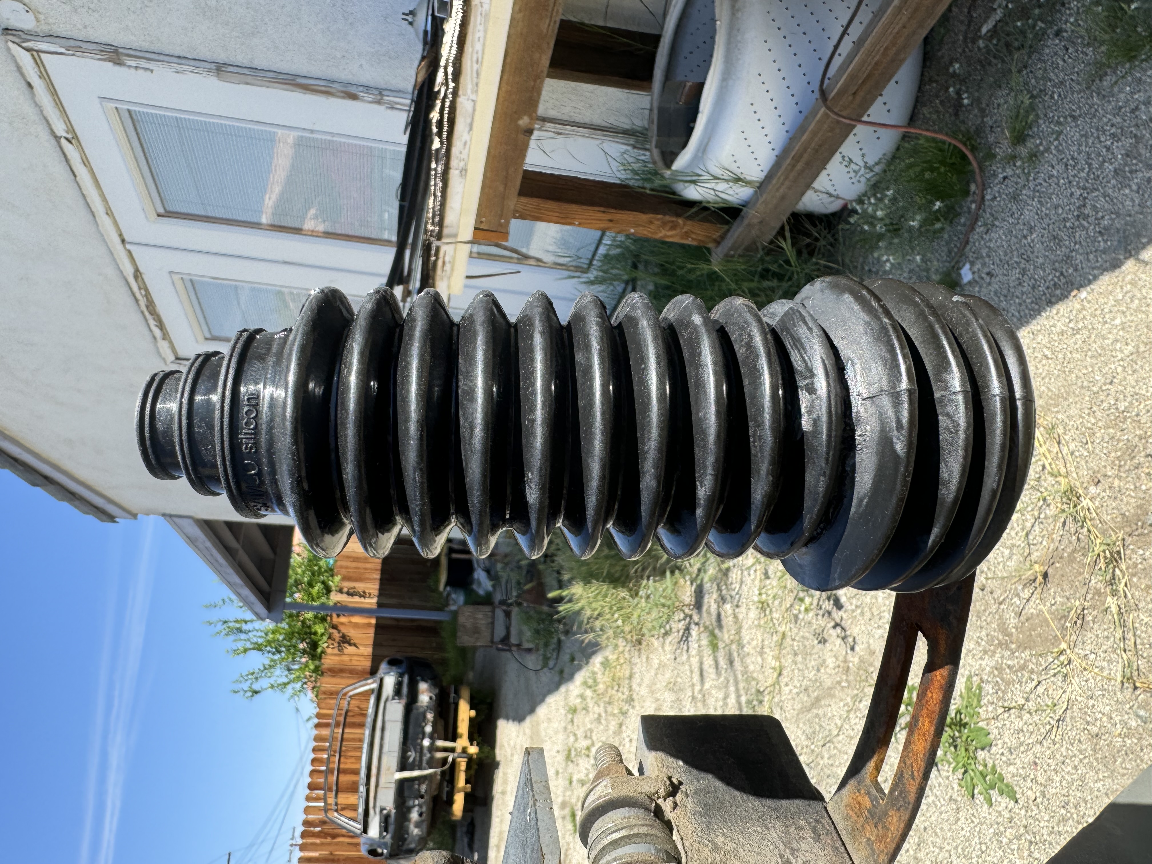

This will go from the firewall, over the u-joint and seal to the shift rod. I used the lower half of the stock one and ultra-blacked the two together on the inside. I’ll use black silicon on the outside for cosmetics.

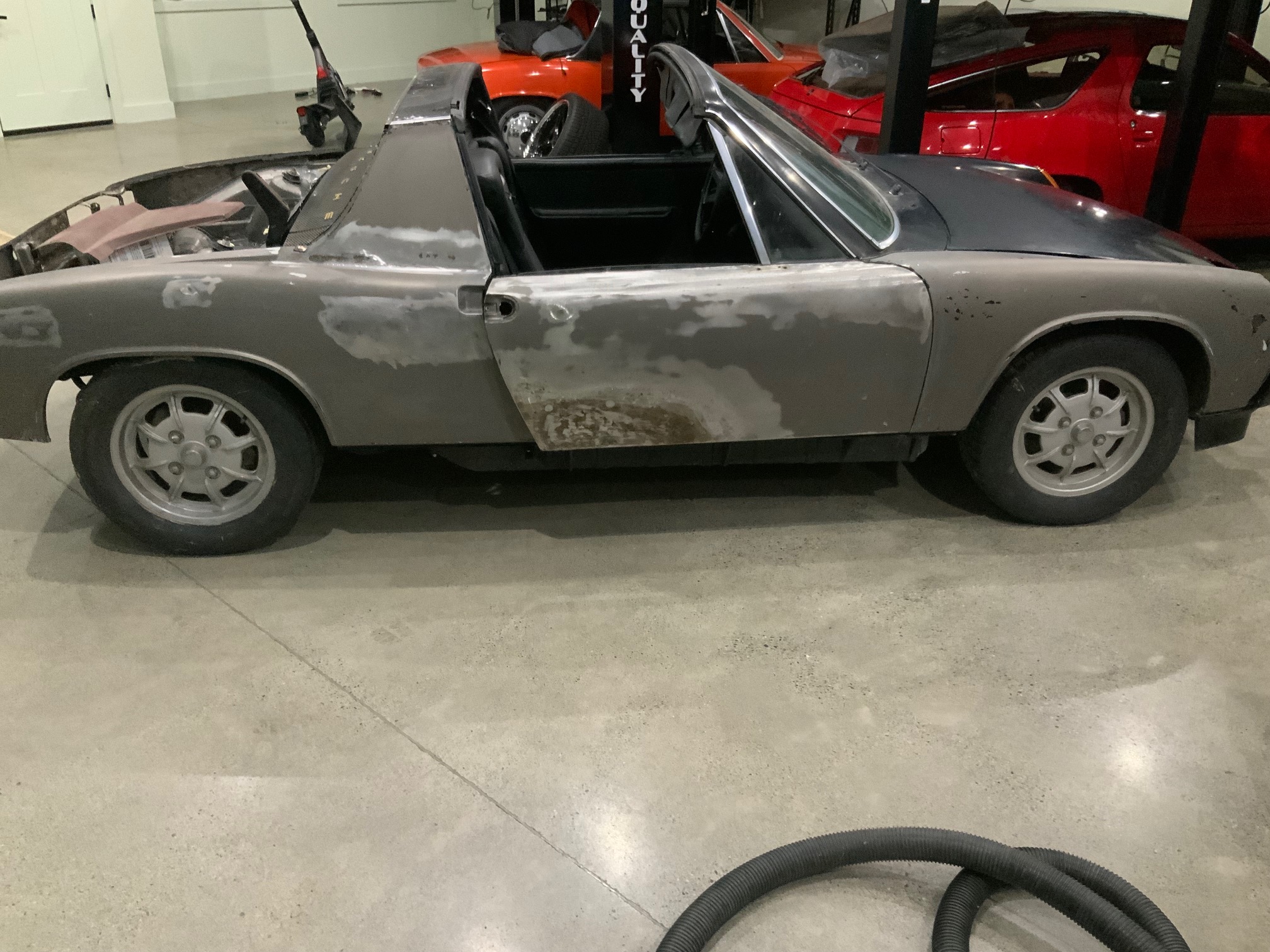

Minor damage on the door but the rest is turning out better than expected…

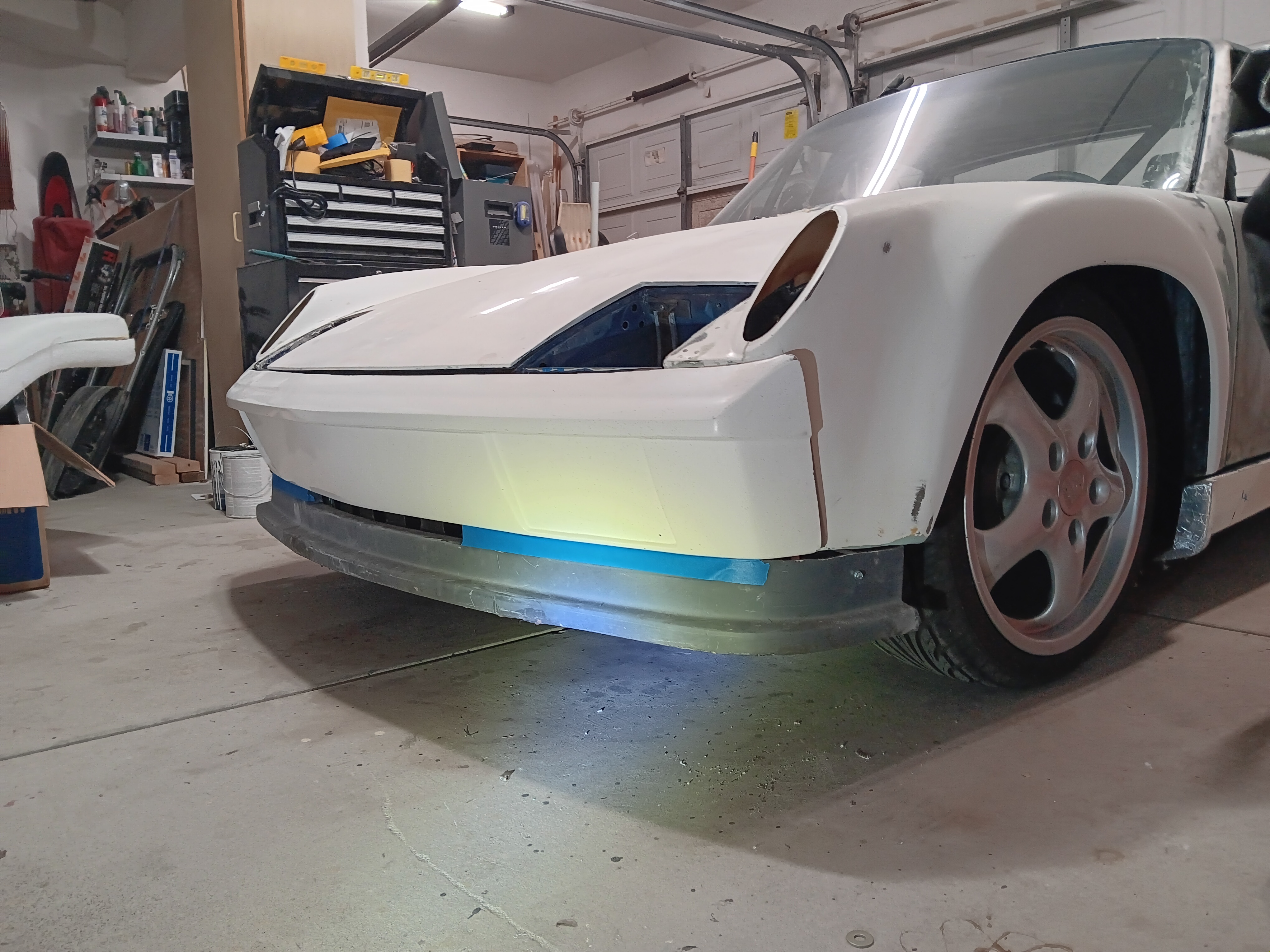

Cut the lower lip off an IMSA bumper to make my front valance. What do you think?

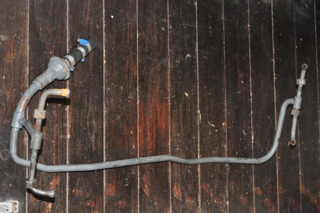

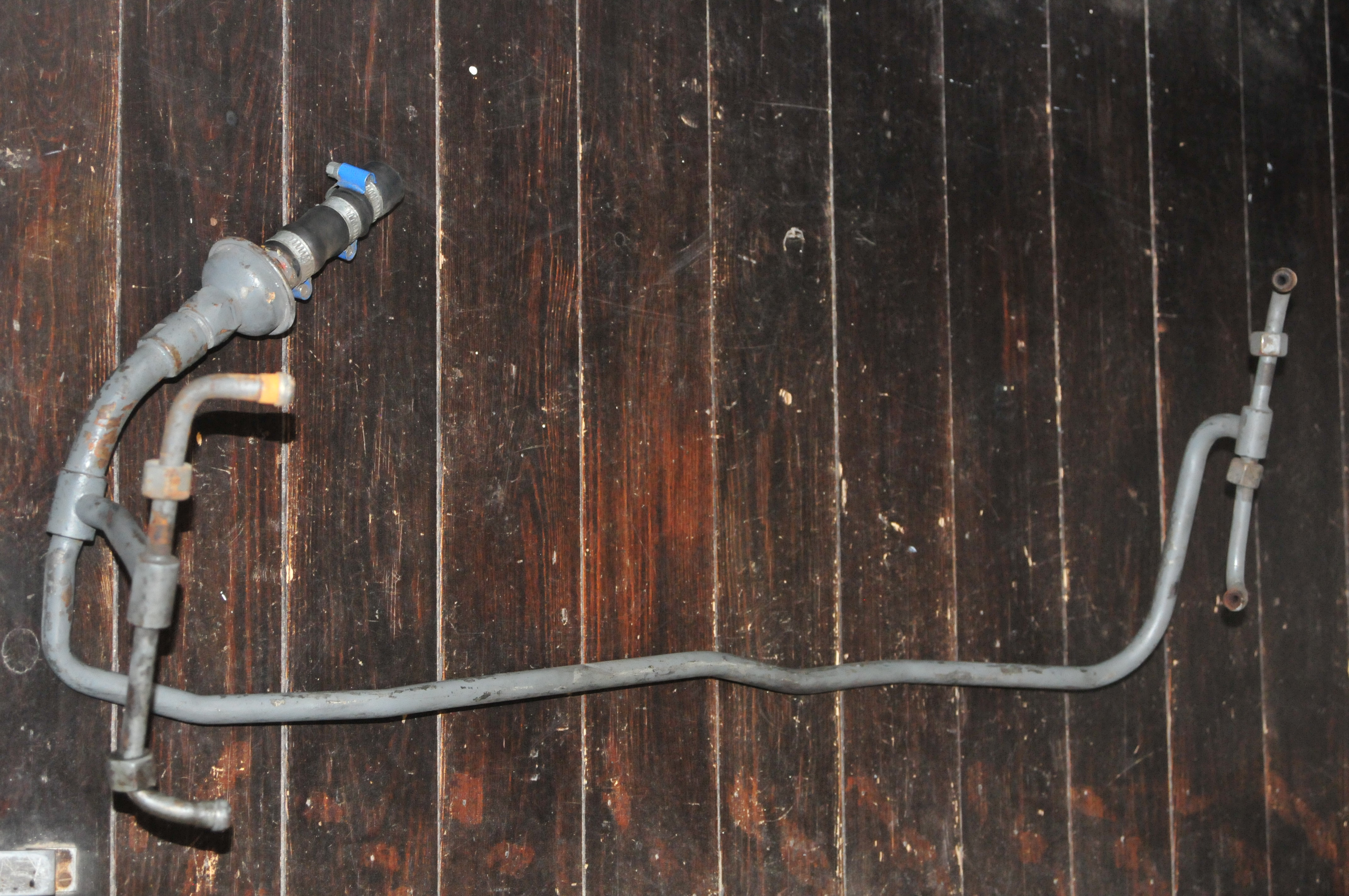

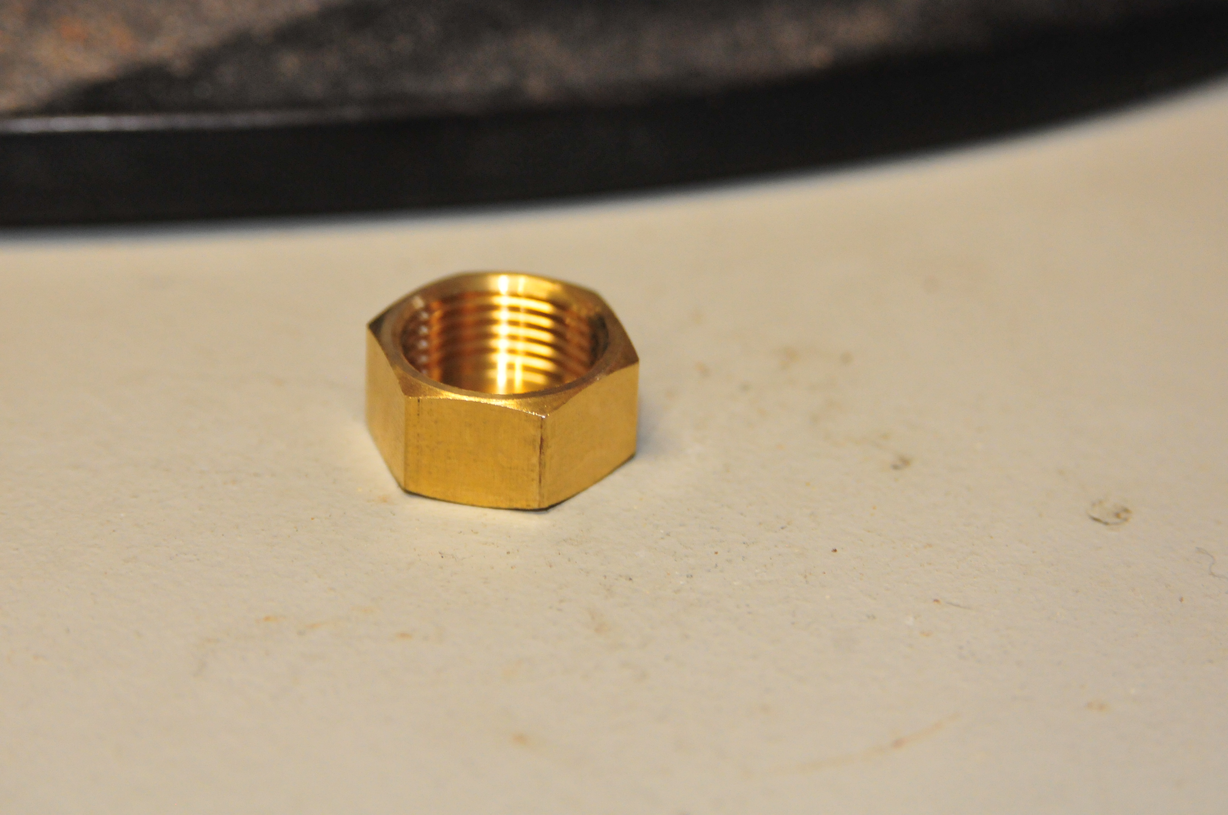

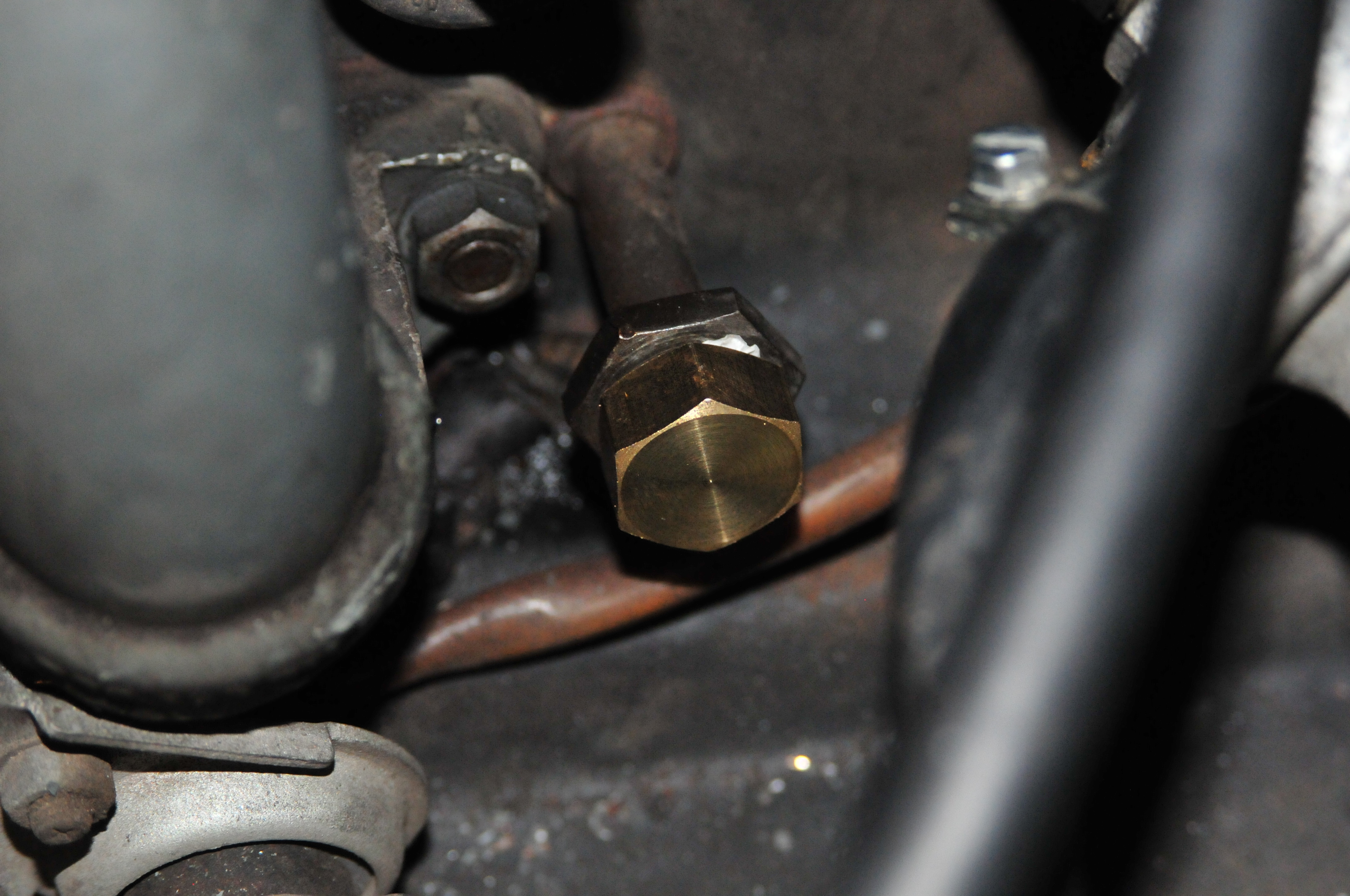

Since it has been raiing here for the last six months , I had plenty of time to surf on the forum and I found a way to get rid of the smog pump lines. The smog pump itself was already removed by the PO. So I took out everything and closed the holes with copper plumbing end caps and a little bit of teflon. It works perfectly.

This is one of the caps. It' 3/8 "

And here it is installed.

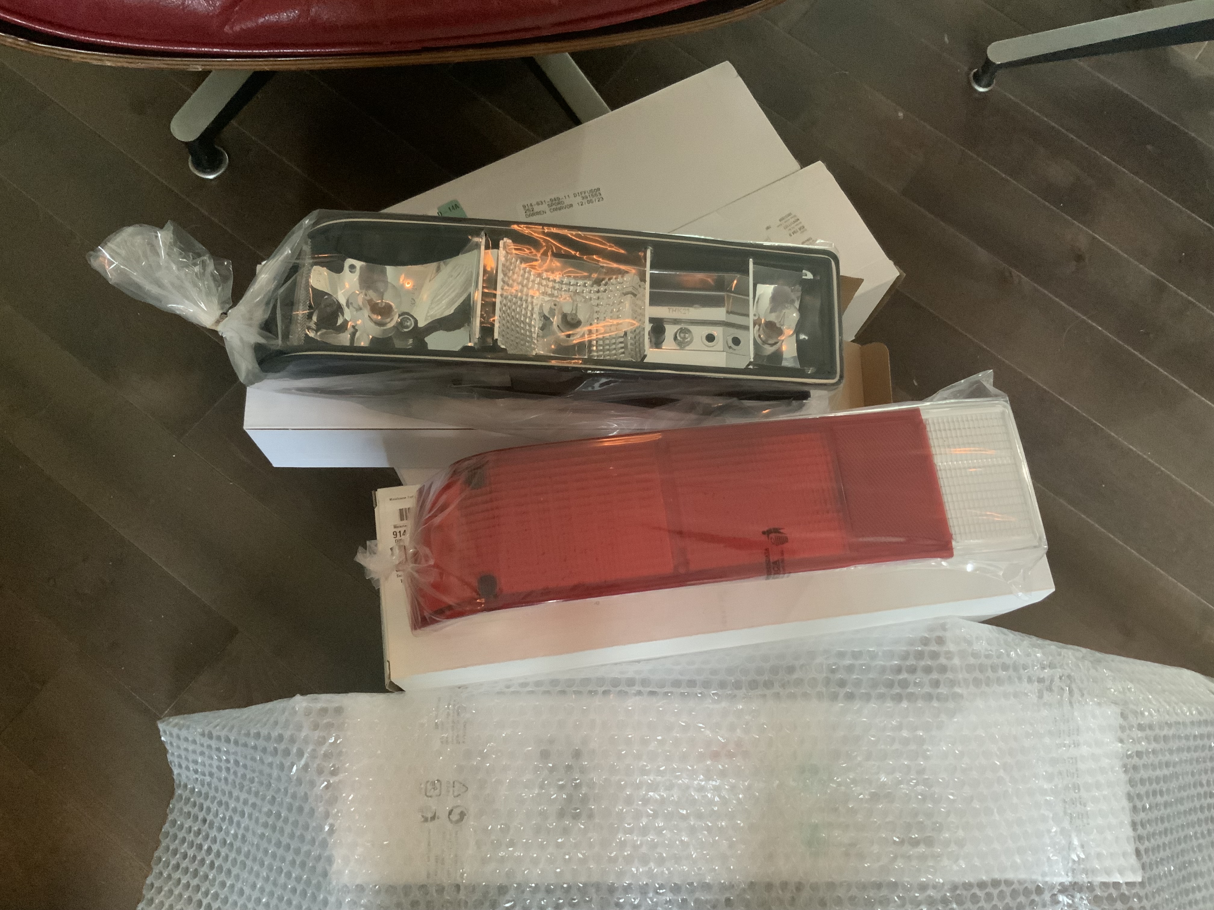

Took the brakes and regulator off and sent to PMB for restoration. Also bought new hard and soft lines.

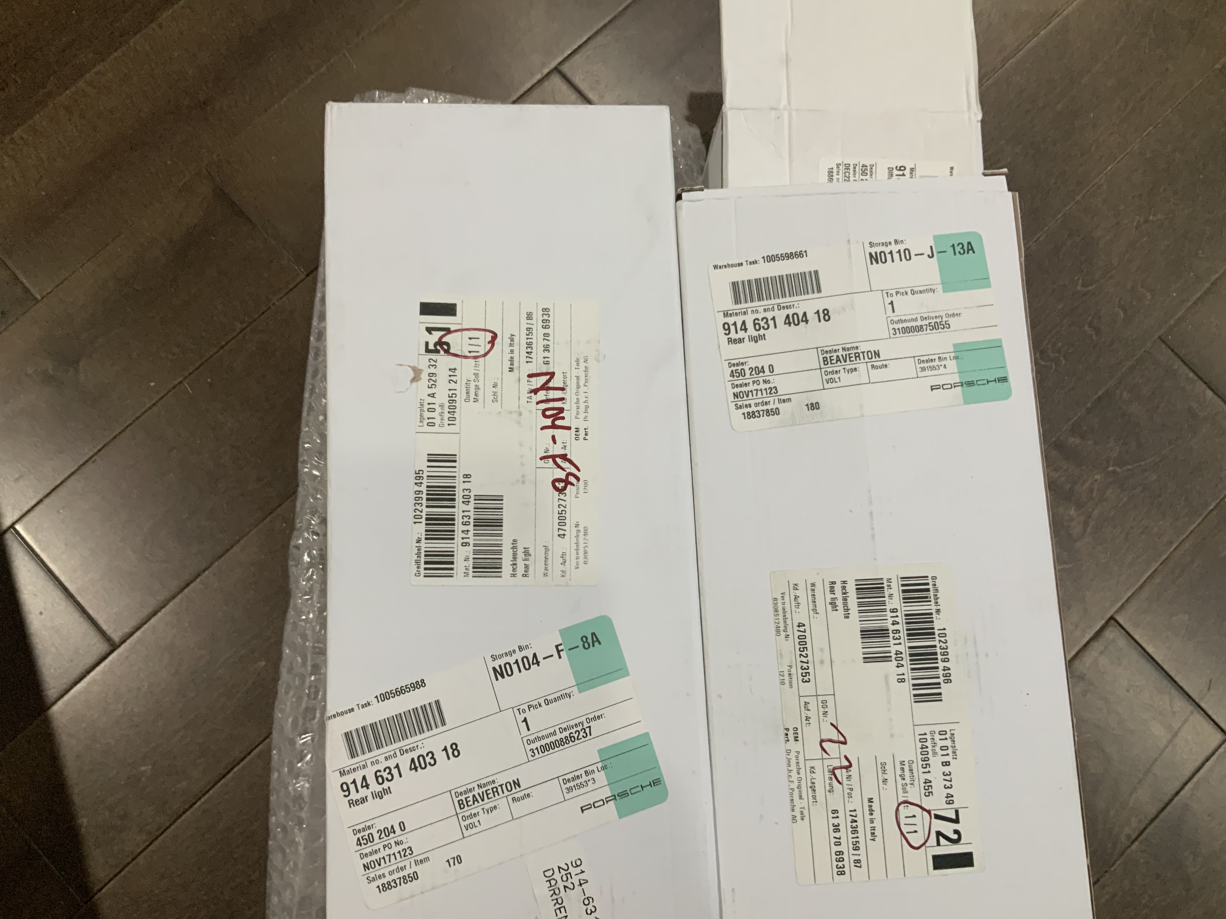

Ordered a new set of taillights from porsche for the BB… not Hella but pretty nice. Also got a set of euro lenses…

brand new housings?? where and how much? wonder if they can be purchased without the lenses?

@raw1298 - That looks pretty good. (IMG:style_emoticons/default/beerchug.gif)

Yes, the housings were bought separately and were $426.52 each… not cheap but are very nice and have the original type body rubber. The lenses were $175.

Isn't that a pretty shot? did you use the Back to Nature paint remover, and very little if any rust topside. How are the undersides? What mill are you planning?

Thanks. I am using citristrip https://www.amazon.com/gp/product/B07LF8T6P...=UTF8&psc=1
Very little rust, underside is really good, but there were some dubious repairs that will get addressed. Not sure about the paint yet…

can you share seller and manufacturer?

Yes, bought directly from Porsche via Sunset Porsche in Oregon. The part numbers were different on order but both boxes have the same number but one is marked “left”. These are the US buckets with no diffuser.
