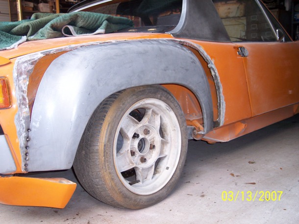

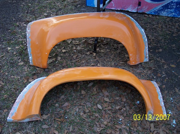

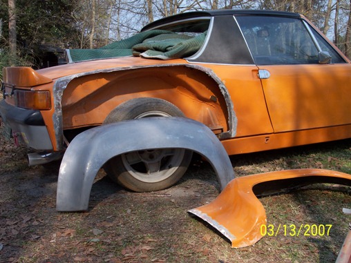

Last night,I ripped of the rear fiberglass flares to make way for the steel units from the group buy a last month.
Fronts are completely done,now the rears.
The rears are gonna widened about 2" per side,to cover the 10" wide wheels.
As you can see in the pics,I have a few holes to fill,but that's not a big deal,that's why I have a welder. (IMG:style_emoticons/default/welder.gif)

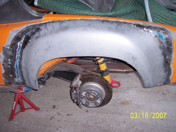

Last one,
Driver's side tacked.
Ron

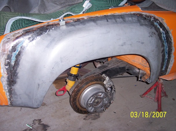

One note to all those interested.
A 930 turbo brake setup DOES fit under 15" wheels.You can see'm peeking out from under those old ATS wheels in the last pic.
Ron

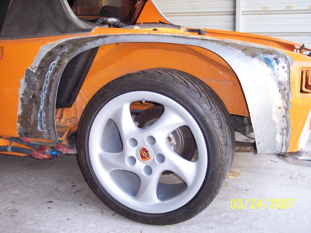

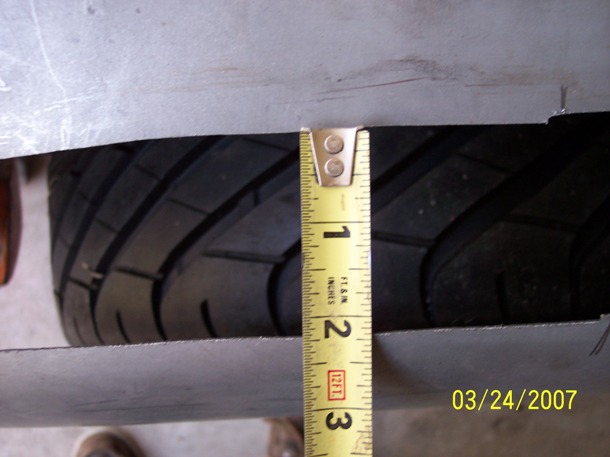

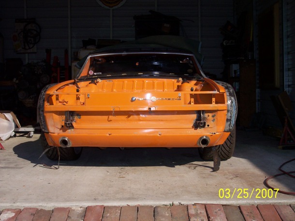

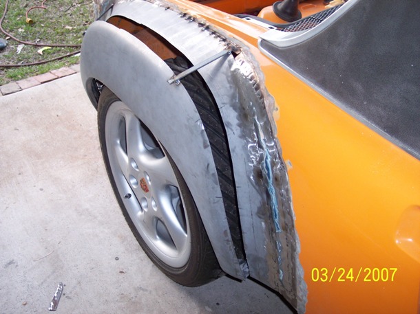

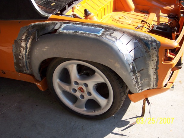

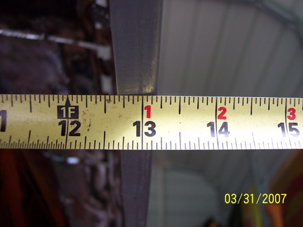

This weekend was a good one for the old flare switch.
Got the repo flares cut and started the 2" widening process.
The amount needed to widen is shown in the photo with tire on sticking out past the stock flare.
Tire is a 265, on a 18X10 rim w/a 40MM offset setting on a 2" spacer.
Ron

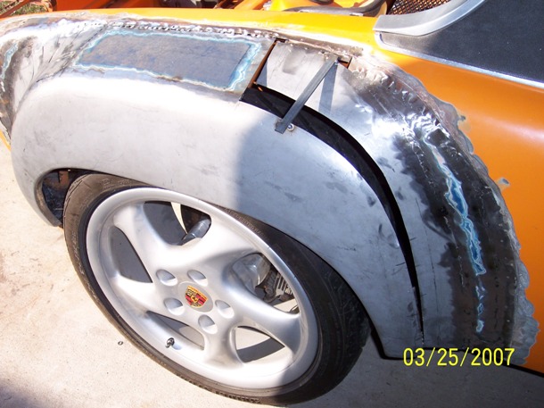

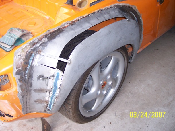

Moving right along, I widened the rears a full 2" on each side.
Then it was just cut and fit from there.
My finished width is within 1/8' from either side.
Ron

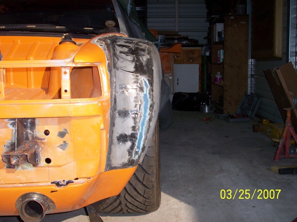

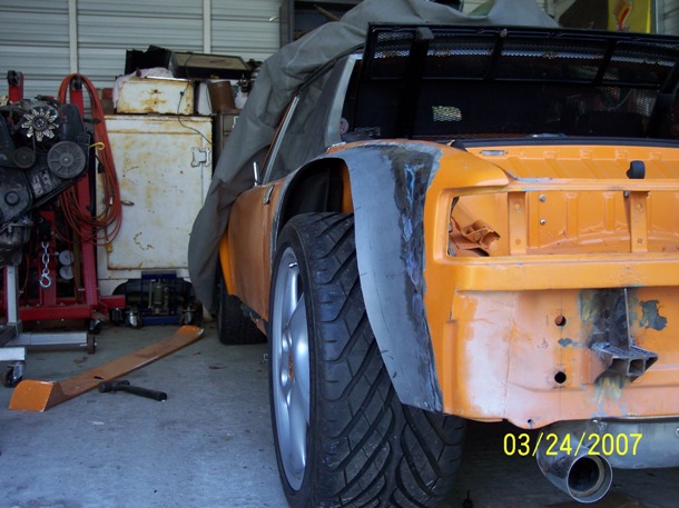

lastly,
some back shots when I stopped work Sunday evening.
R

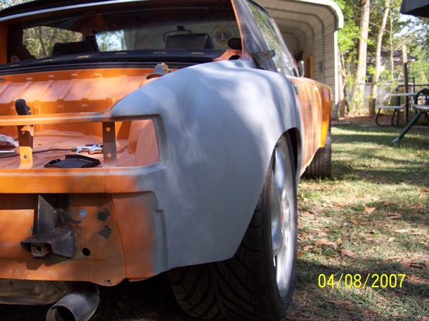

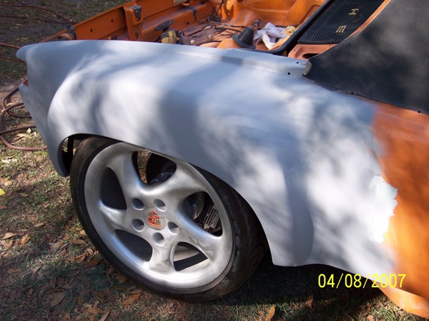

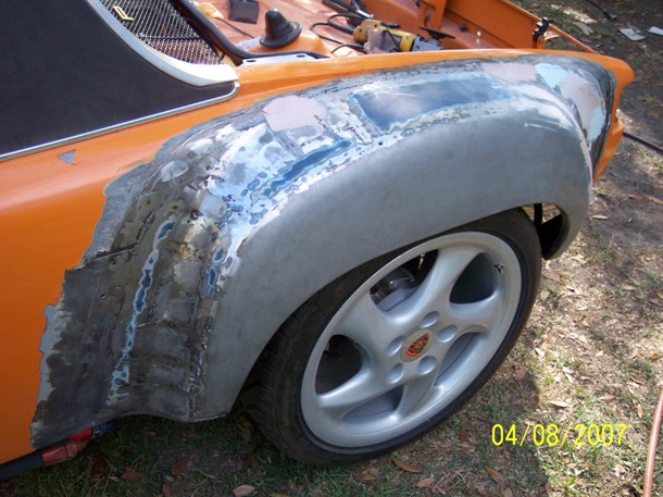

This past weekend was another good weekend for working on the teener.
Weld work is pretty much done now,and I've almost got the passenger side of the car smoothed out.
Drivers side will be ready to start mudding it up in a week or 2.
Ron

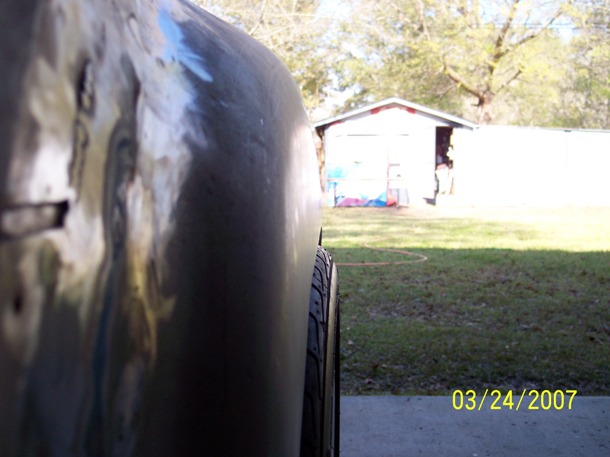

Member No.: 724
If anyones wondering about clearance,I think I have some to spare if anyone needs some.
R (IMG:style_emoticons/default/biggrin.gif)

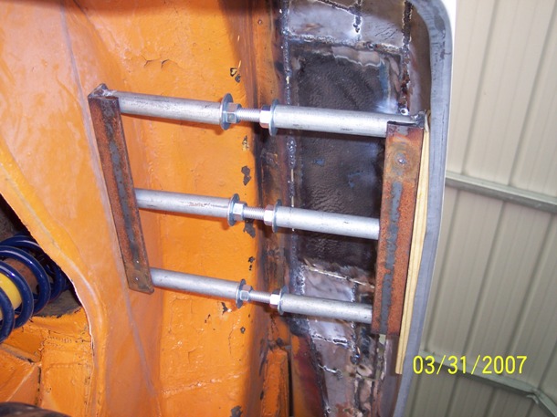

Lastly,I'll show the trick to keeping the clearance stable throughout all the welding.
I made these fender jacks from angle iron,1/2" pipe,1/2"threaded rod,and some nuts and washers.
It worked perfectly.
