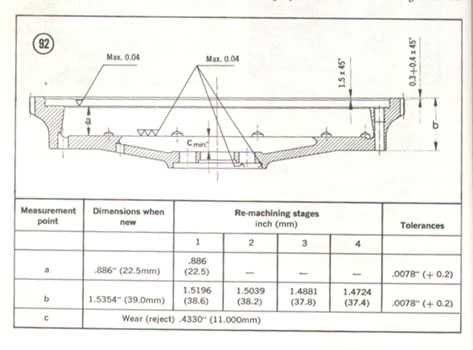

Can anyone confirm if this is the correct drawing for resurfacing the flywheel? Is the 11mm wear limit correct? I ask because the cross-section near the center of the hub doesn't look QUITE the same as my flywheel
PDXMike Flywheel wear limit drawing? Jan 7 2013, 02:53 PM
Dave_Darling Which flywheel are you talking about? 914-4? 914... Jan 7 2013, 04:43 PM
Bartlett 914 I have a flywheel that is in very good condition a... Jan 7 2013, 05:02 PM
rjames I tried long and hard to find this info but never ... Jan 8 2013, 12:22 AM
Mark Henry Did you get that diagram from one of my old posts?... Jan 8 2013, 08:32 AM![]() ![]() |
