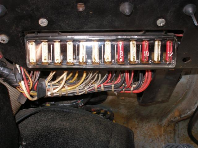

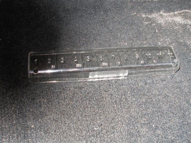

I read a post here not too long ago about an OEM fuse panel cover on eBay for $150. Not long after I had an incident where I ended up picking fuses off the floor of my 914 in the dark when the headlights wouldn't go on. It got me thinking that I needed to get a fuse panel cover, but I didn't want to spend much to get one. So I looked at what was available for VWs and found the following VW part fits just fine:
The one I found was marked 111-555D
but I think the VW part # is 111-937-555D
Fits Bug's 72 - ' 79, Bus's ' 73 - ' 79, Ghia's ' 72 - ' 74, and Type 3's '70 - ' 73 also Van ' 80 - ' 85
AND NOW the 914!
And you can find it for under $10.

Great tip thanks,

Cool. Where did you get it. VW shop?

You should see the big smile I have. This is good news. (IMG:style_emoticons/default/smile.gif)

http://www2.cip1.com/SearchResults.asp?Sea...;Search1=Search
If you order 10 from this website, shipping is free. Group purchase anyone?
