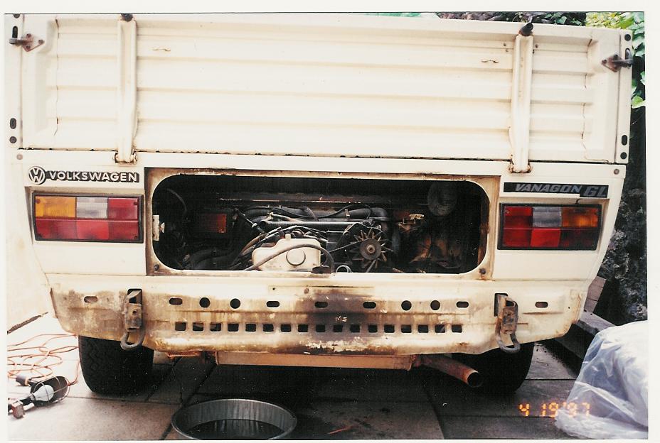

A couple of you were asking about my 1985 VW DoubleCab project buildup, so some pics:
Before
Maltese Falcon
post Jan 21 2006, 02:49 AM
Posts: 5,063
Joined: 14-September 04
From: Mulholland SoCal
Member No.: 2,755

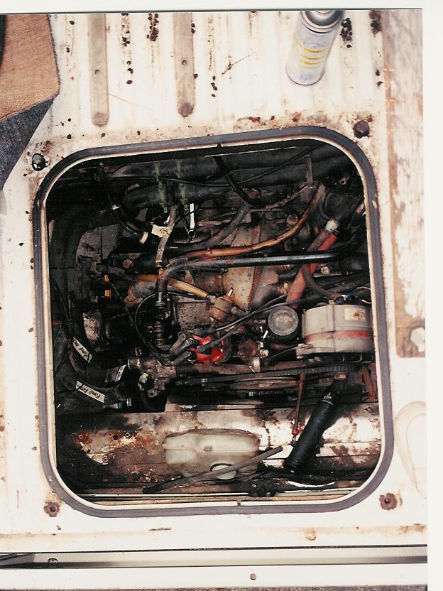

Before
this is a VW Hell Hole, looking thru the pick up bed hatch

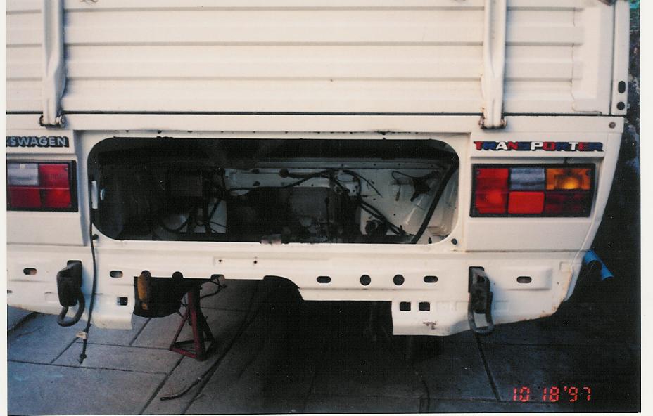

Maltese Falcon
post Jan 21 2006, 02:52 AM
Posts: 5,063
Member No.: 2,755
Getting cleaned up and rear valence cutouts for H20 pump, alternator, and harmonic damper

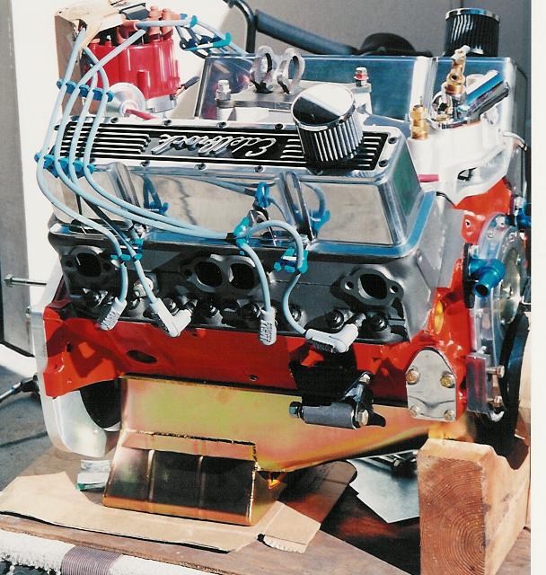

Maltese Falcon
post Jan 21 2006, 02:55 AM
Posts: 5,063
Member No.: 2,755

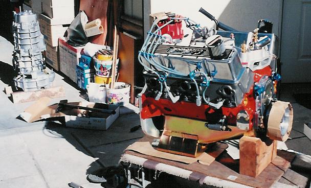

SB Chev. 5.7 (.30 over) lots of aftermarket go fast stuff, it may get a smaller cam--but it's not built for economy right now (IMG:http://www.914world.com/bbs2/html/emoticons/biggrin.gif)

5.7 and G50 transaxle. The outer flywheel bolts supplied by Kennedy had heads that were just a tad too tall, and these would peg against the bellhousing. Found out just before installing the drivetrain, milled the bolt heads slightly and perfecto.
Some DIY kits are not sorted out (IMG:http://www.914world.com/bbs2/html/emoticons/sad.gif)

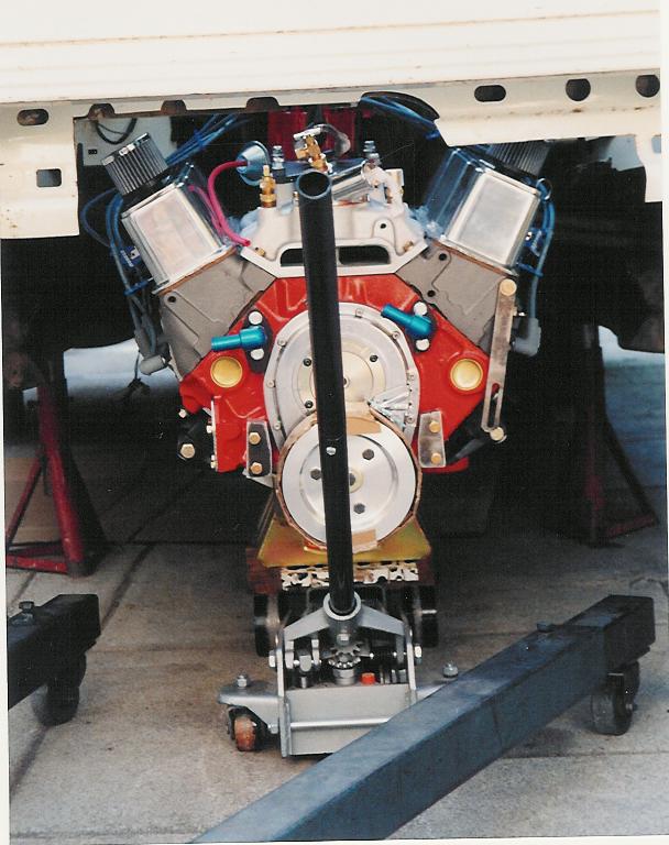

Maltese Falcon
post Jan 21 2006, 03:01 AM
Posts: 5,063
Member No.: 2,755

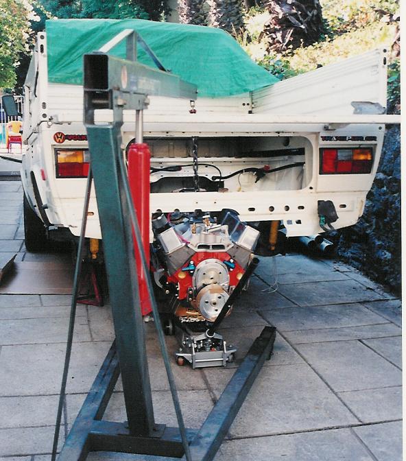

The install was strange, cherry picker and floor jack. This is where the engine hatch is real handy !

...nuther

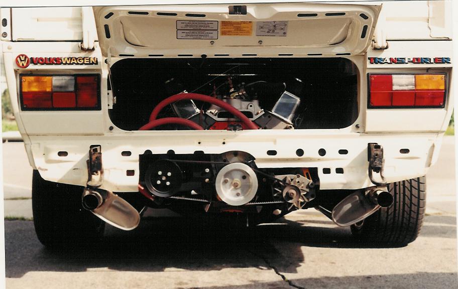

Maltese Falcon
post Jan 21 2006, 03:07 AM
Posts: 5,063
Member No.: 2,755

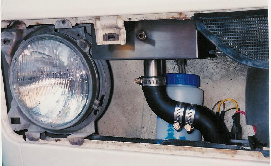

Interesting H20 system uses a basic expansion tank( T304SS) located in the upper R front grille. This is the high point of the coolant system. Initial coolant fill and radiator cap is now in the glove box (IMG:http://www.914world.com/bbs2/html/emoticons/rolleyes.gif) A simple overflow bottle sits in the grille, and heat/ cool osmosis continually bleeds the system . VW never got this right, and requires system bleeding.

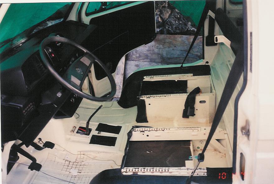

Interior during cleanup, PO had a pet Husky in there...so the seats were all removed and redone.

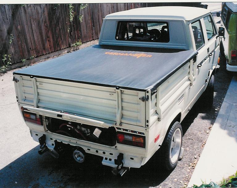

rear w/o bumper...looks functional / and definitely keep all fingers away from moving parts. Laser cut little chevy bowties into motor mount !

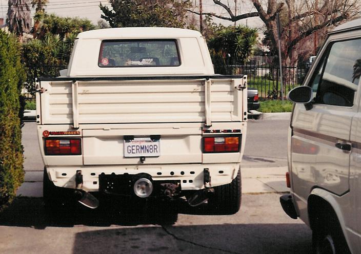

with the German8ter tonneau cover

Front elevation, it's a Super Sport
Maltese Falcon
post Jan 21 2006, 03:23 AM
Posts: 5,063
Member No.: 2,755

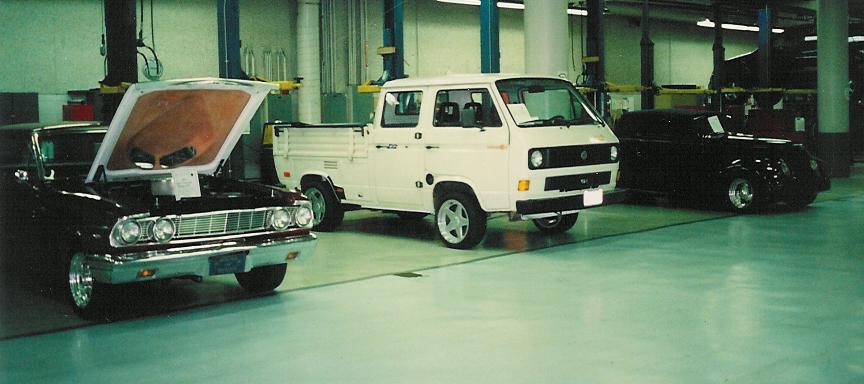

last one, with friends at a local get together.
Porsche content: G50 trans, 930 CVs/ axles, 915 shift console, misc. nik naks (IMG:http://www.914world.com/bbs2/html/emoticons/biggrin.gif)
