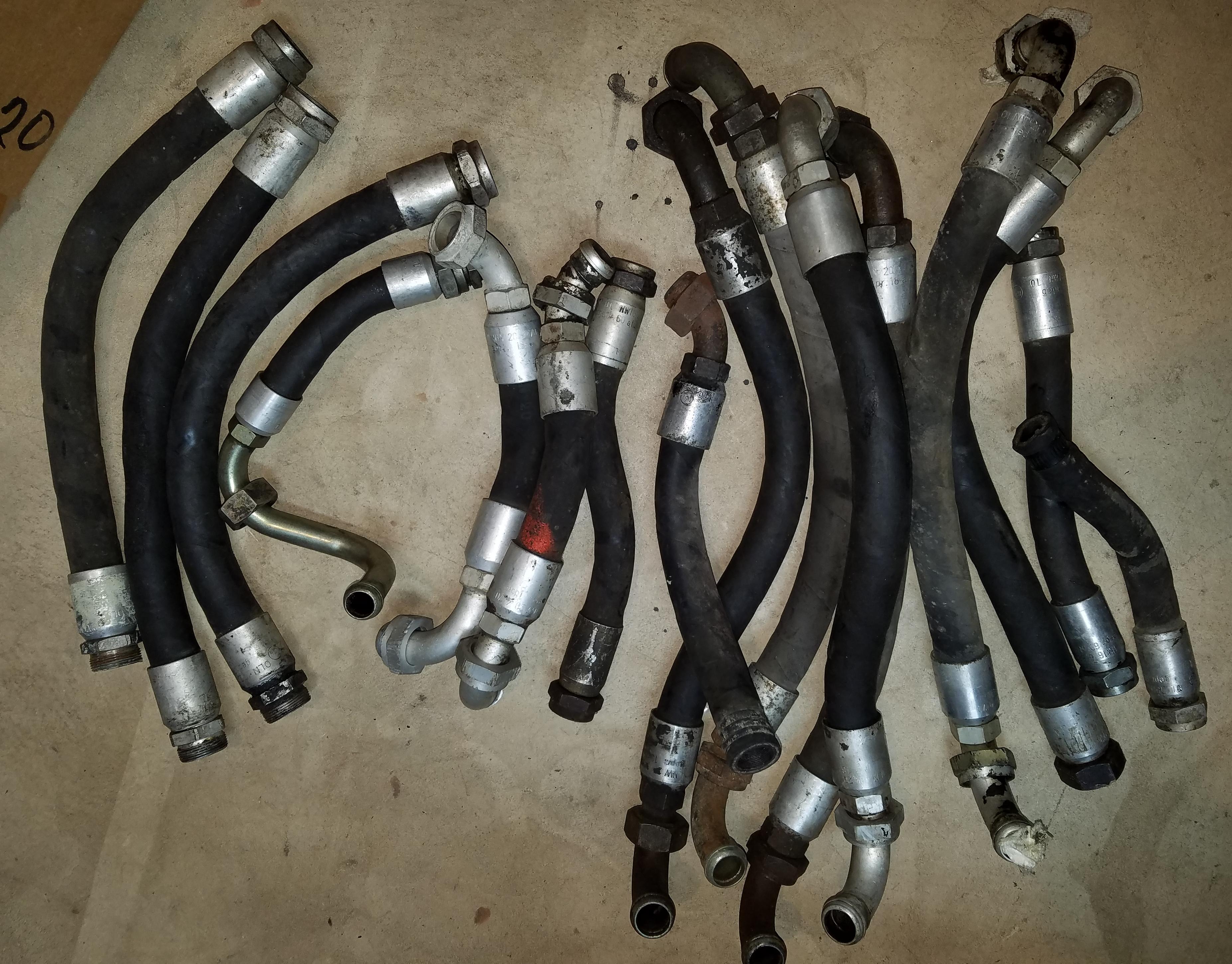

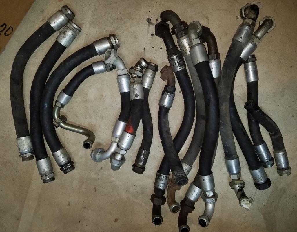

gms Oil hose disassembly Nov 7 2017, 09:05 PM
db9146 Wow, how many 914-6s have you dismembered? Nov 7 2017, 09:18 PM
GeorgeRud They can help with oil filters on 914-6 or 911s as... Nov 7 2017, 09:25 PM
porschetub Wow $$$$ worth are reuseables.... Nov 7 2017, 10:56 PM
Perry Kiehl More of Stazak showin' off :) Nov 8 2017, 06:28 AM
gms I have several 914/6s so I removed them as I feel ... Nov 8 2017, 10:26 AM

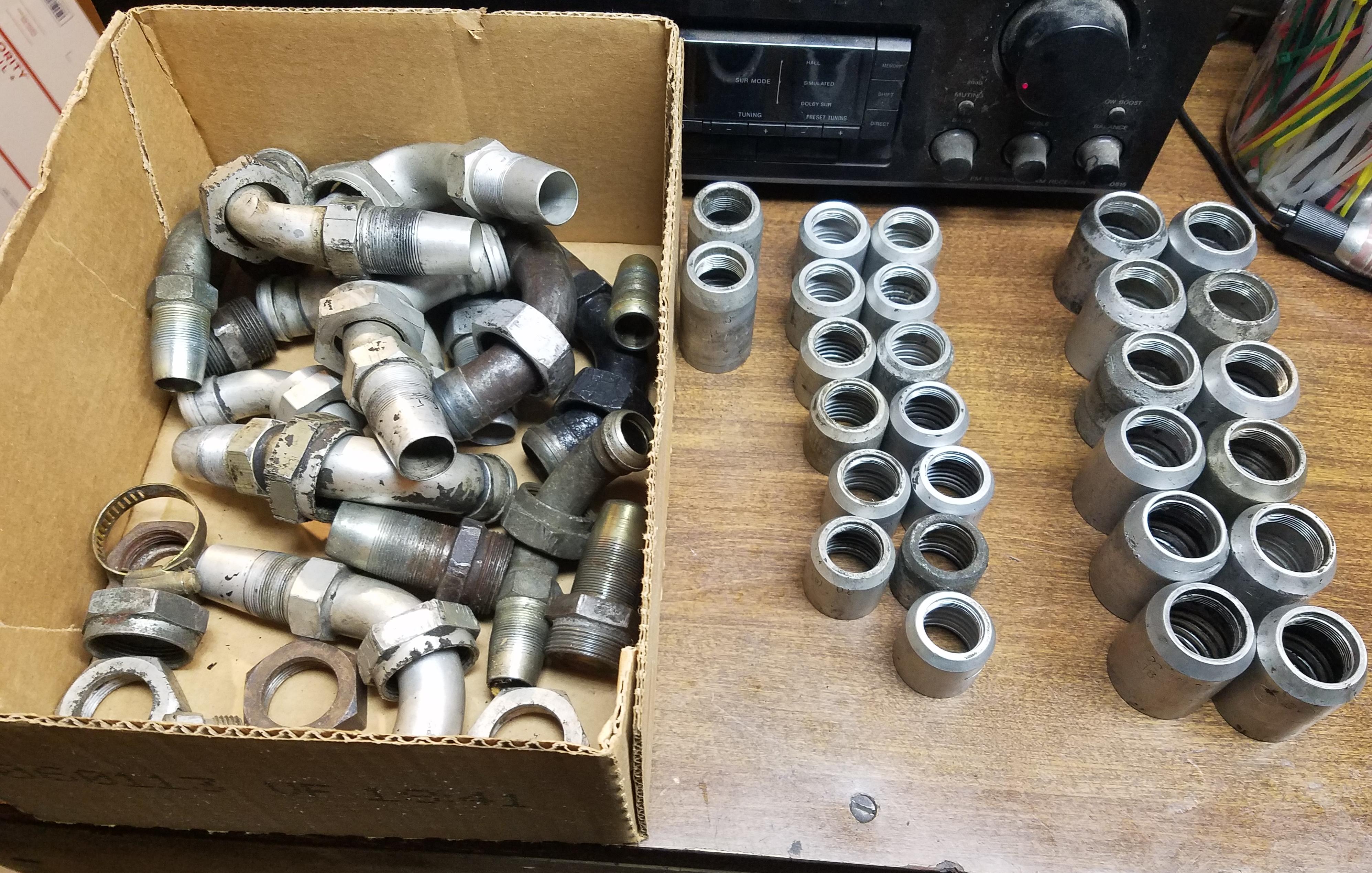

gms this is a close-up of the aluminum ends
Nov 8 2017, 10:28 AM
gms I have a car that came with this elbow (used on th... Nov 8 2017, 10:43 AM
mepstein Glenn - I could vapor blast those aluminum fitting... Nov 8 2017, 11:07 AM
