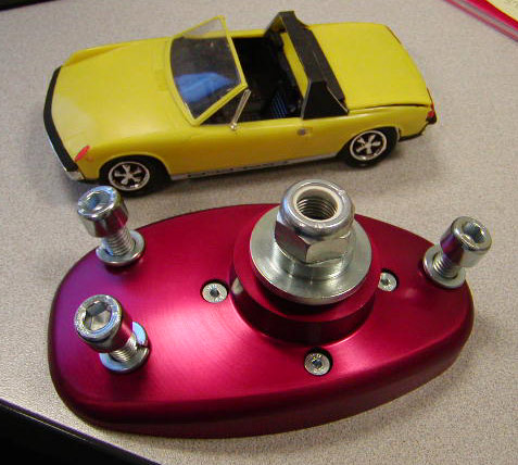

I was weak....right after I sold my Pauter Roller rocker arms to Britain, I ordered a set of these (IMG:style_emoticons/default/smile.gif)

The car has to run to fully utilize those.
How about you commision me to get the engine together and in the car running and you do what you do (drawings/plans/idea's) B |

those would be similar to these from GPR? http://www.gprparts.com/brands/gprStrutMou...ntKit/index.asp Dave/GPR showed these to me at the German AutoFest, they do alot of good, yes? |

those look like the ones given away at the ramble. They are the plastic bushing material.

They work fine Scott for cheap replacement of the rubber. What they dont do very well is control the shock movement up and down. I'm sure they help a little over the stock rubber ones in the side to side department but I also want the shock to have precise control up and down.

QUOTE(Brad Roberts @ Oct 9 2003, 10:23 AM) They work fine Scott for cheap replacement of the rubber. They are not exactly cheap, though... |

$100 bucks........

120 ish

The Tarret jobbies are offset so's you can get more negative camber. Those other ones don't appear to do that.

I expected $50ish for the plastic jobs.

QUOTE(James Adams @ Oct 9 2003, 08:52 PM) They are not exactly cheap, though... Compared to the Tarett's they are (IMG:style_emoticons/default/biggrin.gif) cheers, Jeroen PS Mike, I'm still waiting for a delivery myself (IMG:style_emoticons/default/wink.gif) |

Are you just getting a piece of machined plastic for your $109.00?
Or is it installed in a housing? Paul |

there is a cadplated sleeve

OK, your get a sleeve for the shock shaft to go thru AND a machined pieced of plastic.
Such a deal! Paul |

"They are not exactly cheap, though... " & "Compared to the Tarett's they are" so, how much does the Taret set-up go for? |

I think the Taretts go for sumptin like 450
Check www.tarett.com and look it up cheers, Jeroen |
