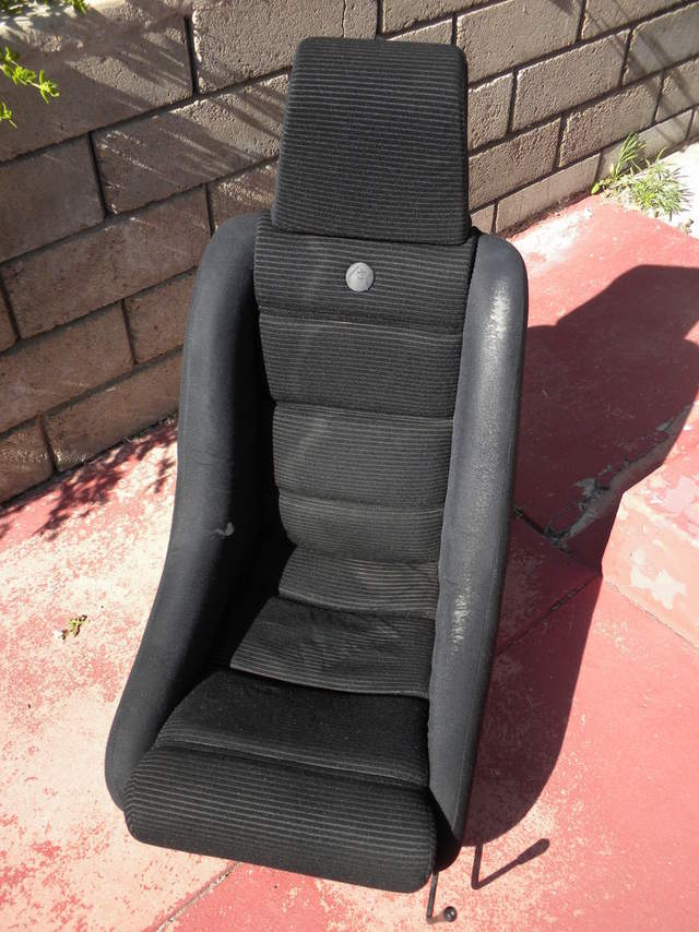

I picked up a Koenig seat and it is way to narrow. Seat will need to be recovered. Has anyone taken the frame and widen it? Maybe a port a power to do some gentle stretching. Or just sell it and move on. Generic picture.

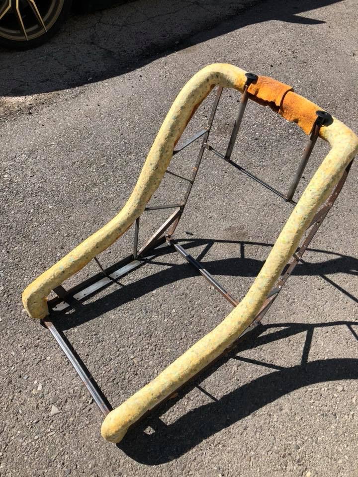

Dave Toppin widened his. You need to remove the upholstery, reweld the tubes and then reapholster. If you just try to bend it, the welds will break. They break sometimes just from normal usage.

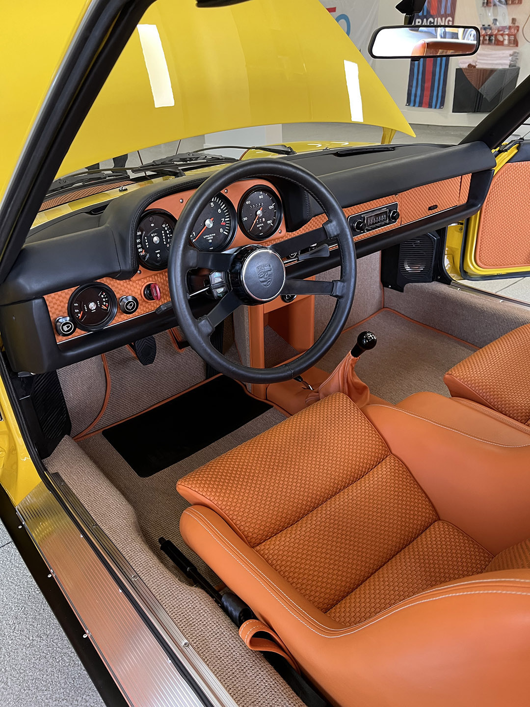

I have a Scheel driver’s seat that was widened to fit my fat ass by Dale Hancock and it came out almost perfect.
The Koenig seat looks to be the very same seat so look over the pictures of my seat and a good local guy can do this work for you.

Man, I love that interior! Beautiful color choices, beautiful work!

I widened my Koenig drivers side many years ago, carefully pulled back upholstery, bent the lower bars about 3/4 of inch wider on both sides at the front where is was digging into my leg. Looks fine, every time I get into the passenger seat I am reminded why I did it, way worth the effort.
