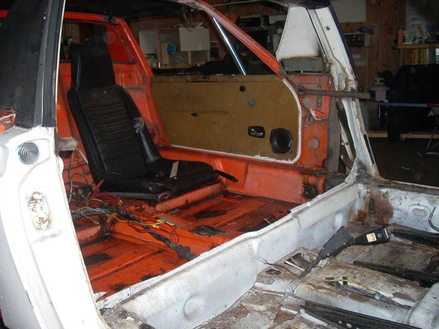

Cutting the firewall:

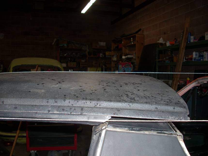

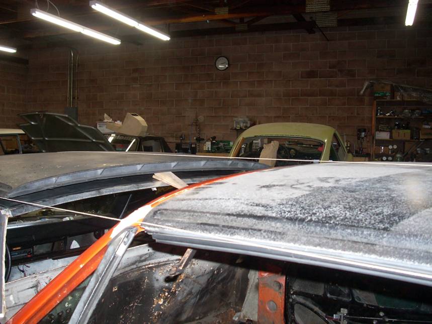

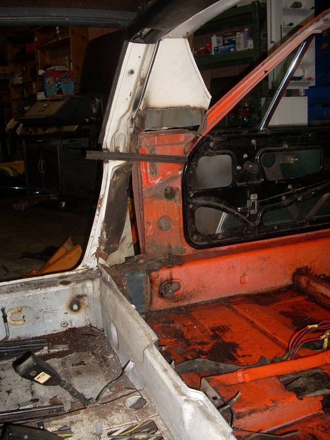

We moved the doors to the back and started mocking up the roofline:

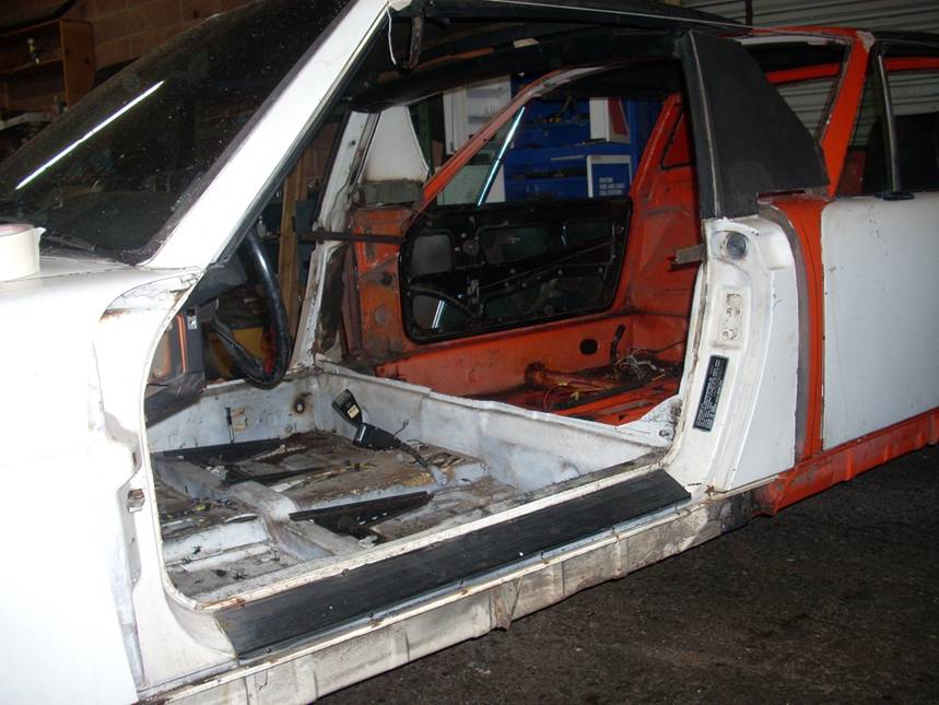

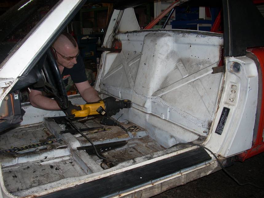

Firewall out! This really opens up the inside space:

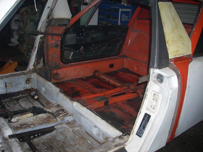

This is going to need some cleanup and welding (IMG:style_emoticons/default/biggrin.gif) ...

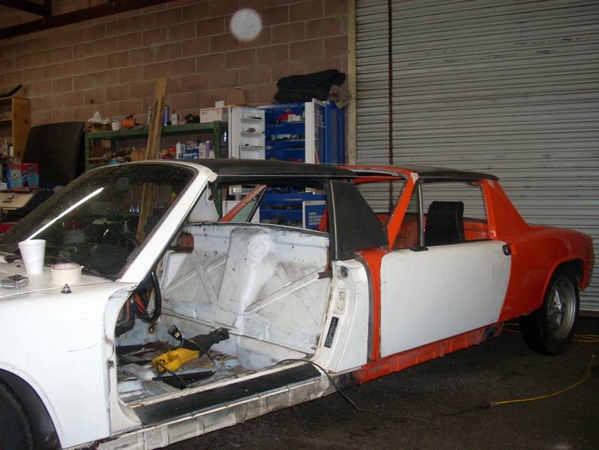

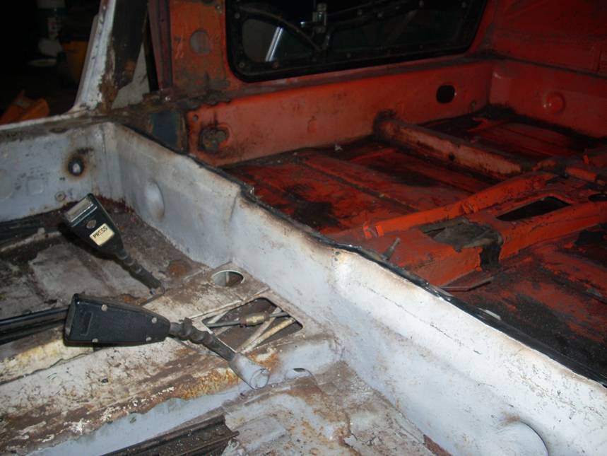

Two more:

The lower portion of the firewall will stay. We already seam-welded the top shut and we'll add a flat section to the back to get a nice clean box. It'll add to the strength of the center portion and also give us a clean transition to the floor-patch that still needs to be added.
The front portion of the rear center tunnel will be replaced with a custom piece for better looks.
The side areas will have substantial bracing added on the inside from the doorposts up into the rollbar area. Then the whole side will be closed up with a smooth patch-panel.
For the roof, it looks like we will in fact be able to keep both targa tops for the front and rear. We came up with an idea that would give us a nice roofline and still have the front top removable as well. We shall see ...
Any local volunteers for Saturday the 20th??? We could need some hands as we will have to do a lot of cleaning, grinding and prepping of the inside before we weld in all the reinforcements and panels.
(IMG:style_emoticons/default/idea.gif) Andy
