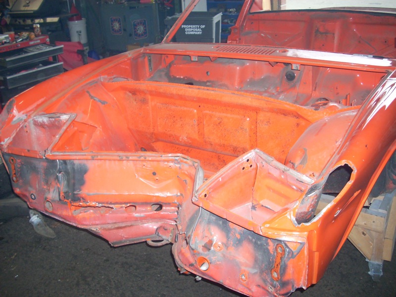

RobW had a bare shell with front end damage so all we needed was another donor to make the front of the Limo.

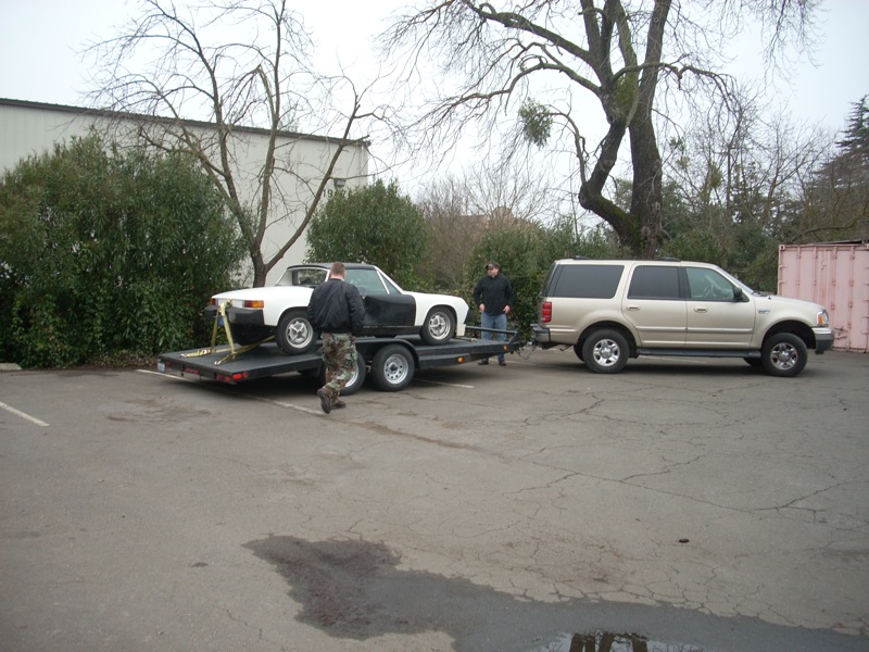

I bought a '75 roller from Chris Hamilton and Rob and i went to pick it up this morning.

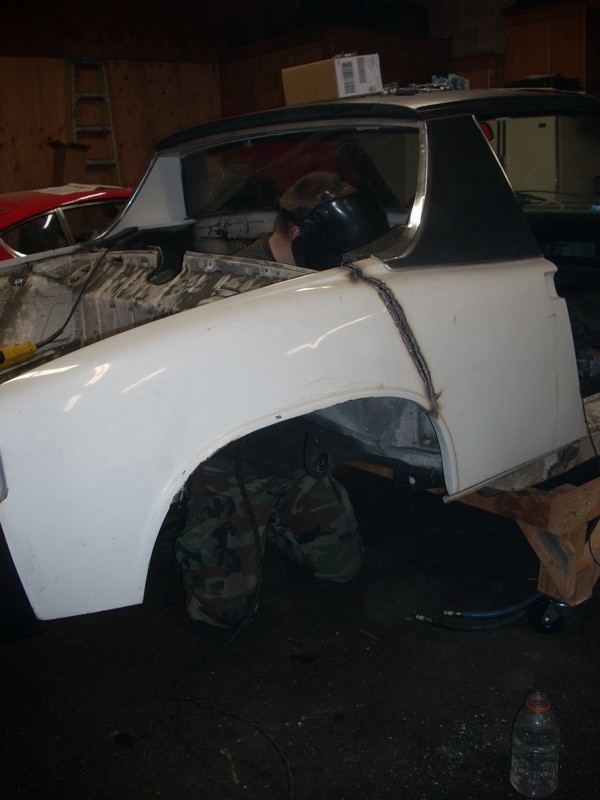

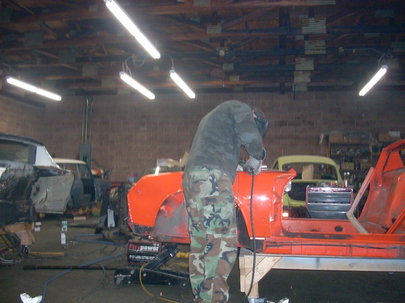

Once at McMark's shop in Sonoma, we started stripping the car, built a second dolly to be able to roll the shell around and started to cut off the rear of the white car and the front of the red car.
Both cuts are rough cuts at this point. Next weekend, we'll start with the more detailed cutting and test fitting.

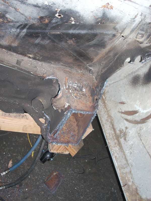

- Fixed the huge hole in the front trunk floor ...

Picking up the second car: cheer.gif

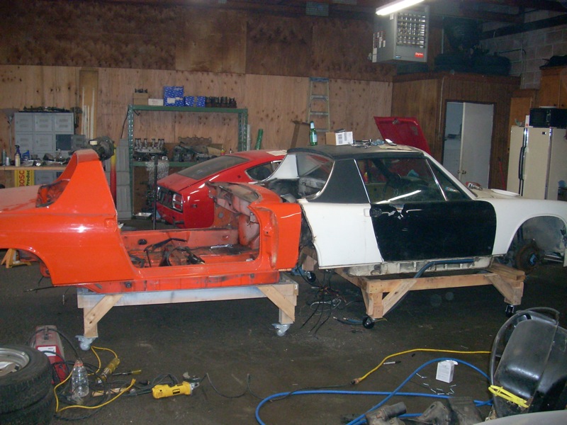

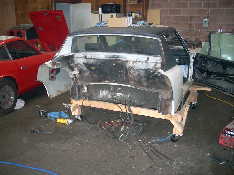

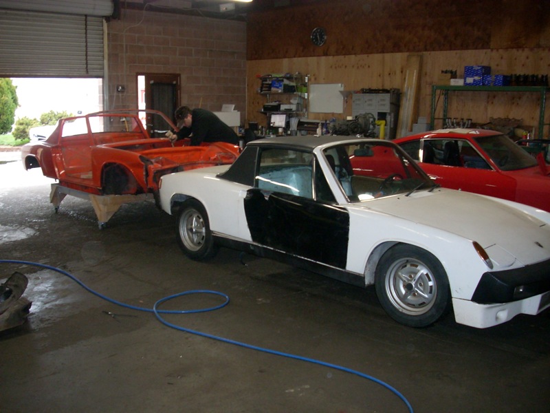

The two cars, before the cutting:

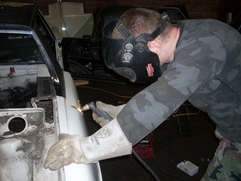

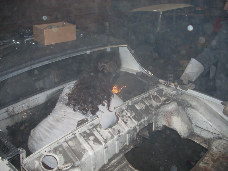

Me playing with the plasma cutter: wub.gif
More cutting. The longs on the later cars have a double walled inner reinforcement that took quite a bit of work to cut through.

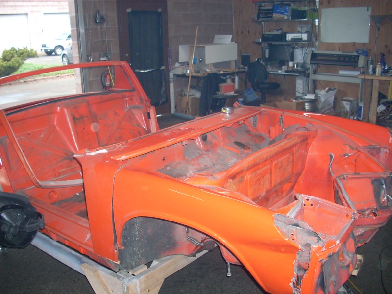

Closeup of the inner workings of the hell hole. They all have rust there, even if the top of the long looks decent.

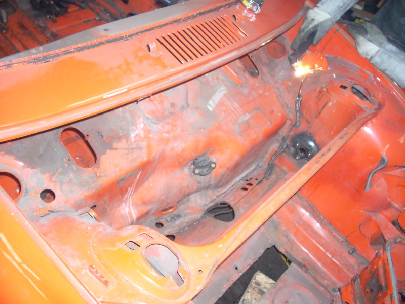

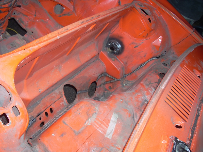

Second car, front end ready to be cut: sawzall-smiley.gif
We're saving the windshield hoop for later:
Nice cut line ...
Almost there:

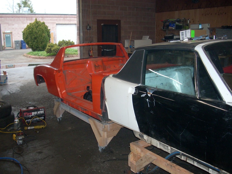

This gives you a rough idea of the dimensions although we'll be cutting off another 1 1/2 feet or so.
Basically, the front door jamb of the red car will be right at the firewall of the white car.
