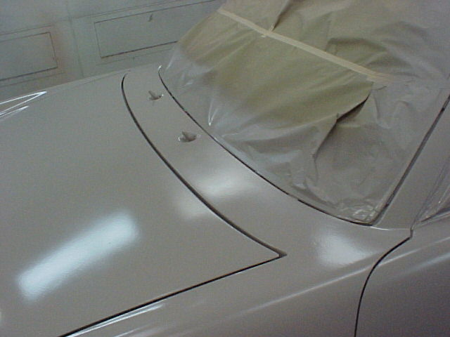

all the holes filled and primed...I'm happy

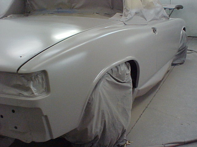

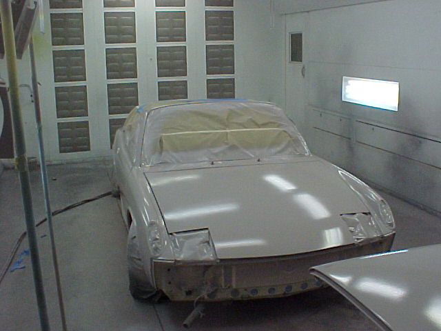

more...
We were out of the booth by 9:30 this evening.
What a day.
The car will now sit until the paint is sandable.
I think it may rain tomorrow so it may not be possible to apply the color and clear on Friday.
Car needs to sit out in the sun and bake.
That's OK, though.
KT

Those are obviously "hood pin" holes at the tail of the trunk?
I know dumb question. Oh, metal glaze over the Entire trunk lid? Is that normal procedure?

trekkor has a rear spoilier, so I bet that's what the holes are for.

The metal glaze ends up being transparent in many areas after sanding.
Bondo is funny stuff in the way that it makes you think, "It must be thick". (IMG:http://www.914world.com/bbs2/html/emoticons/ohmy.gif)
Brandon assured me that the primer would be thicker than most of the bondo.
Yep, rear spoiler mounts.
KT

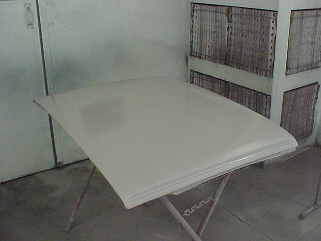

Do you have any pictures of the roof? Did you "float" the roof to get it smooth? or did you sand it down?

roof shot-
I bought Randal's old smooth painted top, block sanded it out with 180 grit. Metal glazed a couple of low spots and chips.

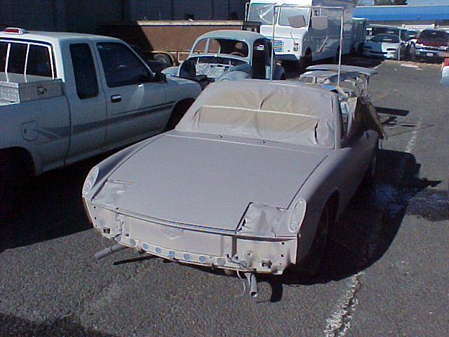

The weather was perfect for baking my car in the sun...All day.
