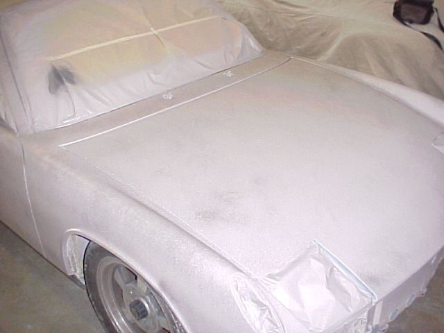

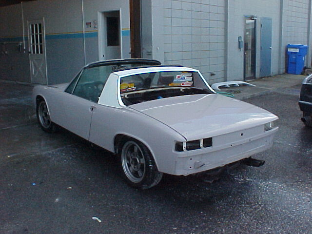

guide coat over primer- ready for 400 grit wet sanding

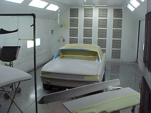

Back in the booth masked, wiped over with the degreaser/cleaner and a tack rag
Next we go to color

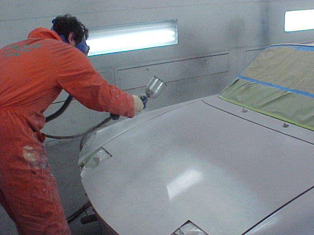

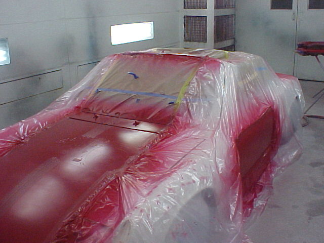

it starts (IMG:http://www.914world.com/bbs2/html/emoticons/smilie_pokal.gif)

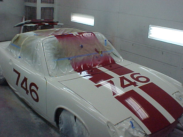

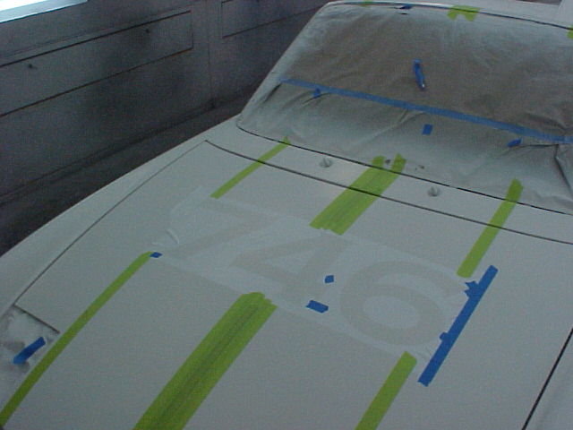

getting the stripes and number mask set up.
McMark cut the lo-tack masking vinyl for me, thanks for that.

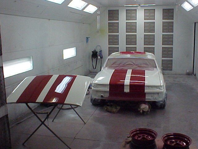

track car-

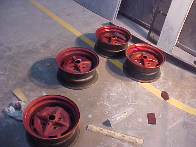

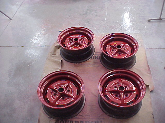

the wheels to match.
I going to sleep now... (IMG:http://www.914world.com/bbs2/html/emoticons/yellowsleep[1].gif)
