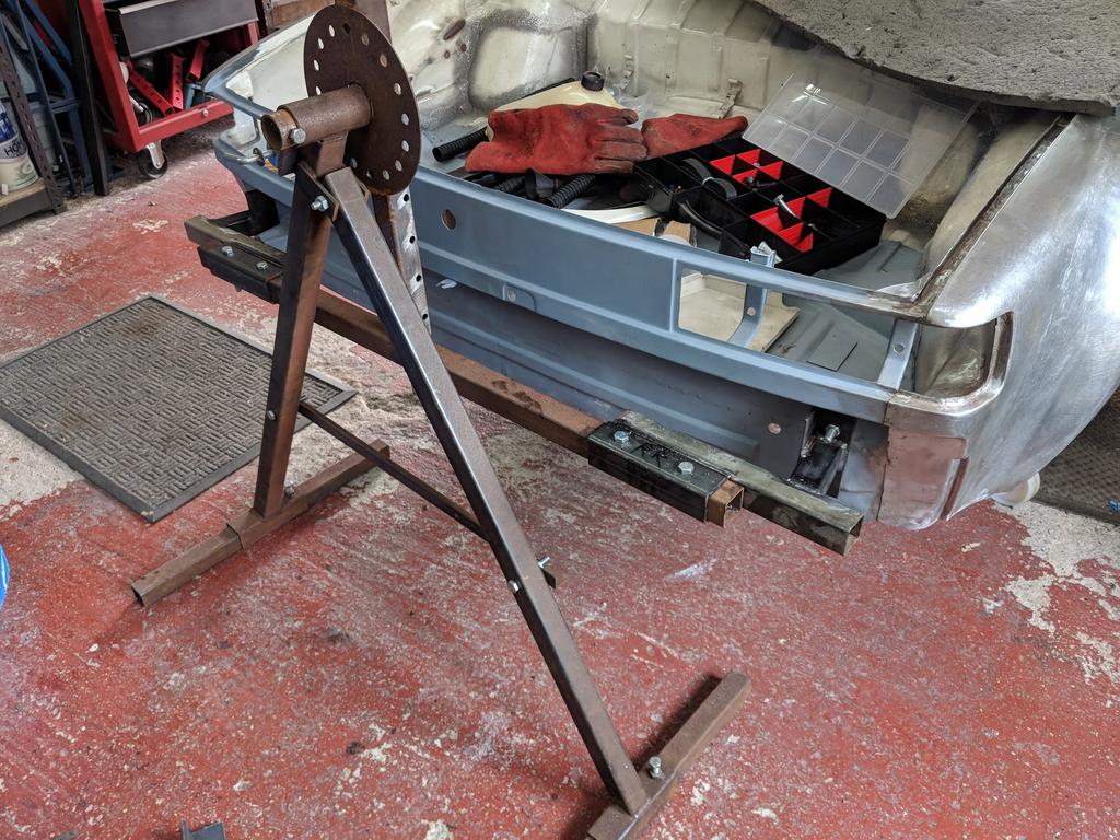

The same guy who recommended the painted was also kind enough to lend me his rotisserie, I just needed to make adaptors so suit my car.
(IMG:http://www.914world.com/bbs2/uploads_offsite/s6.postimg.cc-6621-1534883625.1.jpg)

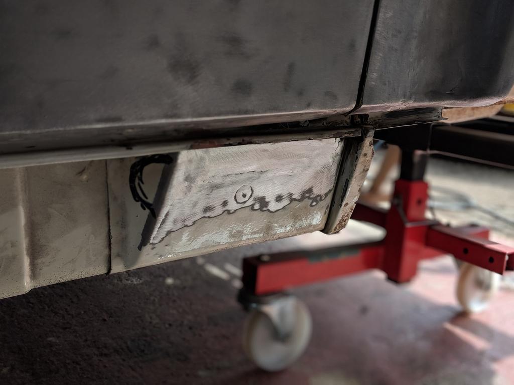

The only job worth photographing was the modification to sill to allow for oil lines to my front cooler. The cooler I'm using has the input and output on opposite sides so I decided the best option was to run a line down each side of the car. Yeah I agree it's not the norm but once the car is together none of it would be visible anyway and it was a considerably cheaper option for the same outcome.
The bottom of the left A post has the indentations originally going to the charcoal canister as I won't be needing those the space is there for the oil line. The right side however is different and required modification.
Before (I'd already previously done a small patch repair here)
(IMG:http://www.914world.com/bbs2/uploads_offsite/s6.postimg.cc-6621-1534883648.1.jpg)

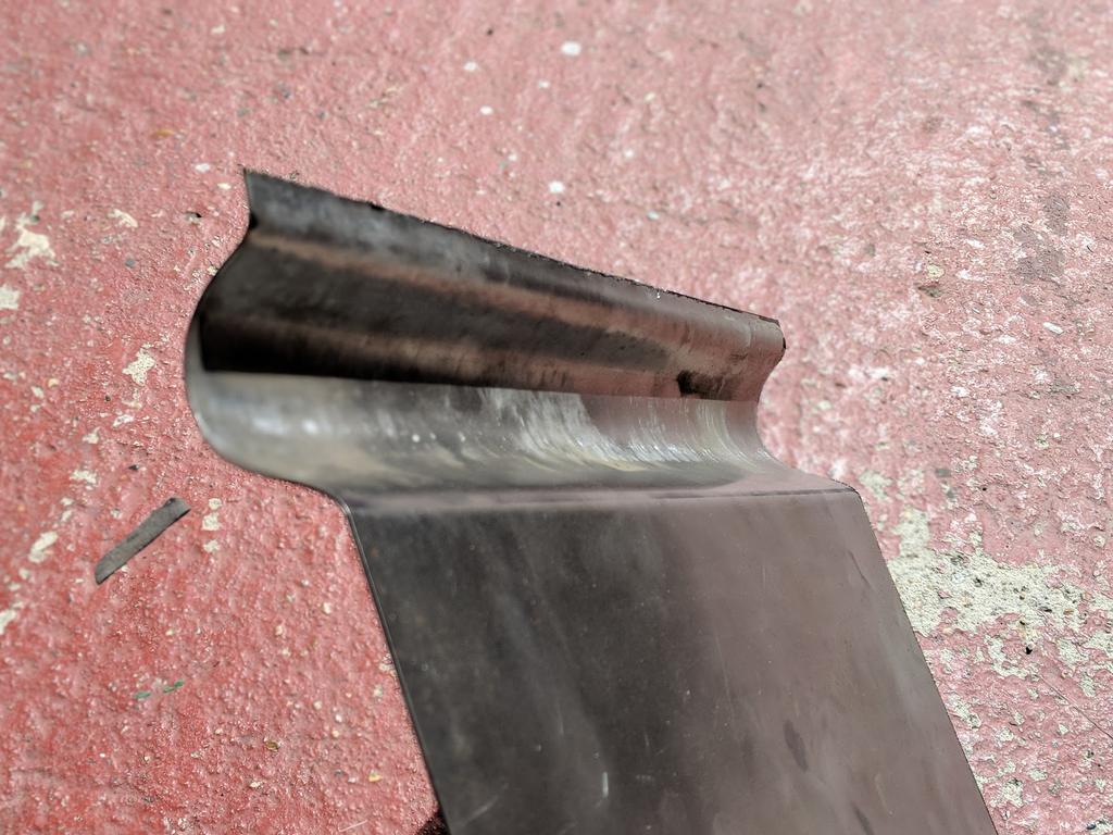

A bit of creative shaping with a scaffold pole (IMG:style_emoticons/default/laugh.gif)
(IMG:http://www.914world.com/bbs2/uploads_offsite/s6.postimg.cc-6621-1534883648.2.jpg)

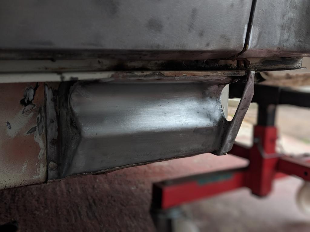

Almost finished
(IMG:http://www.914world.com/bbs2/uploads_offsite/s6.postimg.cc-6621-1534883649.3.jpg)
