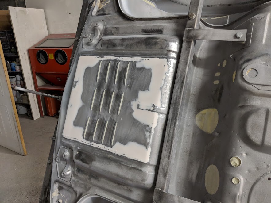

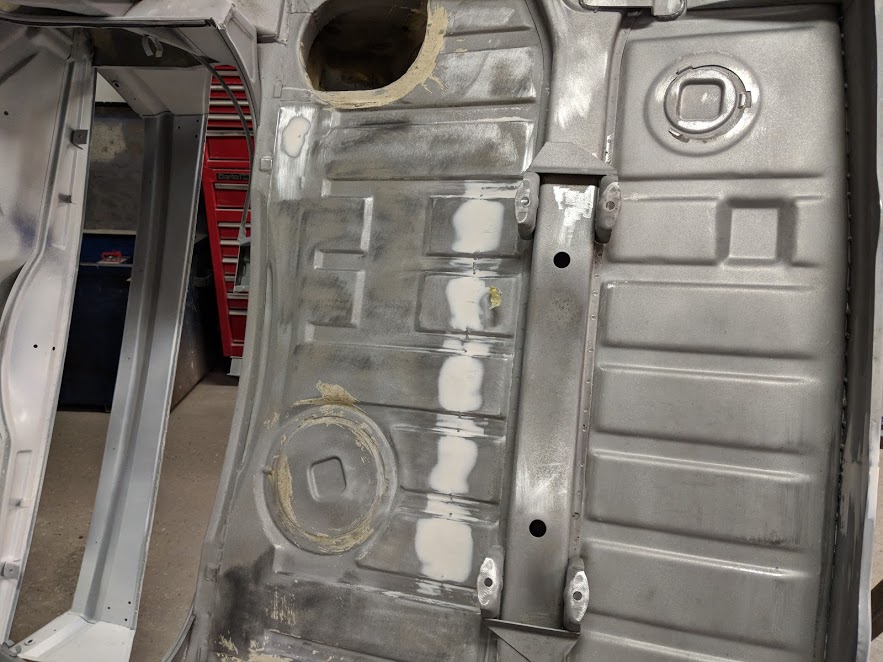

Another visit to the see the car this morning to catch up and see the progress. The previous project, a plane believe it or not, that was holding up progress on mine has now been completed and shipped out so mine will now move along a lot quicker. Not a problem though as I knew this was the case.
Not an awful lot to see but a few pictures nonetheless.
A frew bits on the floor have been tidied up that I was previously unable to get to.
(IMG:http://www.914world.com/bbs2/uploads_offsite/i.postimg.cc-6621-1538823528.1.jpg)
(IMG:http://www.914world.com/bbs2/uploads_offsite/i.postimg.cc-6621-1538823528.2.jpg)
(IMG:http://www.914world.com/bbs2/uploads_offsite/i.postimg.cc-6621-1538823529.3.jpg)
(IMG:http://www.914world.com/bbs2/uploads_offsite/i.postimg.cc-6621-1538823529.4.jpg)
Topside a first light skim of filler over the arch welds.
(IMG:http://www.914world.com/bbs2/uploads_offsite/i.postimg.cc-6621-1538823530.5.jpg)
(IMG:http://www.914world.com/bbs2/uploads_offsite/i.postimg.cc-6621-1538823530.6.jpg)
Over the next week the underneath will be completed and the car will come off the rotisserie. More updates in a week or two. (IMG:style_emoticons/default/cheer.gif)

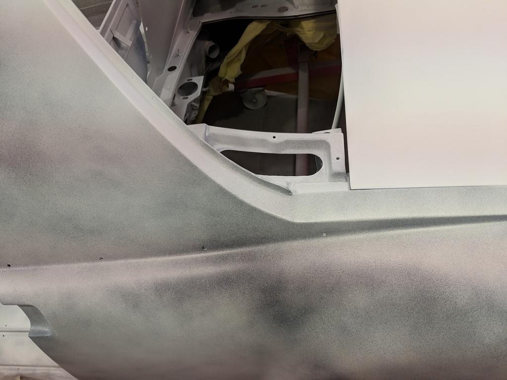

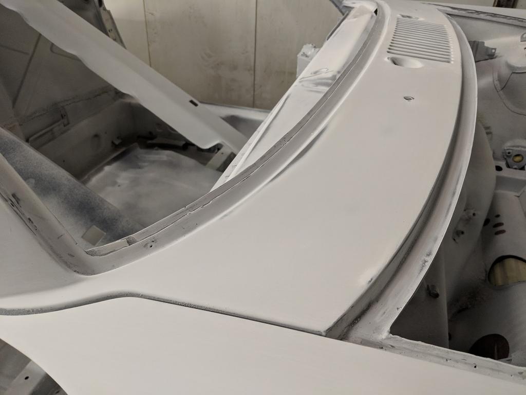

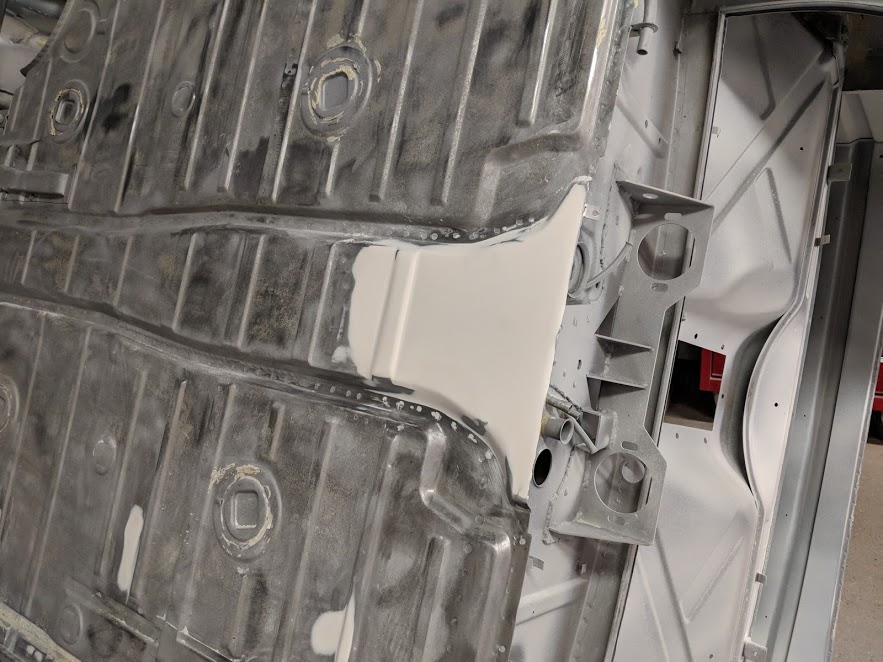

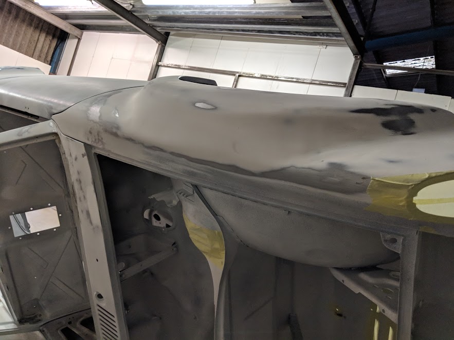

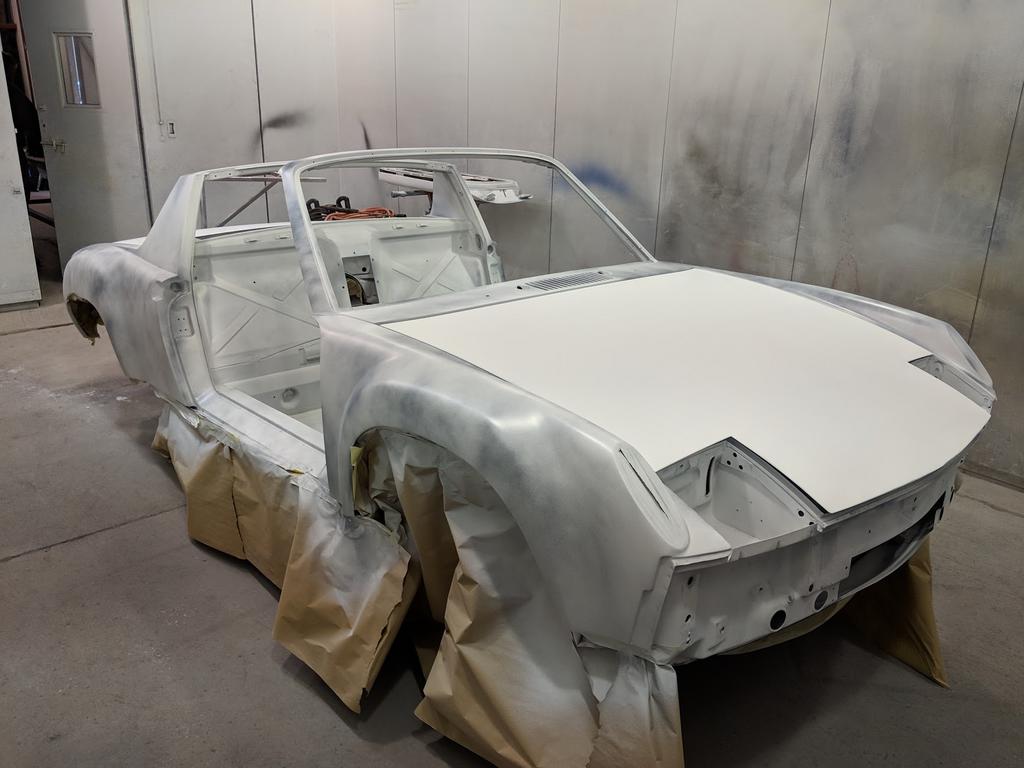

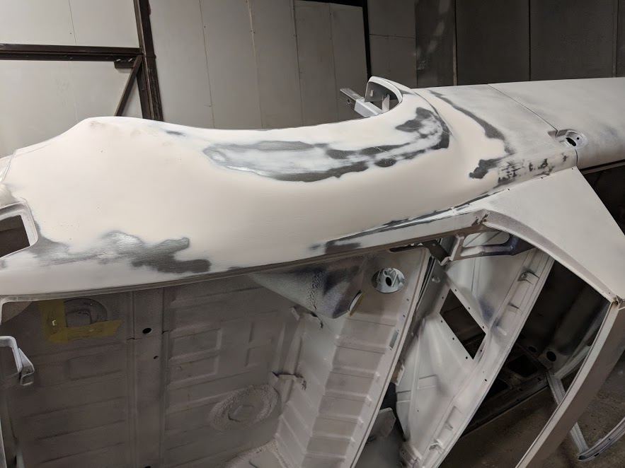

Another Saturday morning visit to the bodyshop and delighted to see some good progress made on the car.
(IMG:http://www.914world.com/bbs2/uploads_offsite/i.postimg.cc-6621-1540640678.1.jpg)
(IMG:http://www.914world.com/bbs2/uploads_offsite/i.postimg.cc-6621-1540640680.2.jpg)
(IMG:http://www.914world.com/bbs2/uploads_offsite/i.postimg.cc-6621-1540640680.3.jpg)
(IMG:http://www.914world.com/bbs2/uploads_offsite/i.postimg.cc-6621-1540640681.4.jpg)
(IMG:http://www.914world.com/bbs2/uploads_offsite/i.postimg.cc-6621-1540640681.5.jpg)
(IMG:http://www.914world.com/bbs2/uploads_offsite/i.postimg.cc-6621-1540640682.6.jpg)
(IMG:http://www.914world.com/bbs2/uploads_offsite/i.postimg.cc-6621-1540640682.7.jpg)
(IMG:http://www.914world.com/bbs2/uploads_offsite/i.postimg.cc-6621-1540640683.8.jpg)

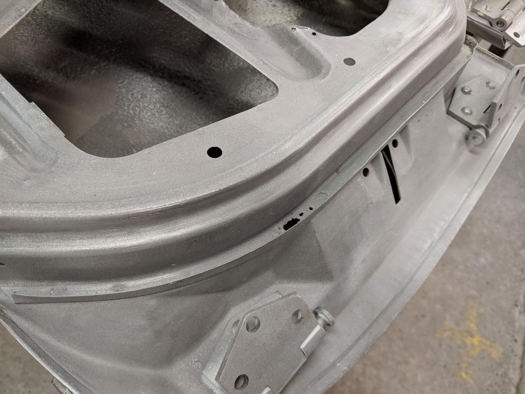

Of course there's always a few not so nice bits too. Just a few small holes found in the door seal channel a a few pin holes on the boot lid structure. They'll all be welded up.
(IMG:http://www.914world.com/bbs2/uploads_offsite/i.postimg.cc-6621-1540640683.9.jpg)
(IMG:http://www.914world.com/bbs2/uploads_offsite/i.postimg.cc-6621-1540640684.10.jpg)

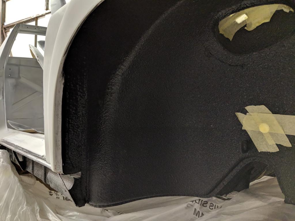

And finally a shot most purists wouldn't approved of. I decided long ago that if the car remained Light Ivory I didn't want the wheel wells to be that colour. Personally I'm not keen on seeing body colour in that area, although if the car was a darker colour I'd have probably left it or used an over-paintable product. So underneath and the arches have been sprayed with a black polymer sealer that actually has kevlar fibres mixed in it. It's strong stuff and will provide the level of protection and sound insulation I'm after.
(IMG:http://www.914world.com/bbs2/uploads_offsite/i.postimg.cc-6621-1540640684.11.jpg)

car looks great, and the wheel wells look great also. I painted my wheel wells black for the same reason as you, although my entire pan and engine bay is also black.
It's refreshing to see even the pros use body filler.

I debated with myself over whether to go black or body color on the wheel wells and undercarriage. My car left the dealer with black undercoat so I think you could argue that was original. I wound up going body color and really like it, but I think it's hard to argue against black if that's the preferred look. Can't wait for the next update! (IMG:style_emoticons/default/beerchug.gif)

Thanks, yes I'm pleased with them. Although it was a decision that took me a while to make.
Thanks Brent. My car was also black undersealed too on delivery so you're right, it's original (IMG:style_emoticons/default/laugh.gif)

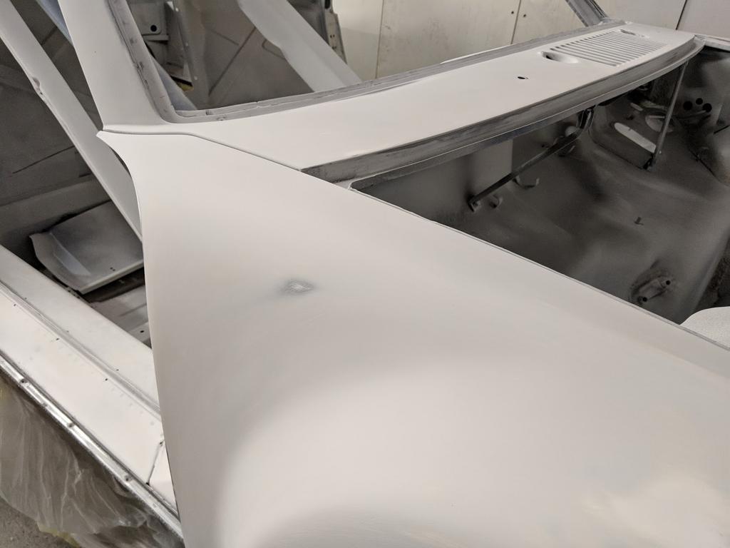

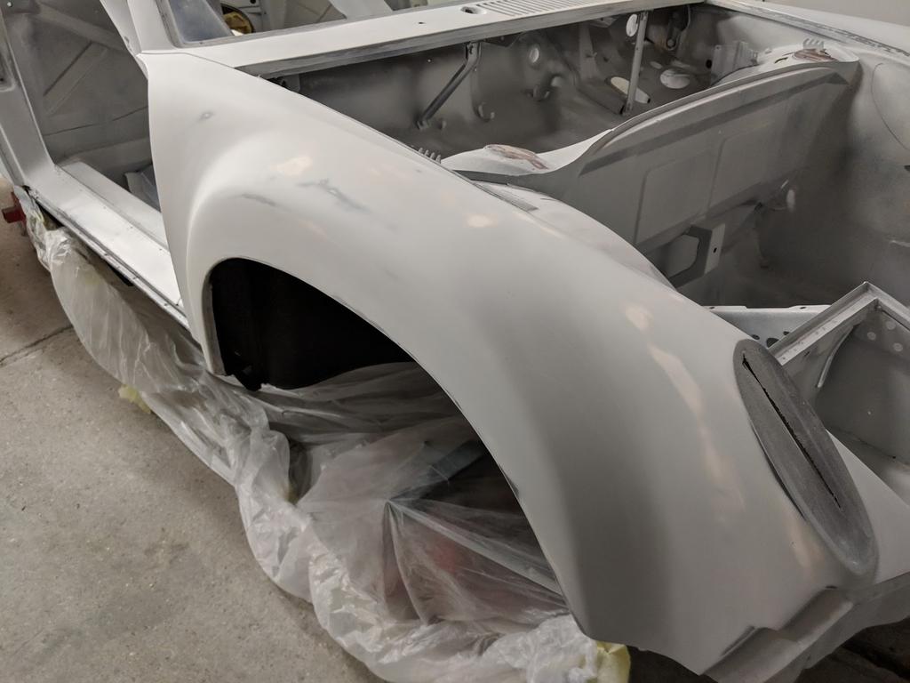

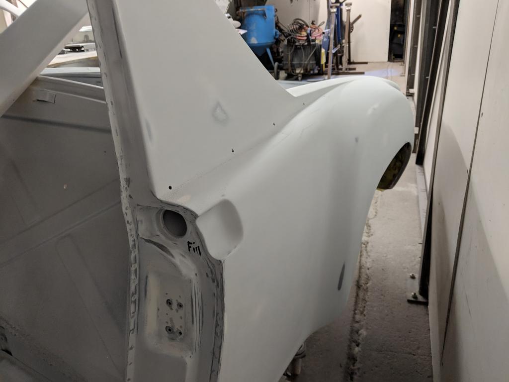

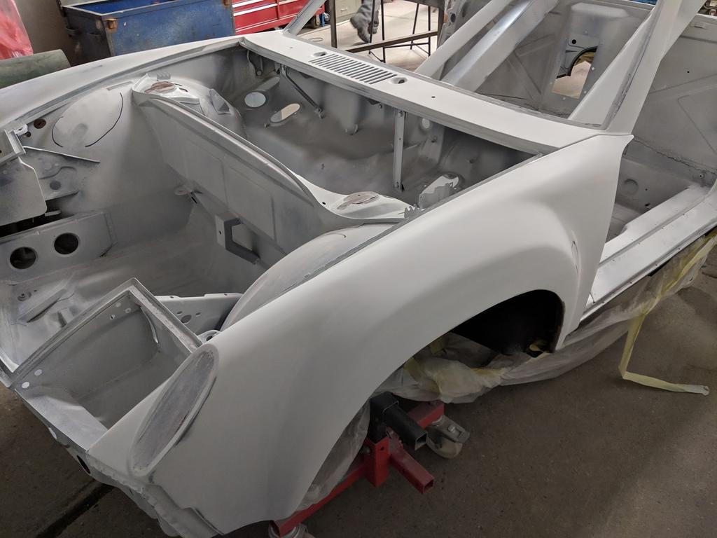

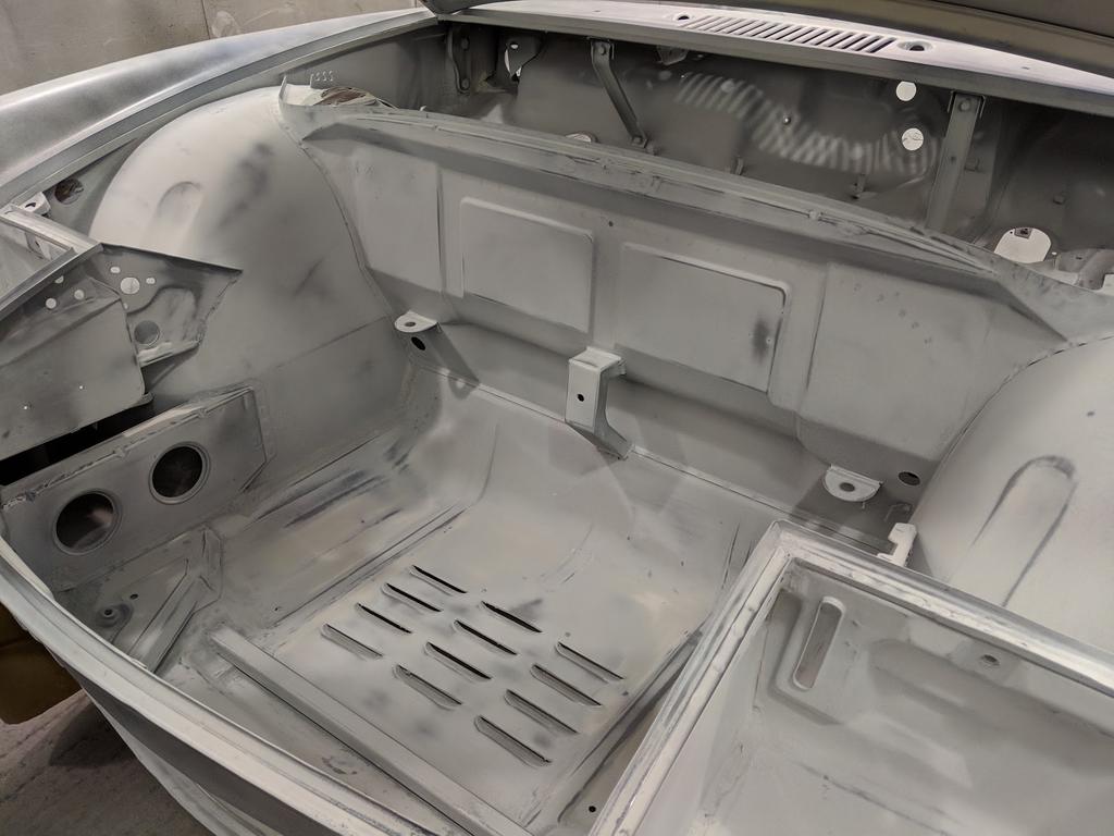

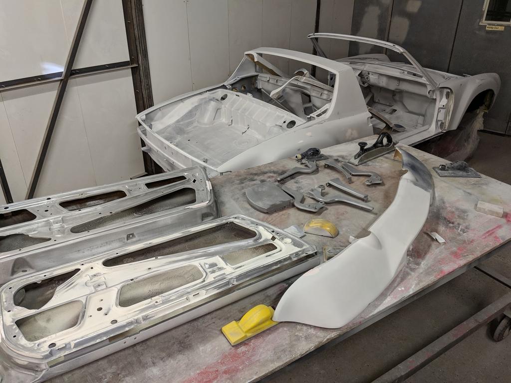

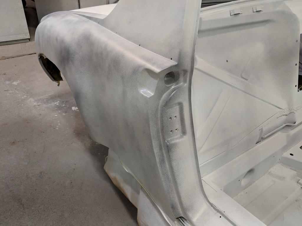

More progress this week as the outside is now at the high build primer stage. Looking great for it too.
(IMG:http://www.914world.com/bbs2/uploads_offsite/i.postimg.cc-6621-1542533670.1.jpg)
(IMG:http://www.914world.com/bbs2/uploads_offsite/i.postimg.cc-6621-1542533671.2.jpg)
(IMG:http://www.914world.com/bbs2/uploads_offsite/i.postimg.cc-6621-1542533671.3.jpg)

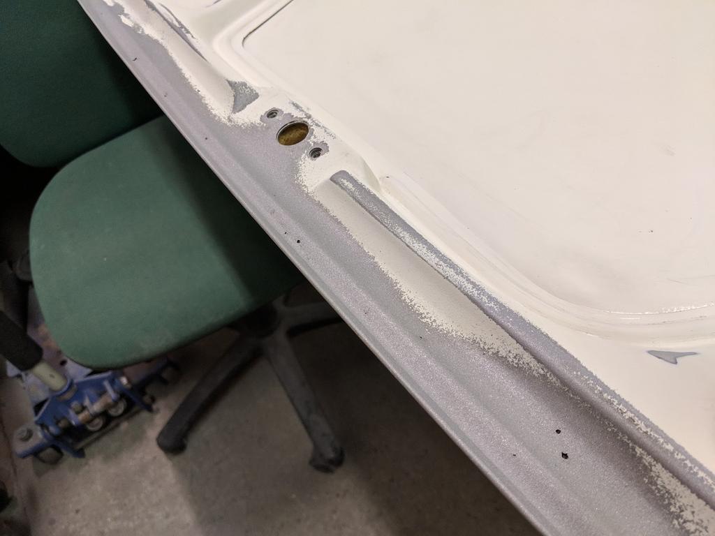

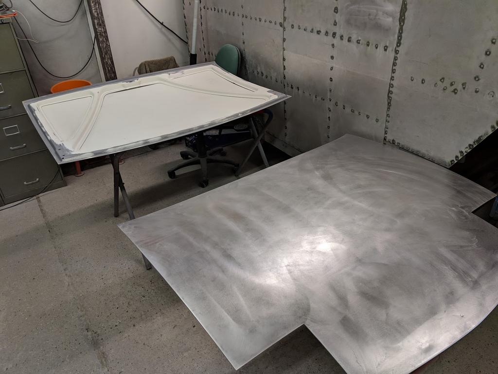

Rather frustratingly I noticed that when I replaced the sail panels I forgot to drill the holes for the rear sail trim. On my next visit I'll take the trim along with me and get those drilled before the car is painted.
(IMG:http://www.914world.com/bbs2/uploads_offsite/i.postimg.cc-6621-1542533672.4.jpg)
Getting close now :cheers:
