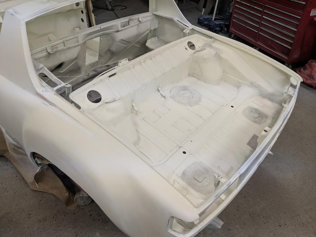

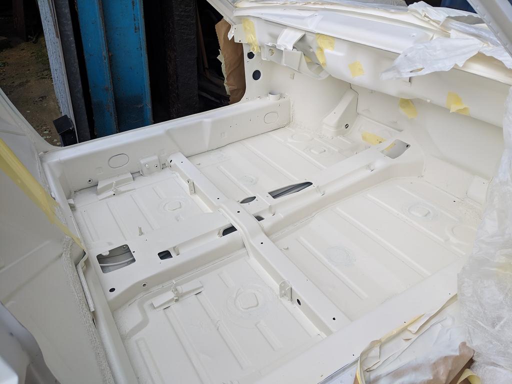

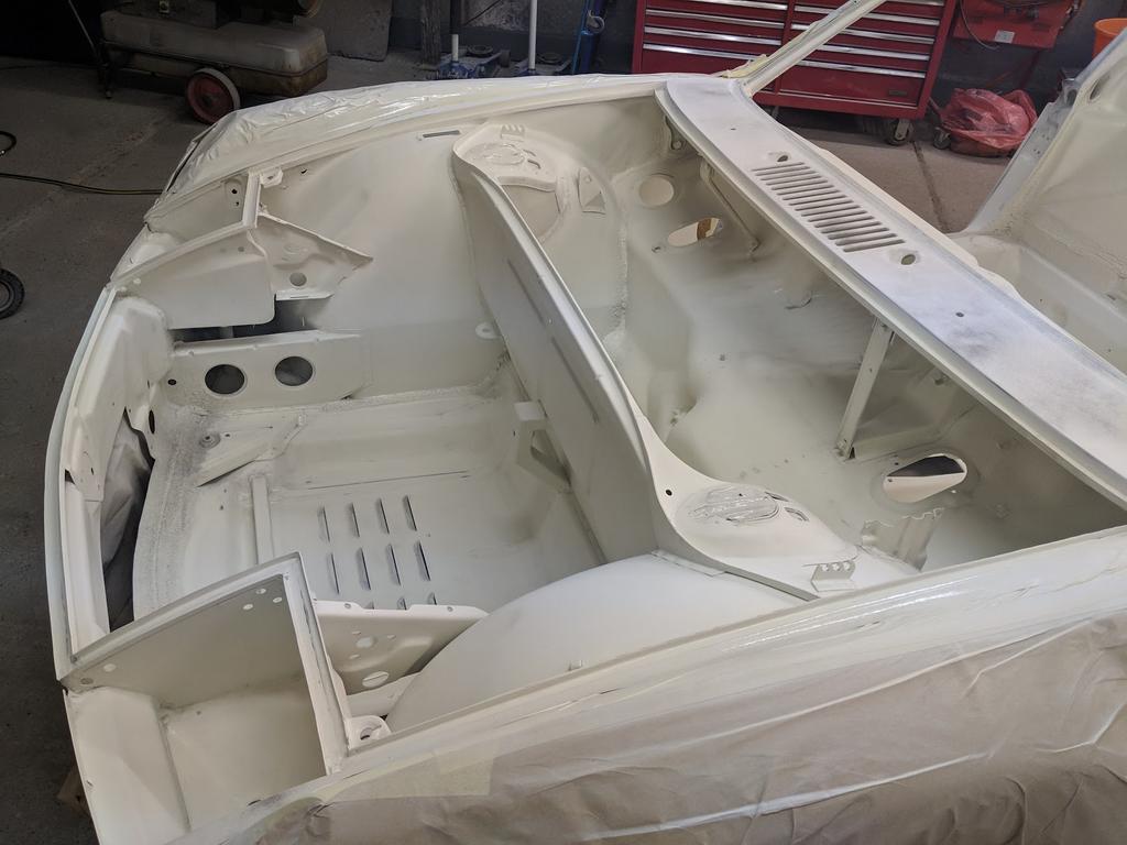

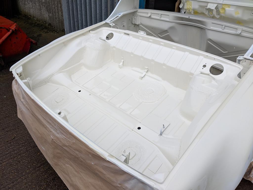

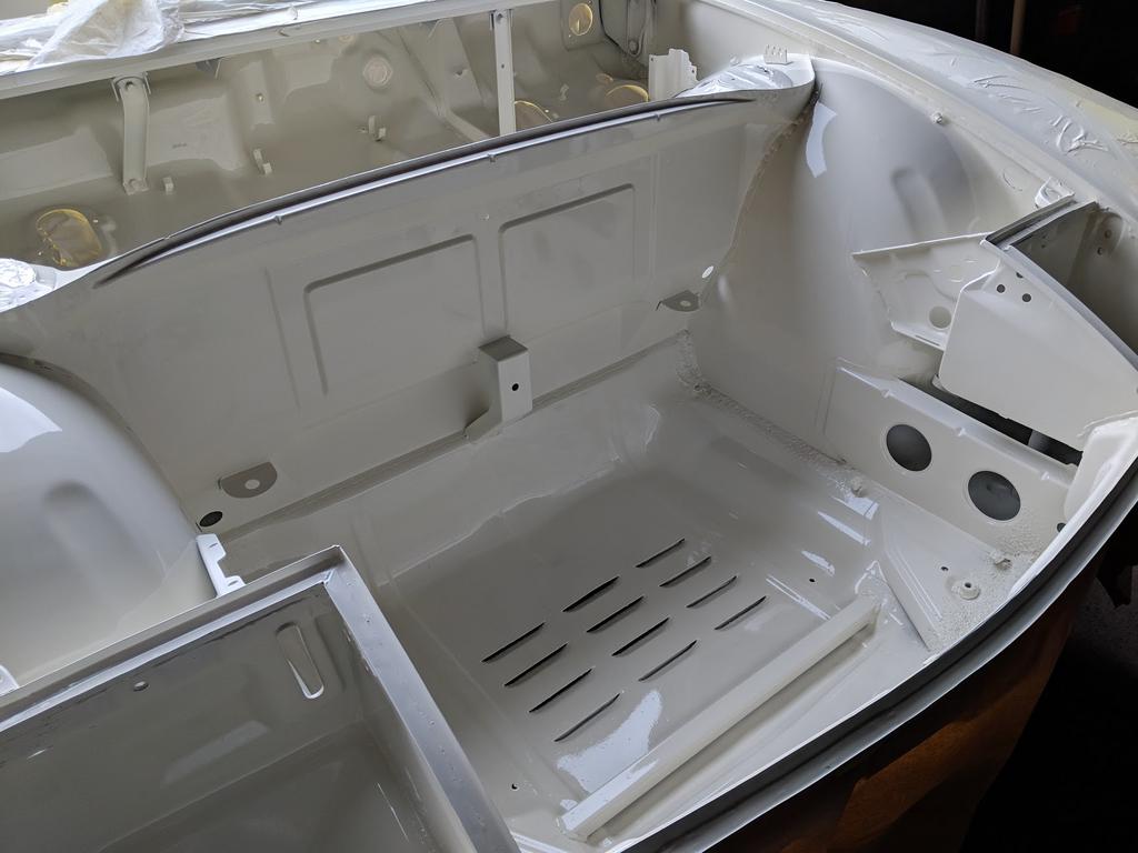

A day of mixed feelings today.
When I got up this morning I was so excited to see the car with some colour on it. The drive over to the painter seemed to take forever. When I arrived the car didn't looks as I'd imagined it too, in fact it looked exactly how I didn't want it to look and I must admit I felt sick to my stomach.
At first glance I simply didn't like the colour, it looked so creamy and nothing like I remembered. We immediately got the spray outs that were done and compared them - perfect match. I then realised the lighting was awful and I needed to see the car in daylight. After moving a rather nice early 911 out of the way we wheeled my car out into the light.
(IMG:http://www.914world.com/bbs2/uploads_offsite/i.postimg.cc-6621-1549031860.1.jpg)
(IMG:http://www.914world.com/bbs2/uploads_offsite/i.postimg.cc-6621-1549031861.2.jpg)
(IMG:http://www.914world.com/bbs2/uploads_offsite/i.postimg.cc-6621-1549031861.3.jpg)
Outside the colour looked much better and indistinguishable from a sample of the original paint.
Months of build up and I'm now at home hoping I've chosen the correct colour. Not how I expected to feel.

Woohoo! (IMG:style_emoticons/default/piratenanner.gif) I can imagine the sick feeling in your stomach when you first thought the car was the wrong color. Glad to hear it worked out! Looks wonderful. Big Day.

Turned out beautiful Stephen!

I really like it. Hard to tell, but is it Light Ivory? Getting a shell in paint is a huge accomplishment- you should be very happy. (IMG:style_emoticons/default/beerchug.gif)

It is indeed but for some reason I can't help think it looks a bit too creamy. But as I mentioned above it's a perfect match for the colour my car was previously.

I like it! Of course I might be a little prejudiced having a light ivory car.
Keep going, when all reassembled it will not look so overwhelming.

As with so many things we are very invested in......anxiety takes over.
IT LOOKS GREAT !!!!!
I felt the same about the prep on my wheel houses and pan. I felt it was all
inadequately done. No one ever sees what we sweat over.
I'm jealous.

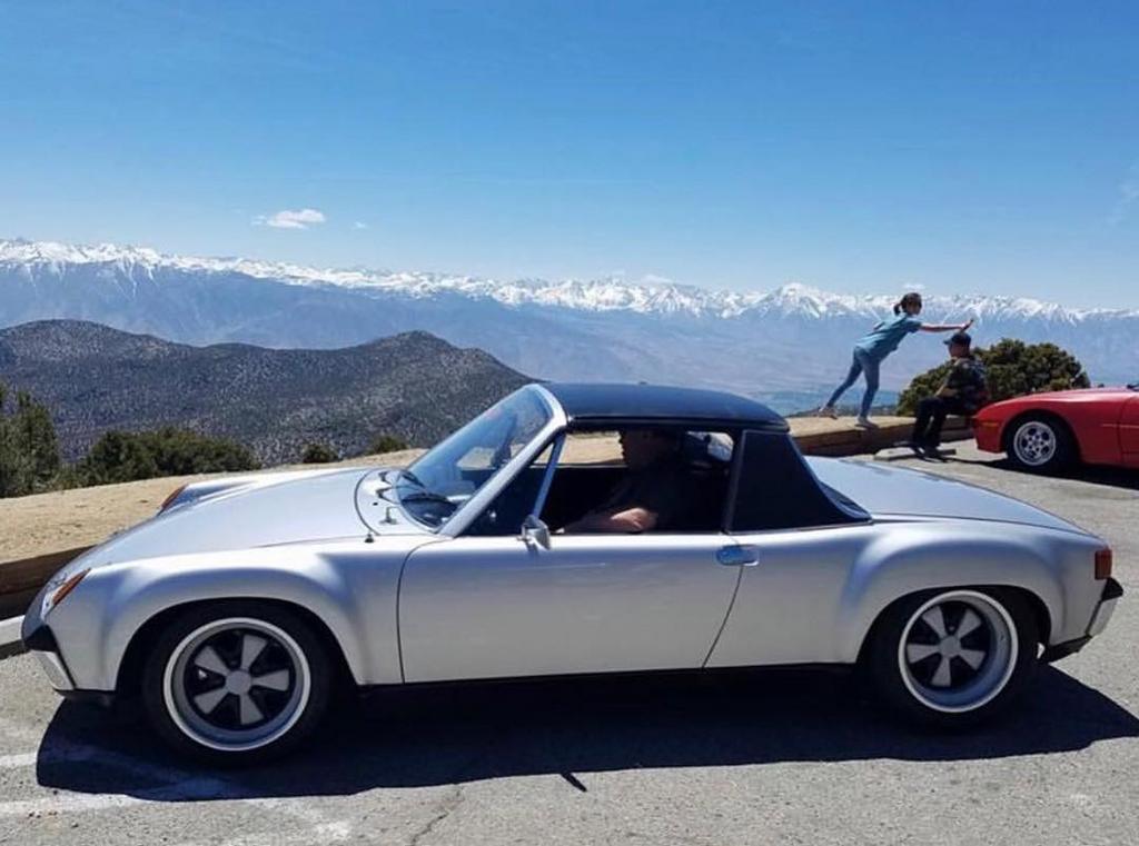

Thanks, I appreciate the comments. It was indeed a difficult and rather expensive decision to make but it's something I had to do.
I went back to see the car several times and despite having a folder full of great pictures of Light Ivory cars and sure that was the direction I wanted to go it just simply didn't work for me. Being this far into the project and with much money spent I knew I needed to change the colour.
For those that know me will know that for a long time I was going to paint the car silver, I actually don't remember why I decided now to stay with Light Ivory, originality maybe? I'm not sure.
This is a picture of ConeDodger's car I've had on file for sometime and it just looks absolutely fantastic. I messaged Rob and he confirmed it was L97A Diamond Silver Metallic.
(IMG:http://www.914world.com/bbs2/uploads_offsite/i.postimg.cc-6621-1550162072.1.jpg)
