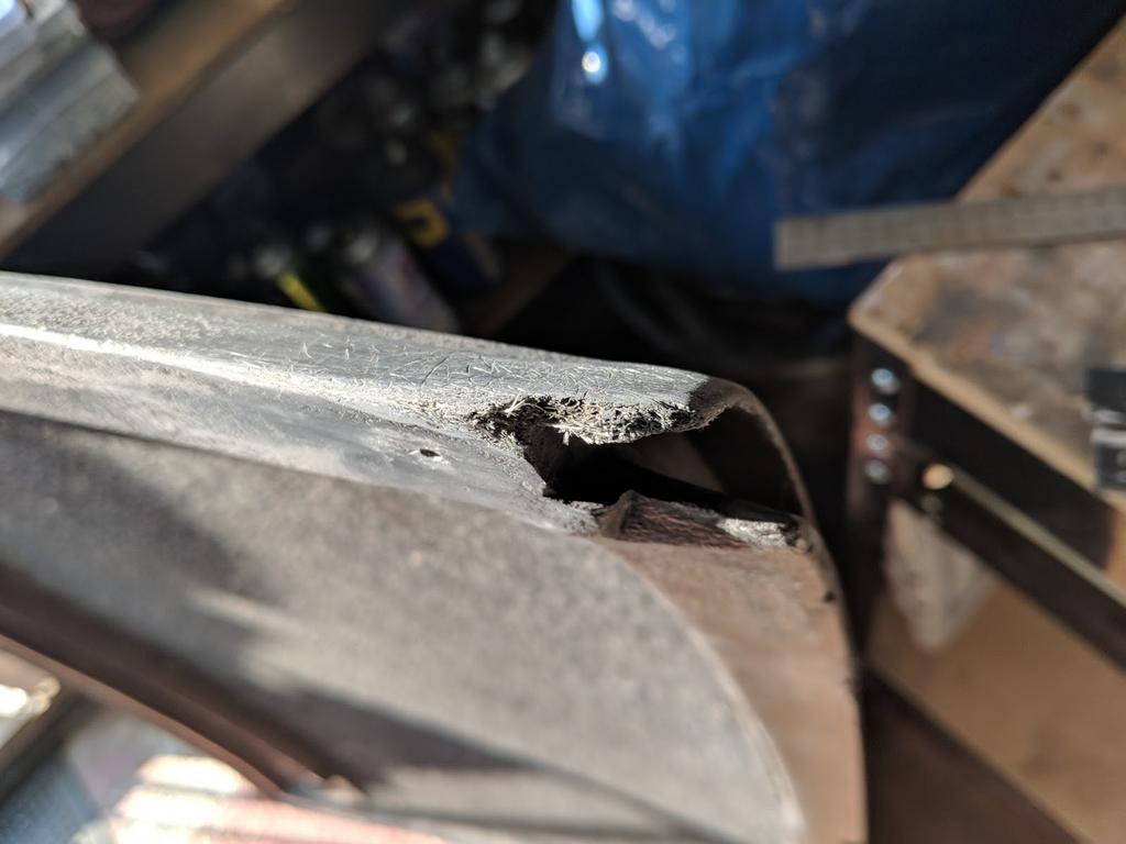

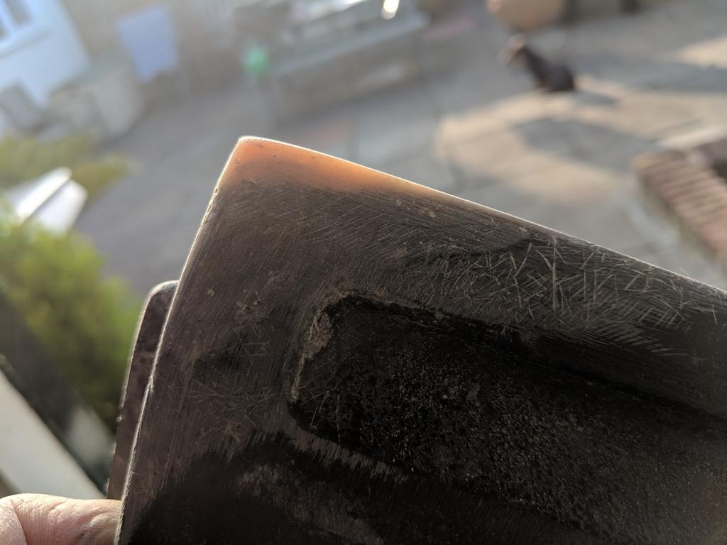

Years ago a bought a replacement targa top that was in much better condition than the one I got with my car. However like many others it had lost a corner at some point in its life. It was a presentable top but need looking at now.
This is the damaged corner.
(IMG:http://www.914world.com/bbs2/uploads_offsite/i.postimg.cc-6621-1552232093.1.jpg)

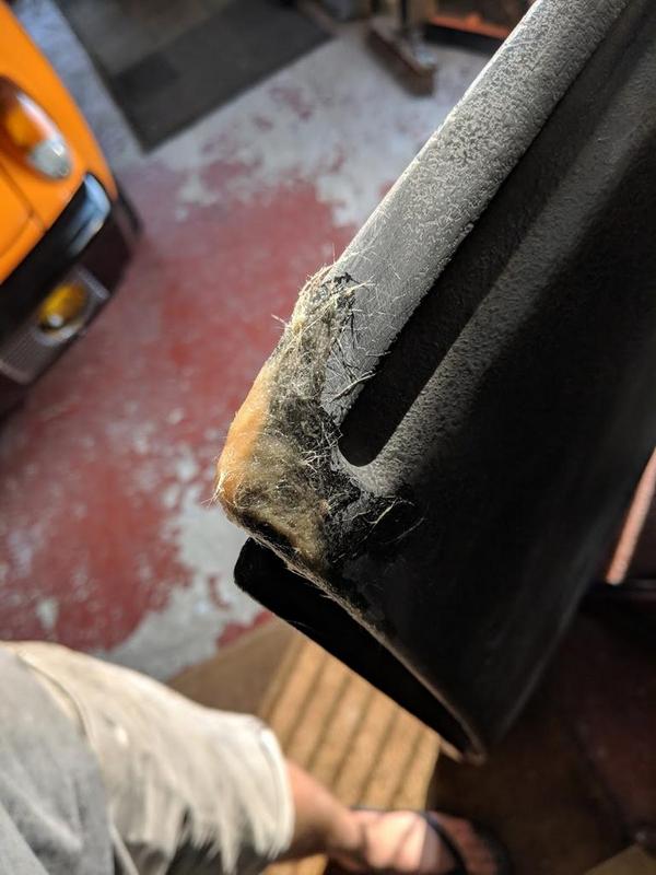

After cleaning the area I started to build it up using fibreglass filler.
(IMG:http://www.914world.com/bbs2/uploads_offsite/i.postimg.cc-6621-1552232094.2.jpg)
Before long I had enough filler there to enable me to reshape the corner as it would have originally been.
(IMG:http://www.914world.com/bbs2/uploads_offsite/i.postimg.cc-6621-1552232095.3.jpg)

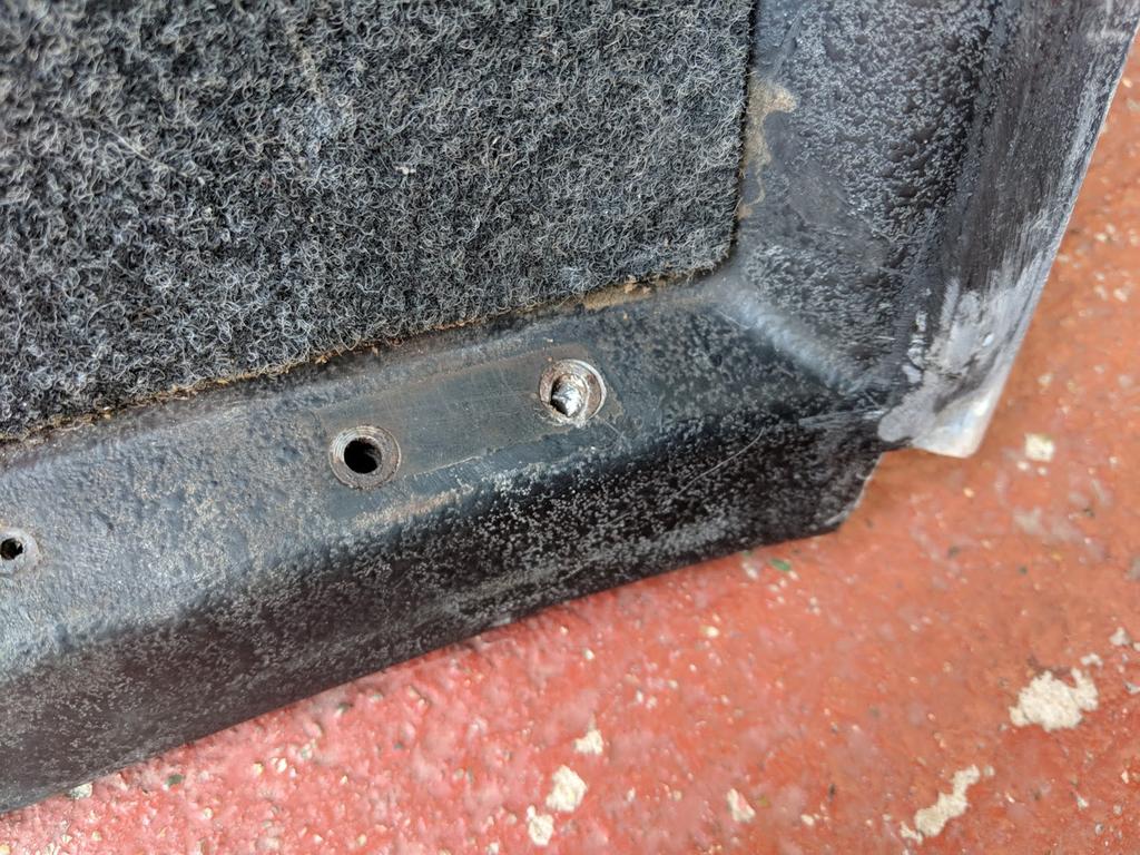

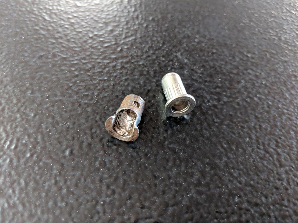

On removing the latch hardwear I came across one screw that wouldn't budge and in the end I had to drill out the insert.
(IMG:http://www.914world.com/bbs2/uploads_offsite/i.postimg.cc-6621-1552232109.1.jpg)
Once I had the insert out I could see that it closely resembled a rivnut.
(IMG:http://www.914world.com/bbs2/uploads_offsite/i.postimg.cc-6621-1552232110.2.jpg)
So with some strong two part adhesive I glued in a rivnut in its place.
(IMG:http://www.914world.com/bbs2/uploads_offsite/i.postimg.cc-6621-1552232113.3.jpg)

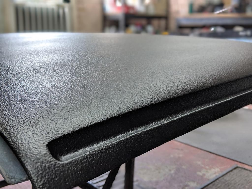

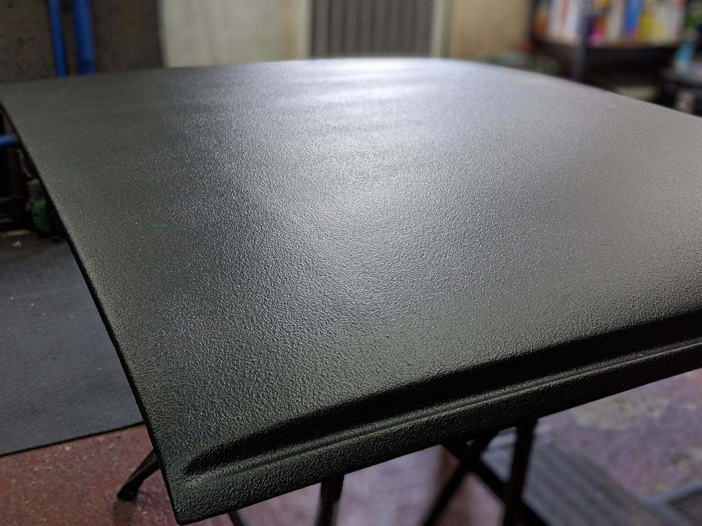

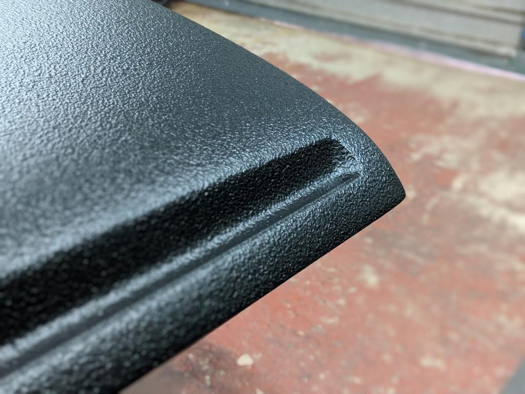

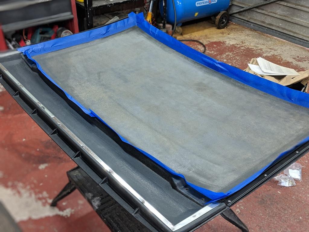

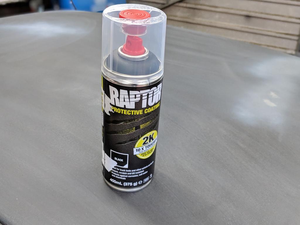

I'd seen Raptor Beliner used before to repaint the targa texture and fairly recently U-POL have released it in 2K Aerosol. After finding a couple of rather cheap cans on Ebay I decided to go that route.
(IMG:http://www.914world.com/bbs2/uploads_offsite/i.postimg.cc-6621-1552232124.1.jpg)
With the roof sanded down almost smooth with 80 grit and a few small repairs made and primered I was ready to give it a go.
Two cans later the job was done. To start with the finish was a bit patchy but I was prepared for that I knew it would impove after it had flashed off.
So 24 hours later this it what I had.
(IMG:http://www.914world.com/bbs2/uploads_offsite/i.postimg.cc-6621-1552232125.2.jpg)
(IMG:http://www.914world.com/bbs2/uploads_offsite/i.postimg.cc-6621-1552232126.3.jpg)
And here's that corner repair
(IMG:http://www.914world.com/bbs2/uploads_offsite/i.postimg.cc-6621-1552232129.4.jpg)

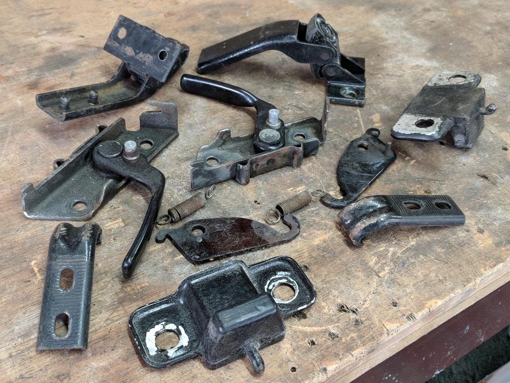

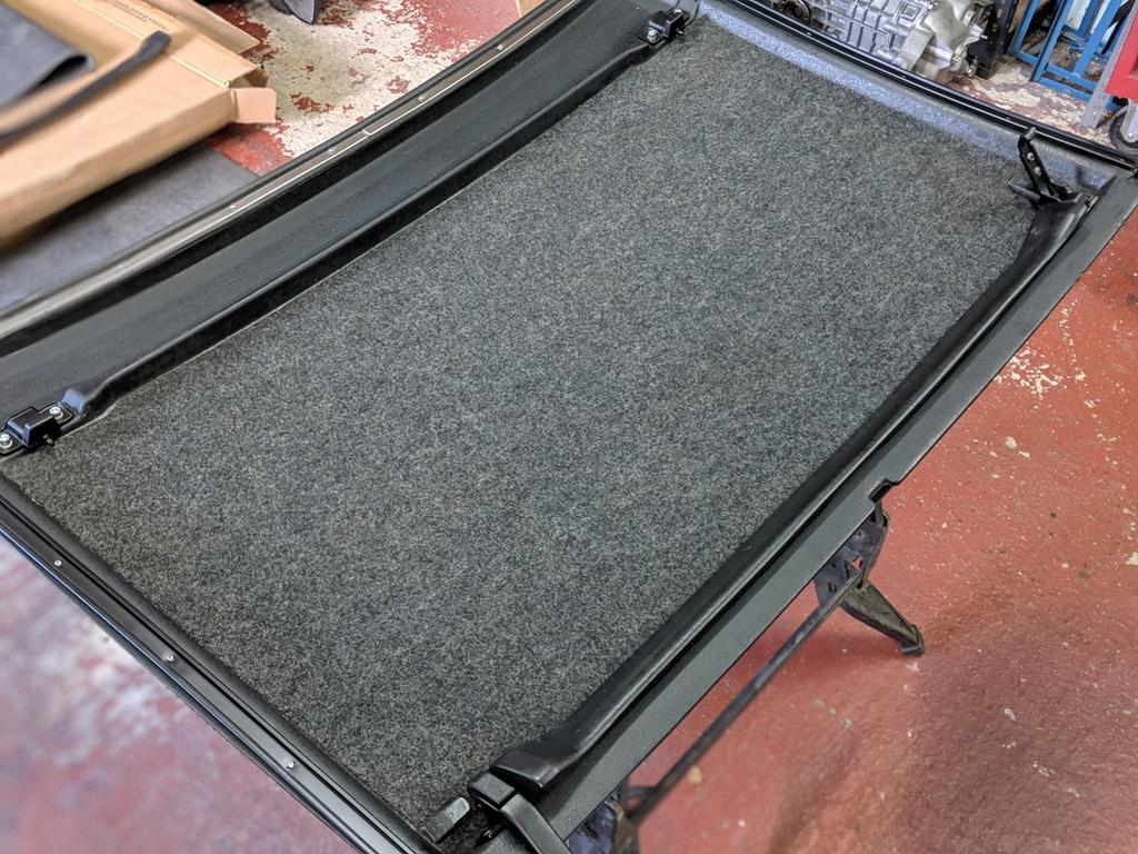

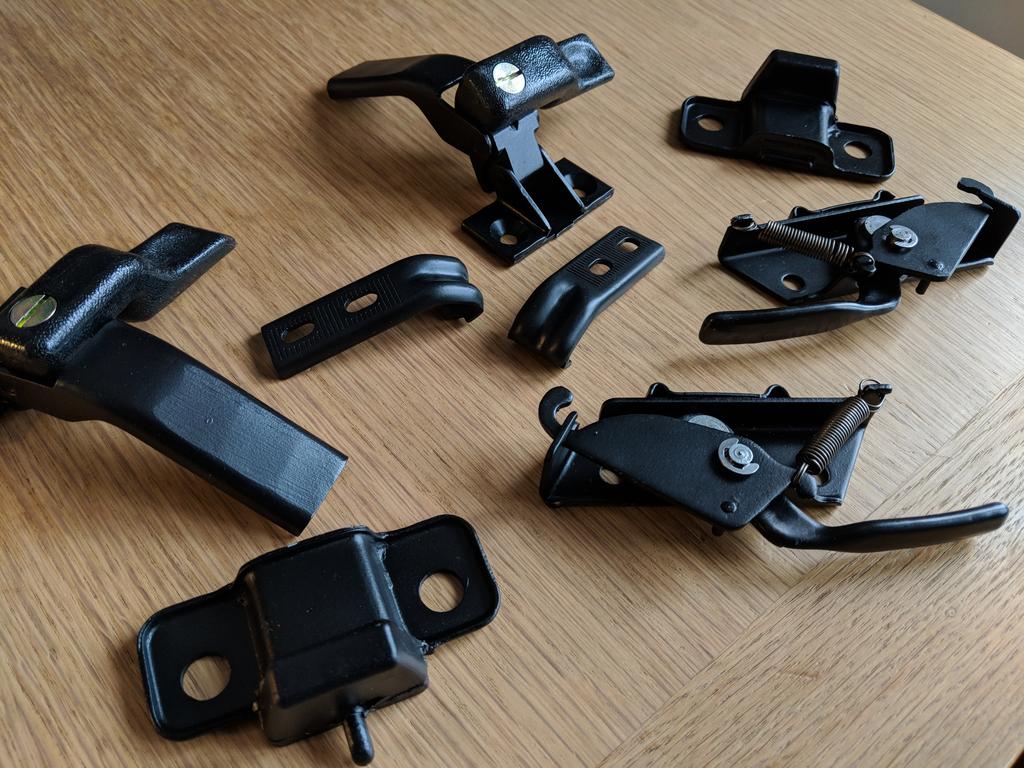

The next day I refitted the original Perlon and refurbished latches I did a few months ago along with new fittings.
(IMG:http://www.914world.com/bbs2/uploads_offsite/i.postimg.cc-6621-1552232144.1.jpg)
(IMG:http://www.914world.com/bbs2/uploads_offsite/i.postimg.cc-6621-1552232145.2.jpg)
(IMG:http://www.914world.com/bbs2/uploads_offsite/i.postimg.cc-6621-1552232146.3.jpg)
(IMG:http://www.914world.com/bbs2/uploads_offsite/i.postimg.cc-6621-1552232147.4.jpg)
Really happy with the result. The texture of the raptor liner is a bit finer than the original finish but it's closer to the finish of the vinyl on the sail panels.

Nice work! (IMG:style_emoticons/default/smilie_pokal.gif) I like the painted rear targa latches. I've been trying to figure out how to take mine apart for replating and get them back together after. I think I'll just follow your lead. Also good to know Raptor is available in spray bomb form.

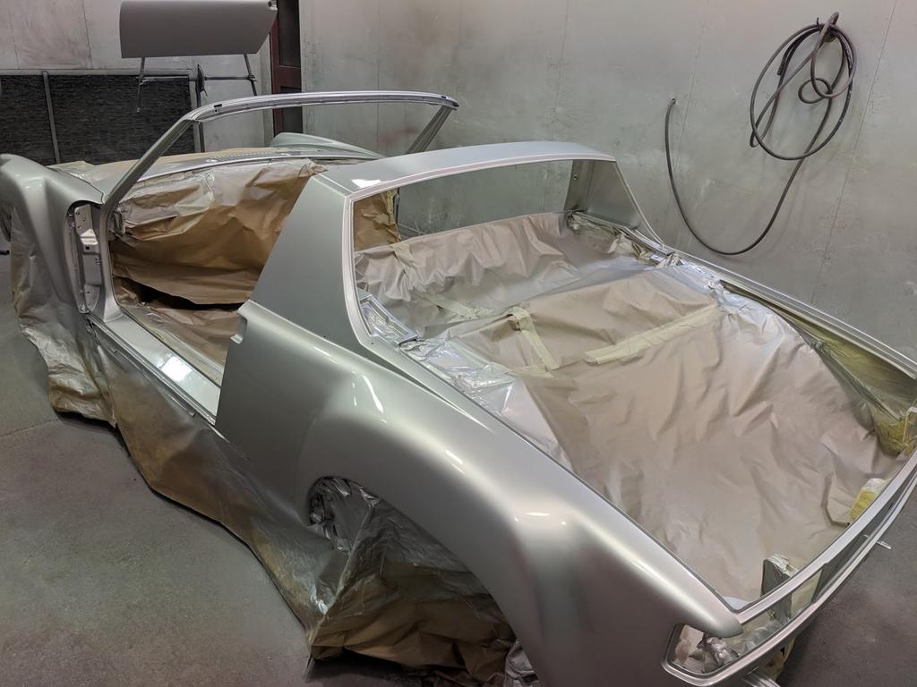

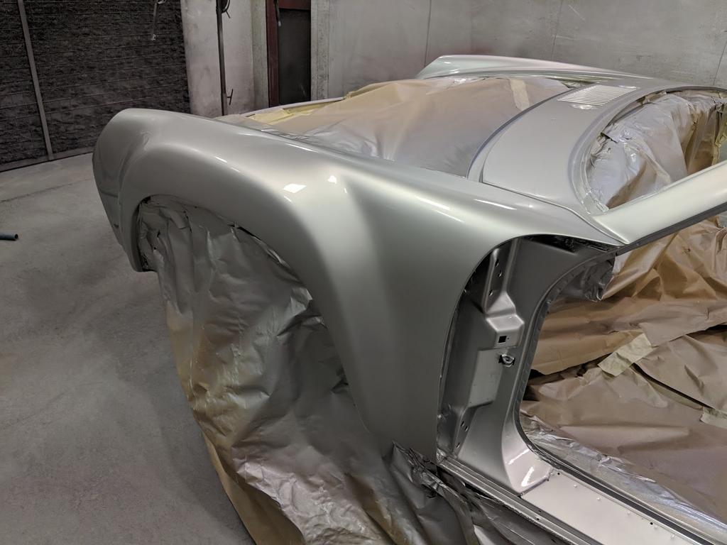

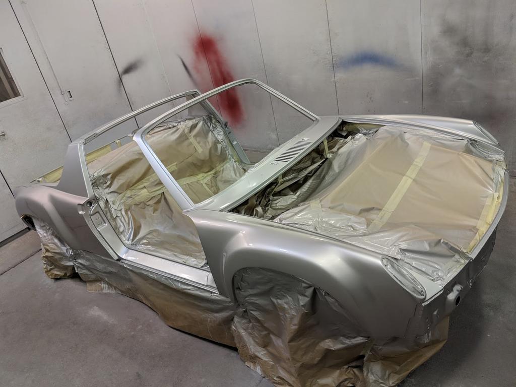

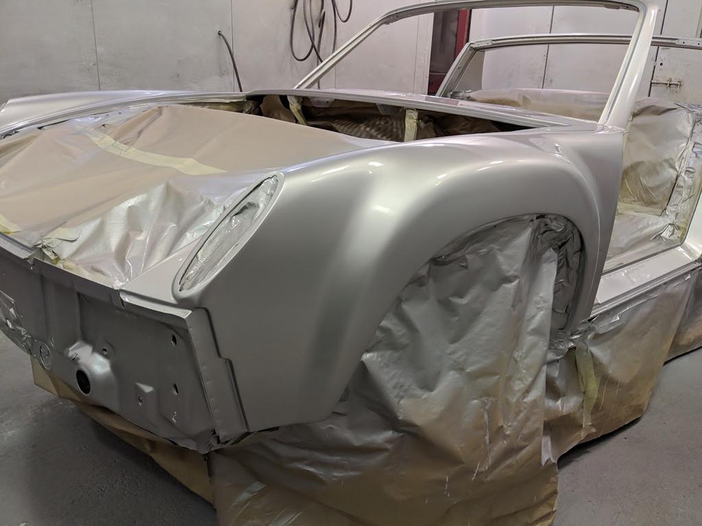

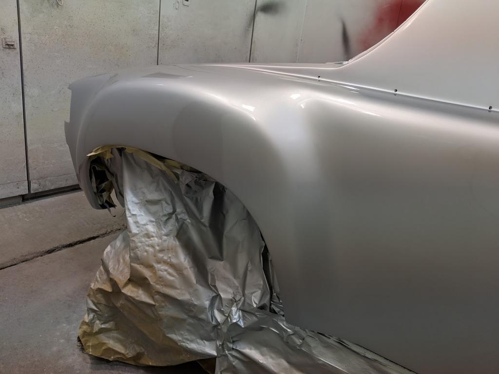

It's painted! I was speechless when I first saw the car. It truly looks fantastic at this stage it's just a gun finish but it still looks impressive.
Plan now is not to rush and leave it a couple of weeks for the paint to harden before polishing. All being well I should take delivery of it at the end of the month.
(IMG:http://www.914world.com/bbs2/uploads_offsite/i.postimg.cc-6621-1552314353.1.jpg)
(IMG:http://www.914world.com/bbs2/uploads_offsite/i.postimg.cc-6621-1552314353.2.jpg)
(IMG:http://www.914world.com/bbs2/uploads_offsite/i.postimg.cc-6621-1552314354.3.jpg)
(IMG:http://www.914world.com/bbs2/uploads_offsite/i.postimg.cc-6621-1552314354.4.jpg)
(IMG:http://www.914world.com/bbs2/uploads_offsite/i.postimg.cc-6621-1552314354.5.jpg)
(IMG:http://www.914world.com/bbs2/uploads_offsite/i.postimg.cc-6621-1552314355.6.jpg)
(IMG:http://www.914world.com/bbs2/uploads_offsite/i.postimg.cc-6621-1552314355.7.jpg)
(IMG:http://www.914world.com/bbs2/uploads_offsite/i.postimg.cc-6621-1552314356.8.jpg)

post Mar 11 2019, 08:49 AM
Post #394
Posts: 5,859
Joined: 6-October 15
From: Petaluma, CA
Member No.: 19,241
That looks.... well, let me think....
Words are failing me, but holy moly. That looks so f-ing GREAT! (IMG:style_emoticons/default/drooley.gif) (IMG:style_emoticons/default/aktion035.gif)
I'm thinking you made a great call on changing the paint color!

defianty
post Mar 11 2019, 10:02 AM
Post #396
Posts: 659
Joined: 9-August 06
From: Essex, UK
Member No.: 6,621
QUOTE(tygaboy @ Mar 11 2019, 02:49 PM) *
That's exactly what I said to the painter (IMG:style_emoticons/default/laugh.gif)
bbrock
post Mar 11 2019, 10:47 AM
Post #397
Posts: 5,269
Joined: 17-February 17
From: Montana
Member No.: 20,845
Simply stunning. You will have NO regrets on the color correction. It looks liquid. (IMG:style_emoticons/default/drooley.gif) (IMG:style_emoticons/default/drooley.gif) (IMG:style_emoticons/default/drooley.gif)

Is the targa hardware painted or powder coated? If painted, what type paint did you use? The finish looks great.
The targa top finish also is impressive. Excellent finish for aerosol spray can bedliner.
