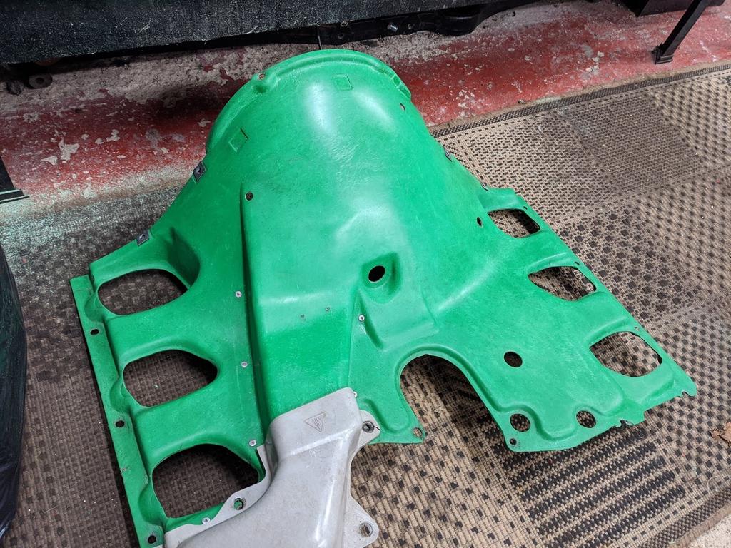

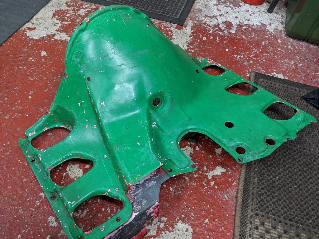

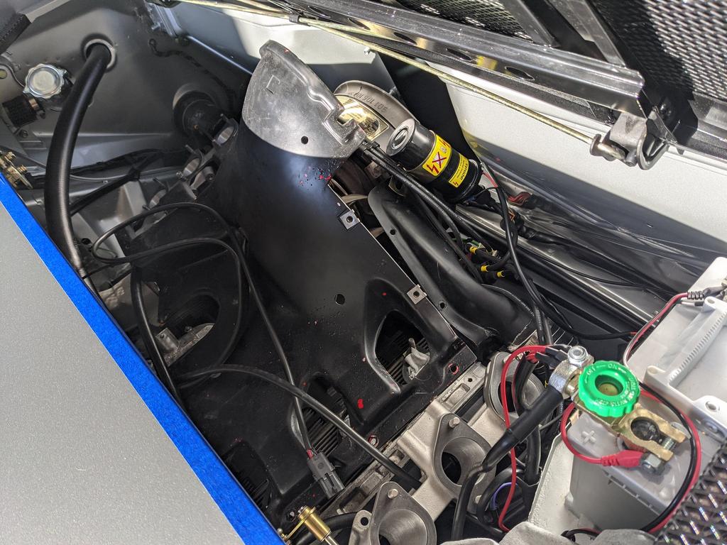

So I stripped down the carbs and gave them a thorough clean. One litre of carb cleaner later and a few replacement gaskets they look much better and hopefully will perform as good as they look.
Taking the carbs off it was plain to see I didn't do the best job in repainting the engine shroud. It had seen a lot of abuse over the years and seen a lot of paint. To be honest I just didn't use the right paint. So whilst I had the opportunity I thought it best to replace it. After failing to get a reply from a couple of vendors and not being able to find a suitable secondhand replacement I thought I'd see what I could do to breathe some life into what I had.
Here you can see the paint bubbling and peeling off.
(IMG:http://www.914world.com/bbs2/uploads_offsite/i.postimg.cc-6621-1576259909.1.jpg)

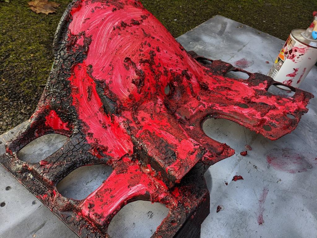

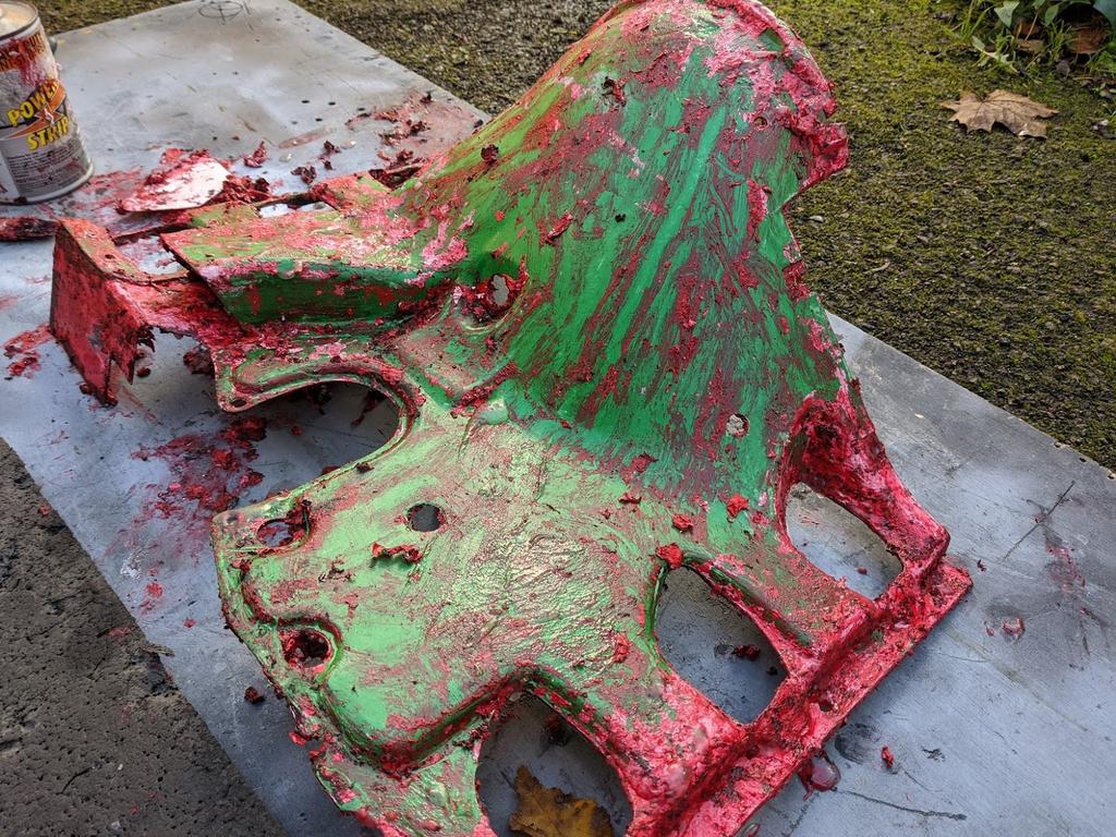

So it was introduced to a can of paint stripper. The top coat of black paint shrivelling away in seconds revealing the next layer of paint and also under that what looks like a layer of white.
(IMG:http://www.914world.com/bbs2/uploads_offsite/i.postimg.cc-6621-1576259909.2.jpg)

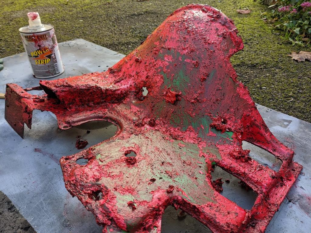

And under the white another layer of red!
(IMG:http://www.914world.com/bbs2/uploads_offsite/i.postimg.cc-6621-1576259910.3.jpg)

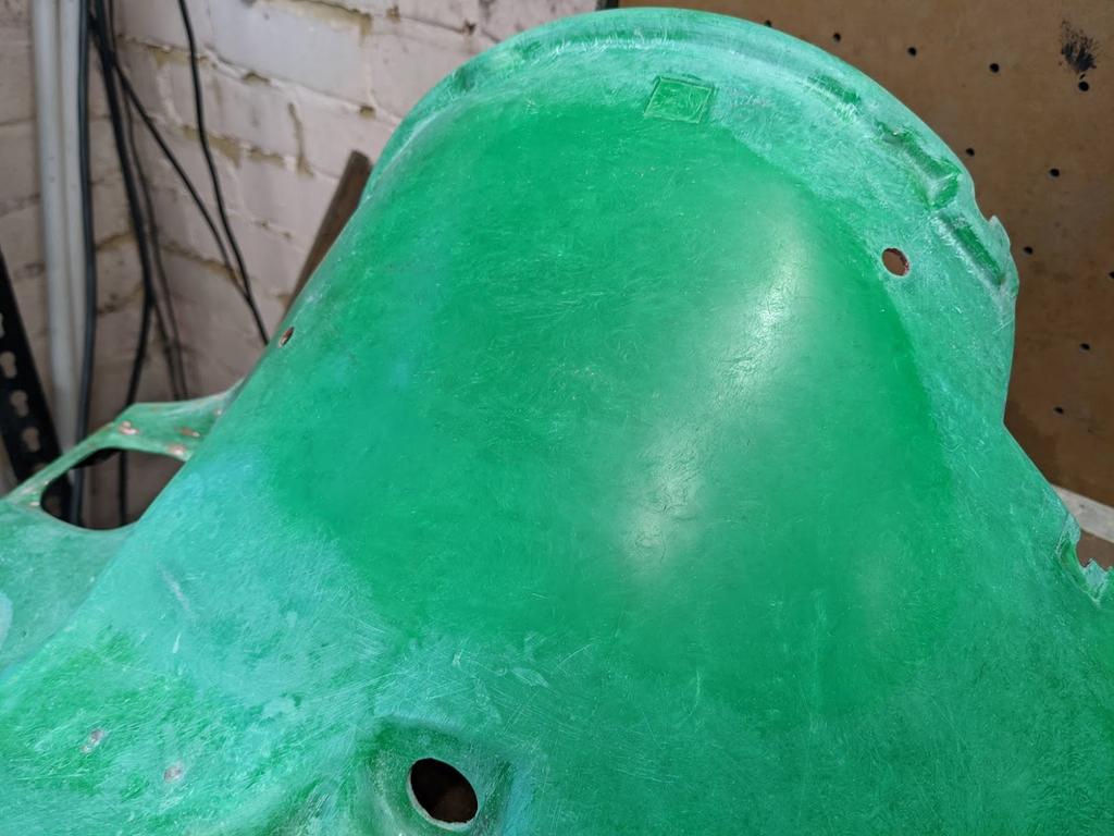

And finally under that the green shroud.
(IMG:http://www.914world.com/bbs2/uploads_offsite/i.postimg.cc-6621-1576259910.4.jpg)

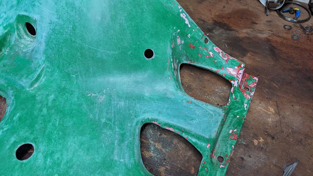

At this stage I ran out of paint stripper but I was close so the rest was sanded off.
(IMG:http://www.914world.com/bbs2/uploads_offsite/i.postimg.cc-6621-1576259911.5.jpg)

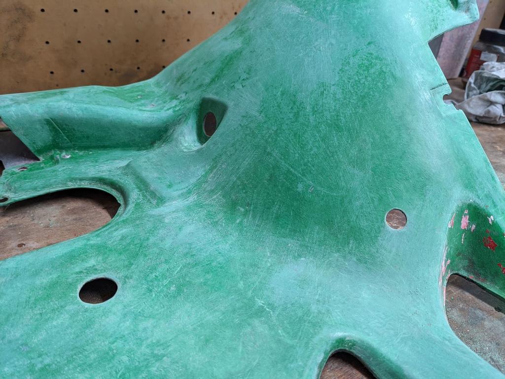

The shroud looked rather tired, the usual marks from the HT leads worn in and I wondered if I'd simply be able to sand them all out.
So slowly through different grades of sandpaper it started to come back to life.
(IMG:http://www.914world.com/bbs2/uploads_offsite/i.postimg.cc-6621-1576259911.6.jpg)
(IMG:http://www.914world.com/bbs2/uploads_offsite/i.postimg.cc-6621-1576259911.7.jpg)
And then I concentrated on a patch to make sure I wasn't wasting my time. Sanding up to 2000 grit and then compound polish. It was only at this stage I thought I was on to something.
(IMG:http://www.914world.com/bbs2/uploads_offsite/i.postimg.cc-6621-1576259912.8.jpg)
Lots of effort later.
(IMG:http://www.914world.com/bbs2/uploads_offsite/i.postimg.cc-6621-1576259912.9.jpg)

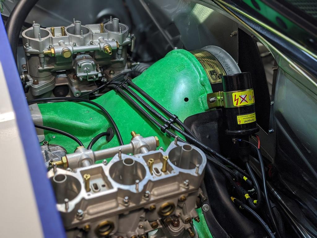

I know it's not the right colour for the engine or the car even but I'm quite fond of it and for once it only cost me my time so I'm happy with that.

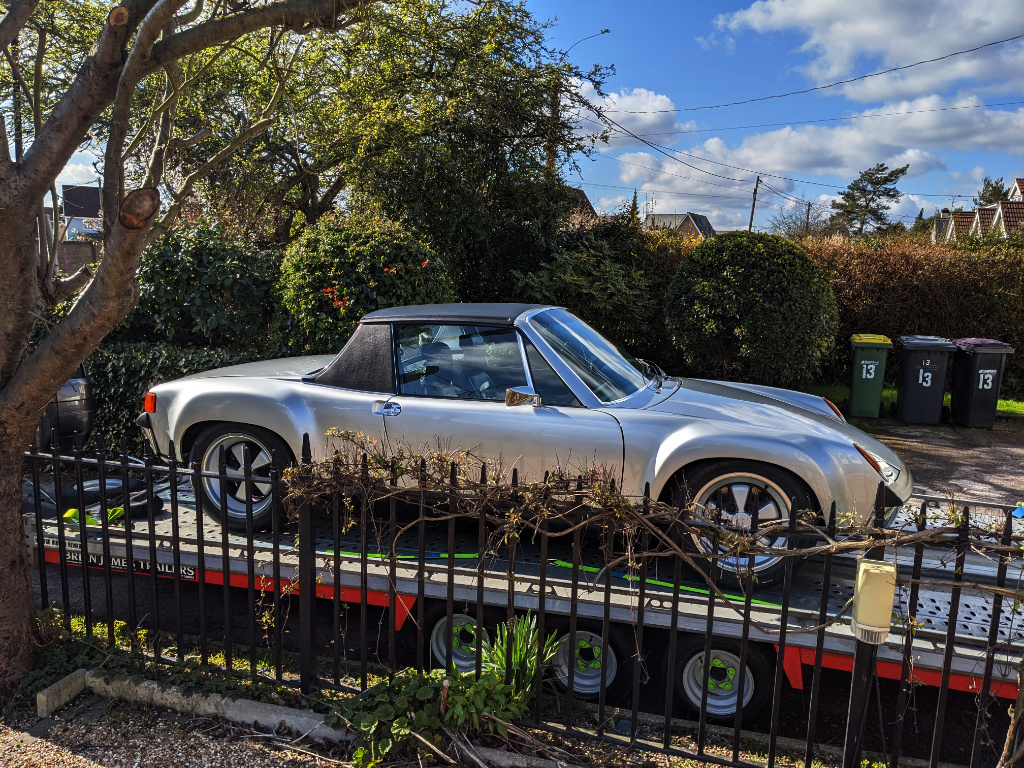

It's been a frustrating few months trying to get the engine running well. I've tried everything I know and more after hours of searching online. So after taking a break for a while to save my sanity, I did the right thing and got someone a damn sight more knowledgeable than me to get it sorted.
Today, in glorious sunshine, it left again on the back of a trailer. All I can do now is hope it's nothing too serious.
(IMG:http://www.914world.com/bbs2/uploads_offsite/i.postimg.cc-6621-1583514574.1.jpg)
