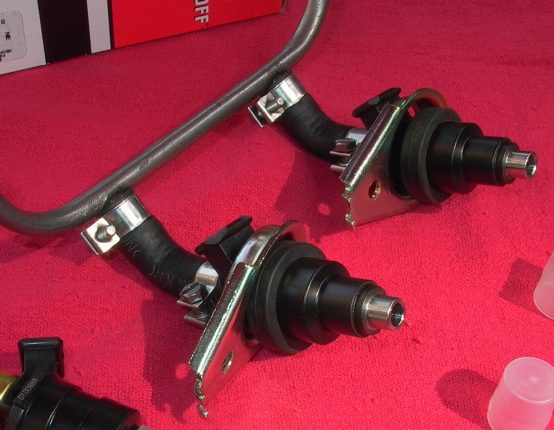

As I reported at the time, I installed the Niehoff injectors for MB 450 back in September '06. I've been running them for about two years now with zero problems. I got them at PartsAmerica.com for under $50 each brand new. Only mod needed was hose changeover. Donut seals are standard 914. Pic below is passenger side rail after retrofitting with 914 elbow hoses.

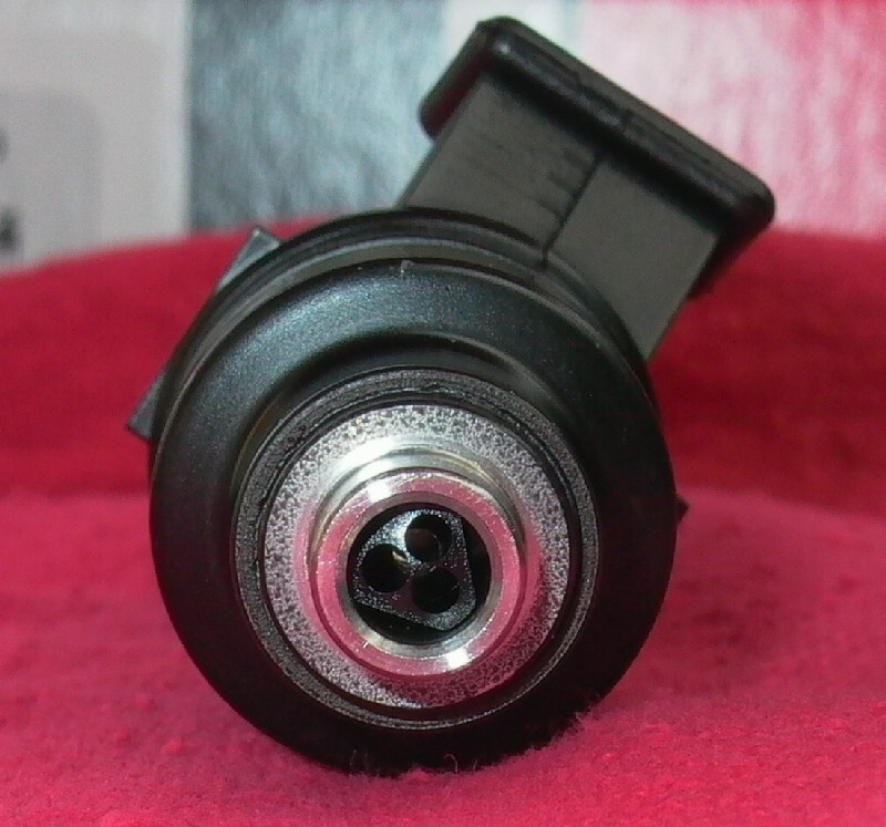

Just checked my records. Actually I put the Niehoffs in 3 years ago, and have had zero problems. Photo below is the business end. Also, when I bought my Niehoffs, I got 3 of this type, plus one of the pintle valve style. Apparently, Niehoff was in changeover from the older style to the newer one. PartsAmerica looked in their warehouse and found them mixed, and replaced my one older style injector with the newer one.

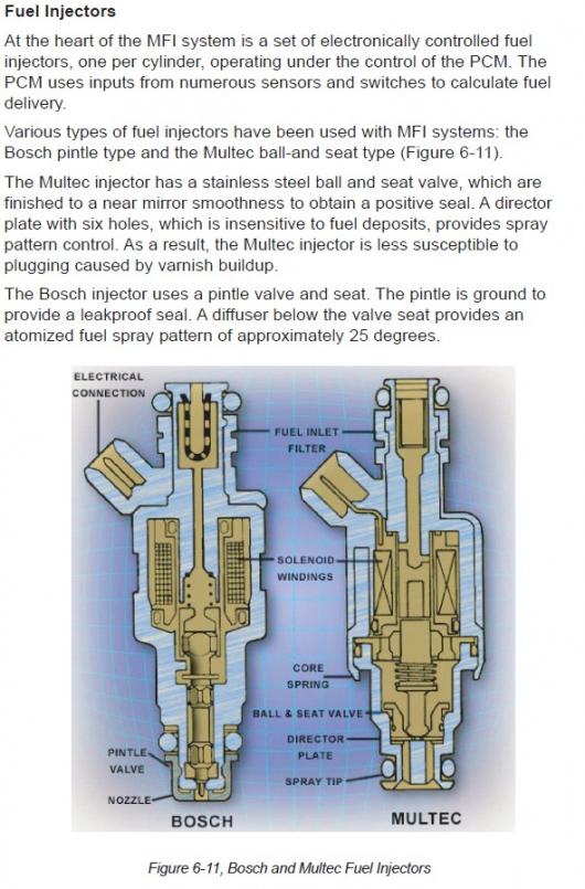

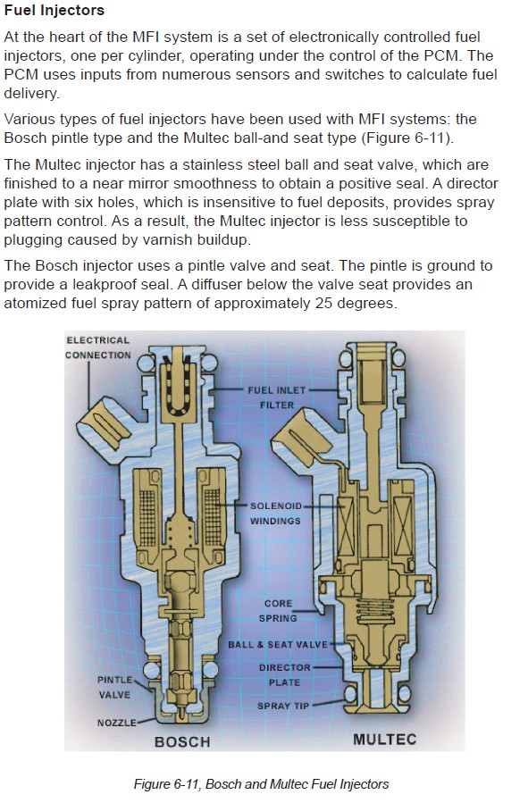

Surfing the web, I found an interesting article in a GM tech manual. I reproduced one page below... Looks like the Niehoff may be a takeoff on the newer GM "Multec" design, as used in their V8 port fuel injection systems and others....
